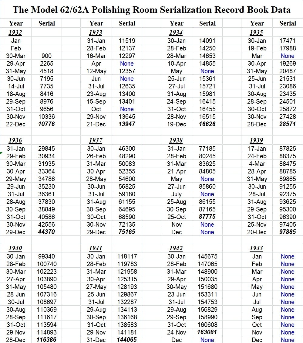

The Polishing Room records still exist for the Model 62.  Ned Schwing published the PR information in his reference books covering the Winchester Slide-action .22 caliber rifles.  I created the table below using the PR records and Ned’s published information.

Bert, just for clarification on the serial numbers on your table, do the numbers represent the beginning number of that particular month or are those serials known individual numbers from specific days? I presume the former. My number 1643 is between 30-Mar. & 29-Apr.?

Darrin Smith said
Bert, just for clarification on the serial numbers on your table, do the numbers represent the beginning number of that particular month or are those serials known individual numbers from specific days? I presume the former. My number 1643 is from 30-Mar.?
Very best,
Darrin
The PR records show the last serial number applied on the specified date.  S/N 1643 would have been applied sometime in mid April 1932.
