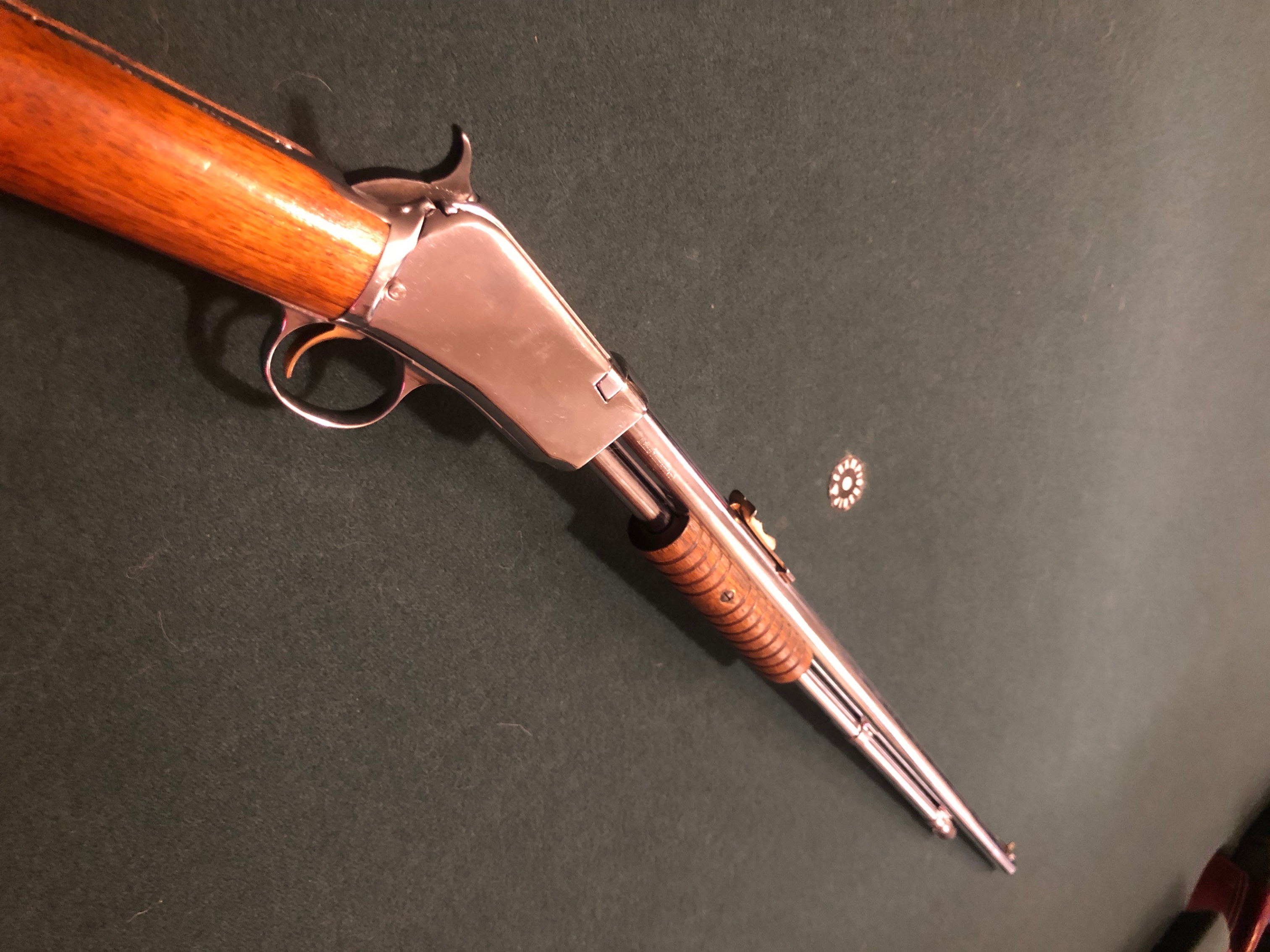

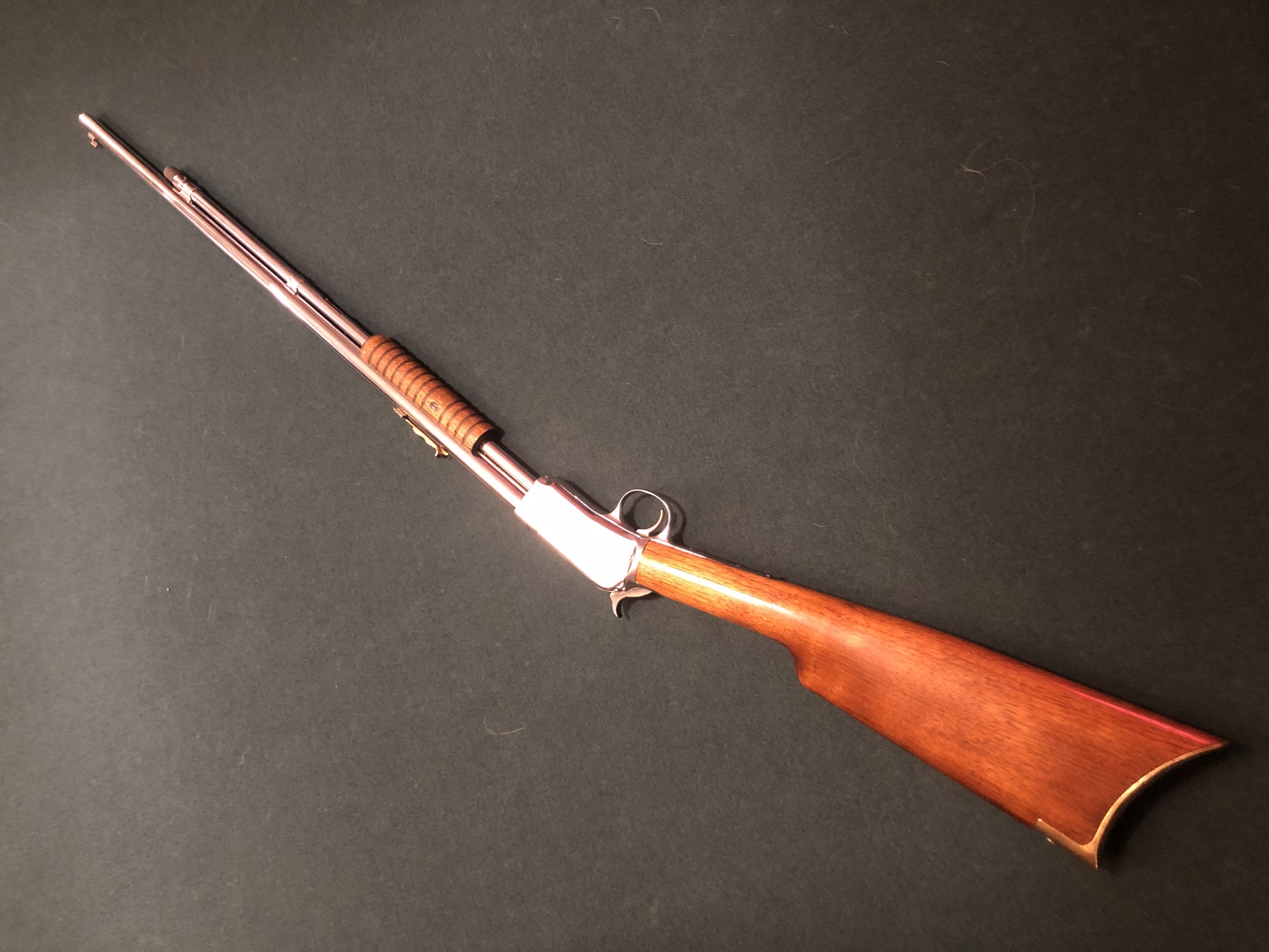

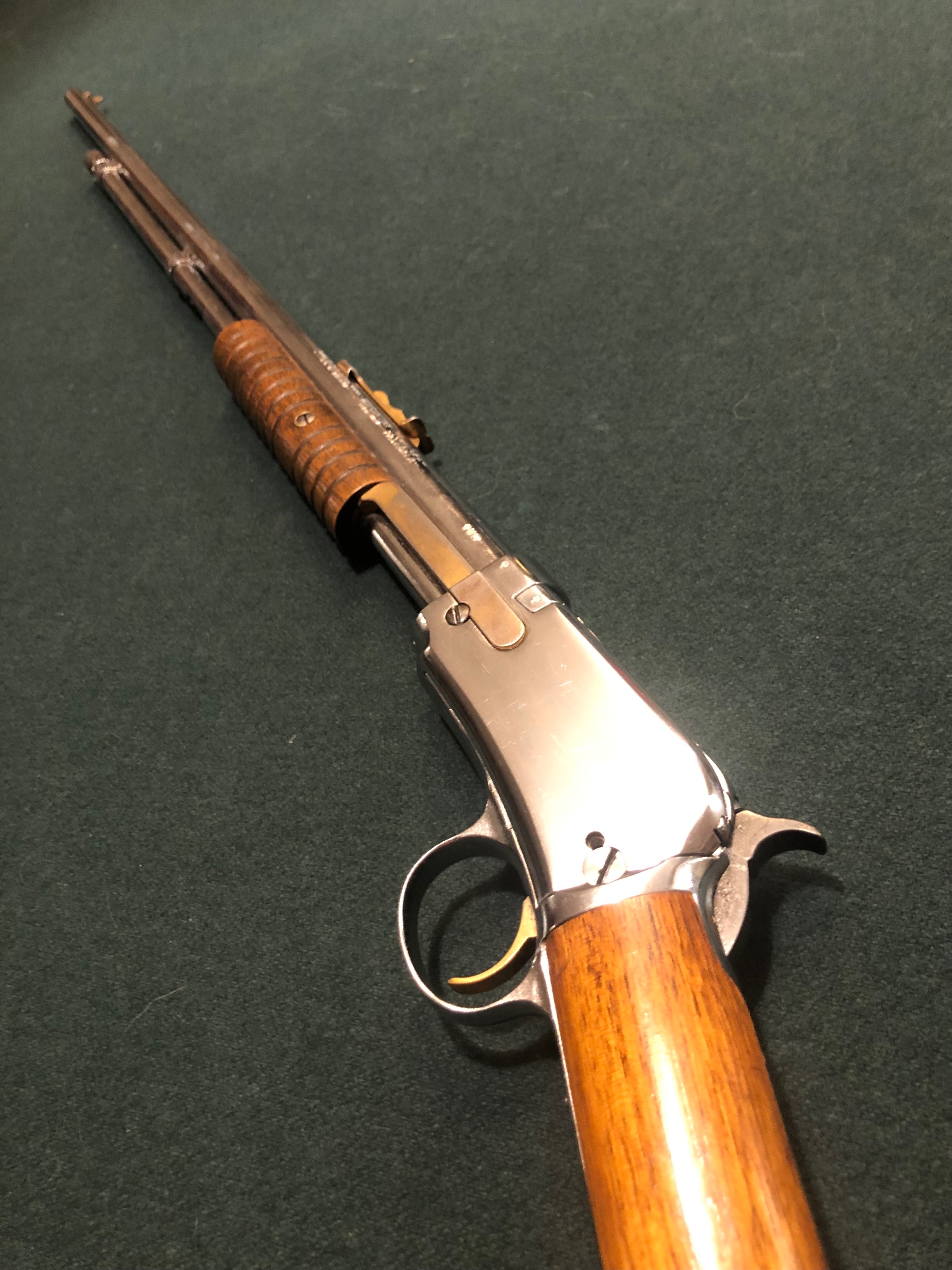

Hello all,
new member here, first post – hopefully it’s interesting for you guys.
I have what seems to be a winchester model 62A with a custom nickel-chrome plating job with multiple proof marks a mark on the barrel that says “A Kind Gummersbach” (likely the gunsmith that did the finish-job), and it seems to have been re-stocked.
The serial number on this rifle is puzzling me as it is 655591 and as far as I know they only manufactured around 409XXX rifles.
Im wondering if I have some sort of post-production special order, or a post-production parts rifle of some sort. If anyone has any information on this or could point me to the right direction I would appreciate it.
kind regards,
A. FL337
IMG_5473.jpegIMG_5467.jpegIMG_5468.jpegIMG_5471.jpegIMG_5469.jpegIMG_5474.jpegIMG_5470.jpeg74589506260__7E2F1293-8BAB-4685-9723-587319CB6D39.jpegIMG_5475.jpeg
Forum Posts: 7757
August 24, 2024 - 11:38 am
Welcome, FL337! What you have may be what we call a Frankenchester. Could be an 1890 receiver and a 62A barrel. My reference books are STILL at an undisclosed location but that seems the best possibility based on my increasingly feeble mind. Can’t help with the inscription, looks like a cool rifle. Thanks for sharing the pics!
Forum Posts: 2869
August 24, 2024 - 12:54 pm
Mike’s description of “Frankenchester” appears to be the case.  Your receiver is from a Model 1906 (hence the “B” under the number), the buttstock is from a Model 1890 and the barrel is from a Model 62A, and then it was chromed……
All those parts are basically interchangeable so it should be a good shooting rifle.  Those are unusual proof marks on the barrel and receiver, if you can post some clear, close-up pictures we might be able to give you more info about them.
