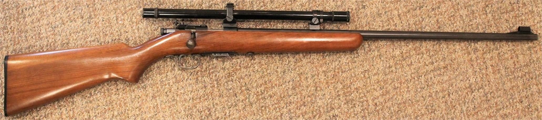

Scoped 22 Winchesters are quite scarce. Most are beaters. I bought this rare factory scoped Winchester a few years ago.
Not cheap, but drippy mint.   Big LarryWinchester-model-69-22LR-Factory-winchester-scope-and-factory-peep-Super_101097869_75444_46DF8803FA013D1A-2.jpg

Nice specimen!

Of all the rare or otherwise exceptional guns you’ve shown us, Larry, this one is hands-down the most outstanding!  Truly incredible!  Because, they were not top-of-the-line deluxe models that owners might be expected to handle & store carefully, but “utilitarian” guns probably bought by someone of modest means, & regarded as “nothing special.”  The paint on those scopes is so easily scratched or chipped, that to have survived in this cond is miraculous.  I’m sure it’s not the most valuable you own, far from it, but I’d call it the “gem” of your collection.  Deserves to be a centerfold in one of Jeff’s future books.

I would have been happy to include that nice G6951R Type 1 in the book except Larry’s scope rings are installed backwards, the mount thumbscrews should both be on the left side WinkLaugh
Larry does have some of his rifles illustrated in the 69 book, such as the G6901R Type 2 on page 26 AND has some in the upcoming book on the Model 75.

Leave them be, say I.  Risk of scraping paint if they were reversed too great.  Placing them on the Southpaw side actually seems counter-intuitive, which Lyman evidently recognized in the new scopes introduced after the 5A.

Yes, I will leave it alone. You are correct, the paint is really thin. I wonder how it happened though. JWA has seen all my guns and never mentioned it.   Big Larry

Larry, I would leave it alone, as Clarence mentioned, the chances of doing damage are not worth the benefit of making it correct.  Since I recommend not touching it, it did not seem important to mention it to you.  I only mentioned it here to help other people install their scopes correctly, especially if they are purchasing a separate scope to restore a rifle (like the original poster).  You can check your other .22 rifles with scopes to verify it, surprised you didn’t notice it yourself as you are as detail-oriented as I am. Laugh

Indeed he is!  But it would be easy to overlook, as most other detachable mounts have the thumbscrew on the side sanctioned by Jehovah.
