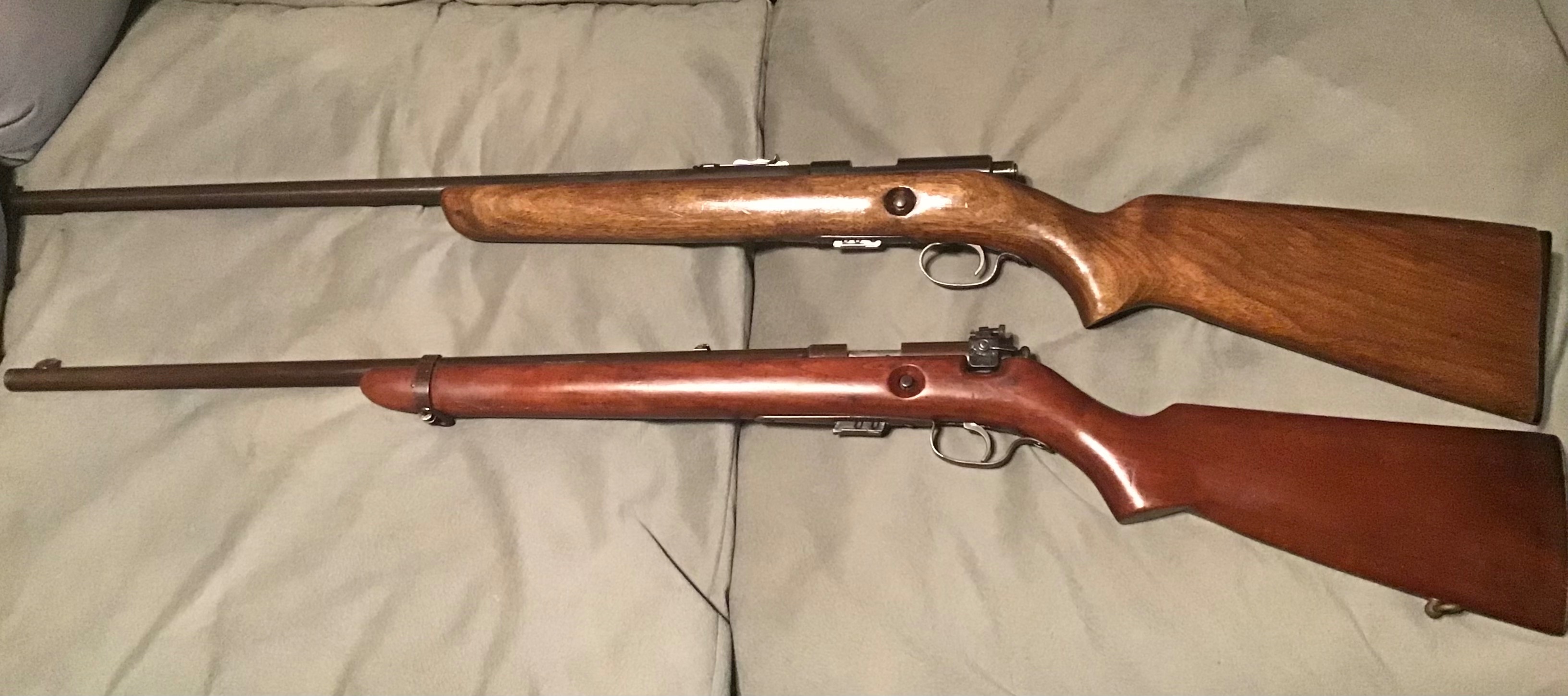

IDK what it is, here it is below my 69a.IMG_0750.jpegImage Enlarger
Forum Posts: 2693
March 8, 2025 - 9:13 pm
I am not sure what it is either, it mostly looks like a 57 stock except the wrist seems to be an odd shape unless it is a trick of the camera.  The dished inlet for the rear sight is definitely not from Winchester.  Possibly an aftermarket replacement stock?

IMG_0751.jpegImage Enlarger
IMG_0752.jpegImage Enlarger
IMG_0753.jpegImage Enlarger
Forum Posts: 2693
March 8, 2025 - 10:22 pm
That appears to be a replacement stock, the receiver and barrel inletting is not Winchester and the shape of the pistol grip and wrist is not correct.  By not correct, I mean it is the wrong shape with too much material so it is likely a 90-95% inletted replacement stock.  The stock finish (that opaque red) is not correct either.
Sorry to be the bearer of bad news….
