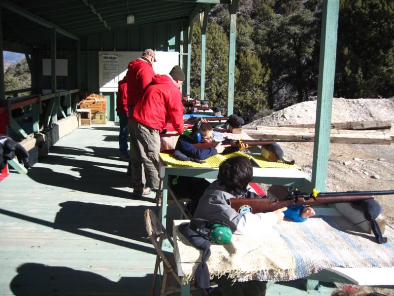

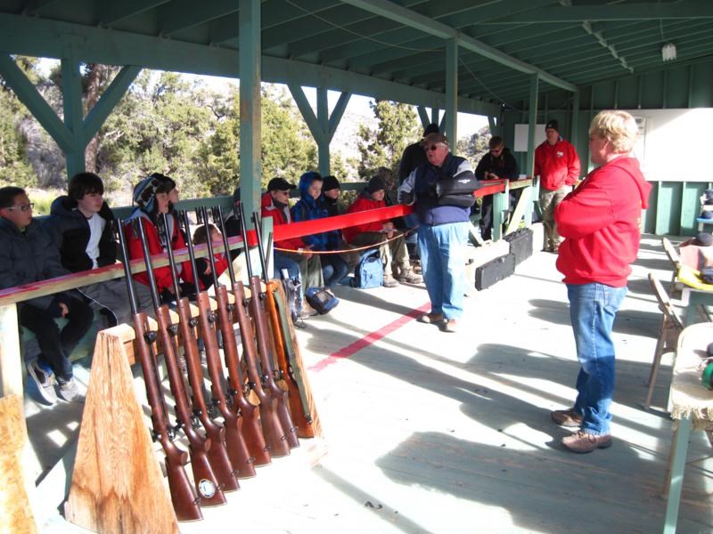

I buy them all the time for use with the Boy Scouts in the $400-$500 range for the early 52’s that have been shortened/modified/D&T’d/re-blued/etc.  As long as the rifle is safe and has a good bore that is all that is necessary for a BSA Rifle Merit Badge. 😉
