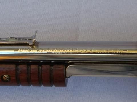

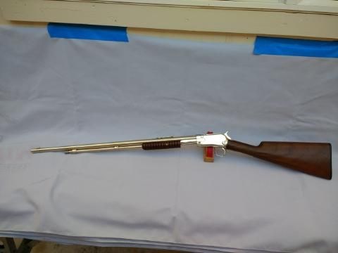

I bought a nickel plated Model 62 back about 2004.  It was brought in to the local gun show by a man who claimed he got it from a neighbor who had cancer and had died several years before.
He said the neighbor had worked for a West Coast Carnival show and ran the shooting gallery.  When the carnival show folded there were two of these rifles that had been offered for prizes but never won.  The show owner kept one and the other was sold to the man who ran the shooting gallery concession.  I bought the gun with the promise that the seller would return with more information on the gun and name of the carnival.  Needles to say he did not honor his side o the agreement and I never saw him again.
The gin is pristine with the exception of a couple of scratches on the hammer from the bolt.  I noticed it had a Model 90 fore arm and not the proper cigar shaped one.  Not being knowledgeable of “nickeled” guns, I was wondering how to tell if it came from the factory nickeled of if it was after market nickeled.

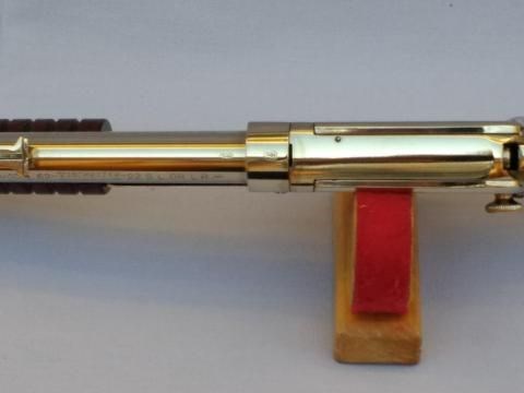

My photo taking lacks expertise, but you should get an idea of the finish.  Any photo taking suggestions will be welcomed. Thanks, Roger
November 18, 2019 - 9:12 pm
Sorry, I know this isn’t what you want to hear, but to me, the nickel looks too flawless for a gun discontinued about 50 yrs ago.  And I’m a little skeptical that a carney operator would have been fastidious about caring for it.  I think if that story were true, both guns would quickly have been disposed of at the nearest pawn shop, & by now show plenty of usage.

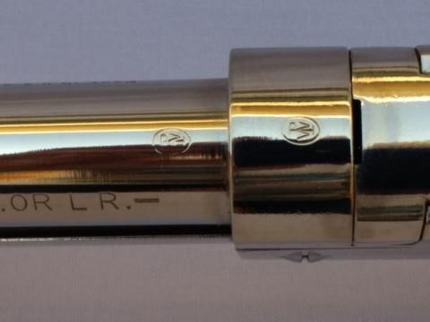

Roger,
I would bet good money that it was nickel plated after the fact.  The clue is the condition of the proof mark stamps.  As manufactured by Winchester, they were applied after the rifle was fully assembled and test fired (after the nickel plating).  As it appears in your pictures, the nickel plating was applied over the op of the proof mark stamps.

November 19, 2019 - 5:36 am
That was my take on it too.  That is why I made my best effort to show the proof marks.  I will pull the stock just to see what is under the wood.  I know the sights are plated so we will check it out the inside.  I would think the ‘prize guns’ would probably not have been fired as they were always just on display.  I also remember why the black dot could not be shot out in three shots.  They used the “hanging chad” system.  The paper tore and a part of the black dot always hung on.  You had to completely shoot the dot out to win and it isn’t possible.  Thanks for your replies.  I will add that I have not been able to find any signs of pitting.  Roger

I very carefully removed the stock screw and stock.  The flat hammer spring appears to be the only part that is not plated.  Thanks to all for your input.  Looks like I just have an old shiny gun with a good salesman’s story.  Forgot to post the serial #83363A.  Has the one pin bolt.  Roger

November 20, 2019 - 4:24 am
Something else I just noticed, it has an 1890 forearm. The 62 should have the double taper forearm.

November 20, 2019 - 3:13 pm
Mentioned the ’90 fore end in the first post.  Considered trying to replace it with the proper one, but was afraid of getting scratches on the magazine tube.  Plus, “it is what it is” and the proper slide handle in pristine condition may not exist.  I have always wondered how it was possible to assemble or disassemble a Winchester firearm and leave no trace of doing so.  I definitely do not have that expertise!  Roger
If it’s a refinished gun, “proper” is no longer very relevant; the ’90 forearm looks better, & replacing it won’t increase gun’s value.
