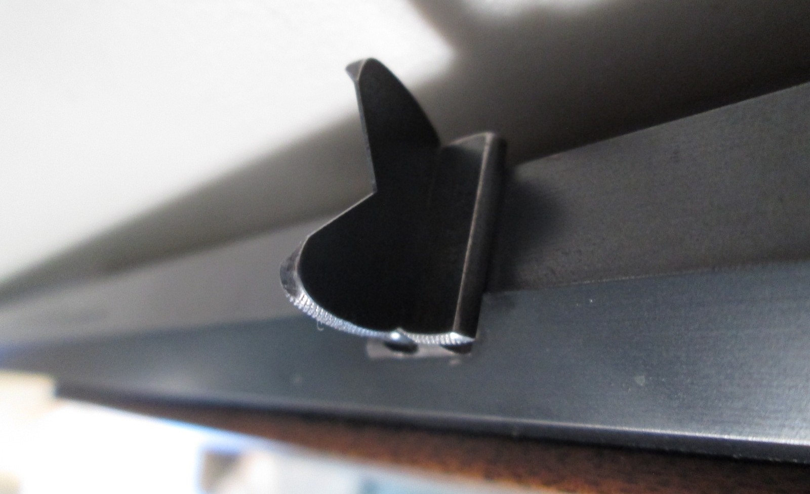

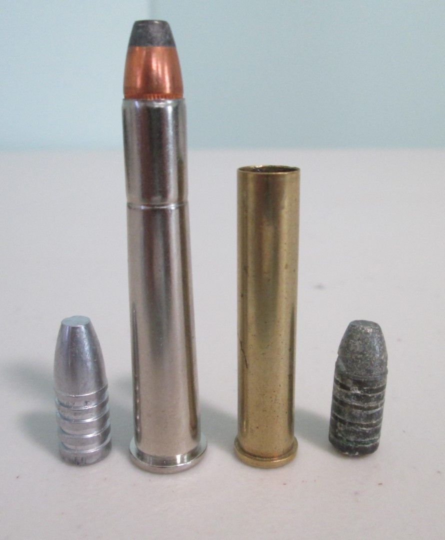

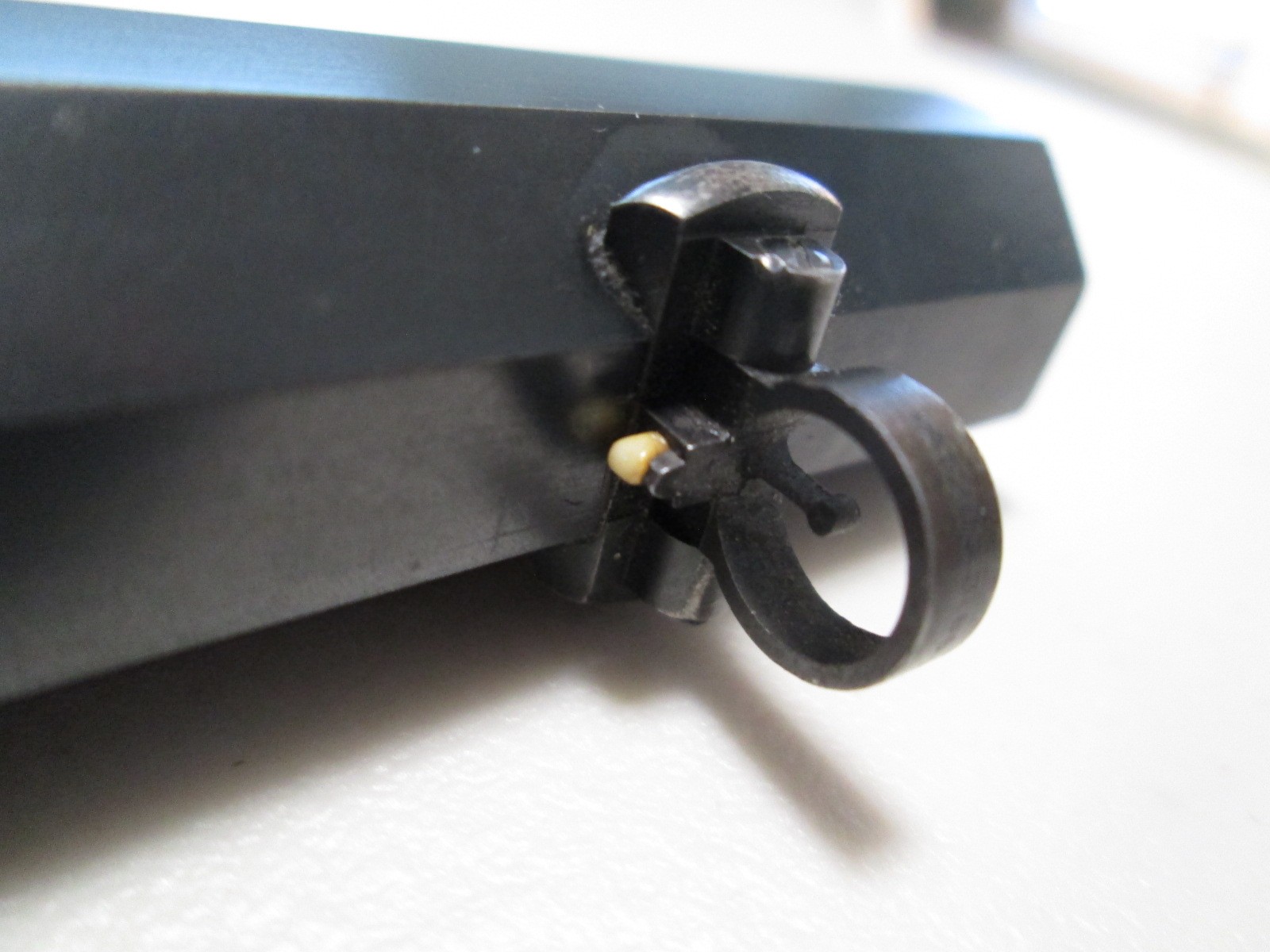

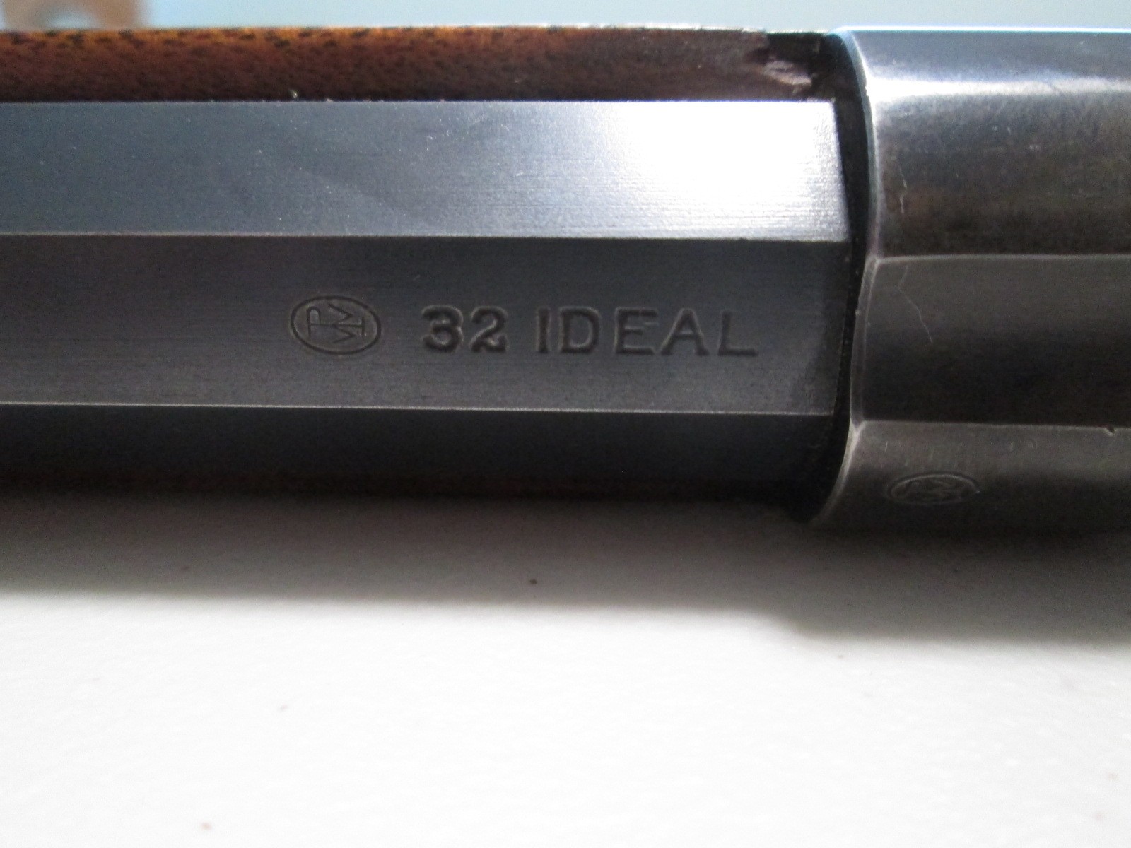

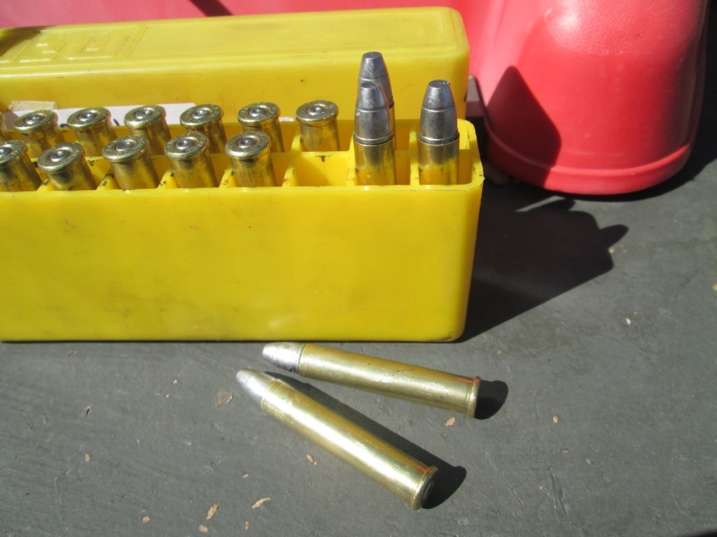

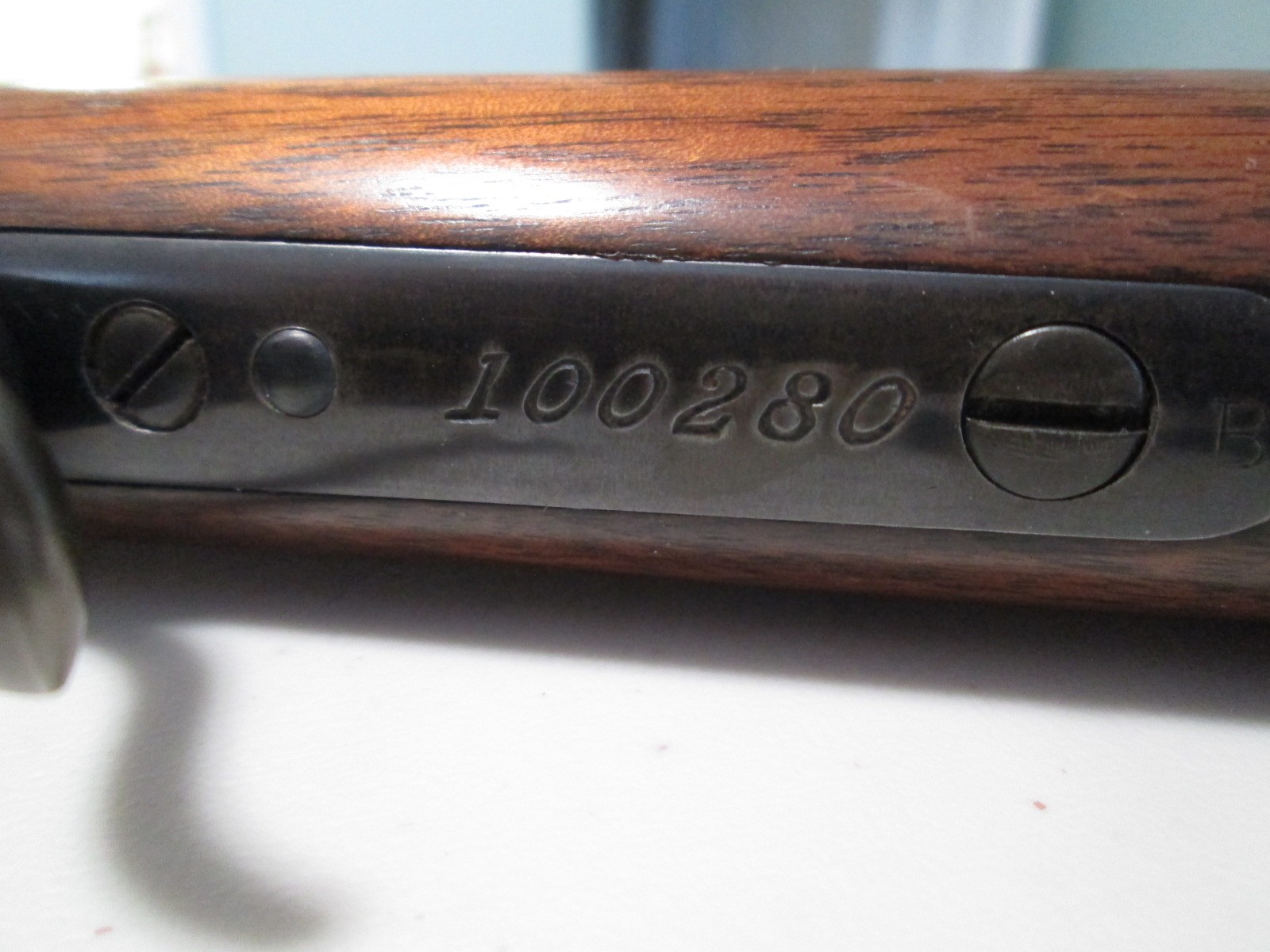

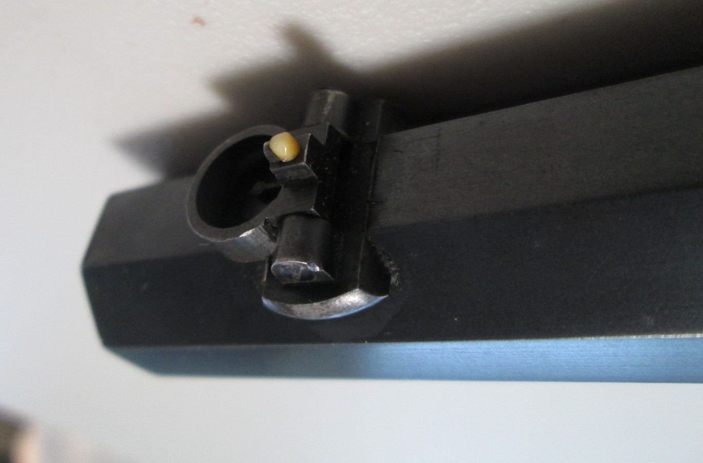

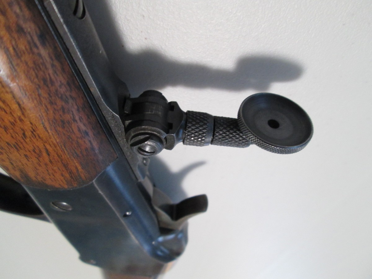

This spring I acquired an 1885 low wall (#100280) in caliber .32 Ideal, a cartridge unfamiliar to me. With the rifle were 60 cartridges, some loaded with black powder and  153 gr. .318″ bullets. Many of the cases were Peters, others WRA. I handload for over 30 cartridges but this one was going to be problematic. Not one of my many shell holders fit the rim! Regardless, I was able to put together some loads using an Arsenal mold throwing 165 gr. .321″ bullets. There’s much more work to be done with loads, but with its excellent bore the little rifle shows good+ potential at the range. I especially like its sights. I’ve attached some photos for your review and hope to report range results in the future.

Brian Sindelar said There’s much more work to be done with loads, but with its excellent bore the little rifle shows good+ potential at the range.
Gun looks immaculate, so “good+ potential” is probably conservative.  Worth trying .323″ bullets, if you can obtain them.

Hello Brian,
That is a very interesting low-wall Plain Sporting rifle.  Specifically, the “B” stamped on the bitter end of the lower tang is the first one I have ever seen, and it is a complete mystery to me.  Ordinarily, the lower tang is blank in that location, or will have a sideways stamped “A” (which indicates a coil-spring action).  The factory records indicate that this rifle was received in the warehouse in July 1905 as a 32 Ideal, 28″ No. 1 octagon barrel, plain trigger (light pull), which is too early for it to be a coil-spring action.
The sights that are on it now were added after-the-fact by a discriminating shooter (a Lyman No. 5B Combination front, a Lyman No. 6 Folding leaf rear, and a Marbles tang sight).  The 32 Ideal cartridge was known for its inherent accuracy, but it was greatly outnumbered in production by the much more popular 32-40 cartridge.

Re: Clarence:  Gun looks immaculate, so “good+ potential” is probably conservative.  Worth trying .323″ bullets, if you can obtain them.
I’m betting you’re right on its potential. I’m wishing my new mold was casting .323″ instead of .321″. I’ll try to get some.
Try Hunters Supply cast : Link  I used the 170 gr 8mm for my 32-40 several years ago. Or beagle your mould with aluminum tape if you have a sizer that works…

rwsem said Try Hunters Supply cast : Link  I used the 170 gr 8mm for my 32-40 several years ago. Or beagle your mould with aluminum tape if you have a sizer that works…
I have a .32 Spl. HW with a badly pitted bore.  Considering the bore, it shot better than expected with .321″ bullets (jacketed, of course), but with 8mm–.323″, I believe it shot about as well as a perfect bore!

But thanks, Ron, for the link to Hunter’s Supply. I just ordered 250 .324 cast bullets for both my .32 Ideal and .32-40 rifles. I have a .323 sizing die for my luber. Plus I have been looking for a good cast bullet supplier and these bullets are shipped free!Smile
December 13, 2022 - 6:26 pm
Brian Sindelar said I just ordered 250 .324 cast bullets for both my .32 Ideal and .32-40 rifles. I have a .323 sizing die for my luber.
Brian, if you can lube them without sizing, that’s also worth trying as, theoretically, the .001” oversize may shoot best.  Though as we all know, theory & practice don’t always agree.
