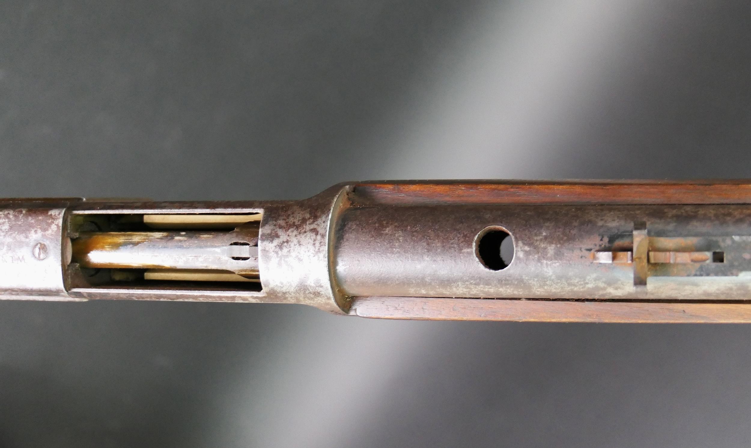

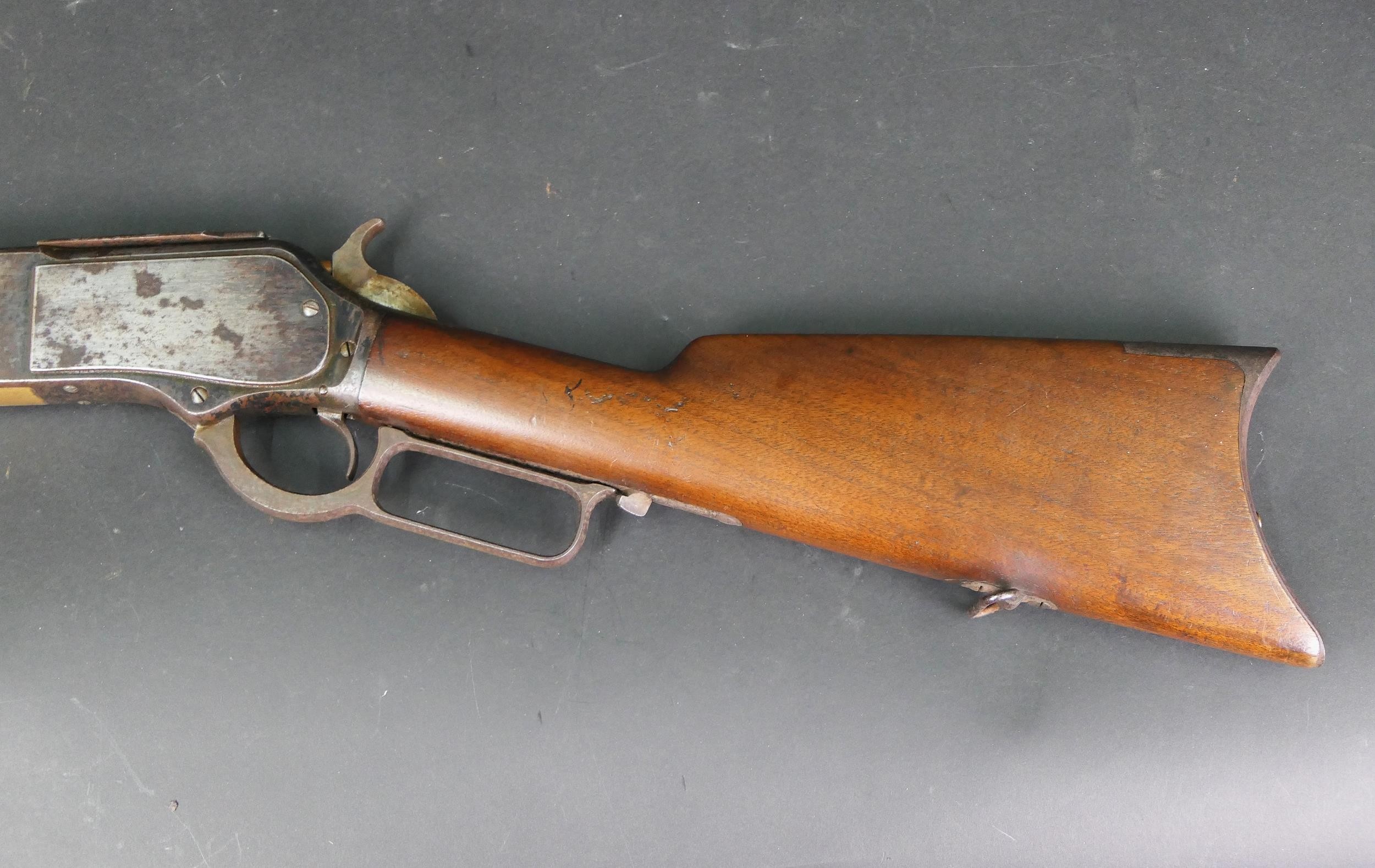

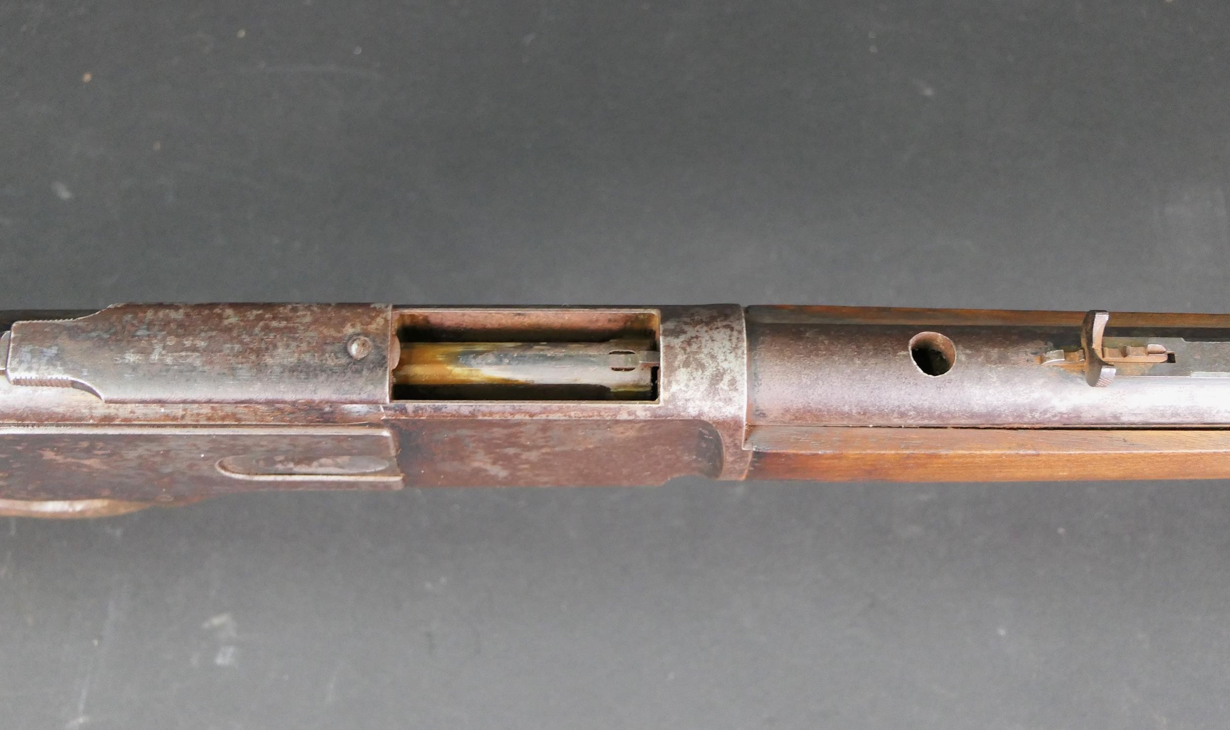

I just bought a 1876 at auction unfortunately someone drilled a hole in the barrel just behind the rear sight, not content with just drilling the barrel they went through the  handguard as well. I presume whoever did this wanted to show it couldn’t be fired?  What I would like to ask is, what would the chance be to maybe get a replacement barrel. It doesn’t have to have a good bore, just the exterior to look okay. By the way the bore on this one was very good except for the hole in it. It had not seen much use all the internal parts, lifter, bolt, hammer, sear/trigger etc. are all in very good condition. Anyones help in this matter is appreciated. Regards Ron.

Post pictures of the hole in the barrel and the other hole. What is the distance from the hole in the barrel to the receiver? Depending on where the hole is you could have the barrel lined  or sleeve the chamber which would fix the bore and then its a matter of plugging the outside.

Thanks for your response, a friend of mine suggested something similar. The hole has been drilled into the rifling about 1/4 of an inch in front of the chamber, chamber is untouched. I will try and sort this out in the future. Sorry it took  me a while to reply my internet was not working.

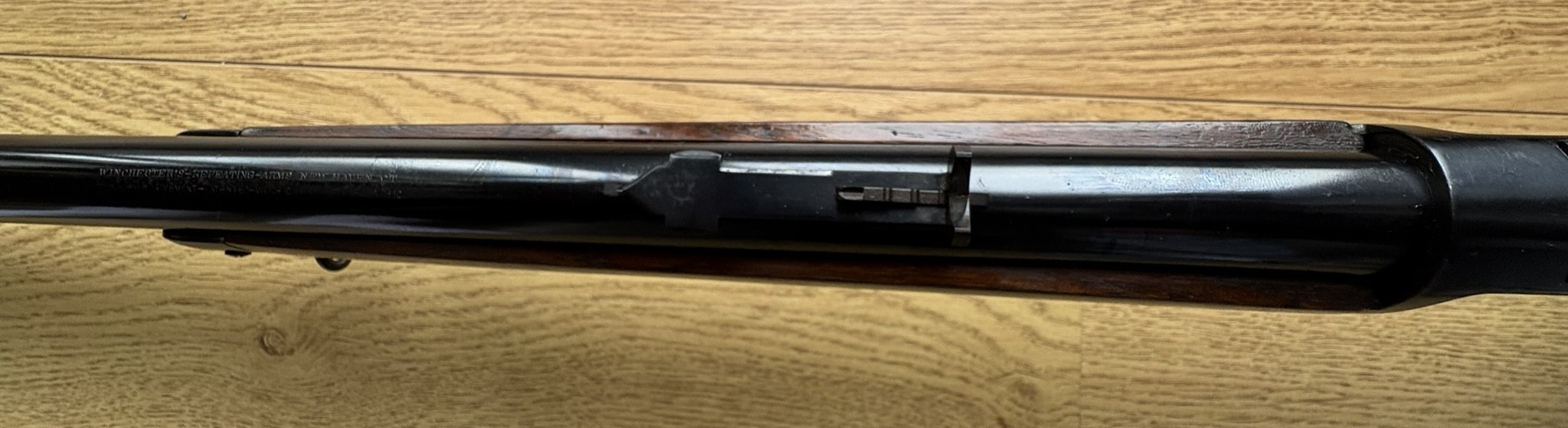

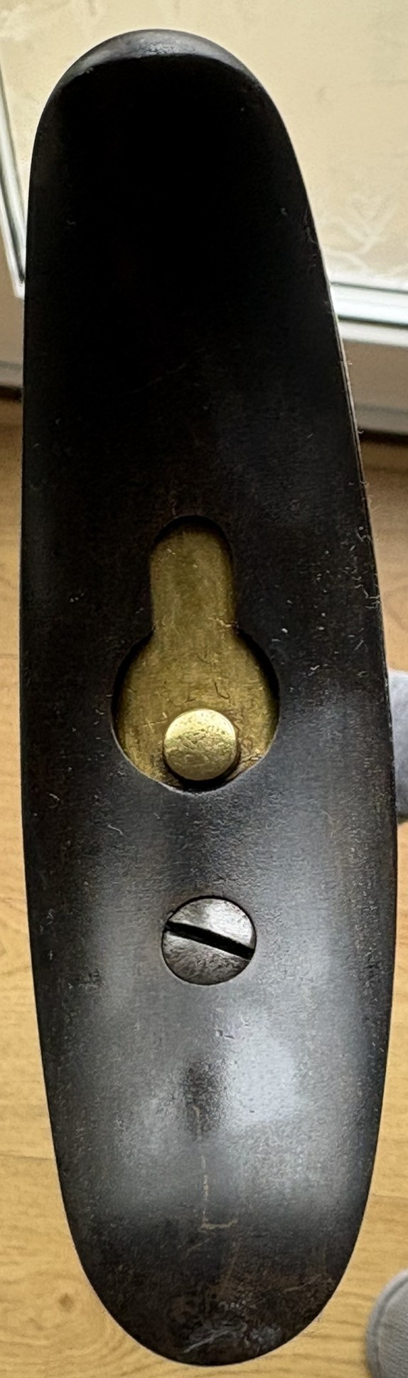

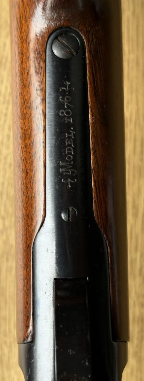

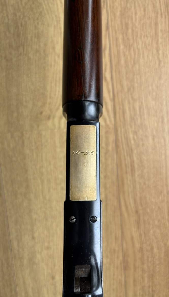

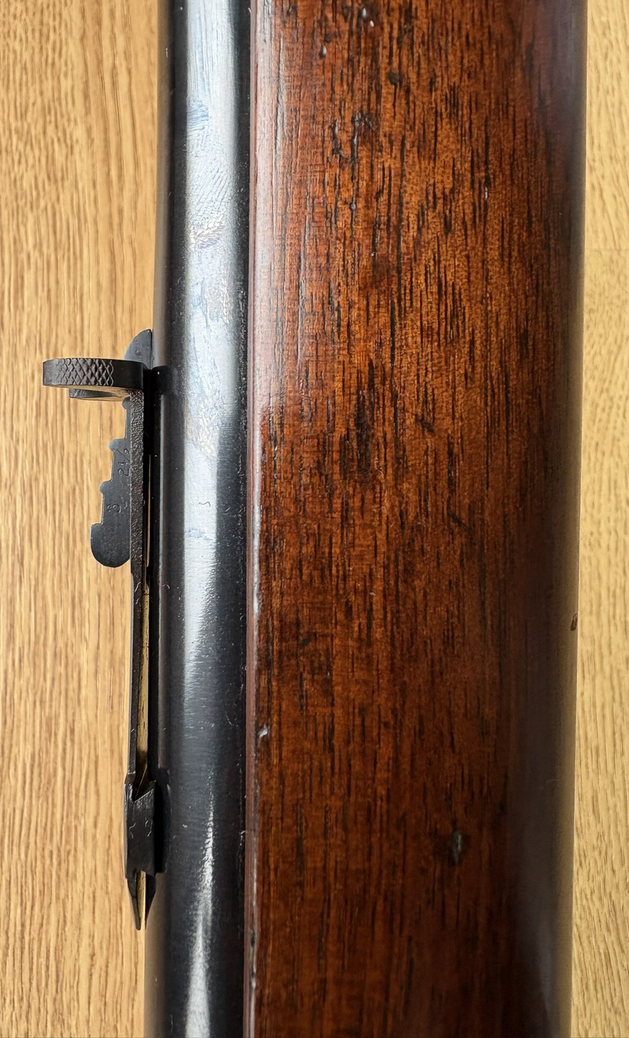

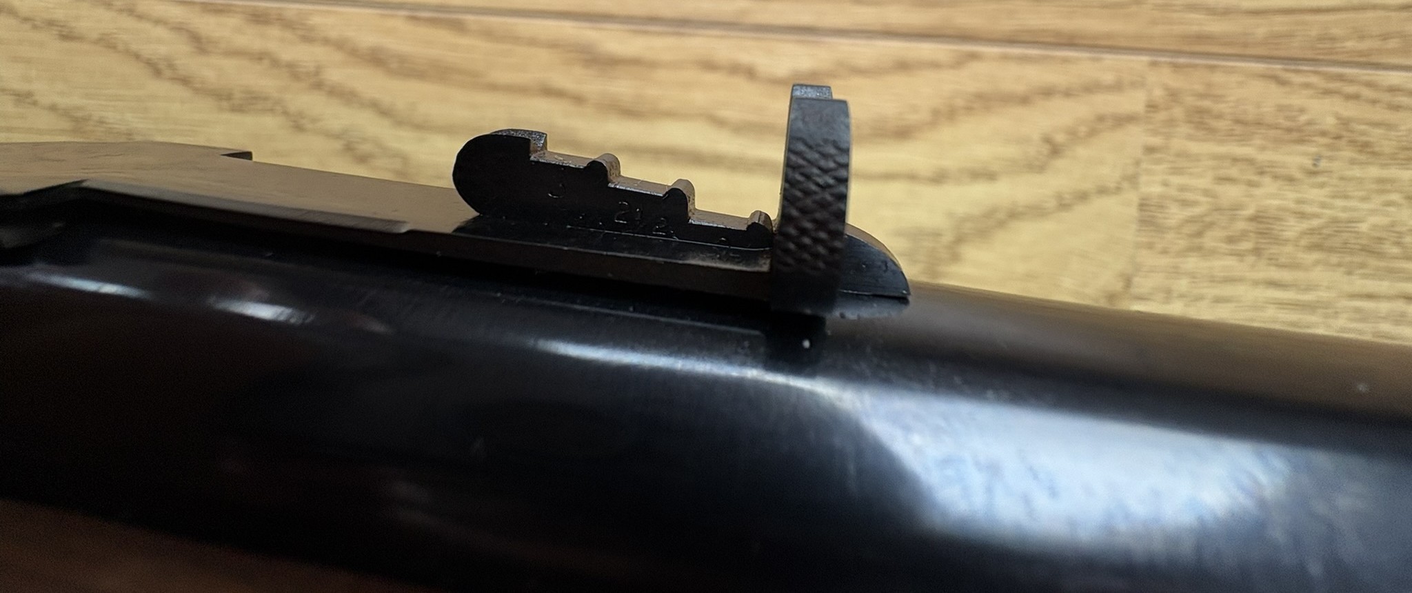

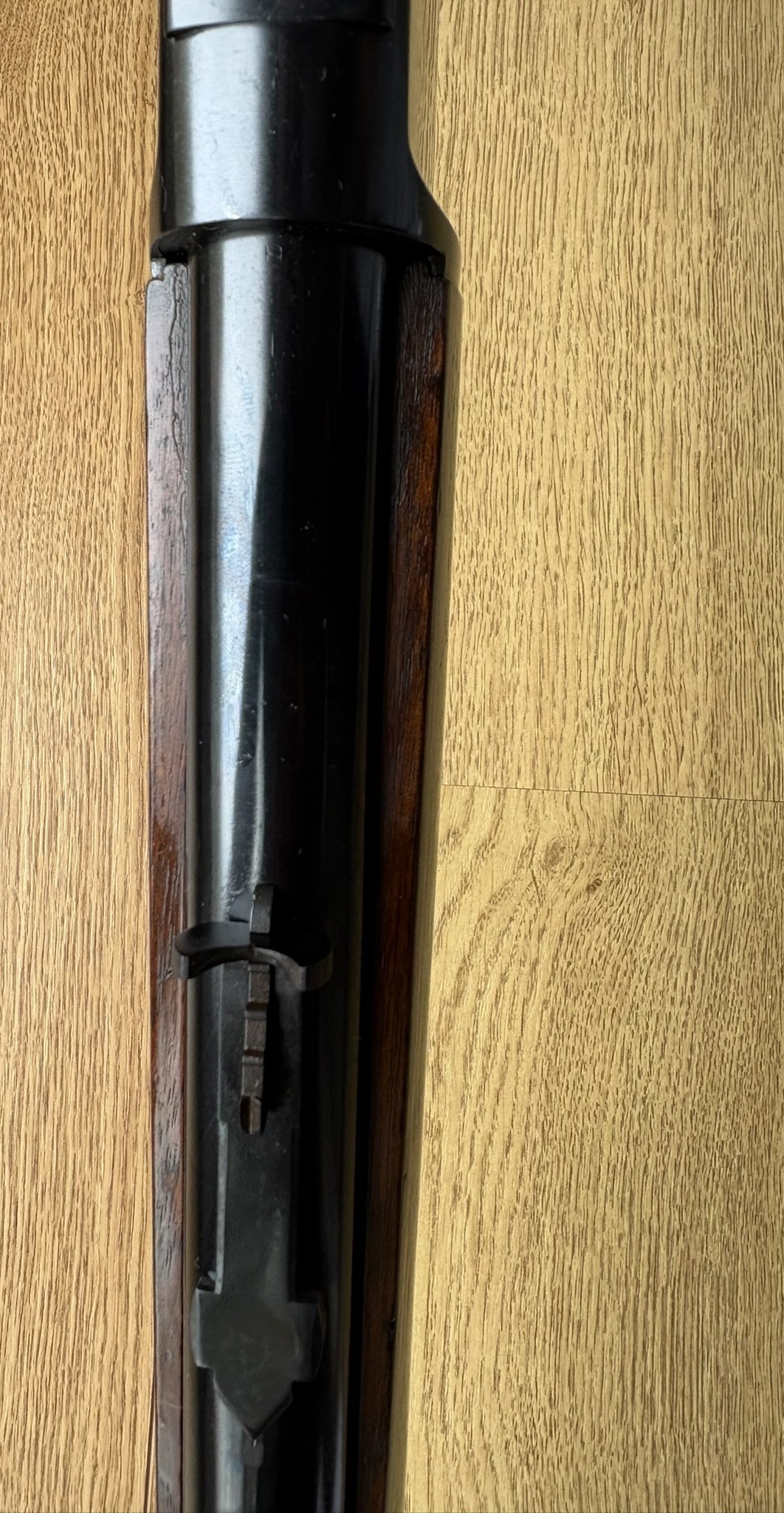

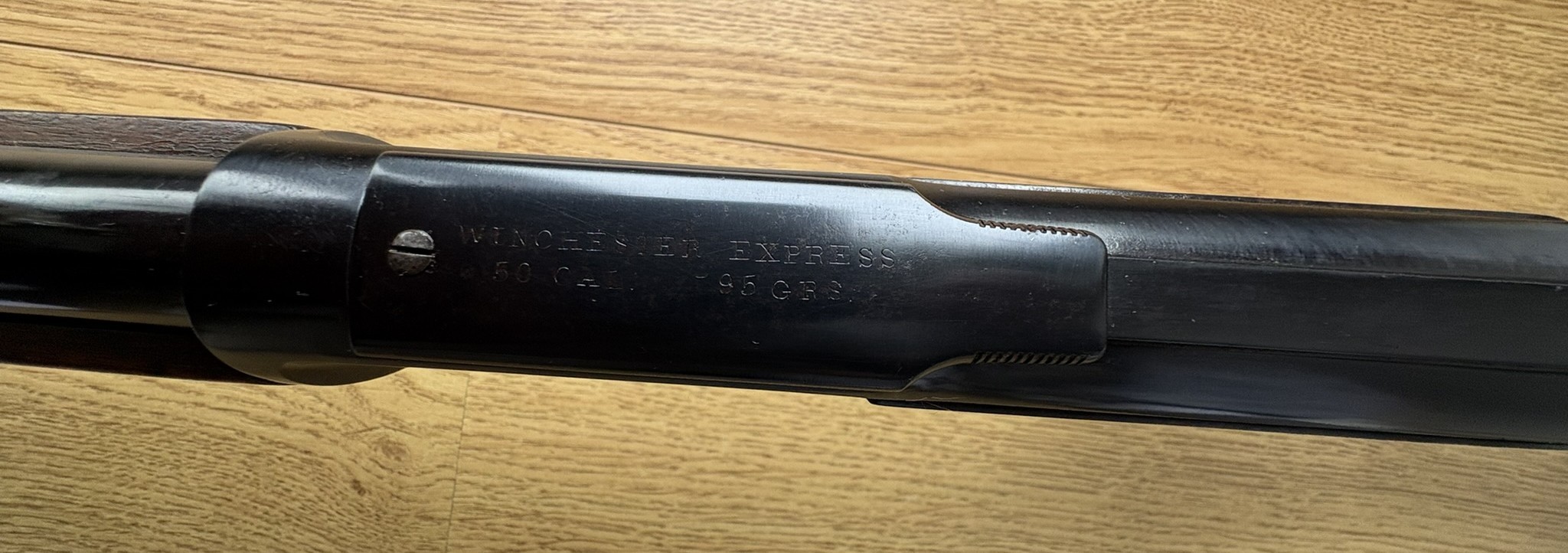

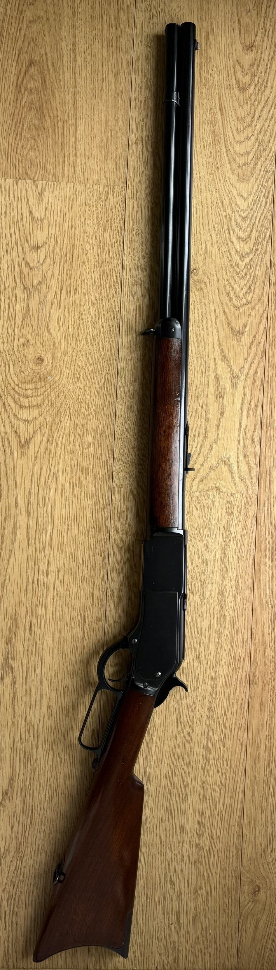

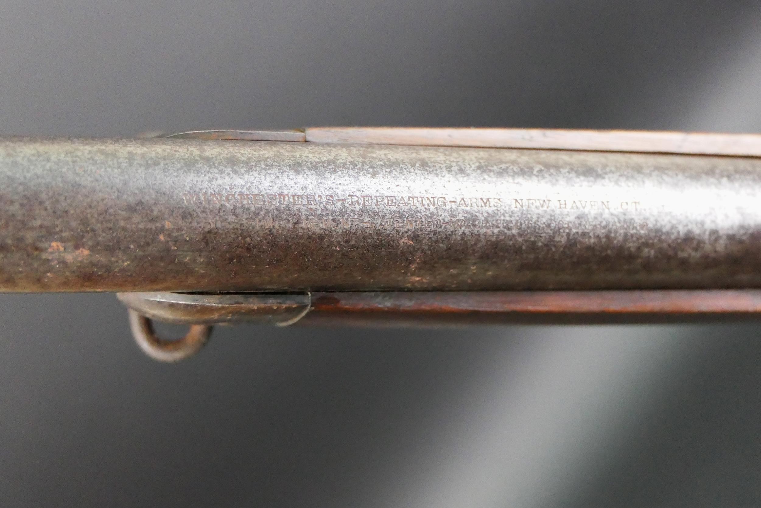

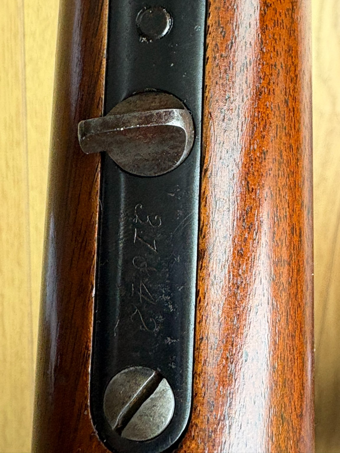

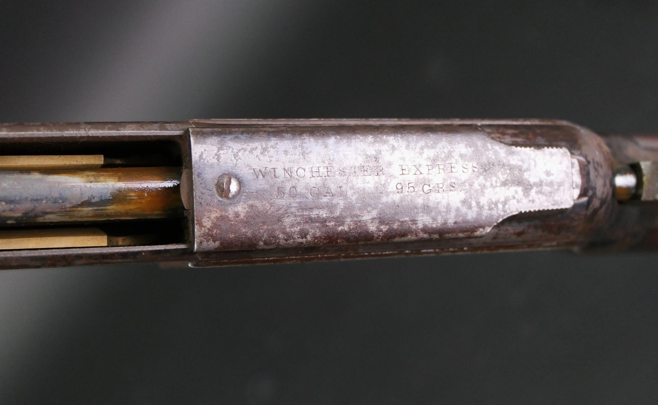

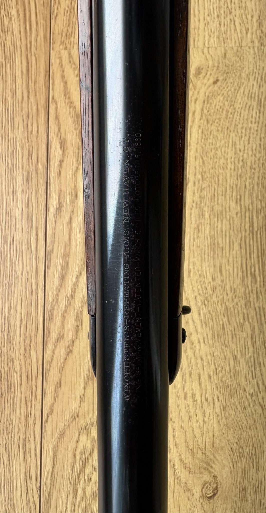

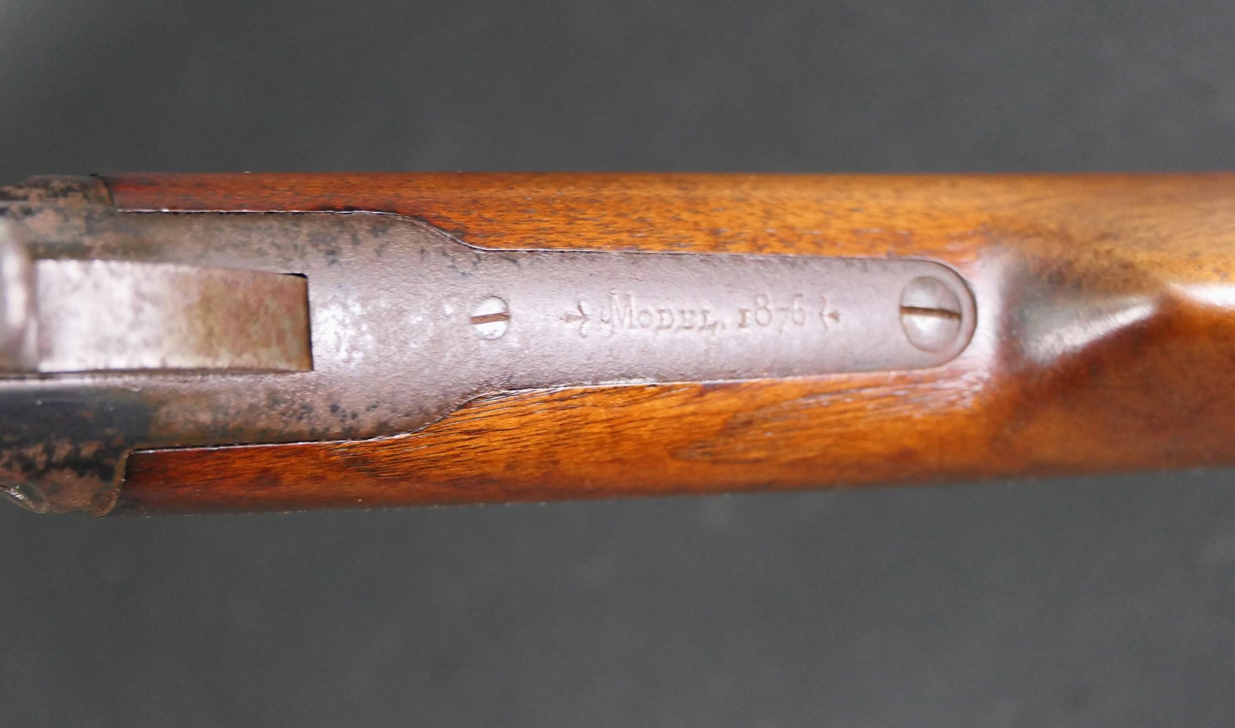

IMG_35581.jpegThis is after refinishing and reblueing the Winchester 1876.  It’s probably not everybody’s taste but I think it looks better than it was especially with the hole drilled in the barrel.IMG_3560.JPEGIMG_3562.JPEGIMG_3563.JPEGIMG_3564.JPEGIMG_3566.JPEGIMG_3568.JPEGIMG_3570.JPEGIMG_3573.JPEGIMG_3576.JPEGIMG_3577.JPEG

There are a couple of screw heads that need touched up and the finger latch I will do that later, I know that refinishing goes against alot of collectors values. What are your views?Frown

It certainly looks better than it did before the refinish.  Impressive that it still has it’s original rear sight with the special elevator used only on the .50 Express ’76.  We need a report on how the barrel was “fixed” and who did the work.

Thanks for all your comments. The barrel has not been relined, my friend in the north of Ireland threaded the hole in the barrel screwed a threaded plug into the hole. He then tig welded the plug contured it to the shape of barrel, polished by hand and reblued the barrel and receiver and various other parts. the hole in the forearm was pluged and wood was gently refinished. The gun will not be shot as it was purchased as an obsolete calibre firearm, meaning here in the UK it can be owned without a firearms certificate. The gun was aqquired by the auction house from a farmers estate in Cumbria, I presume the farmer not knowing it was obsolete calibre drilled the hole to show people or (police) that it couldn’t be fired. Thanks for agreeing that it looks better than it did.

 Are we talking about two plugs, one from the top and one from the bottom leaving the bore clear or one blocking the bore.
 If you have ever shot a 50-95 you know the kick. Not a lot of steel in that area and not high grade steel. Blocking a barrel in a less than obvious fashion   would be dangerous. T/R

Two plugs as you say. The gun won’t be fired.
