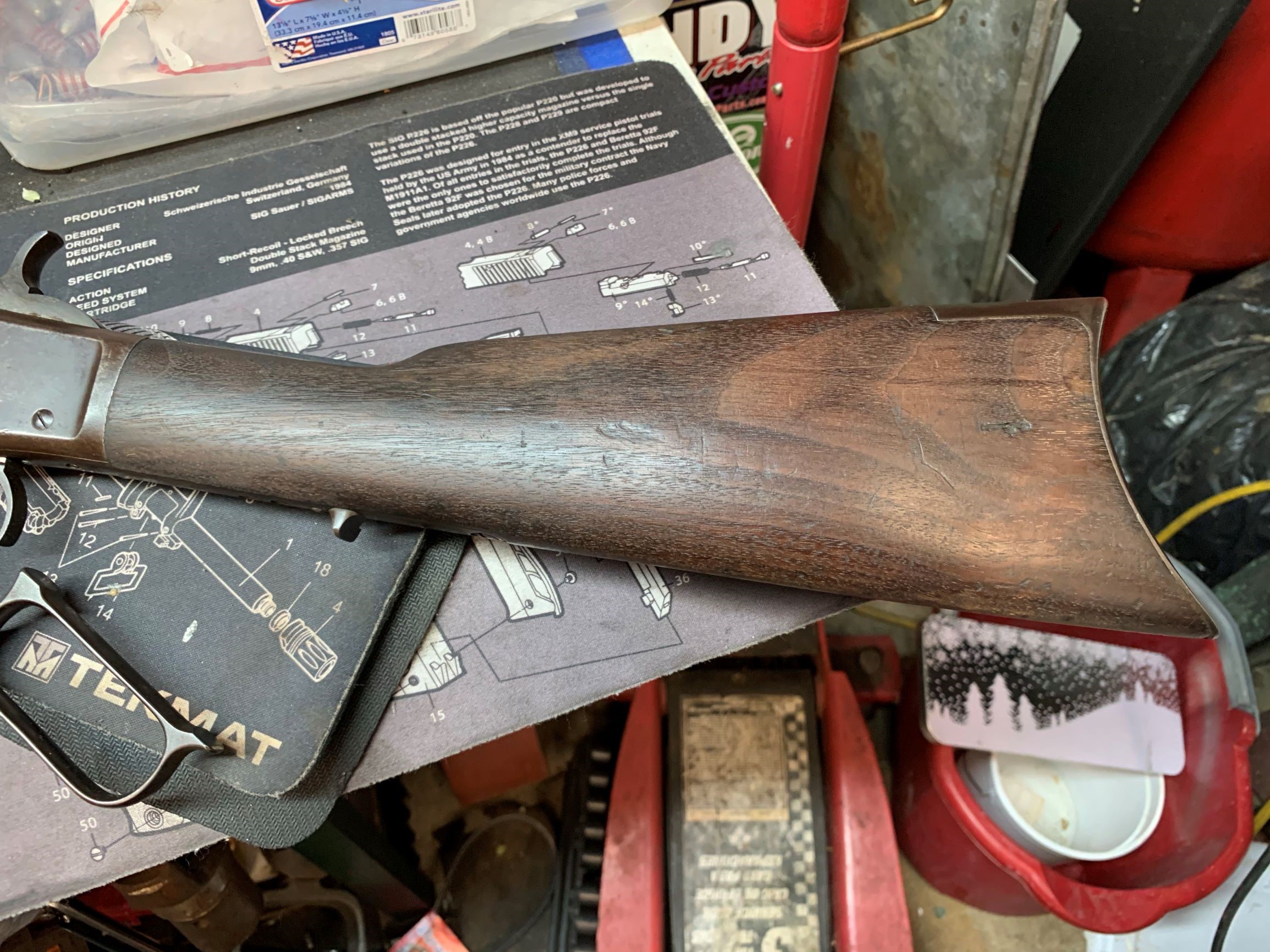

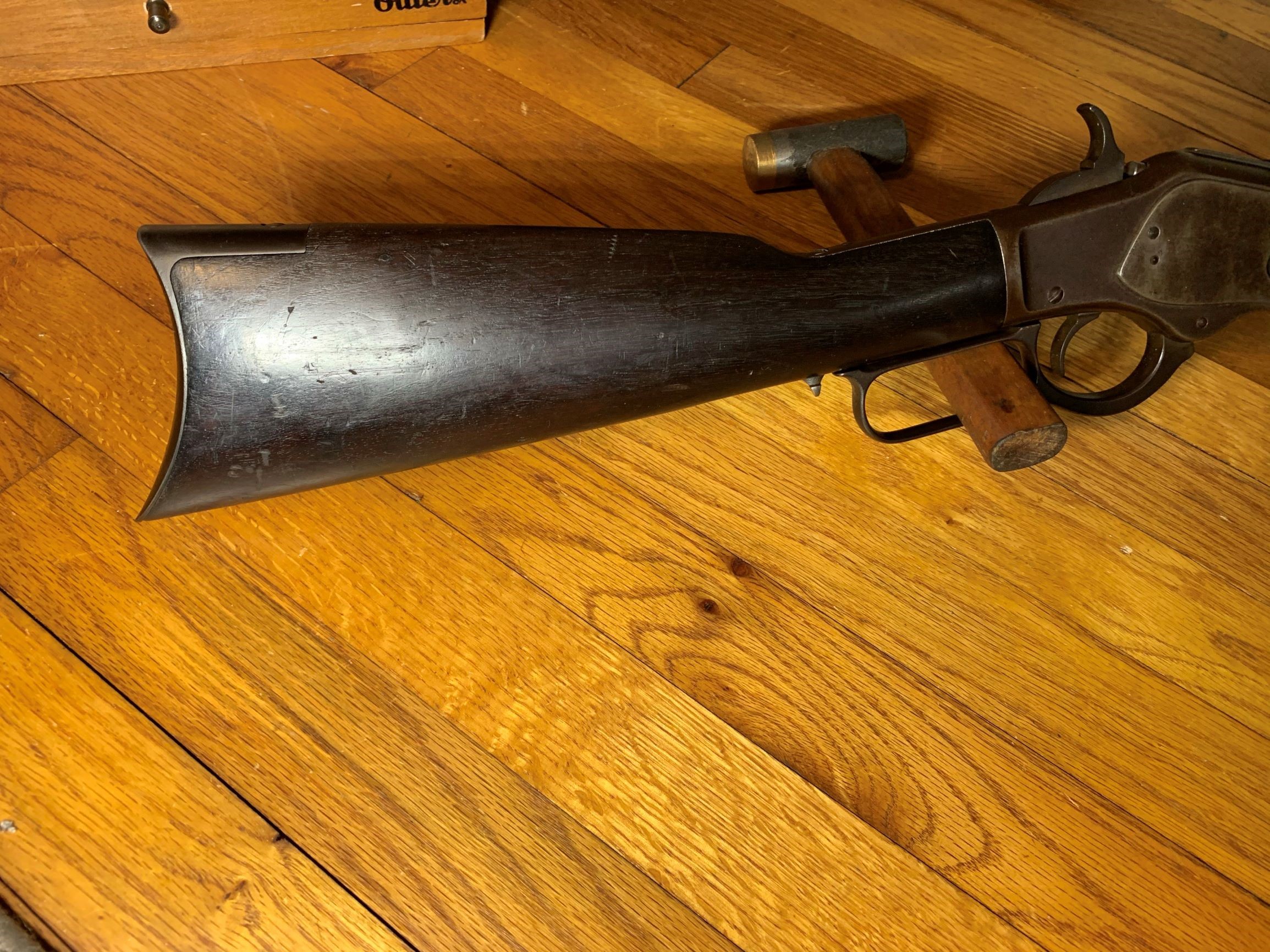

[Image Can Not Be Found]Yes I did take pictures in fact I have one with the Rear Stock cleaned but not the fore Stock. It shows a sharp contrast between the two. I try to post a couple, but keep in mind the rest of the Rifle is on the “Brown “ Side . But it is a nice piece of History. ,Thanks again for your input, Bruce
Photos ; The first one on the Left is Clean before treatment and Right is the fore-stock before cleaning.

I can’t tell you exactly why your gun is so dark but I can tell you I’ve seen quite a few that look like this.  Sometimes excess oil over many years can turn the wood dark.  Wood left to sit in water for extended periods can do this too but usually you see this on the butt end of the stock and the butt plate is corroded.

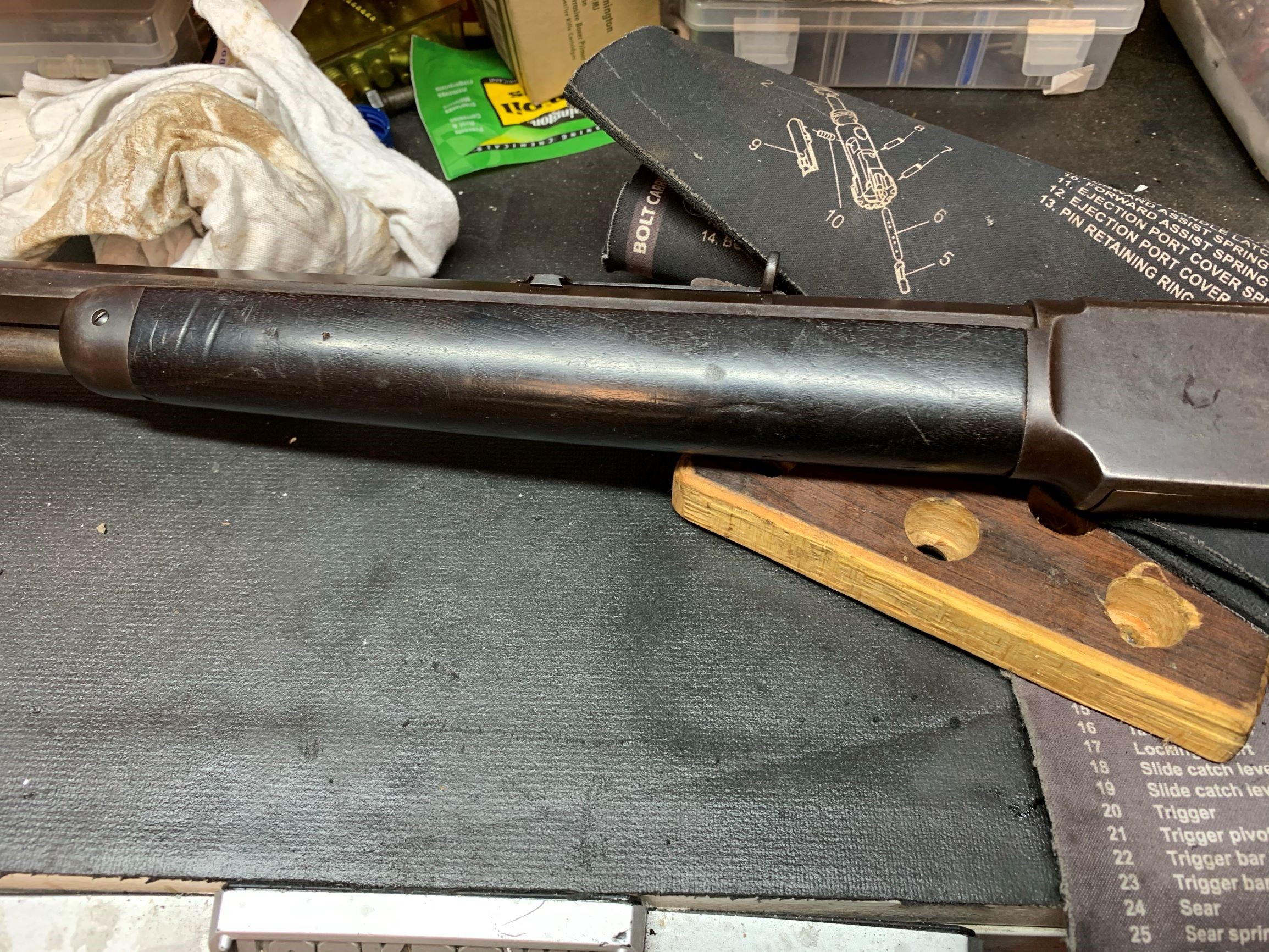

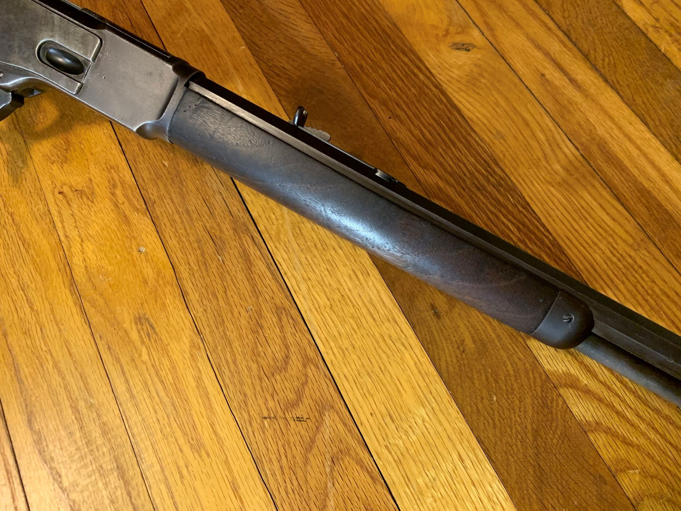

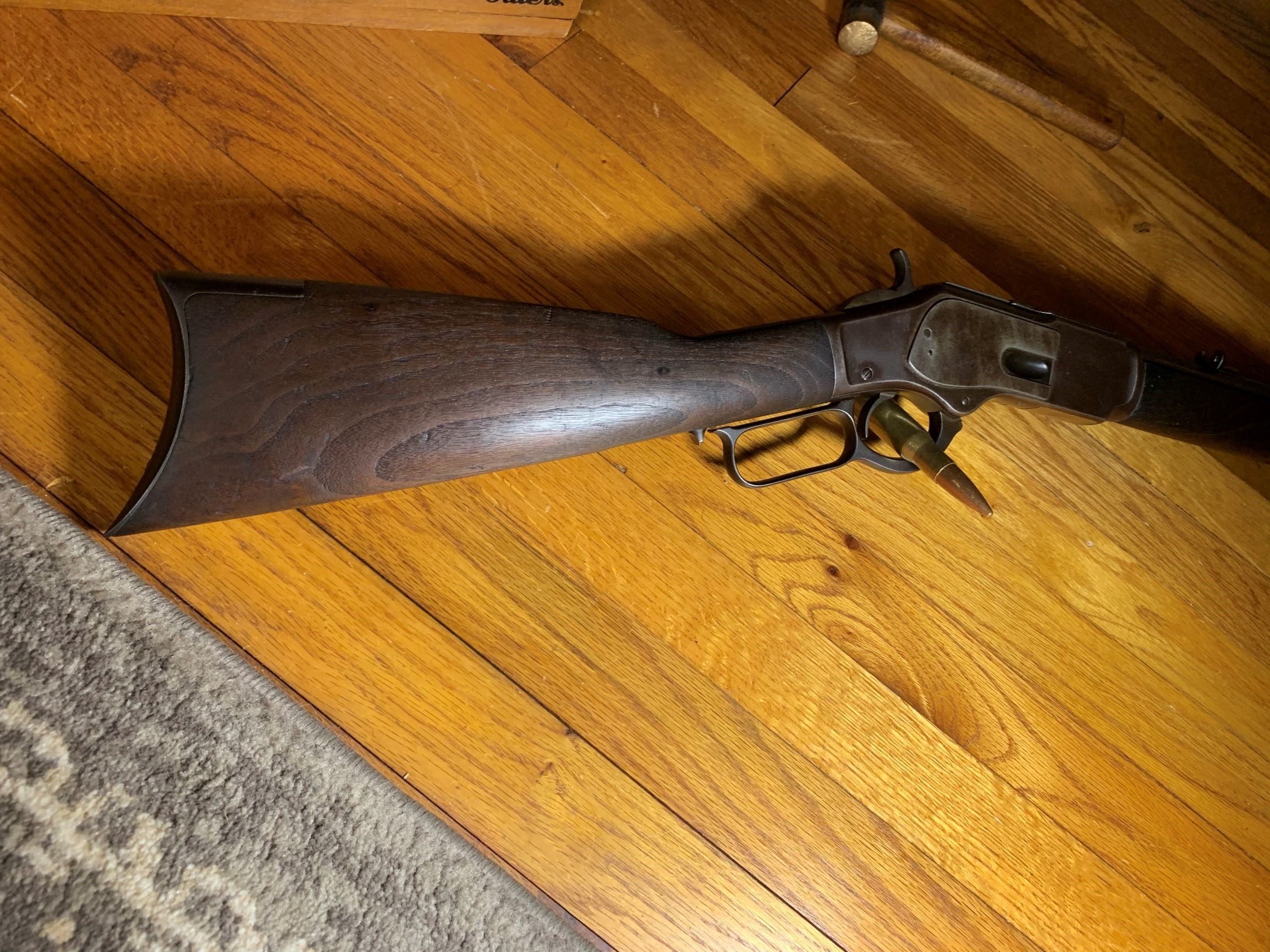

Here are the latest photos . Those are before the BLO cut with Mineral Spirits.  Here are the After Photos . The Wood Stocks seemed like it was almost sealed with something as it had a hard absorbing the BLO. It is still lacking something . I have a few types of Wax that might enhance the look of the Wood . At least the Wood Grain is Visible now as before it was almost straight Black .   The Wax  I could remove at a later time if I wanted to take another Crack at it .
I was thinking of Laquer Thinner to Clean it back when I was removing the Black but didn’t have any and it was Late at night. It is better by some anyway.
