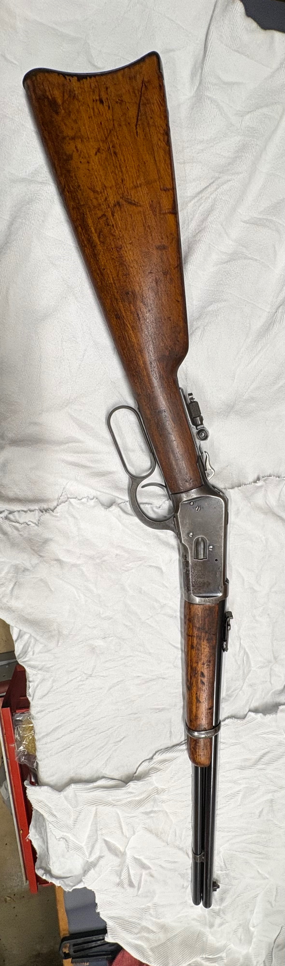

So here’s the riffle back together.  I wanted it to look more original than it did with the varnished yellow stocks.  I’ll let y’all be the judges.
Thanks for all the help!

Looks good mate. You were already up against it with the sanded stocks before you started, but you’ve done a nice job.

I’m impressed.  You’ve really come a long way with it. Congratulations.

Good job. Restoration is one thing but IMHO performing overdue maintenance is another. Wood finish of the day was not durable in anything but ideal conditions and a working gun seldom had that luxury. A bit of fresh oil now and then was just good maintenance just as we polish our old wood furniture. It will never again be original or pristine but it damn sure has character and it is down for hanging on the wall or a range trip. Enjoy!

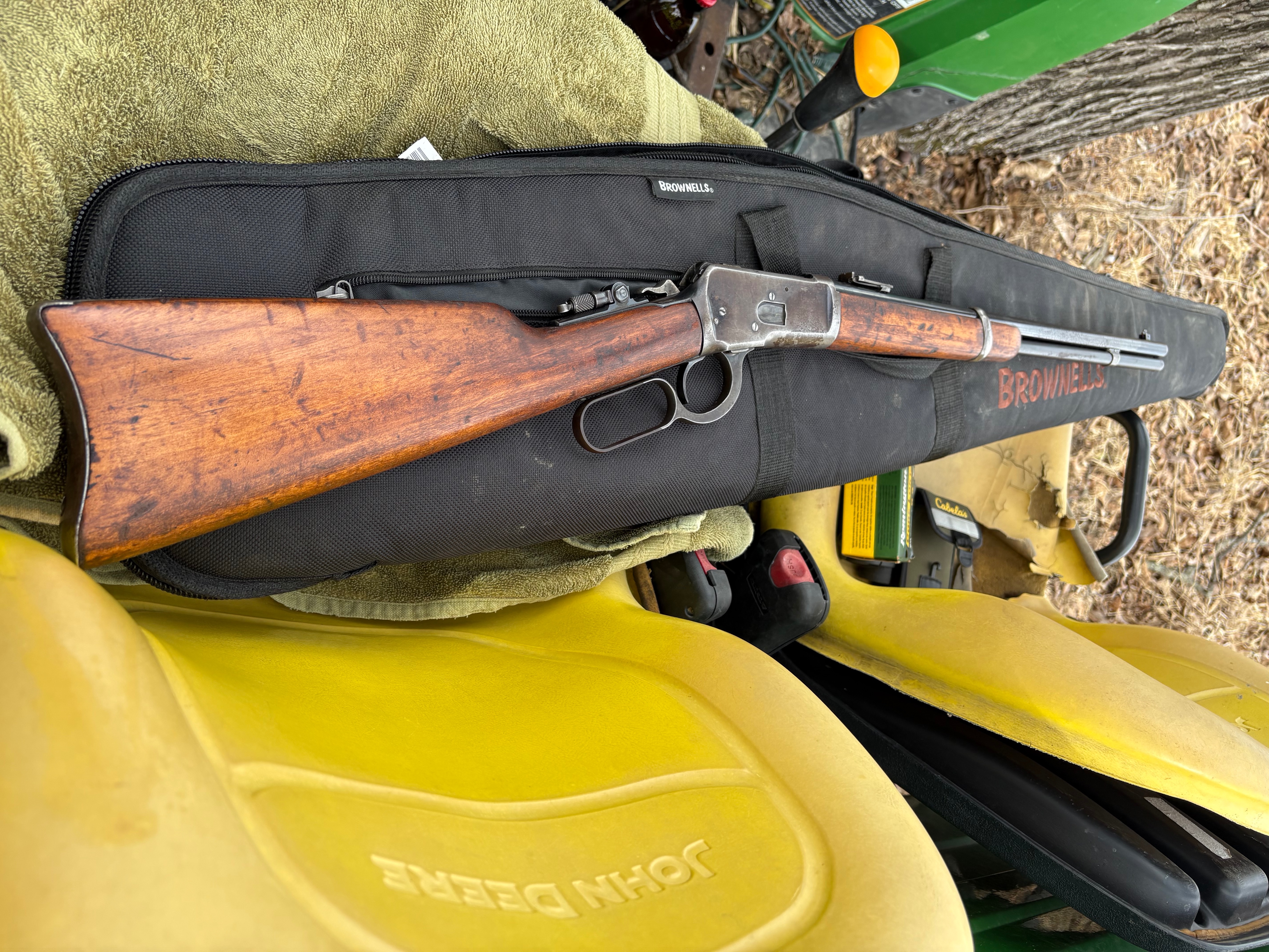

It was a little cold but I took it and shot a little.  Kept a decent group to the left.  I didn’t have a rest or anything. Mostly just a functional check at 25 yds.  I’ll sight her in when it’s nice out. I took a picture in the natural light to hopefully show the color better.  I’m really happy with it and I appreciate all the advice.

What a difference! It has some nice character to it! Great work! Smile

Concur.  It looks like it could serve the hero n a Howard Hawks Western.  Really nice restoration.
