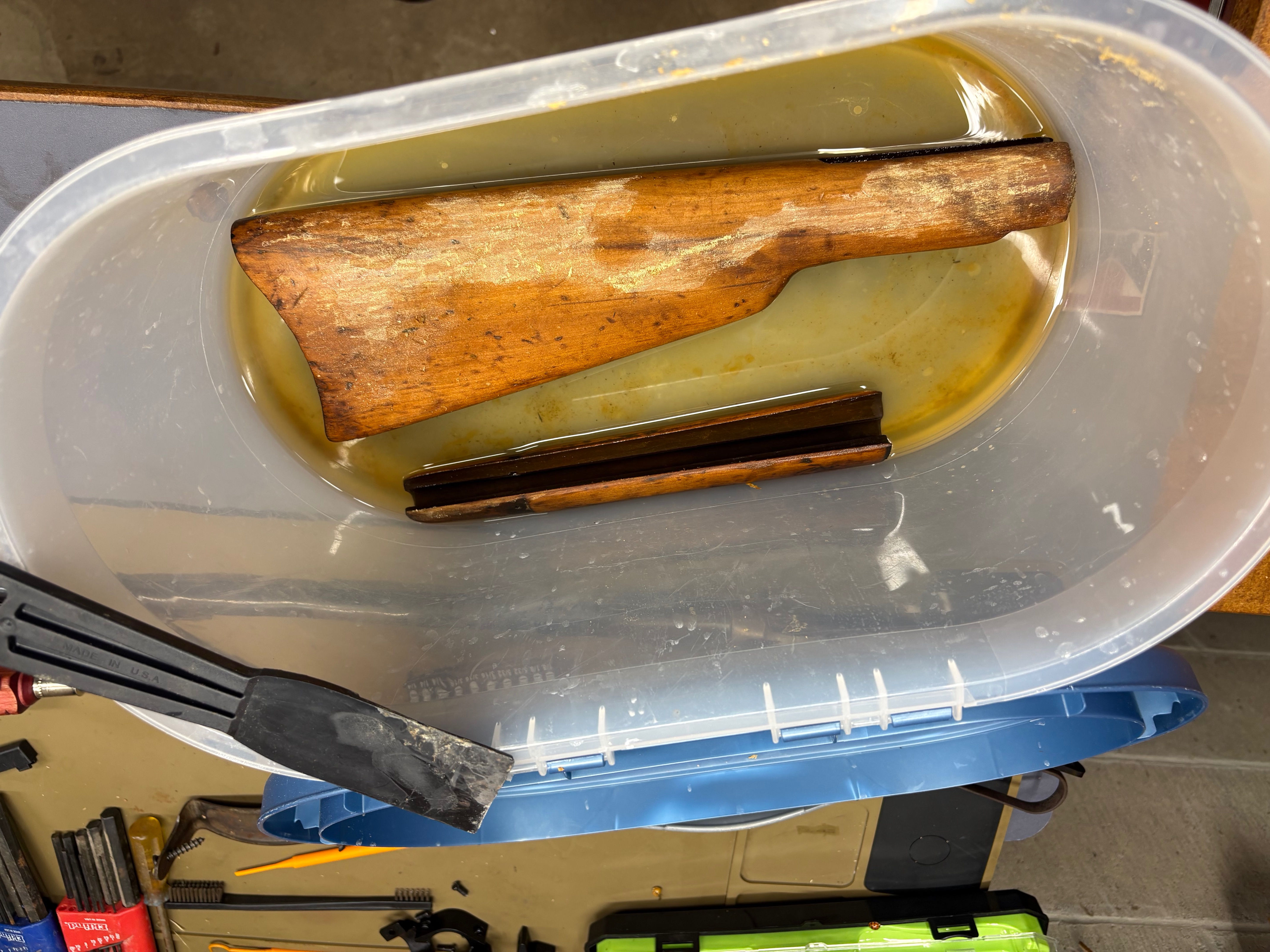

MidwestCrisis said
Should the stocks being gum wood change anything in my process. Did they receive the same finish as the walnut stocks at the factory?
Same finish.

February 18, 2026 - 12:21 am
I have acetone, I’ll try it once I have some time tonight.  All the denatured alcohol did was clean them well.  Grok told me it would be a polyurethane or other oil based varnish. That’s why I asked y’all. I’ll let you know what I find out.

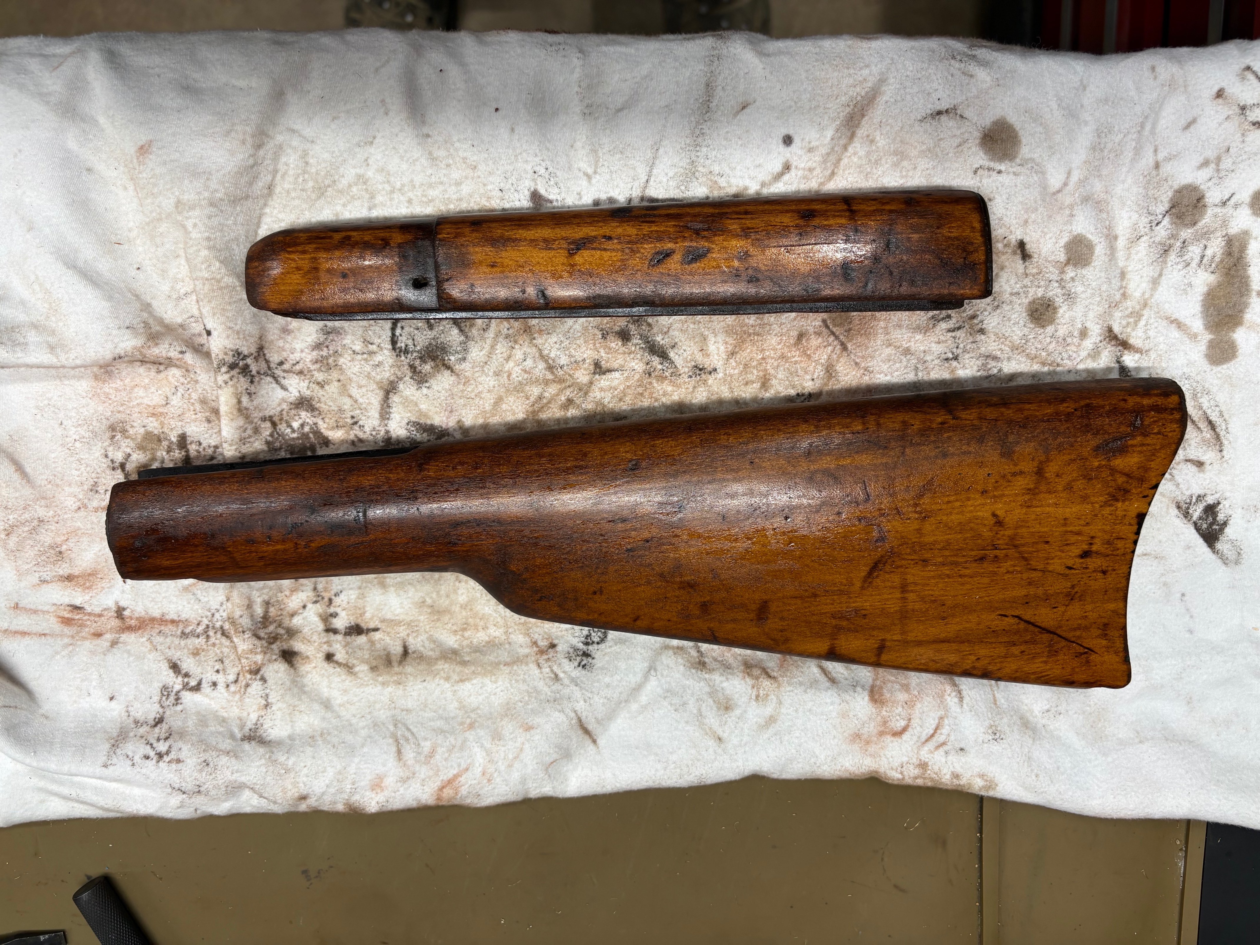

February 18, 2026 - 3:57 am
And Bert strikes again….  Acetone loosened it enough I could scratch with my fingernail,  so I used what I had and put the stocks in a bath.  Letting one side soak for a bit, then scraping it with a plastic knife, then repeat. Didn’t need to soak as long in between after the first 1/2 hour.  Once I was satisfied I wiped them down with clean acetone and clean rag.
did I find original finish color?

February 18, 2026 - 6:37 pm
Let it dry out for a day or so to let the acetone evaporate.  Don’t aggressively sand the wood.  Very light sanding at the most with 0000 steel wool or 400 grit sand paper.  The dark spots in the dents may be spot treated with more acetone and a tooth brush but don’t be surprised if you can get the black out.  If you sand the stock enough to get rid of the dents your stock won’t fit the metal anymore.  You can test a spot with boiled linseed oil to see if you like it or have to do some staining before the oil.

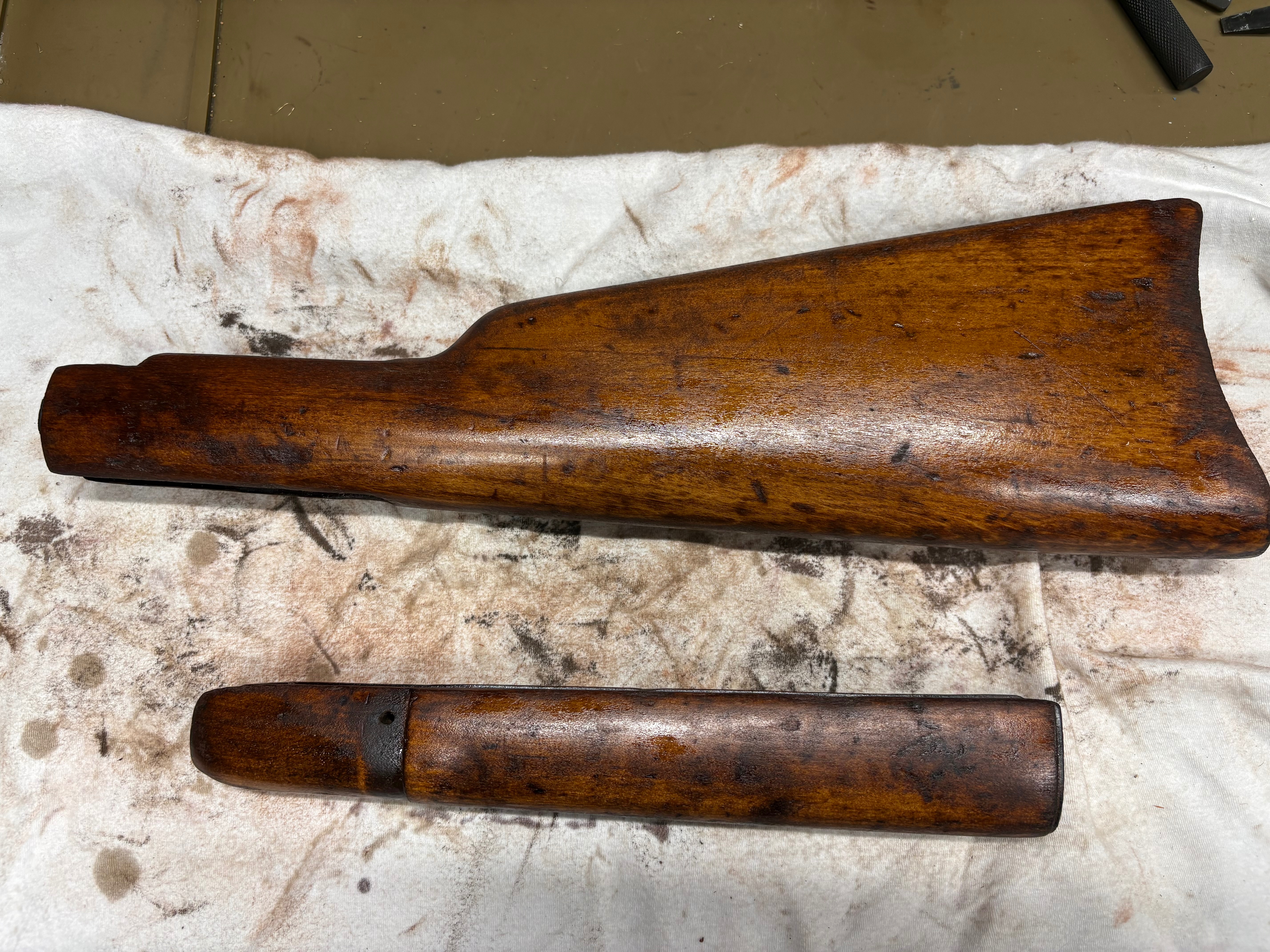

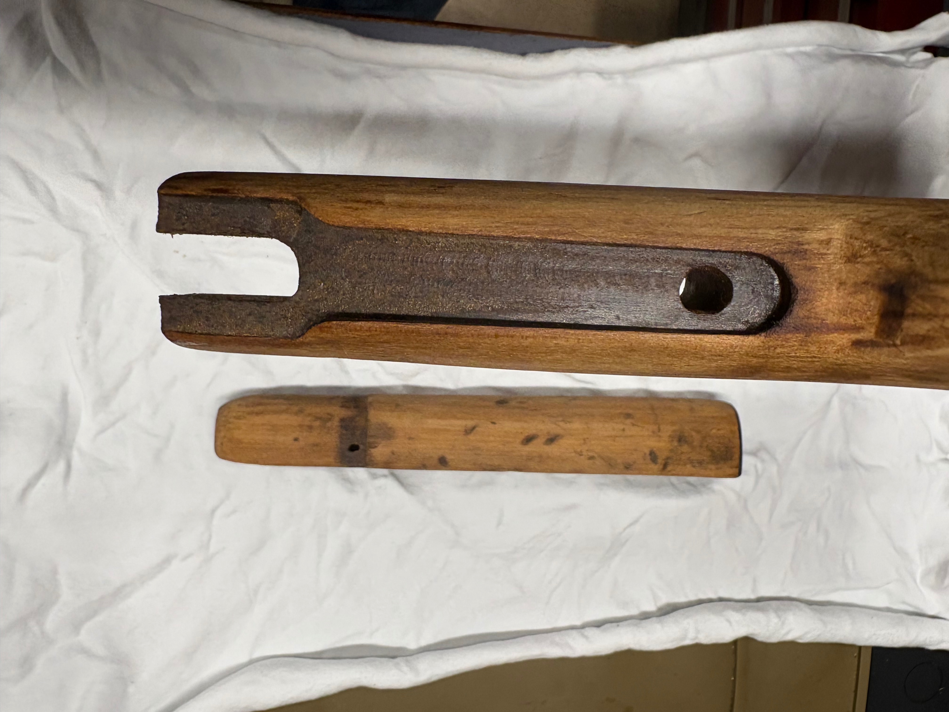

February 20, 2026 - 4:58 am
So I had already put a coat of stain on before Chuck said give it a day and we had the dent steaming conversation.  In short, the stain didn’t take well, as the latter comments said it wouldn’t.  It at least has an oil finish now instead of whatever varnish it was.  I’d like this thread to serve as guide to people like me that watch the Marks on YouTube, that half hour video takes several full days of work. You can do it yourself, in “free time” but patience is key and the videos do not contain all the details. However Mark Douglas and Mark Novak are the best videos to watch IMHO.  This place is the best place for information, my lack of patience was my issue.  Not to be forlorn. I can always do it again with these stocks as they had been abused by a previous custodian.  Never give up.

February 20, 2026 - 5:28 am
The stain took closer to the metal fit points, that should help hide the previous over sanding.  It also highlights every imperfection.   Right now the stocks are still soaking up the boiled linseed oil.  I’m not unhappy with the stocks. Wish I would’ve exercised a little more patience.

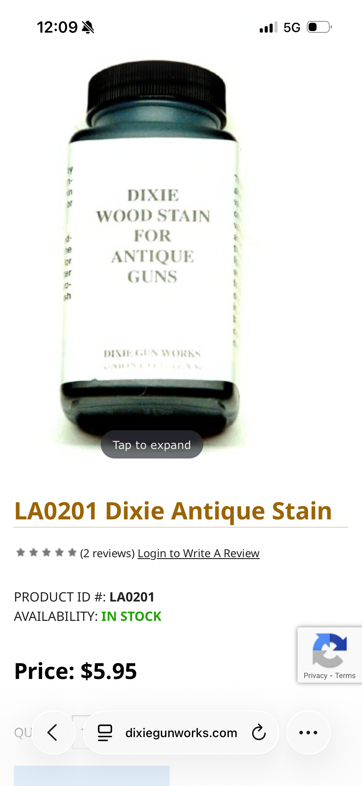

OK, let me add something that might allow you to salvage the finishing without having to redo it all again.  Dixie Gun Works (IF they still exist!) USED to have a solvent based stain for military rifles.  Tended to be a bit on the red side, but it would penetrate BLO and go into the wood to some extent and allow for more coats of BLO.  It will tend to wipe off a bit as new coats are added, but then you can also add more of the solvent based stain as you go.  I would assume a query will confirm if Dixie is still going and if they still ahve the solvent based stain.  Patience is so important to so many things in life, but there can be ways to overcome the lack thereof at a few times.  Tim
This?

Forum Posts: 1151
38
February 20, 2026 - 6:22 pm
Can’t say for sure.  Its been a LOT of years since I used what I had on a bolt action military rifle.  I DON’T see any mention of “solvent based” on the face of the bottle label.  Maybe on the back or in the instructions or ads for it?  Price is not out of line by any means.  I used to buy Dixie products for military rifles, etc, but that was when Kirk—– was still alive and running Dixie.  Tim
