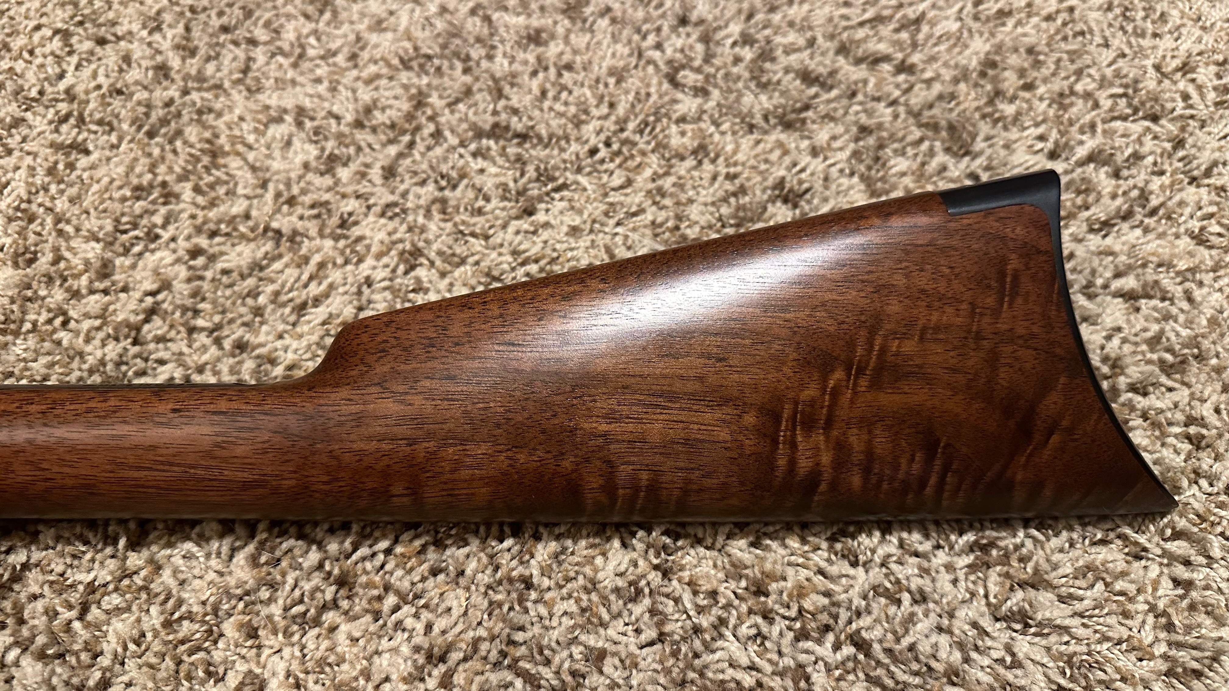

I can also vouch for Precison Gun stocks.  I’ve bought 5 from them so far.  All very nice.  They don’t do anything but what’s listed (nothing custom or special wood) but what they do have has been more than acceptable.  Pics attached of an 1890….got lucky as this is a stunner!
I’ve also used Gunville stocks before and they’ve been very good ONCE I got the product (about six months.). There was also about the last 6-8 months where I couldn’t get anyone to return my calls or messages.  However, about a week ago someone from Gunville called me and let me know they’ve got new people and more staff and should be responding quicker and getting product to me quicker as well.  They’ve been very responsive since that time.
But both of these require finishing even on the inletting, which is what you want in order to get a good fit.  Gunville leaves quite a bit more to finish off – like you need a file or other quick removal to get down to final size whereas Precison doesn’t leave much at all (plenty, but goes quick enough with just sandpaper.)
