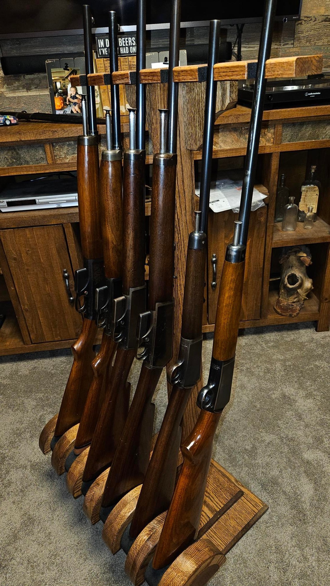

I have all the calibers and all but the .32 shoot fine. I am currently in the process of replacing springs and dampeners.

Very nice CoolHowever, I see that you are missing a Model 1911 to round out the complete T.C. Johnson S.L. collection.

I’m always looking Bert,
the opportunity has not presented yet. I tend to be more mindful of condition recently and apparently the shotguns received heavier use.
Also as I age I’m more aware of any firearm tagged as “The Widow Maker”.😃
