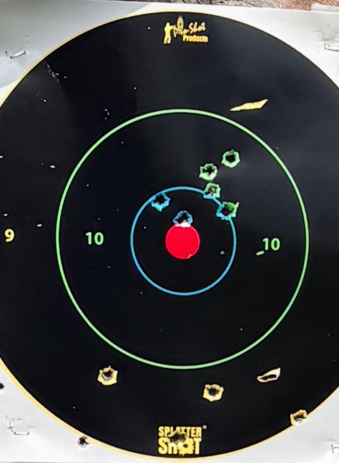

Well my targets are a little too embarrassing to show but I was able to get some good groups.  I noticed last night that the front sight was a little loose in the dovetail so I super glued a .001 shim to the bottom and drove it back in with blue loc-tite. I was hitting where I was aiming once I figured out the correct sight picture.  At my 130 yd steel I was hitting low, but I did ring it a couple times.  My stock repair held up. So now I’ll see if I can get the butt stock to match
The Winchester S.L. Rifles are not known for target grade accuracy… 2″ groups @ 50-yards are superb.

Well that makes feel better.  I couldn’t see my hits at 35 yards. I shot a group, then tried a 6 o clock hold.  That’s the low ones.  Then I checked the target and shot the two that look good.  Then I threw $50 at the 130yd steel.

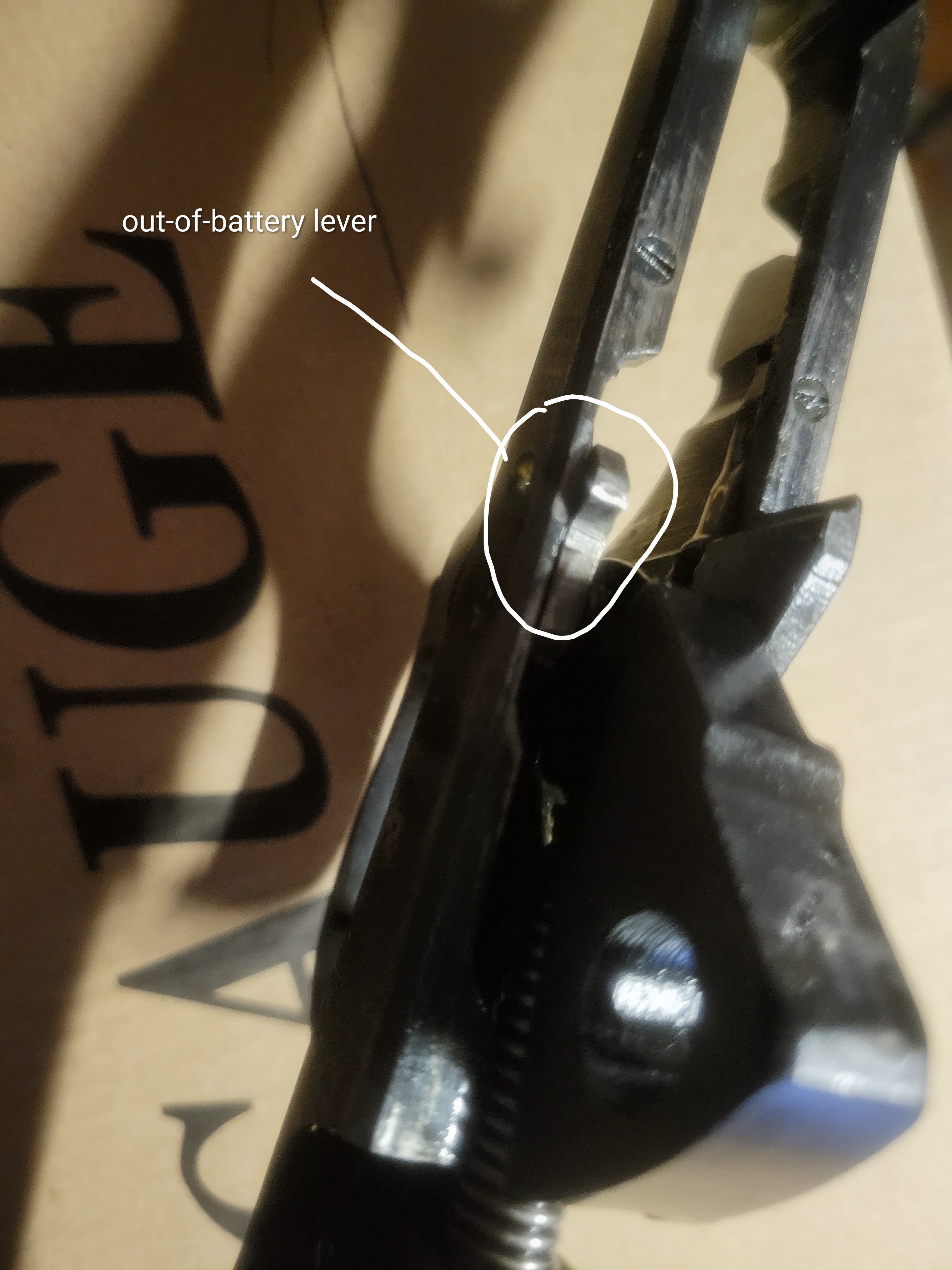

An update.  At the range, the 07 trigger locked up and would not fire any of several chambered live rounds, as if the crossbolt safety had been engaged.  The same as had happened at the previous range session. Despite “firing” any number of dummy rounds made from fired brass out of the same box, at home. These dummies were carefully made with a Redding 3-die set and measured by dial indicator to be within both SAAMI dimensions and as identical to the vintage factory rounds as I could make them.
The trigger assembly of the 07 is a reliable design and is used almost intact in both the .30 M1 Carbine and the Model 50/59 shotgun. However, it has a very slight amount of takeup creep. More significantly for our investigation, the trigger does not move at all – no creep – when the crossbolt safety is engaged.
At the range, when the trigger is pulled on a live round, the trigger does not move. There is no takeup creep. At home, when the trigger is pulled on a dummy round, the trigger takes up very slightly and then “fires” the dummy with an audible firing pin strike on the dead primer.
The firing pin assembly is not blocked, as can be verified by other means as well. It is the trigger stroke alone that is blocked and there are only two things that can block it:
1. Manual engagement of the crossbolt safety by pushing the button in the trigger guard.
2. Automatic engagement of the crossbolt safety by the “out of battery” lever:  the spring loaded lever installed in the left wall of the lower receiver,  directly over and connected to the crossbolt safety. Under spring pressure this lever is held vertically at full extension and the trigger is blocked. At full extension this lever rides along the bottom of the breech bolt. There is a bulge or block at very end of the bolt, such that when the bolt is in full battery the lever is depressed, unlocking the trigger stroke.
The rim thickness dimensions of the live and dummy rounds are virtually identical. Both seat fully in the chamber, as can be confirmed visually. The live rounds are Western factory. Insufficient headspace is not an issue.
The most likely reason the trigger is blocked at the range is the failure of the bolt safety lever to be fully depressed, for some reason.
At the range,  I failed to bring the set of dummy cartridges, to try after the live rounds would not fire.  That would have probably revealed cartridge dimensions aren’t the problem.
I carried the 07 to the range disassembled in a Boyt takedown case. This particular 07 has never been taken down very much and all the steel edges are sharp and unworn. If not lubricated, the upper and lower receiver are difficult to manipulate into position and close fully. The takedown bolt requires a screwdriver to firmly close the two halves.
I now believe the lower receiver can be installed with enough of a barely noticeable gap that the bolt safety lever is not fully depressed.   The lever is on the lower receiver, along with rest of the fire control mechanism. The breech bolt is in the upper receiver.
When I came home from the range, it was a couple of days before I cleaned and reassembled the gun. Before I did so, I decided to “season” all the internal steel with BreakFree CLP, to impregnate the pores and make a slick, molecular-level bond. It has made assembly and functioning significantly easier. Of course, after I assembled it and tightened the takedown bolt with a Brownell MagnaTip, it shucked and “fired” dummies without issue. Repeatedly.
The most likely cause of the trigger lockup is that the internal, spring loaded, bolt-out-of-battery safety lever mounted in the left wall of the lower receiver is not being fully depressed. I can prove or disprove my theory just by bringing dummies and live ammo to the range. “Firing” a dummy and then loading a live round. What I should have done before.

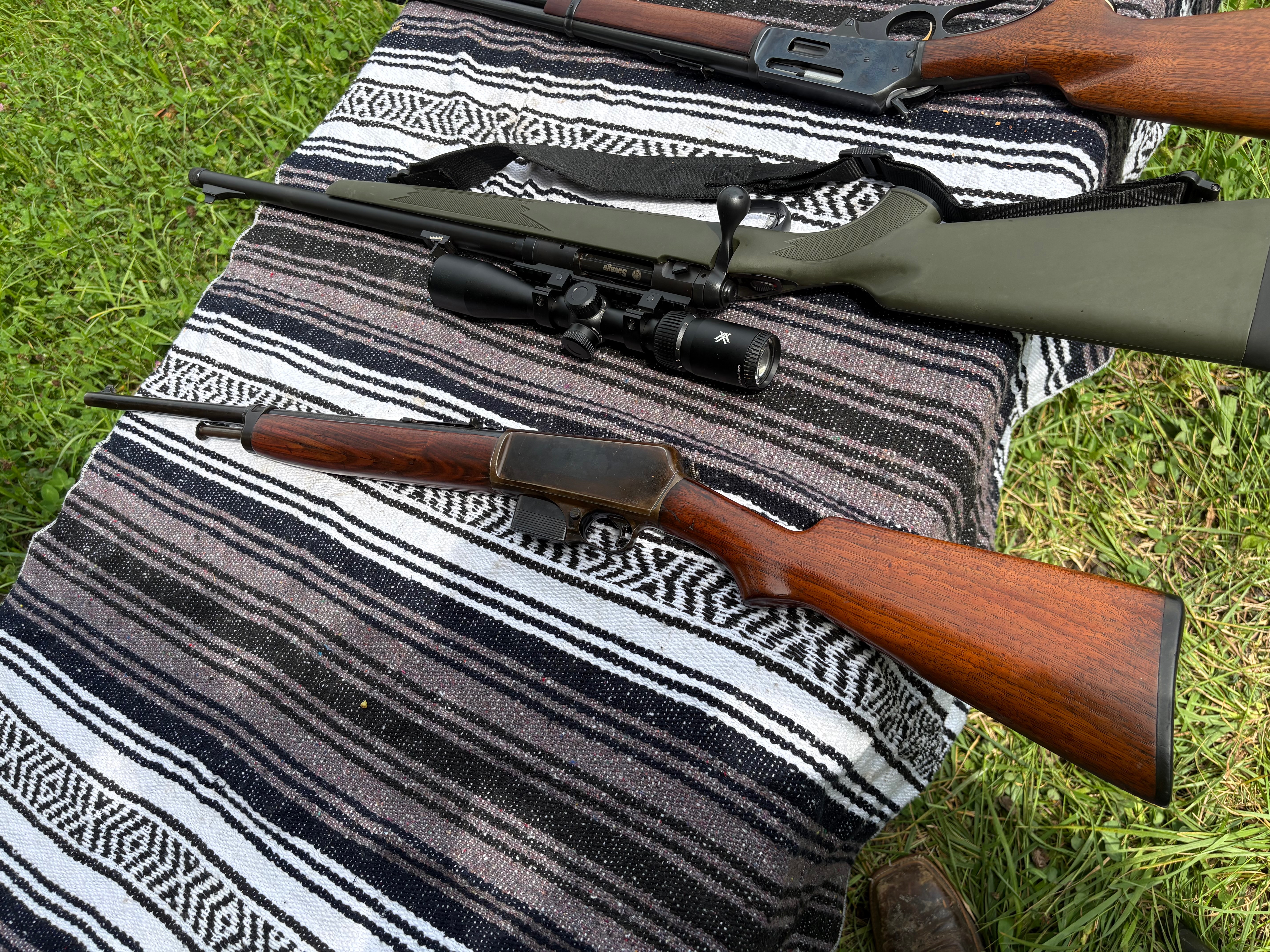

Here is my rifle after finishing the stocks together.  To recap, my rifle had no usable buffer washer left.  The fore stock was almost in 3 pieces.  Both stocks had extra varnish of some sort on them.  I repaired the fore stock and replaced the buffer, shot it to check function then refinished the stocks. I believe the fore stock is heart wood and butt stock closer to sap wood.  Zebulon’s School of Woodworking helped me through the process.  The goal was to make it look like it should.

Good job, Adam! Functionality restored, improper finish replaced, character retained. I think your goal was achieved.
