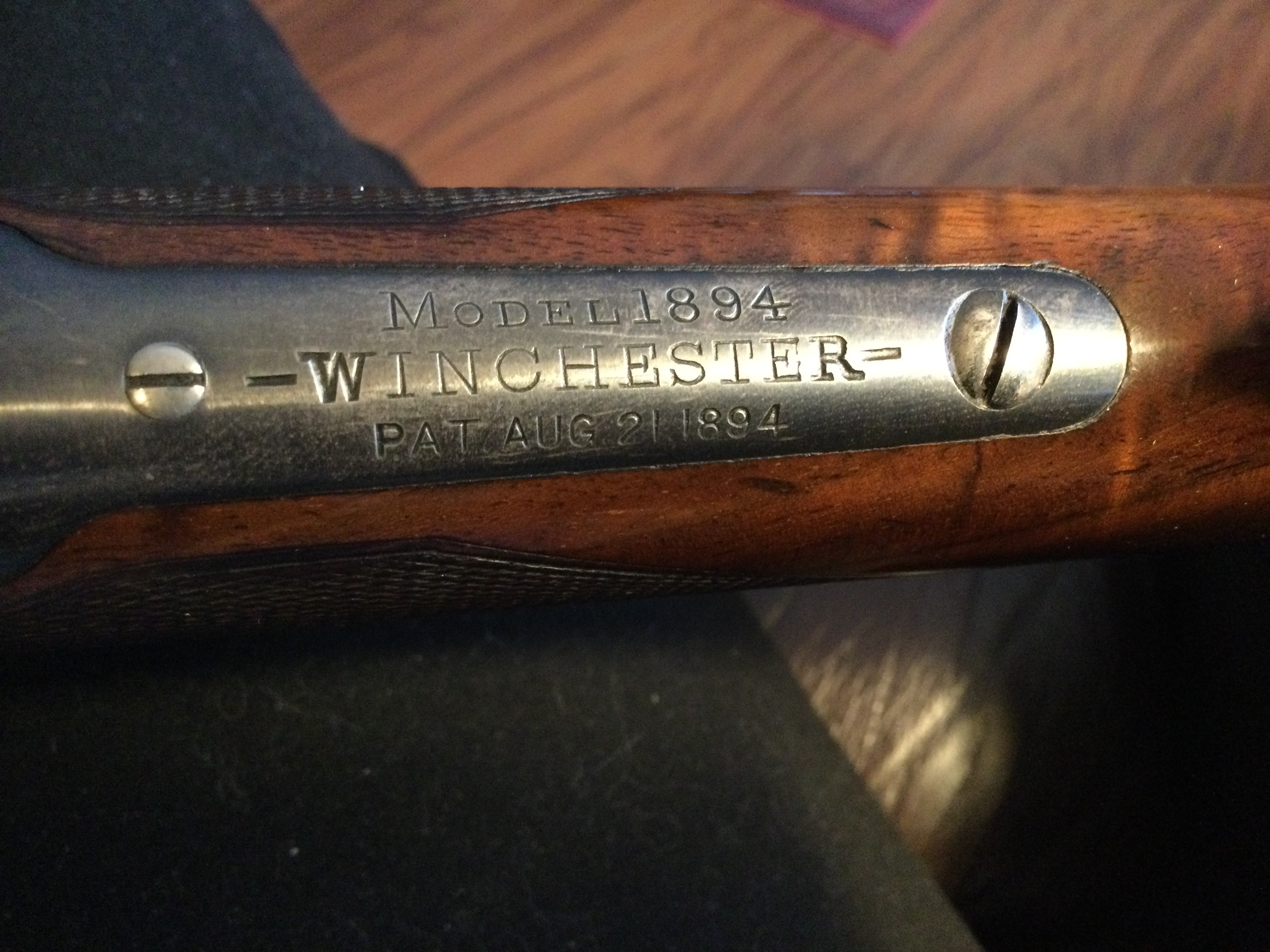

I was perusing GB today and came across this 1894 that seems odd? The serial number indicates is from 1902. But the tang markings aren’t correct for 1902, and the serial number is also stamped in front of the trigger in addition to it’s normal placement. That seems odd to me too, I haven’t seen that before.
Wheat do you all think?

The original serial number has been removed and re-stamped with a bogus fraudulent serial number.  Stay away from this one.

Matt – you are correct about the upper tang – it should look like the photo below. Look at how poor the wood to metal fit around the upper tang is on the Gun Broker gun – this is a parts gun – Winchester did not make guns with fit & finish like that – run away – be careful – these guns are everywhere.

Yes sir Burt, I noticed the tang immediately, and then the serial number. I consulted my Renneberg book just to be 100% certain and it confirmed it. This one isn’t even doing a good job of trying to hide the fact that it’s misrepresented, but it’s good for my education for sure! I’m leary of the ones I may not be able to spot!

Illegally altered serial number. The barrel marking and upper tang marking indicate a late 1920s production rifle. The date stamped on the bottom of the barrel would tell “the rest of the story” in the immortal words of Paul Harvey. It is most Definitely NOT an “antique”, even if the serial number was original.
