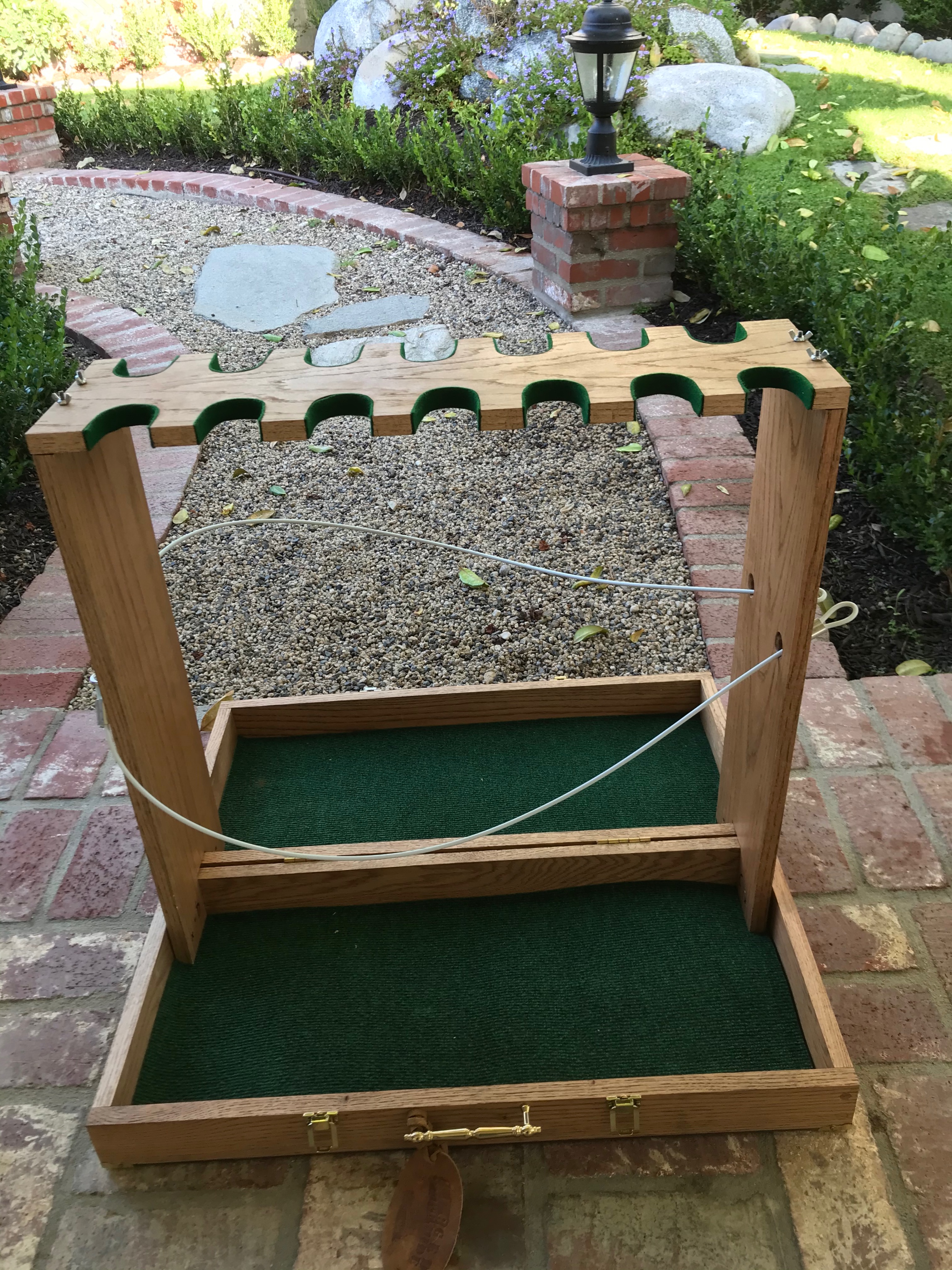

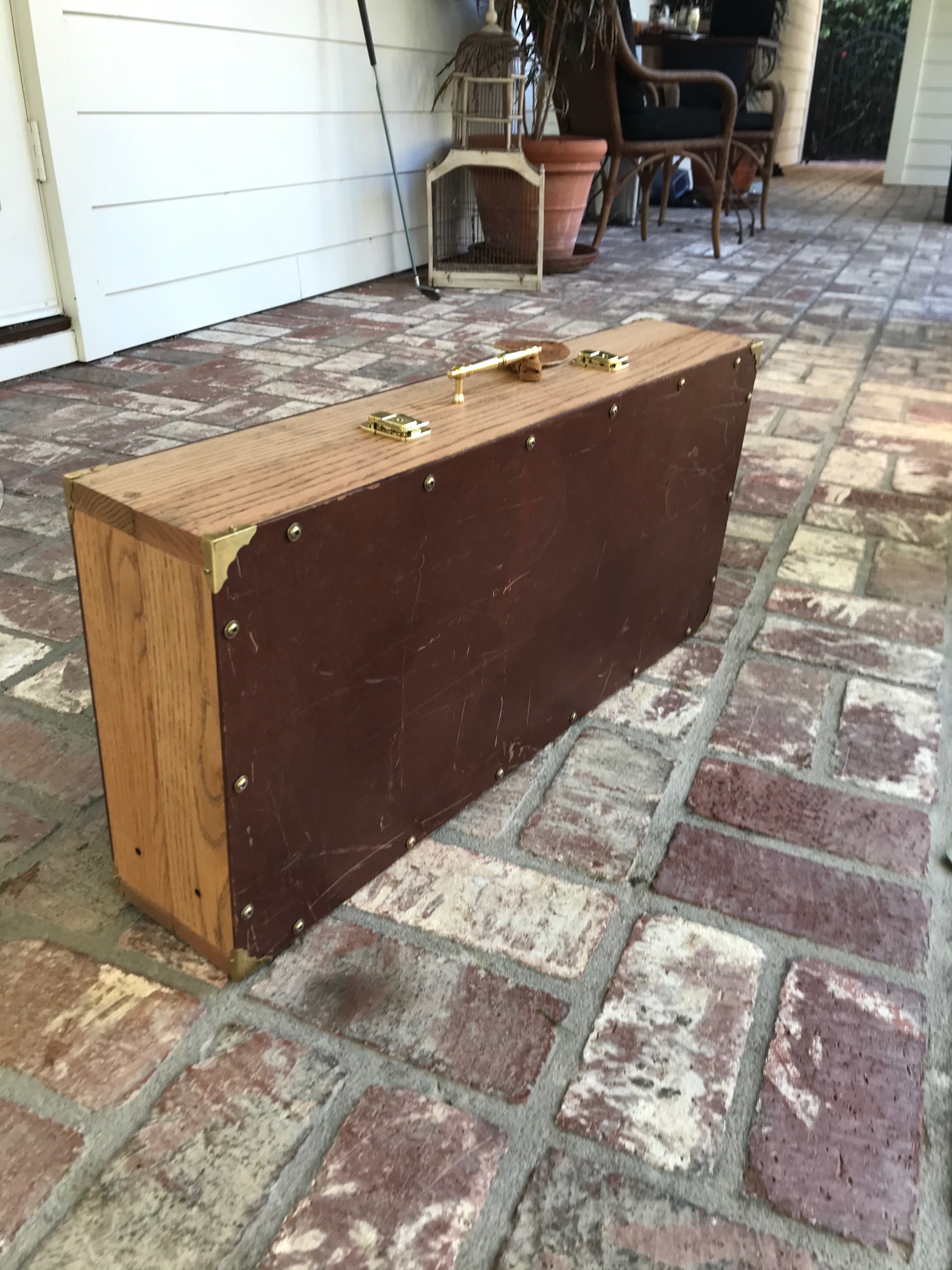

Bill,
I’m going to be at the upcoming Reno Show and have two “suitcase” style cases that open up and have 6 -8 slots per side for upright guns. They fit on the 8’ show tables perfectly. Just screw in a couple wing nuts to affix a top bar. The shape is like an upside down “V”. They have a cable that can or cannot be used to run through the levers and connect to the other end, where a paddle lock can be attached. Easy to pack & carry, and are well made. If interested, email me at [email protected]

Blueliner said
Bill,
Bill
46555729-533E-49C4-BC09-AAC09448161C.jpeg1A881FCF-0801-4782-9E0E-5E945B4AEF6F.jpeg79AB56EF-7163-42B8-8239-C5C5B6420417.jpeg23DE0C93-5F8F-4133-A7C1-CE03B7A7A4F5.jpeg2CF75C37-A297-4AEC-B387-E0FAA3DCDD3A.jpeg28 1/2” x 13” x 5 1/2”. 23#
