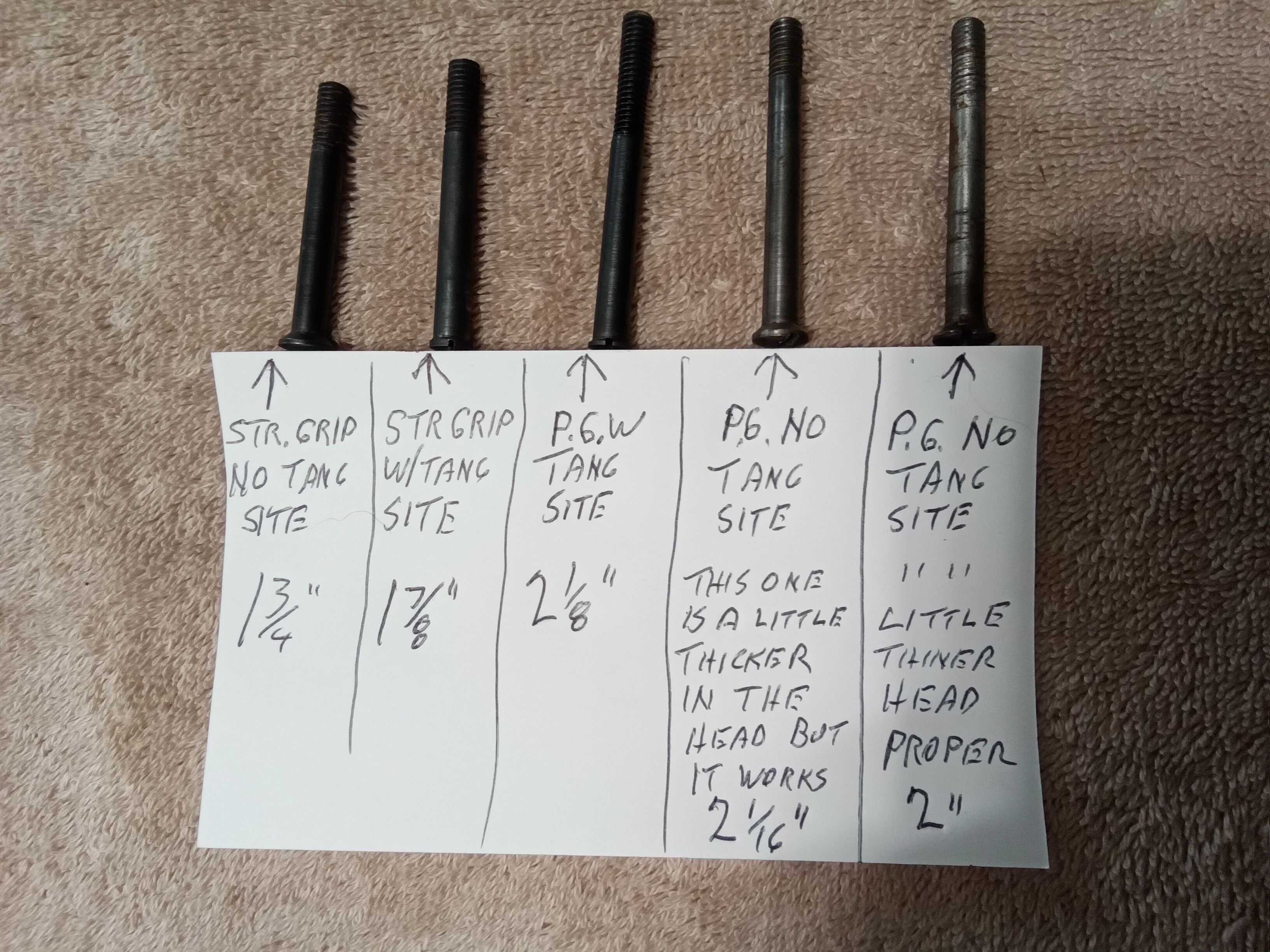

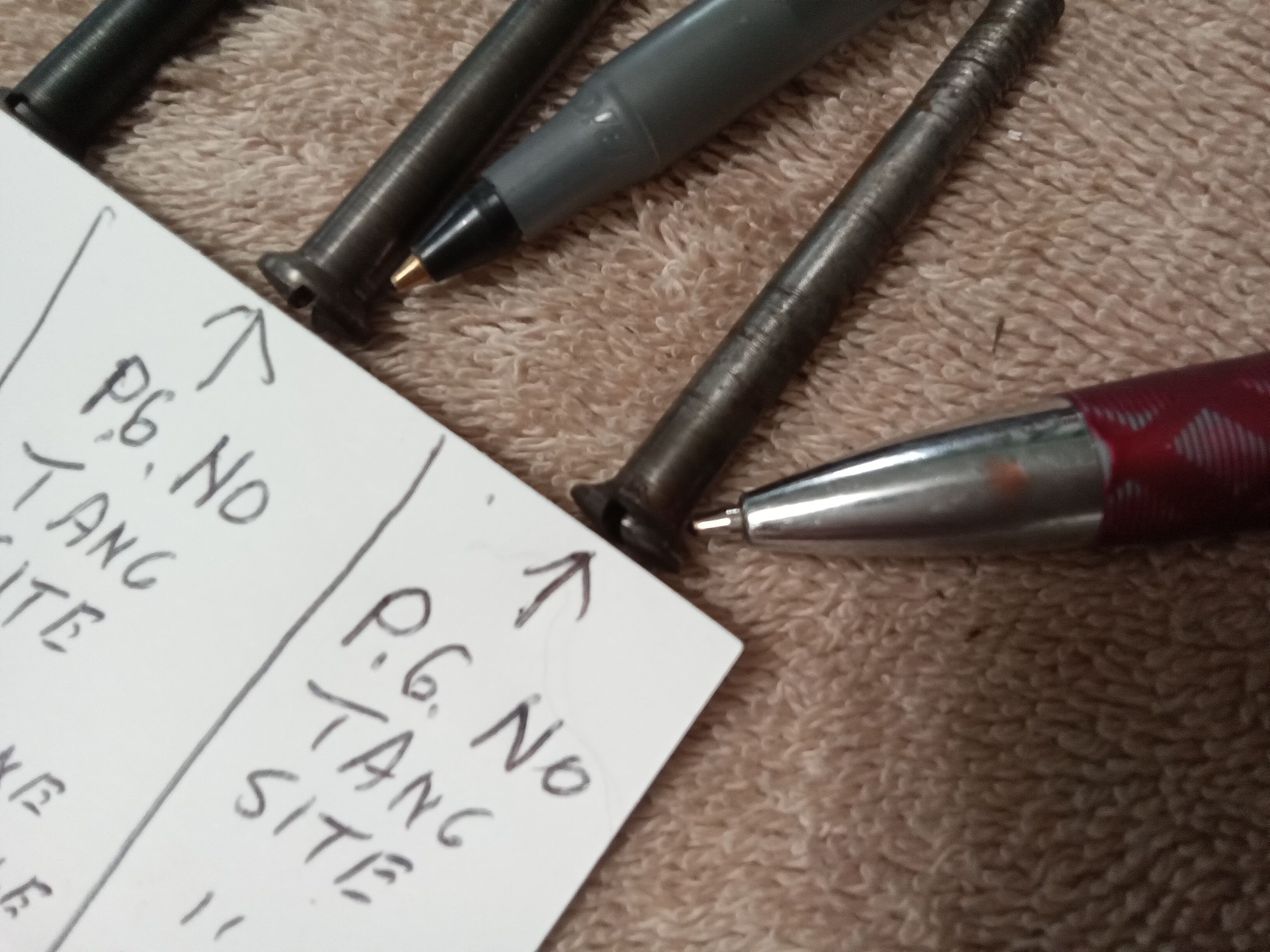

Forum Posts: 1601
February 27, 2024 - 4:46 pm
Here Ya’ go, the one on the far right is the one You want.  20240227_114131.jpg20240227_114058.jpg  Hope this helps.  Unfortunatly I don’t have a spare to part with.
