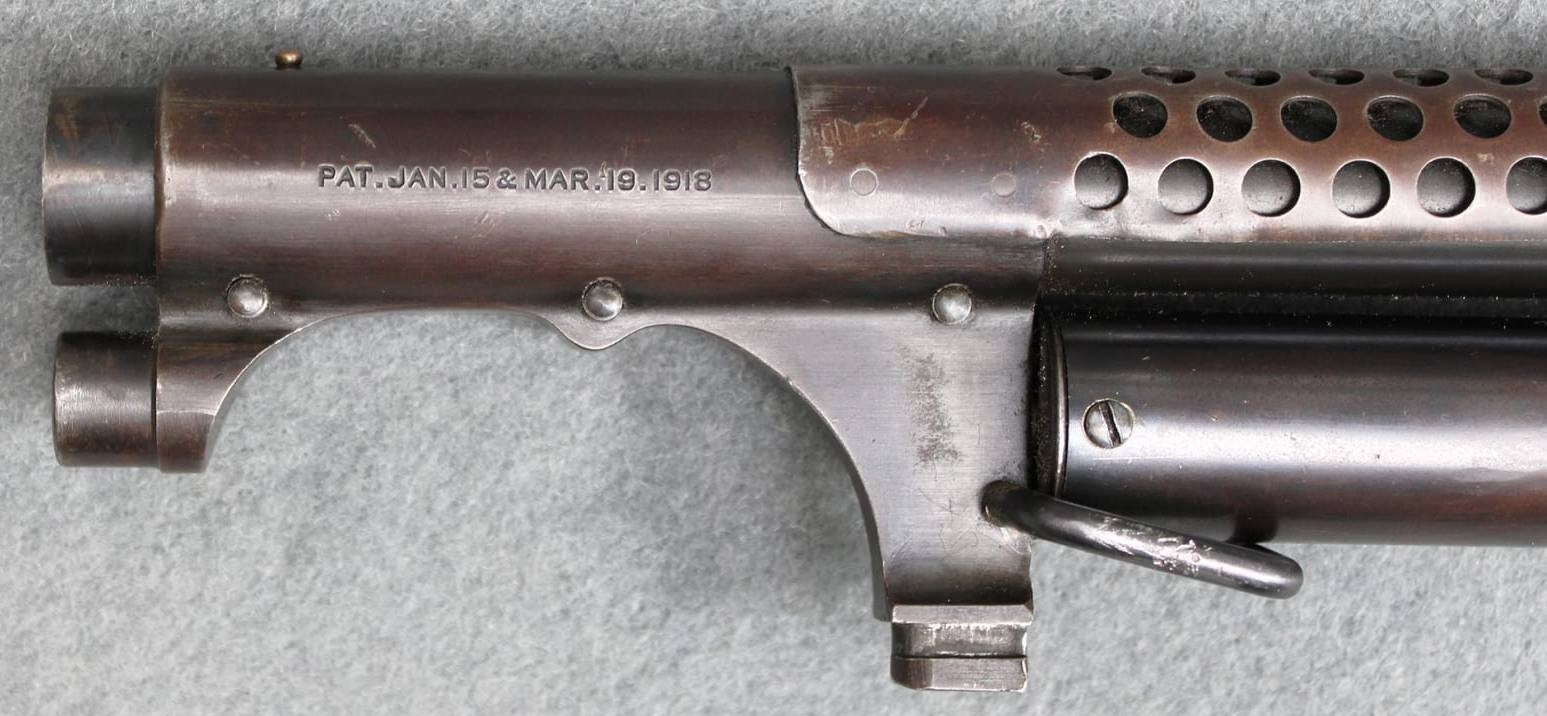

Yes, very greedy or more likely they decided to jack up the shipping cost to increase the profit margin on that gun.
Speaking of that gun, it is not an authentic WW I Trench Gun.  Per the serialization records, it was manufactured in mid September 1920… almost a full year after WW I ended.  Further, the heat shield on it is suspect.  It should be marked as shown in the attached picture.  The “PAT APL FOR” marking is only found on the very early WW I production Trench Guns.  Well before WW I production ended, the heat shields were all marked “PAT.JAN.15 & MAR.19.1918“.

Thanks Bert, they covered themselves by saying it was in the ordnance “pipeline” when the war ended. A little auction house artistry no doubt. It is for my daughter as she asked me for one awhile back. I kept losing out at auction with everyone I bid on going for over 6k until this one. I was pleased to get it for the $3,450 but I guess we now know why. Hopefully still not a bad price and the added benefit of it will be protecting her home! Once it comes in I will look at the heat shield and report back. Fingers crossed. Appreciate the feedback!

Bert your suspicions were verified. The Gunsmith at the FFL verified the heat shield does not match the rifle and believes this is just a standard 97 someone has modified to appear to be a Trench Gun. If I had bought it for anything other than home defense for my daughter I might be inclined to complain but think it is  still acceptable for my purposes. Appreciate your catching this for me though!
