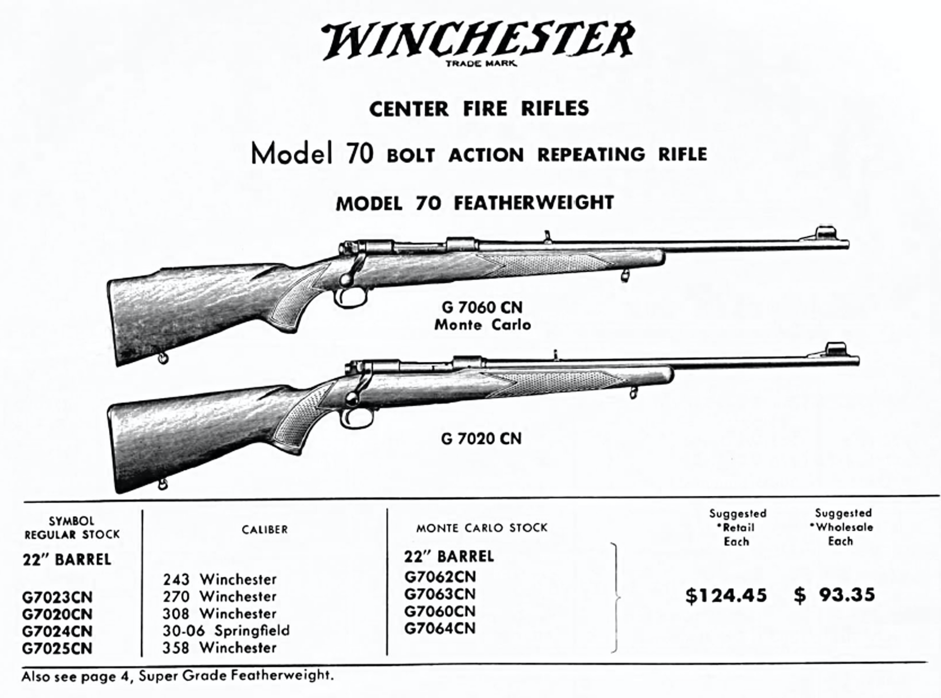

Hi Timmy-
Below is a clip from the December 1955 Winchester catalog showing the calibers and stock styles available at the time.
As Zeb said, from 1952-1955 the Featherweight was only available in 308 WIN with either low comb or Monte Carlo stock.  The caliber offerings expanded in 1955.  None of these rifles came with a factory-installed recoil pad.  Butt plates were originally aluminum but were replaced by plastic in 1958-1959.  The “Featherweight-Westerner” in 264 WIN MAGNUM was only cataloged in 1963 (most were made in 1962) and featured a factory-installed ventilated recoil pad.

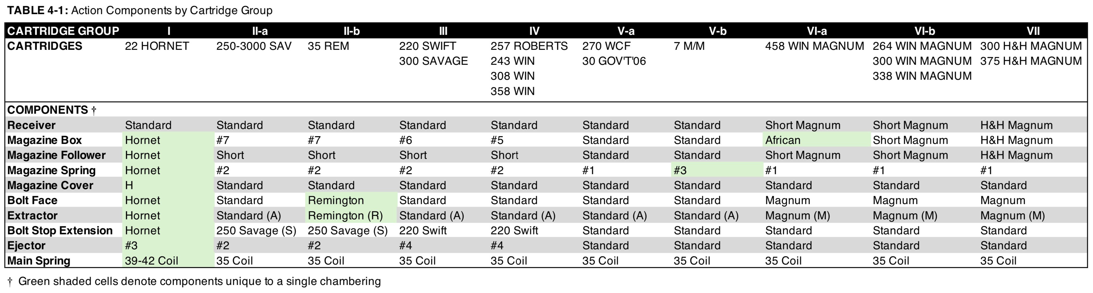

Lou, other than the bolt stop and magazine box – forgot to mention the follower – were any other parts for the Featherweight  dependent on cartridge length?
Forum Posts: 1525
July 20, 2026 - 5:26 pm
Hi Zeb-
Look at the Table below, which gives the action components by Chambering.  You may need to consult your copy of Rule’s book for pictures.  Since the FWT was chambered for Standard length (270 WIN, 30-06), Short (243 WIN, 308 WIN, 358 WIN), and Short Magnum (264 WIN MAGNUM) cartridges, they were built with internal components adapted to Cartridge Groups IV, Va or VIb depending on chambering.
The defining characteristics of the Featherweight were the barrel contour, stock, and aluminum components.  The other action parts were determined by Caliber, not Style.

Lou,
It makes most things clear and is a very  useful document.
I recall the late Townsend Whelen opining that owners of a Model 70 chambered for the 257 Roberts would do well to replace the bolt stop, magazine box,  follower and possibly the ejector to allow the rifle to function with the longer spitzer bullets the Roberts needed to perform well.
I note the Roberts was furnished with the “220 Swift” ejector whereas the 7mm Mauser got the “Standard” ejector.
I’m not sure why the short cartridge group would need an ejector designed to cope with a semi-rimmed case but assume the reason had more to do with the length of the Lee Navy case than rim and groove details.
But the Roberts is based on the 7mm Mauser case, for which a Standard ejector is furnished.
Curiouser and Curiouser but I guess they did what actually worked.
Forum Posts: 1525
July 20, 2026 - 8:19 pm
Zeb-
I personally agree with Whelen, as did quite a few owners of Model 70s in 257 ROBERTS back in the day.  It is not uncommon to find M70s in Roberts whose magazine box, follower, spring, extractor collar/bolt stop extension, and ejector were replaced with the Group V-a (standard) parts to permit loading longer spitzer bullets without seating them well into the case.
The only difference between the 7 M/M (V-b) and Standard (V-a) action is the magazine spring, which on the 7 M/M was given a slightly different “set” when hardened.  I presume this had something to do with the body taper of the 7x57mm case.  The springs were identical (made from the same part) before hardening.
On both the Swift (Group III) and Roberts (Group IV), the #4 ejector went with the “Swift” extractor collar/BSE.  The ejector was necessarily longer than Standard to adjust for the shorter bolt throw caused by the BSE.  It has nothing to do with Swift being a semi-rimmed case, just the bolt throw.  The slanted partitions in the #6 (Swift) versus #5 (Roberts) magazine box dealt with the semi-rimmed issue while using the same “Short” follower and magazine spring.  Swift, Roberts, and the 308 Winchester based cartridges all used the Standard extractor b/c they have the same case head diameter.
