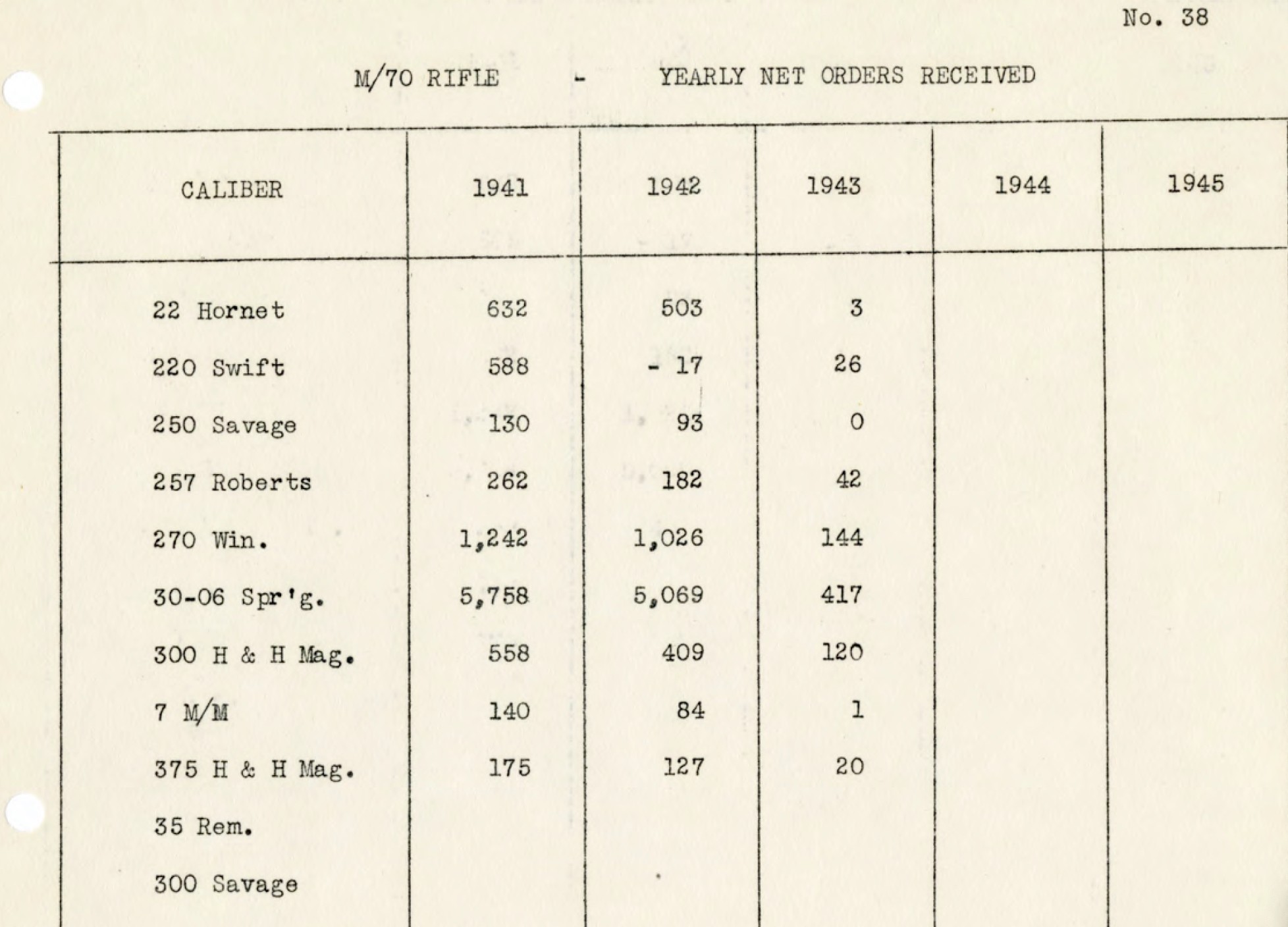

Pre War production on the Model 70 is interesting.  For example I have a .220 Swift National Match gun.  The seial number is 53255.  Jesse Bennett did a search for me stating that the SN was aplied on 10-10-1942.  The barrel date is also 1942.  But, I have a feeling that the rifle was put together after the War.  The National Match stock is from the Transition era, it has a type two safety. With the Pre War receiver.  The reciever has the clip feeding cut out, and has one hole for a scope mount in front of the clip feeding cut out.  Has the 48 WB peep sight  with the Lyman Adjustable front site globe.  The gun also features the correct scope blocks.  With what appears to be the original sling that came with the rifle.  So, all in all the gun looks correct.  But like a Super Grade Carbine it will be suspect.  Louis, it is written that they only made 17 .220 Swifts in 1942.  Would this rifle be included if it was not completed until after the War?

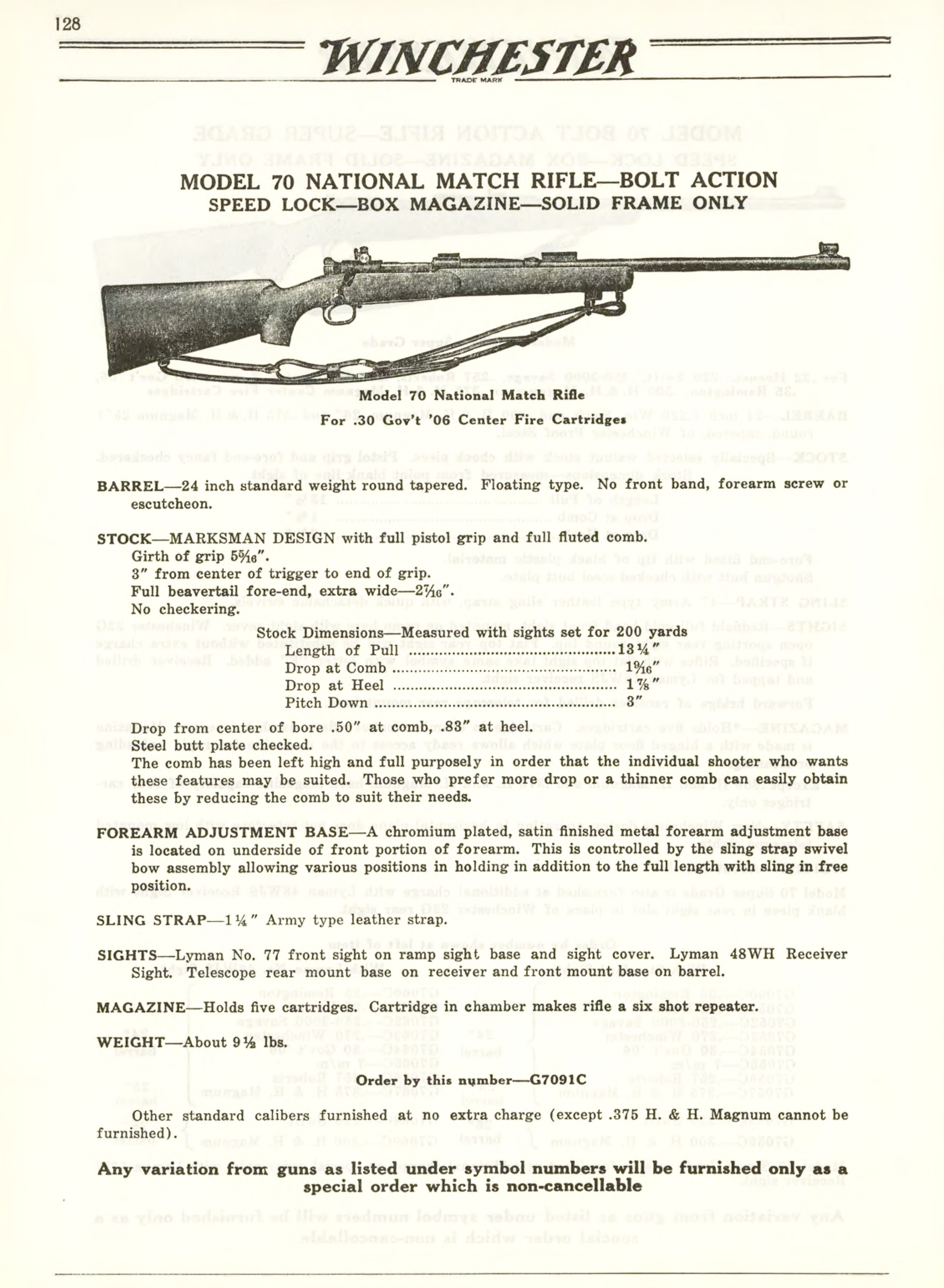

This should interest you…  The National Match page from the 1941 WWSG&A full catalog.  Note at the very bottom, where it says “Other standard calibers furnished at no extra charge (except 375 H&H Magnum cannot be furnished)”…  One could (almost) argue that your 220 SWIFT National Match was a “cataloged special order”…  Laugh
I have seen a few National Match rifles in non-standard calibers (besides Wayne’s documented 264 WIN MAGNUM and 338 WIN MAGNUM Nat Match rifles) including 300 H&H MAGNUM and 7 M/M. Not sure if they were legit or not, but the 7 M/M was interesting b/c it also had a non-standard 26-inch barrel…
What I’ve wondered is WHAT Winchester would actually provide if someone ordered a National Match in something other than 30 GOV’T’06.  As you know, the cataloged 30-06 National Match barrels had that special low front sight ramp and were D&T for a 0.470″ tall scope block…  The easiest thing for Winchester to do when filling such an order would have been to simply drop a regular barreled action (with standard front sight ramp and not D&T) into a National Match stock.  Your rifle, which has the scope block sounds interesting…  That’s what I’d hope the factory would have done.

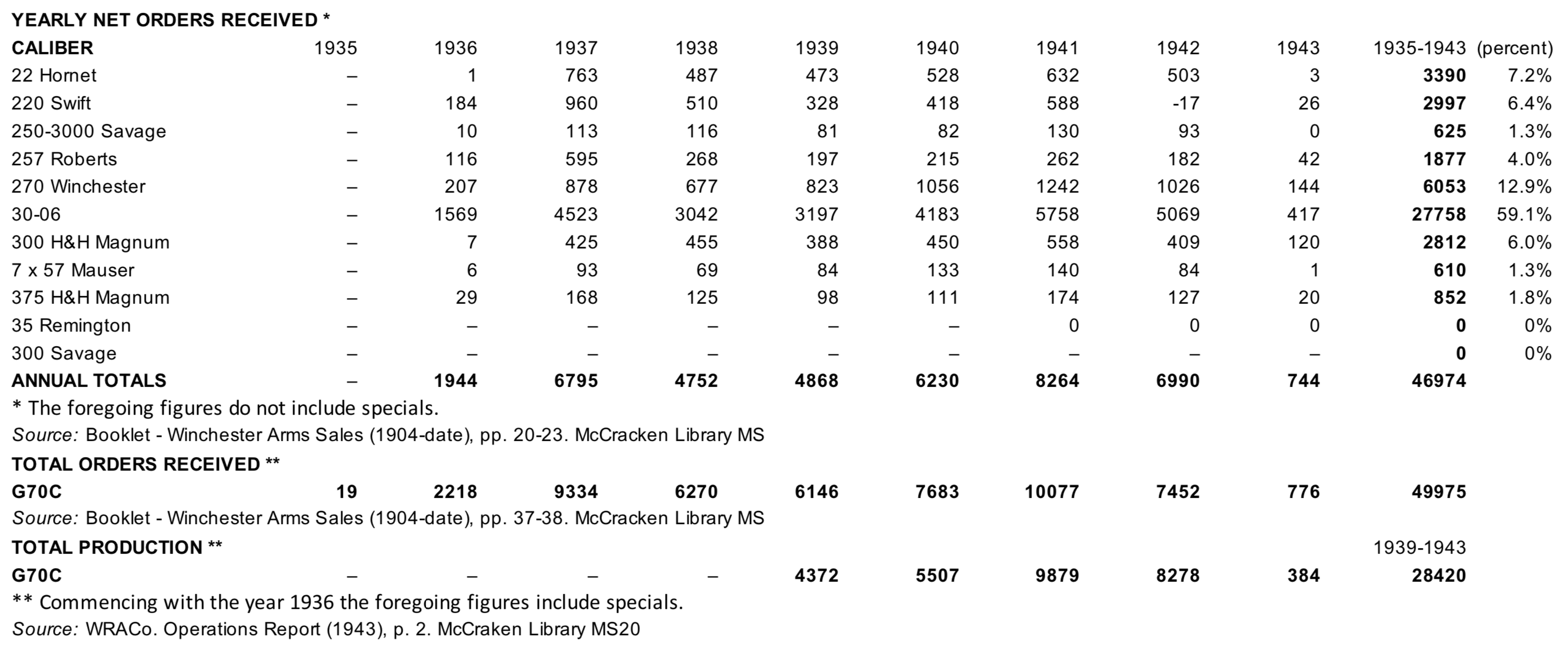

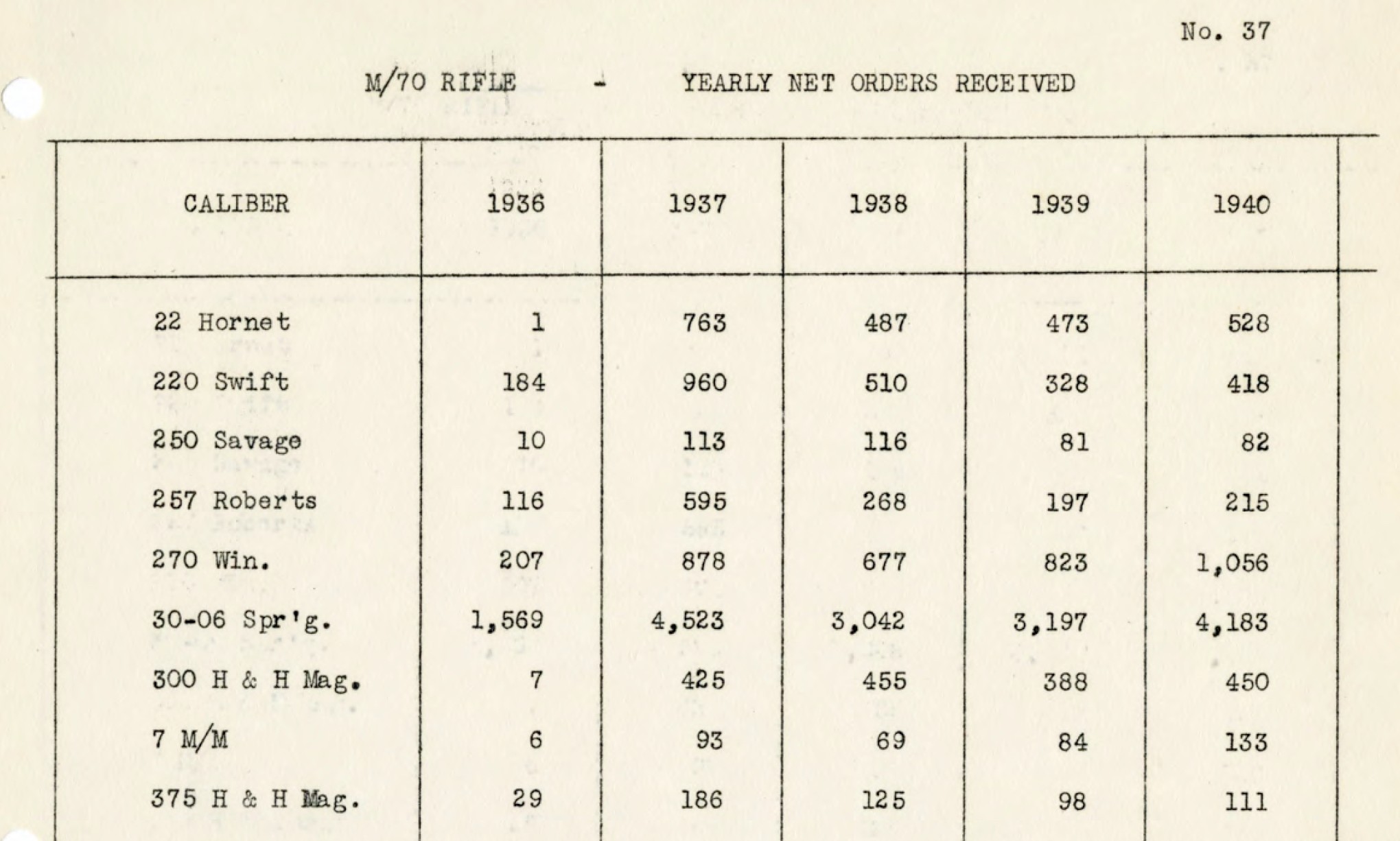

As far as the catalog summary…  The way I INTERPRET it is that Winchester received orders for only (17) M70s in 220 SWIFT in 1942.  How many 220 SWIFTs they manufactured, and in what styles, is something I have not found recorded (so far at least)… They might have had (17) 220 SWIFTs in the right style in inventory and made (0) in 1942…  Or they might have left the (17) orders unfilled???
What I THINK is that a 220 SWIFT National Match would have been a Special Order as indicated in the 1941 catalog above.  As such the order would have been processed as a single gun assembly order (not a regular production work order) and would not have been counted at all in the “Yearly Net Orders Received” summary, either for 1942 or 1946 as the report didn’t include “Specials” (this is stated in the document).  Rather, it would have been classified as a “Special”.  “Specials” were only included in the “Orders Received” by Model report that isn’t broken down by caliber.

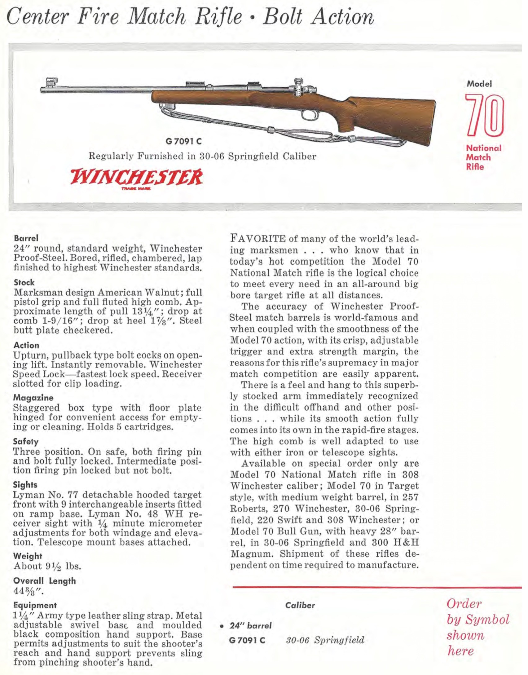

The one I’d like to see (own) would be the National Match in 308 WIN.  These, along with a Target Model in 308 WIN, were specifically offered on Special Order in 1953-1954 only.  Read the “fine print” on this page from the 1953 Winchester Firearms catalog…
If there were ever a National Match in something other than 30-06 that came with the low Nat Match front sight ramp, I’d expect it to be one of these.  There is one pictured in Dean Whitaker’s book (photo 6-7) and I think MAYBE it has the low ramp, but the angle of the photo leaves me uncertain.  Since Winchester never routinely made standard contour barrels in 308 WIN (myriad fakes notwithstanding), 308 WIN Nat Match barrels would have been made in a special limited run.  So why not put the Nat Match ramp on them???
As the Nat Match in other calibers listed as available on special order early on were not higher priced, I suspect they were just Standard Rifles (regular ramp) dropped into a Nat Match stock.  Maybe with the scope block added, like yours.

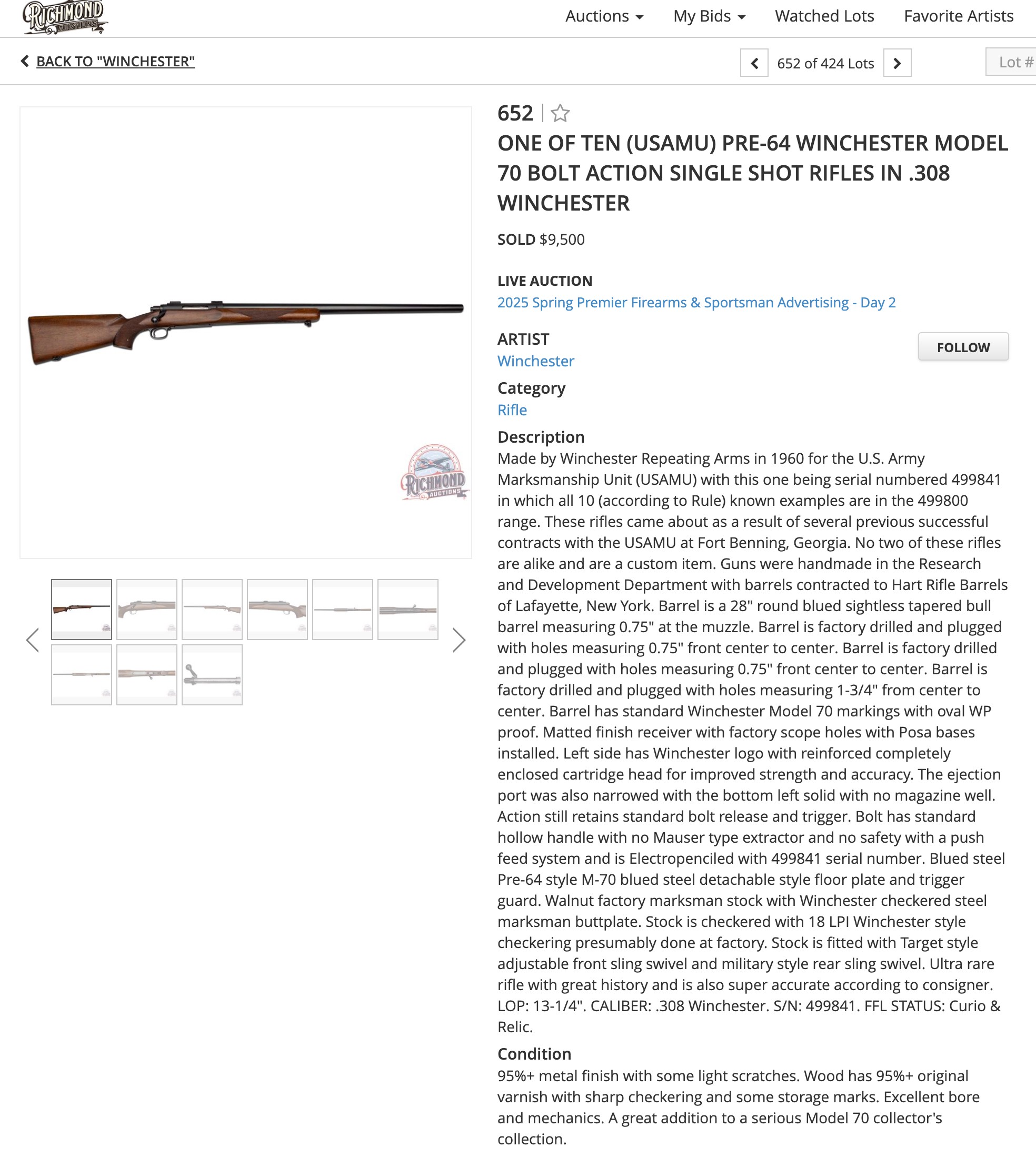

Several 308 WIN Bull Guns were made as part of the AAMU collaboration in 1956 and other military R&D projects. Did you see this one in the Spring Richmond Auction?  Not sure about the checkering on the stock, but the solid bottom single shot action R&D is legit.  It got kind of pricey…
https://guns.richmondauctions.com/lots/view/5-1PNL38/one-of-ten-usamu-pre-64-winchester-model-70-bolt-action-single-shot-rifles-in-308-winchester

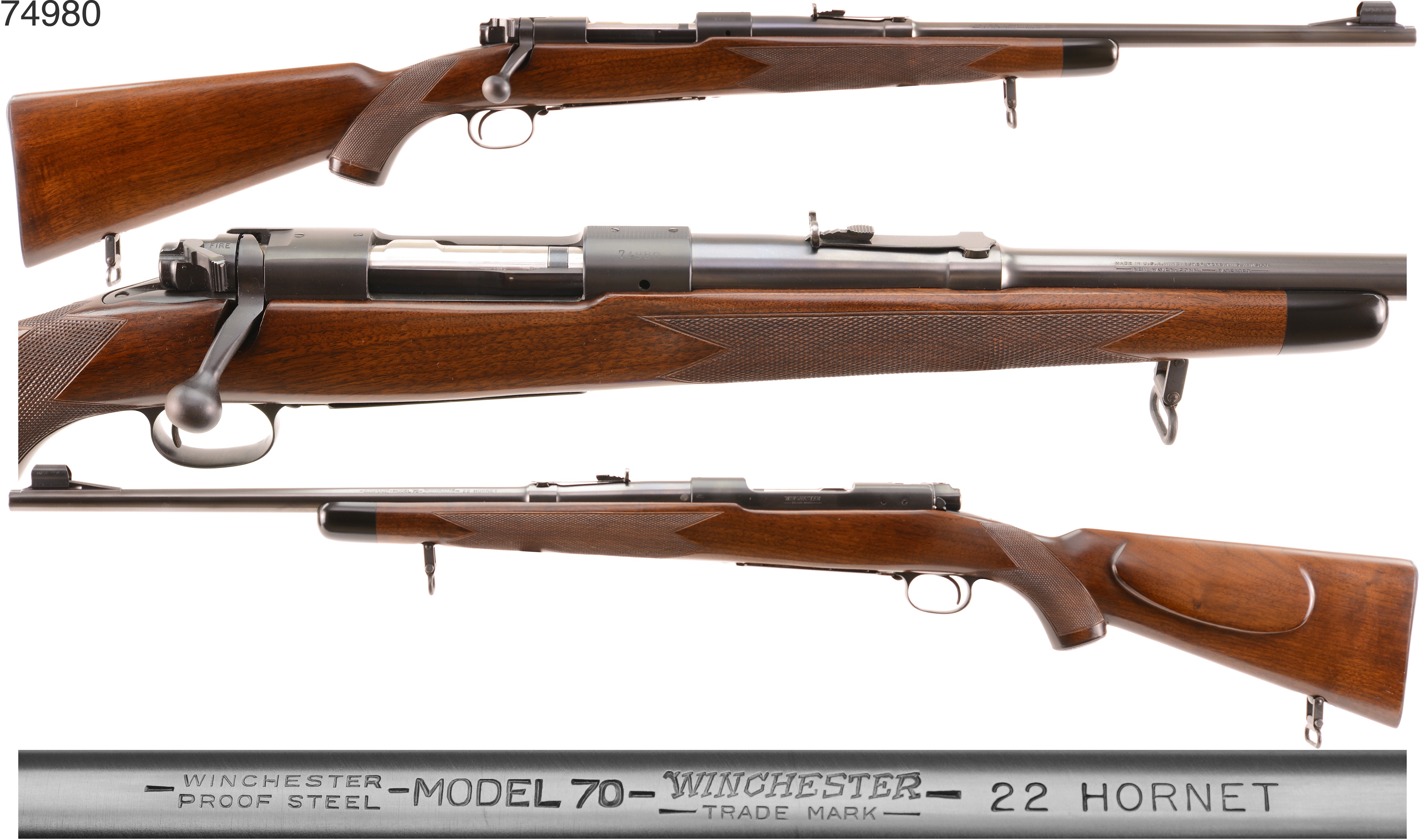

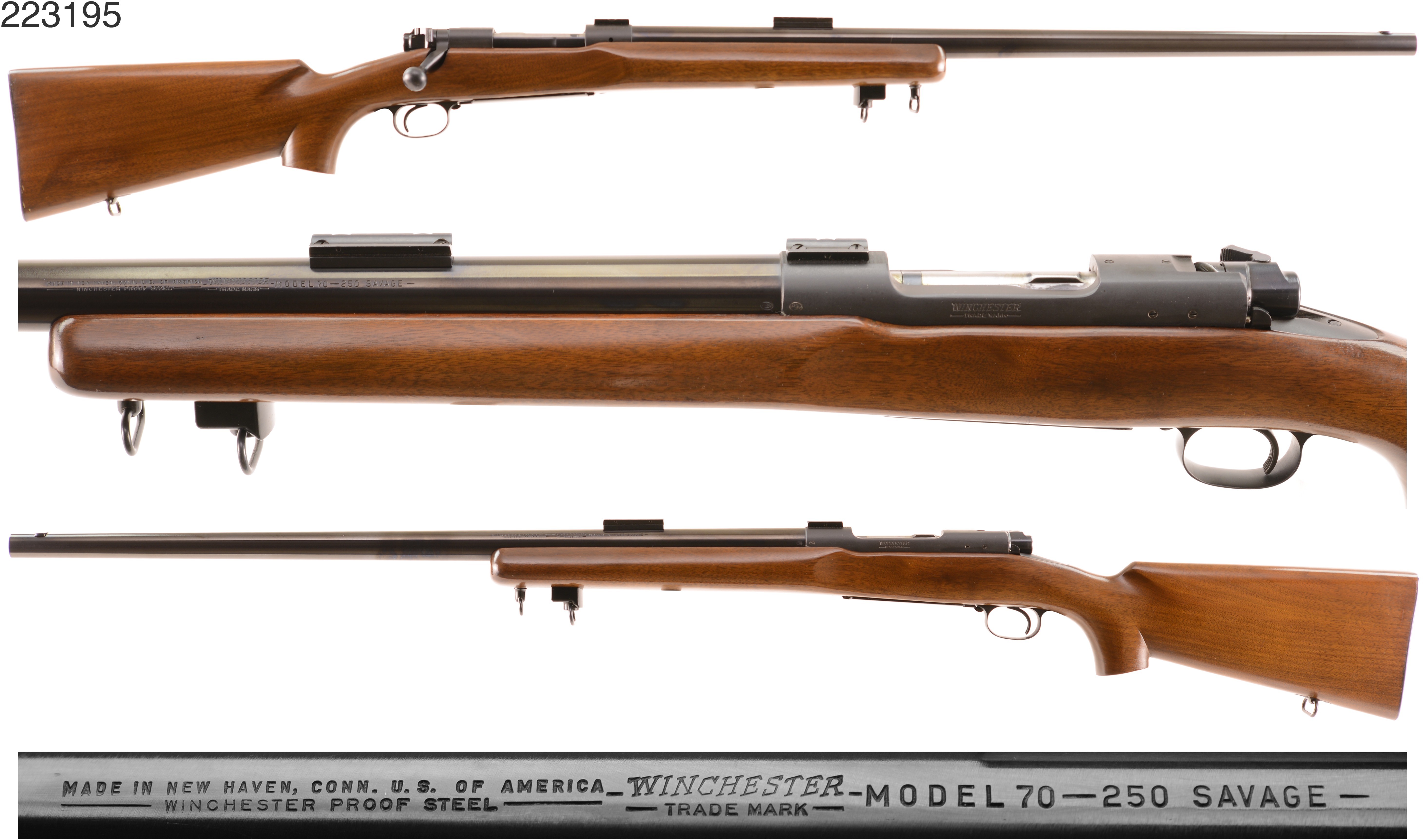

As for other “oddball” Bull Guns, besides 308 WIN and 300 WIN MAGNUM, I think there are legit ones in 22 HORNET (!!!), 243 WIN, 250 SAVAGE, 257 ROBERTS, and one (claimed by Roger Rule to be legit) in 300 SAVAGE.  Below is one of the 250 SAVAGE Bull Guns (s/n 223195), which is pictured in Whitaker’s book from Ken Reynold’s collection.  There’s another one of these serial numbered close to it.  The two are identical down to the never seen style 3C roll marked caliber reading “250 SAVAGE –” instead of “250-3000 SAV”.
You never know what may turn up (and even be legit)… LaughLaughLaugh

Louis Luttrell said
Hi BRP-
Winchester certainly did make some 308 WIN Bull Guns, but as far as I know (unlike the Nat Match and Target Model) they were never specifically cataloged as a Special Order option. They also made a few in 300 WIN MAGNUM that weren’t cataloged.

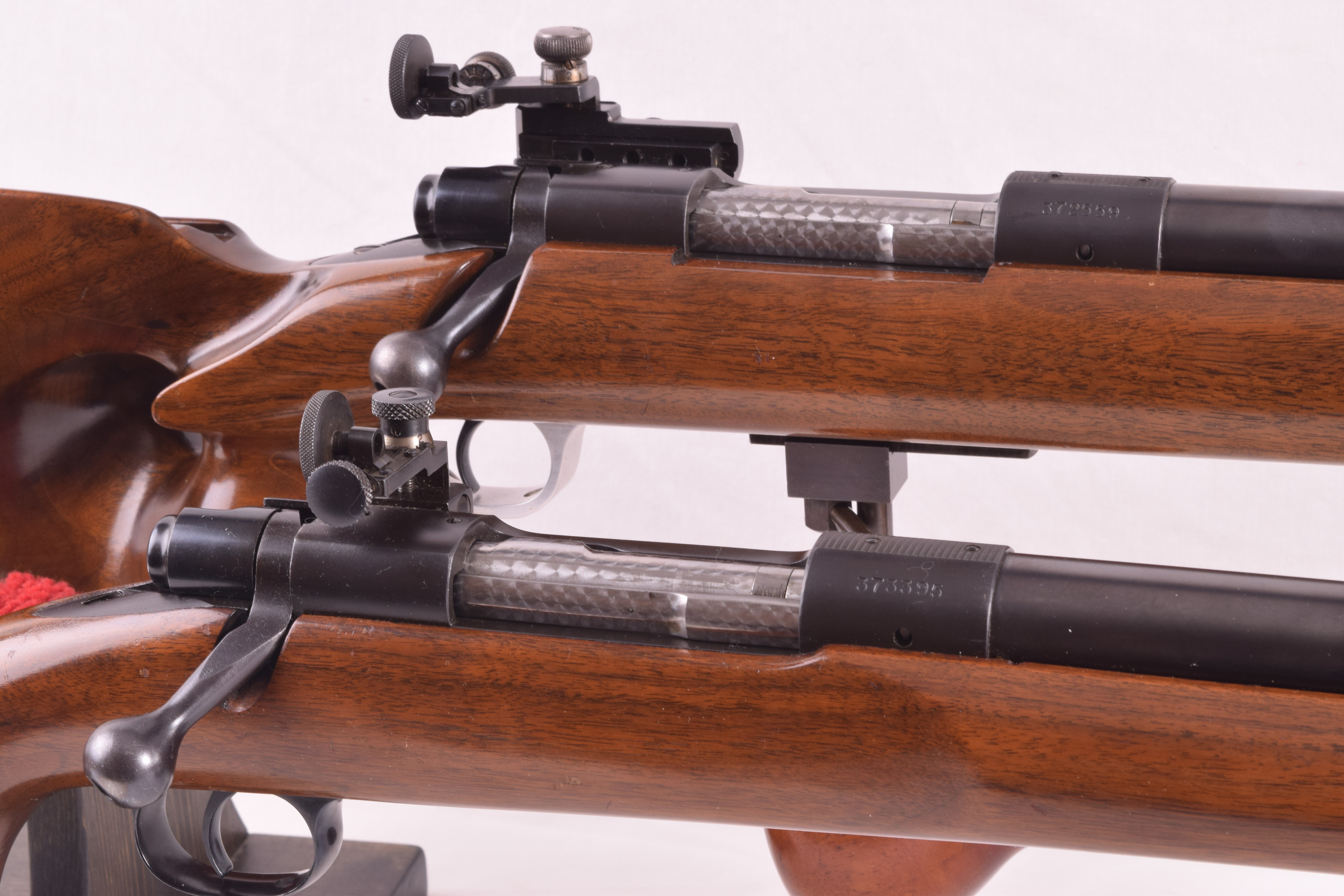

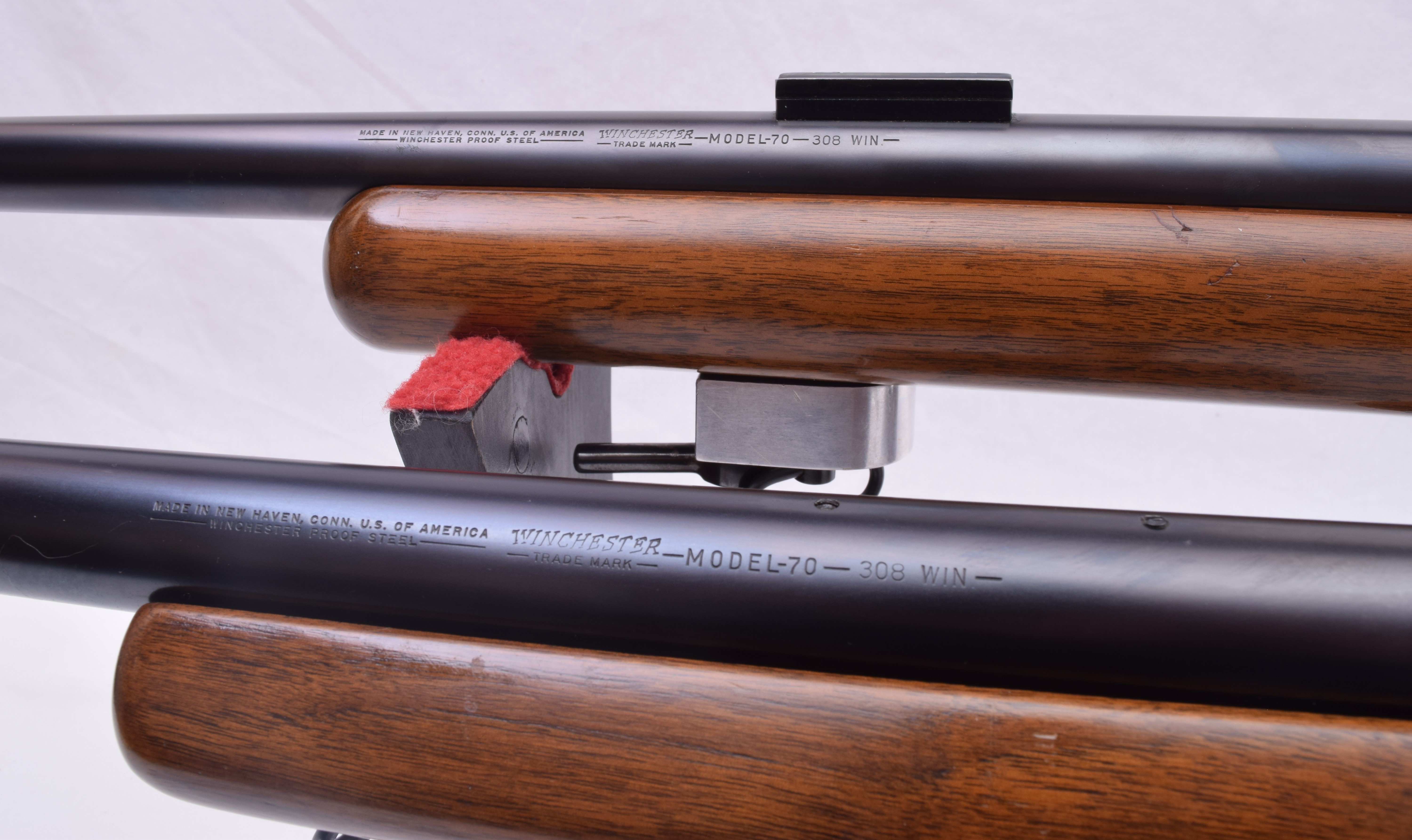

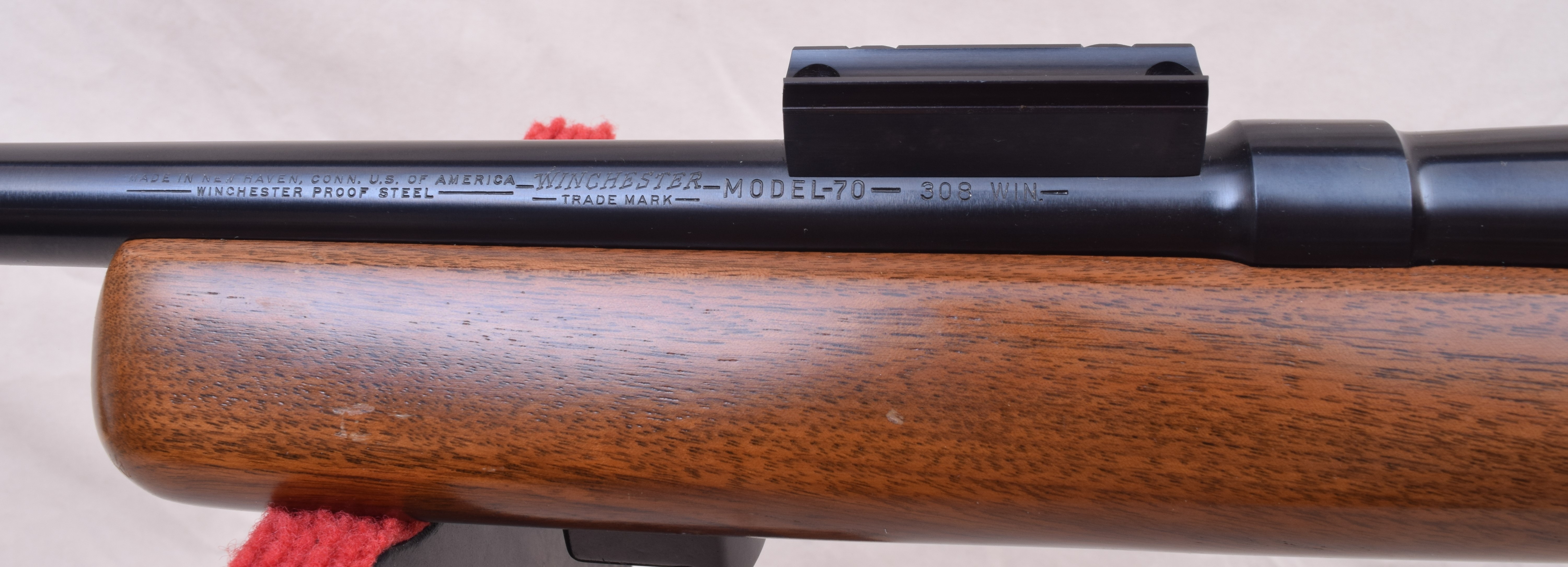

I have attached a couple of photos of the 1956 Olympic/AMU bull barrel rifles Lou references. All 10 were chambered in .308.Olympic1.JPGOlympic2.JPG
With respect to the Richmond Auction rifle which Lou mentions, from the information I have, the checkering is not original to the rifle and much of the description is inaccurate. Everything else about it is original.

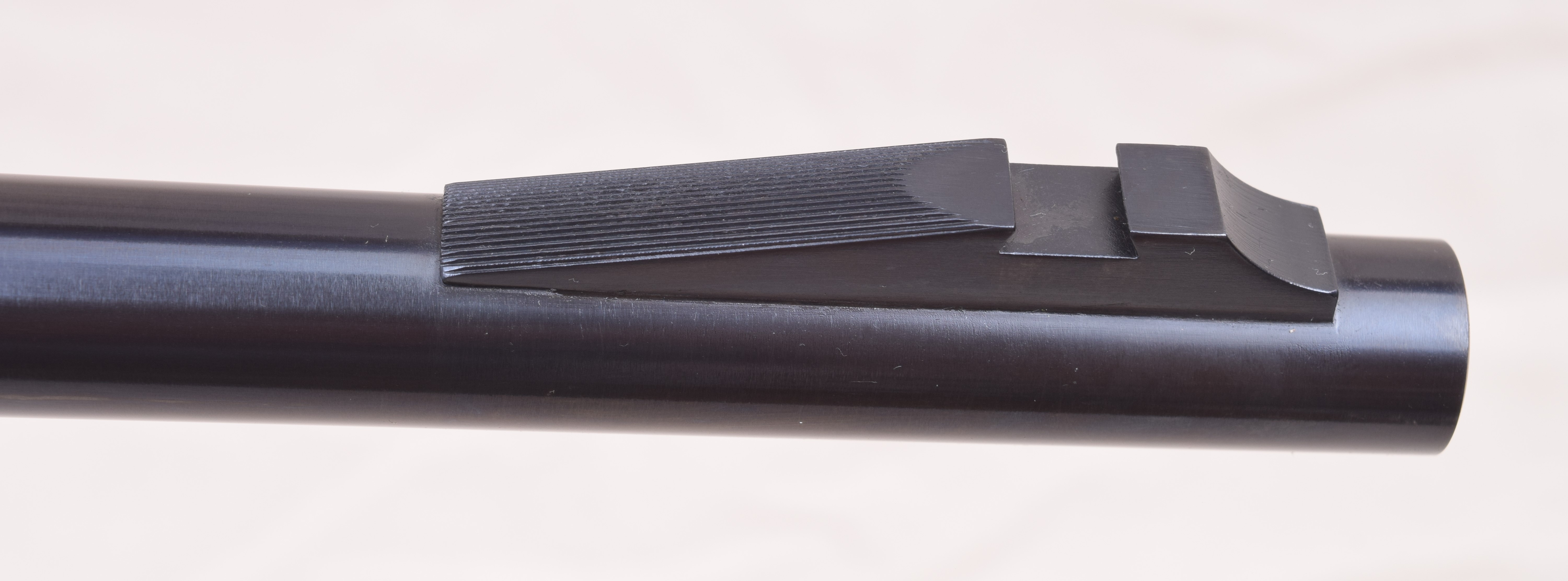

Coincidentally to the ongoing discussion here, the auction rifle(499841) is consecutively serial numbered to the lone .308 National Match (499842) configured single shot. The front sight on this .308 NM is not low profile, but is without the sight cover slots. However this barrel is unique in that its 26” vs the standard 24” and it has no dovetail cut in the barrel boss as on the production rifles.NM1.JPGNM2.JPG

Thanks Ned!!!
Those are awesome guns!!!  LaughLaughLaugh Did you finish your monograph yet???  I want to buy a copy… Wink
Your pictures clearly show that Winchester made Style 3C roll dies (one-piece Standard style not Featherweight) in 308 WIN.  Something the myriad fakers out there cannot get right…
