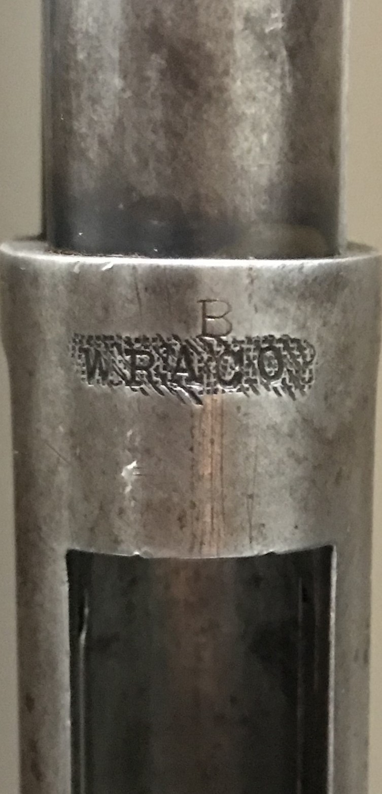

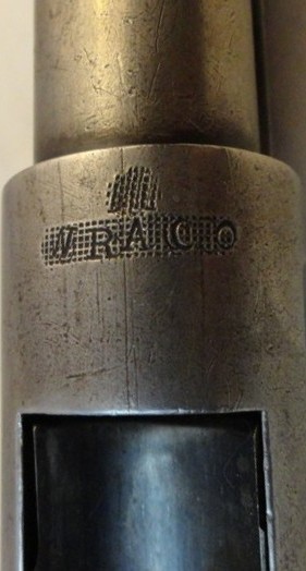

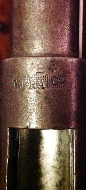

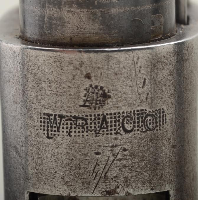

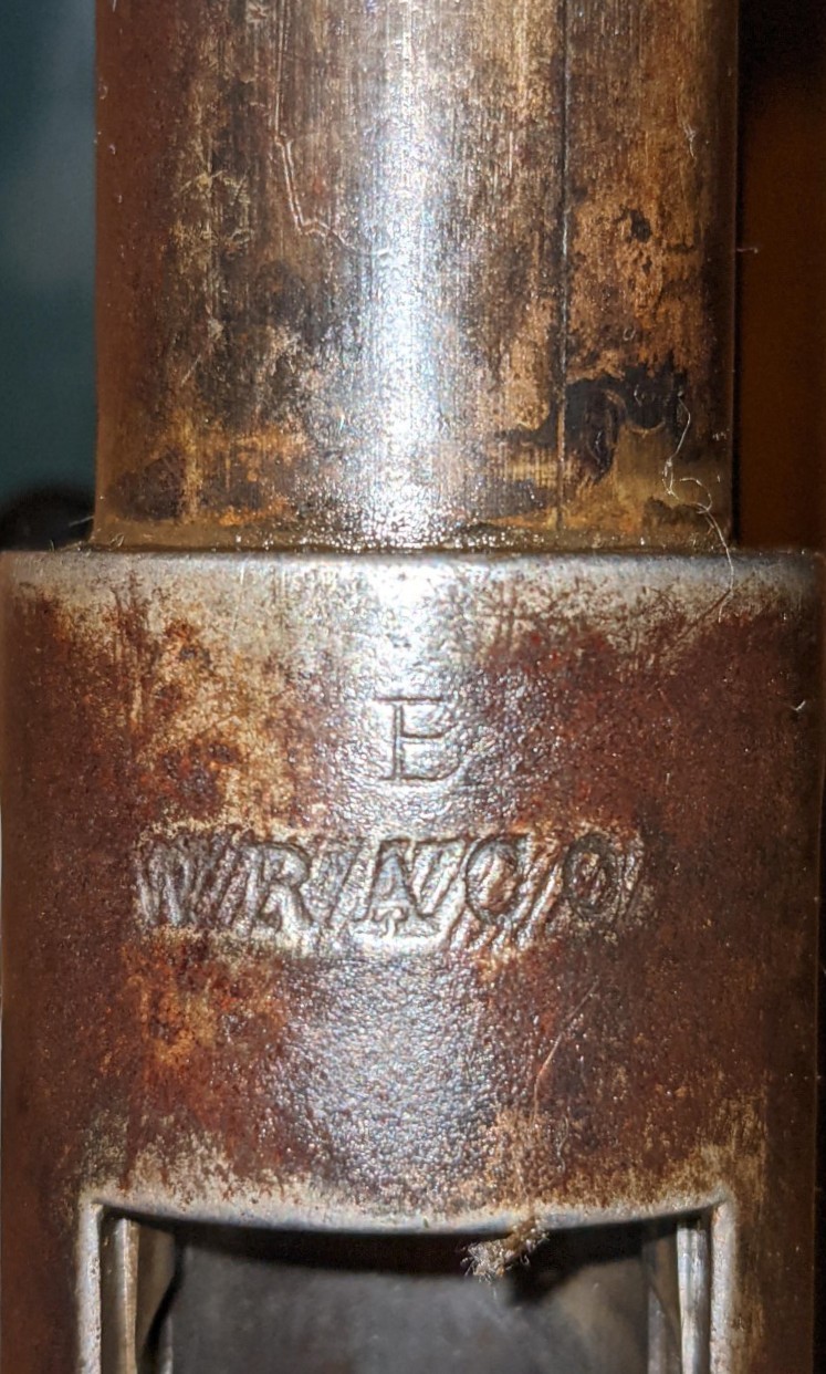

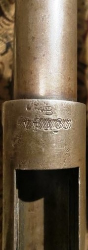

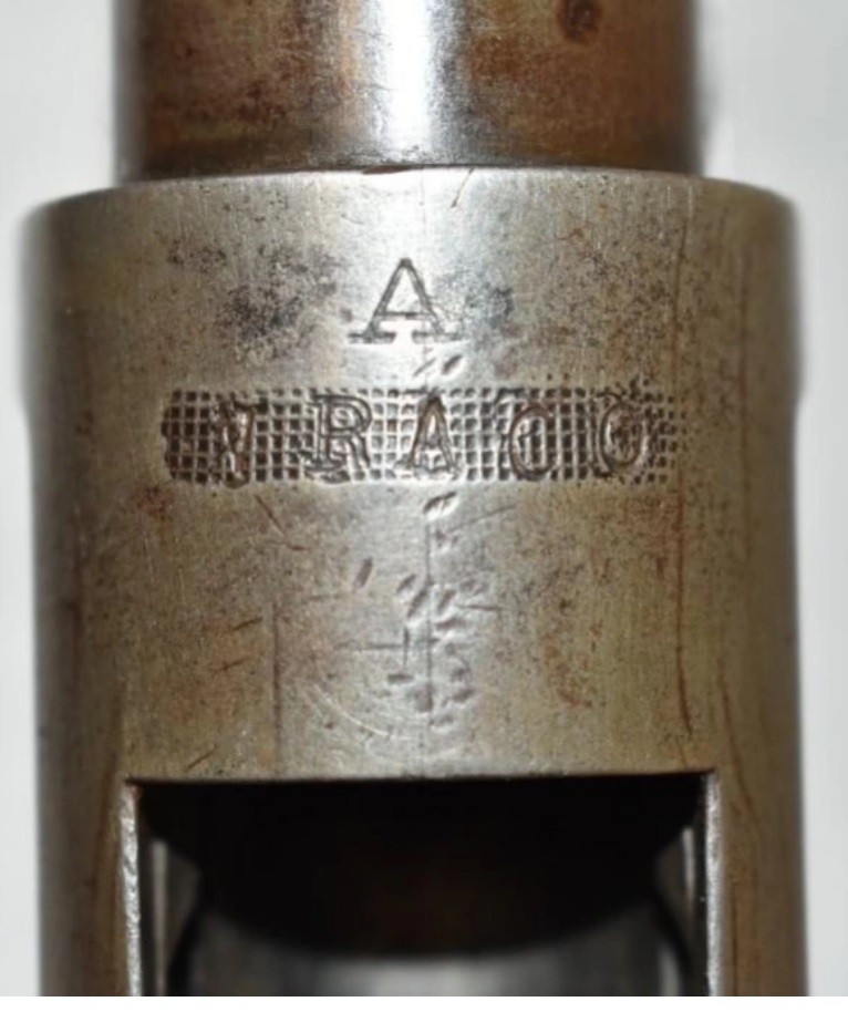

A 1892 is currently on GB with this description concerning its blocked-out serial number.
Price Pirate examples of the Model 1892 are especially scarce, as relatively few rifles were subjected to this serial number obliteration process. The overstamped WRACO marking and grid pattern on the receiver are  factory-applied identifiers when the rifle was returned for service, making these rifles immediately recognizable and highly unusual survivors of Winchester’s internal business practices rather than routine production arms.
The Madis book, pg. 645, has this minimal write-up about this situation.
“Some guns which were sold by distributors selling to dealers who cut prices had the serial numbers removed to eliminate the possibility of Winchester’s refusing to sell more guns to these firms.”
Does anybody have any additional information about how this happened?  Did the distributors know who the discounters were and removed the serial number before delivery, or did the factory remove them after they went back to the factory, as the seller indicated?
If this was discussed in the past, point me to the thread, as I could not find it during a search.
Forum Posts: 14946
February 7, 2026 - 12:21 am

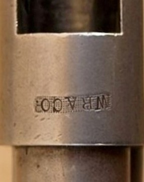

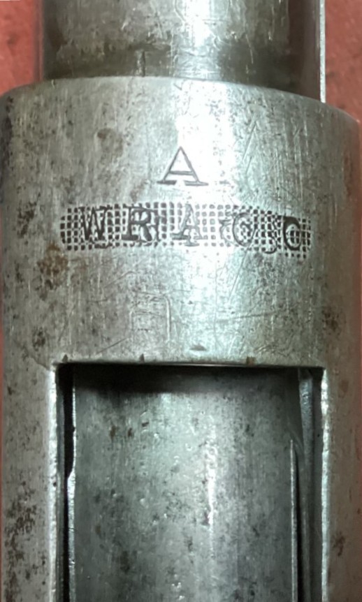

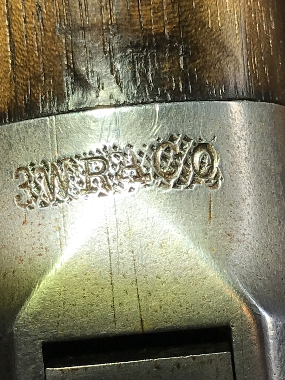

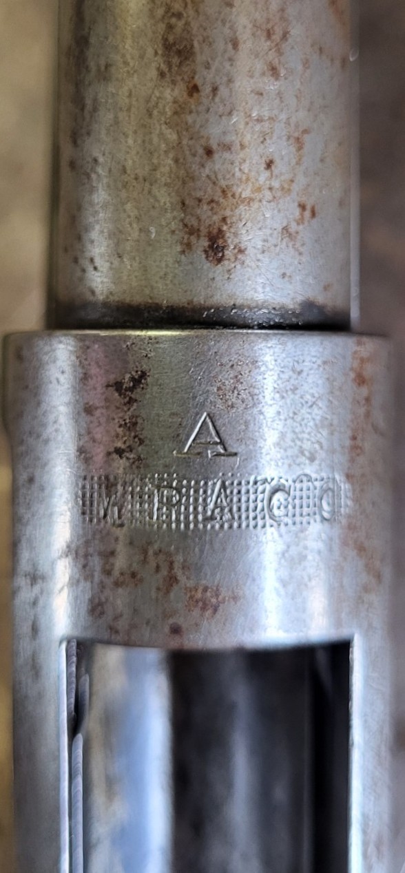

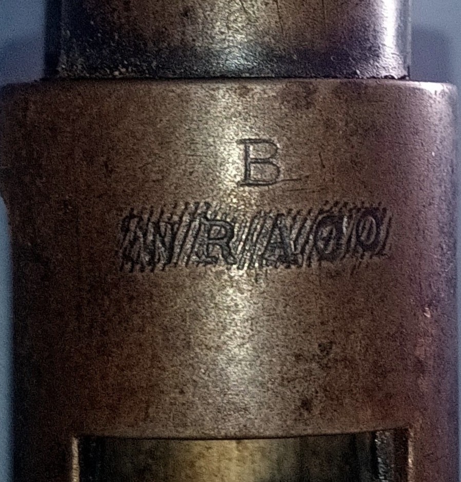

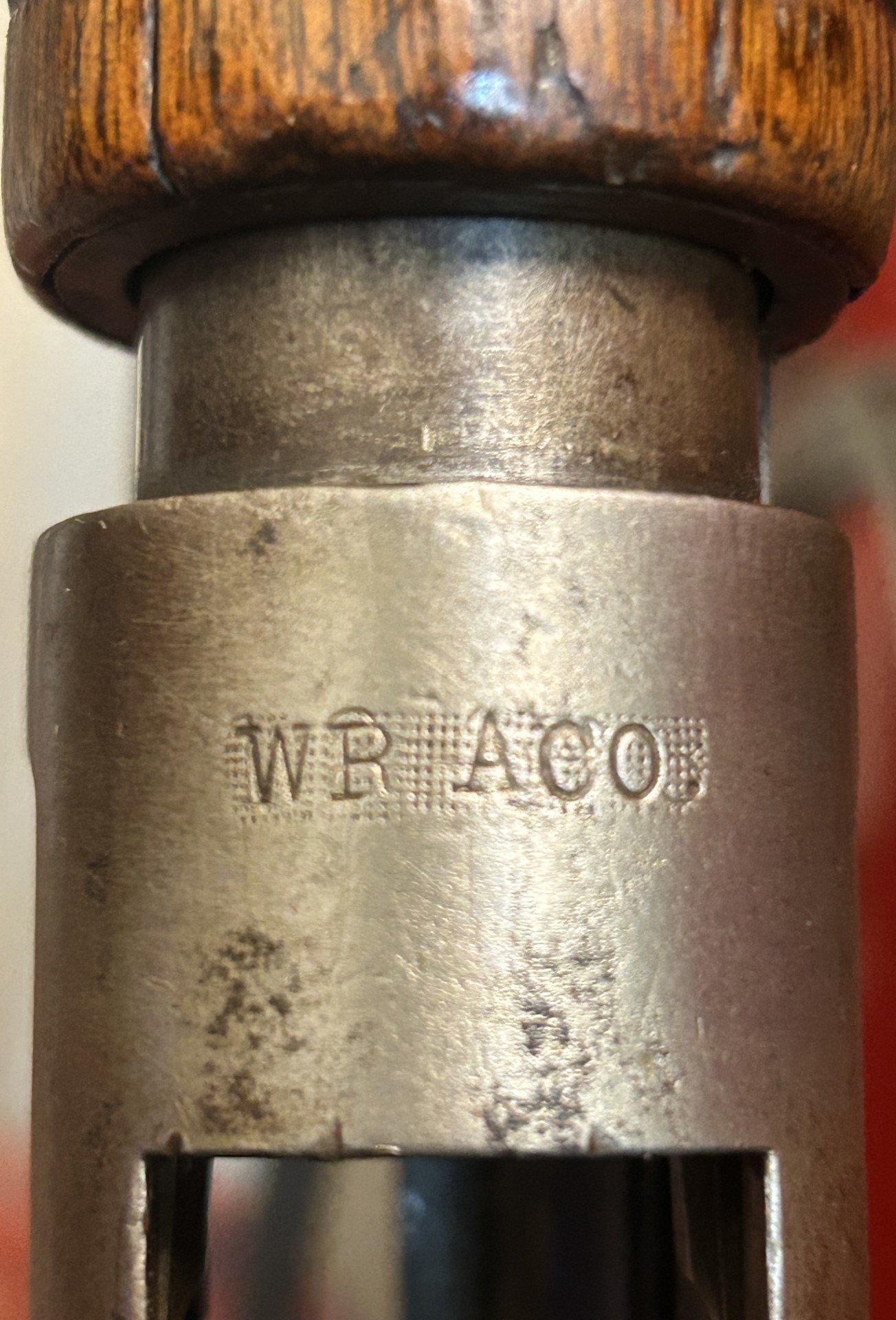

The WRACO over stamp was positively not a factory applied obliteration of the serial number, nor did it occur when a gun was “returned to service”.   The subject marking is found on a small number of the Models 1892, 1893, 1894, and 1897 that were manufactured in the mid to late 1890s only.
The theory
is actually correct.  The “distributer” was Sears & Roebuck when they were still located in Chicago, IL.  Winchester did eventually cease selling firearms to Sears & Roebuck as a result of them selling at prices lower than what Winchester dictated.
The serial numbers were removed by employees of Sears & Roebuck, and they were crudely done.  Several different types of over stamp types have been observed.
The pictures below are all Model 1893 Slide-action Shotguns with a “WRACO” over stamp.  Note that the pattern and style is different for each one of them.
WRACO-A-1.jpgWRACO-A-2.jpgWRACO-A-3.jpgWRACO-A-17422.jpgWRACO-A.jpgWRACO-B-2.jpgWRACO-B-3.jpgWRACO-B-4.jpgWRACO-B-Star.jpgWRACO-B.jpgWRACO-Pre-A-1.jpgWRACO-Pre-A-2.jpg

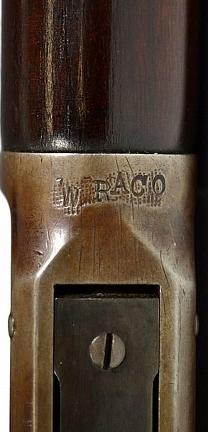

These are WRACO over stamps on Model 1894s
WRACO-overstamp.jpg WRACO-marked-Model-1894-Rifle-38-55-TY2-UT.jpgWRACO-marked-SRC-38-55.jpgWRACO-overstamped-Model-1894.jpgWRACO-IMG-Model-1894.jpg
