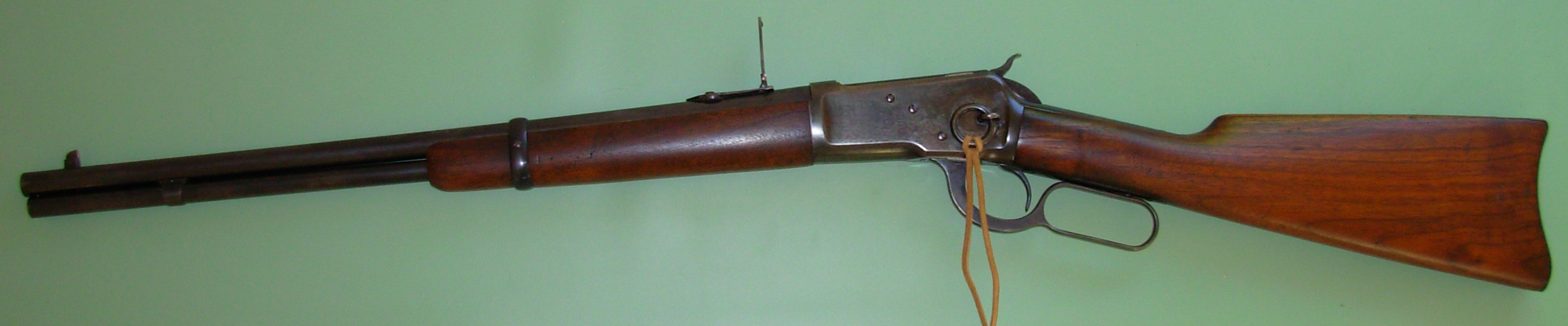

That’s what I did with a twin to your new Model 1892 when I got it a couple of years ago:
SN 910523
SN 910523
Wow! That looks great! Hope I can get mine to look that good. Yes, we definitely have a pair of twins! Even the coloring is the same as mine.
