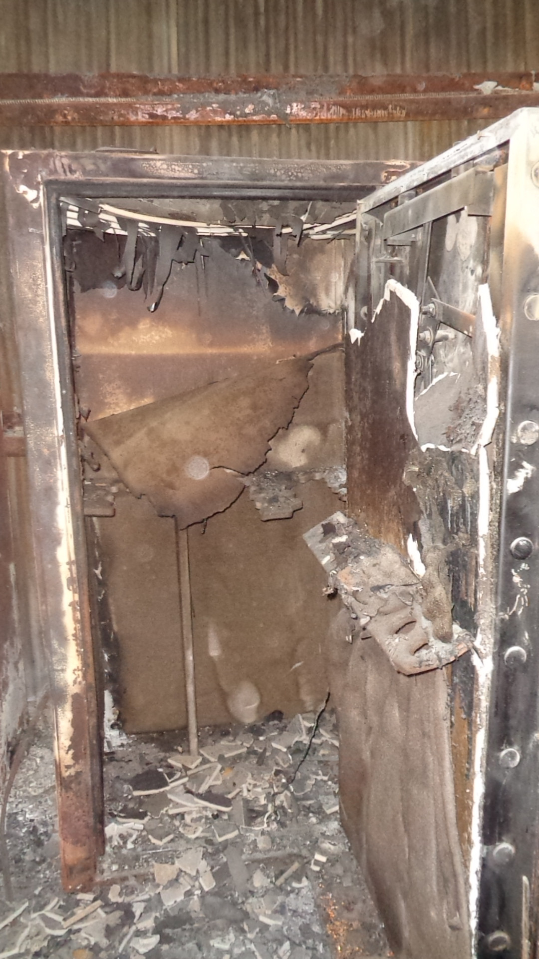

Nevada Paul said And the safes have the added protection of fire, which a vault door in a framed house does not fully.
That protection is limited, unless there’s a fire station on your block.  In a major fire, the safe may preserve the baked remains, but their collector value has gone up in smoke.  Those terrible photos shown on TV news over the last few days of the wildfires in NM & CA always make me wonder what guns & other antiques have been lost.
Depending on the fire intensity and duration, you have to cross your fingers and hope for the best.  When that fire builds pressure, smoke gets into places you couldnt begin to imagine–and the added heat. Then within a short period of time the corrosion sets in.  The damage caused by smoke alone is bad enough and I dont think you can trust some of the best safes out there to protect from the all fire/smoke conditions.
That is absolutely true – time and intensity are the controlling factors in fire damage and none of the gun safes are an absolute protection.  The only practical solution is to buy a good brand of safe with what fire protection is available, and maintain a monitored alarm system.  The large majority of “saves” by alarm systems are fire calls, not intrusion calls.  It varies with the locale, of course, but we’ve been had a couple of false fire alarm calls – one due to broiling steaks on the kitchen stovetop where the exhaust fan just couldn’t keep up; the other was a failing sensor that cried wolf.  In both instances, our FD boys were at the door in less than 4 minutes.  With a proper spread of heat and smoke detectors, that response time can really limit the damage – most of which is going to be smoke damage, the severity of which I do not discount.  As in the case of burglary, I think limiting time on target helps more than anything else.
