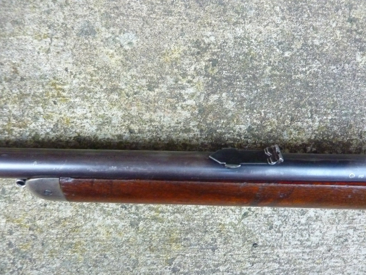

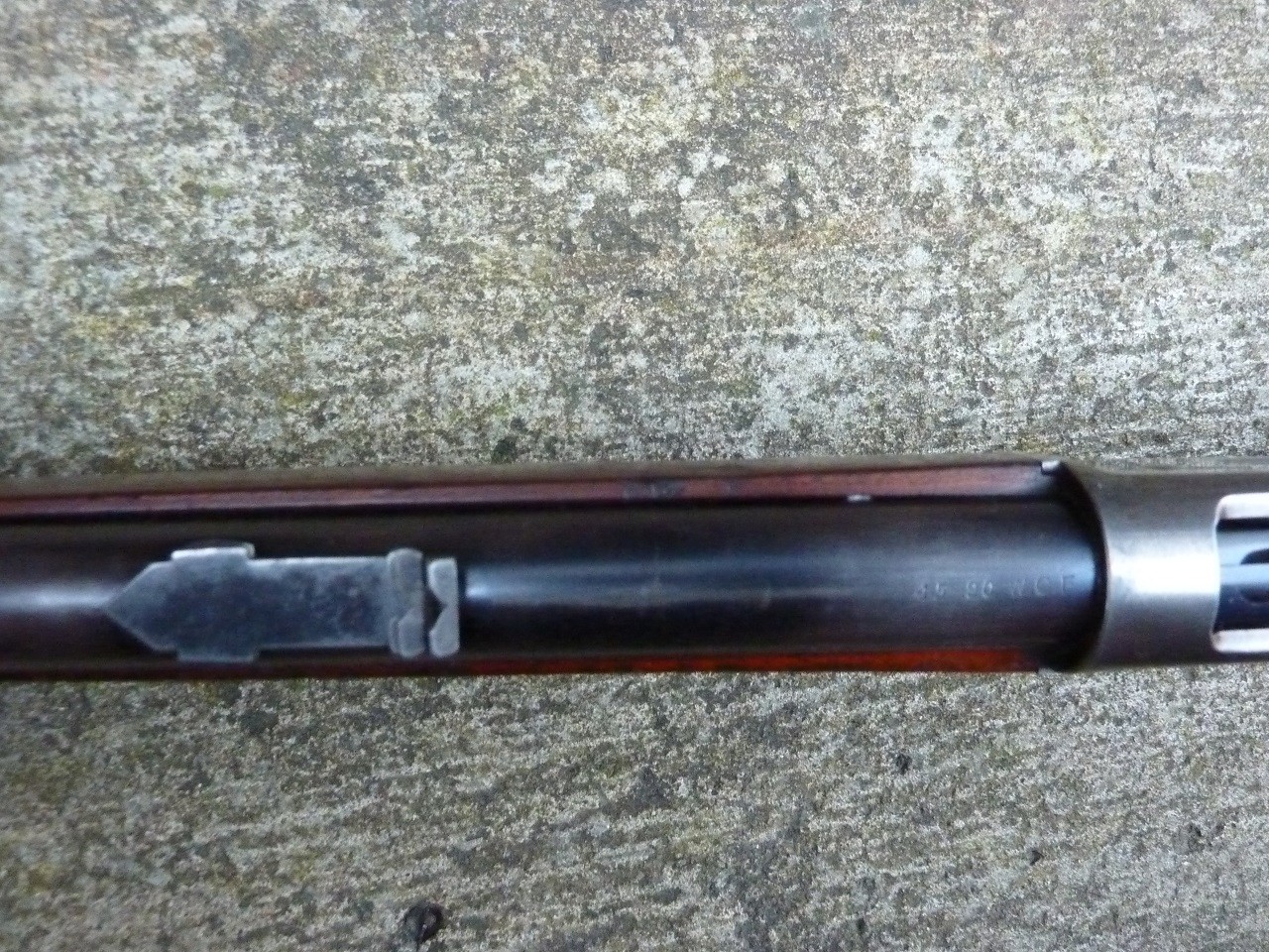

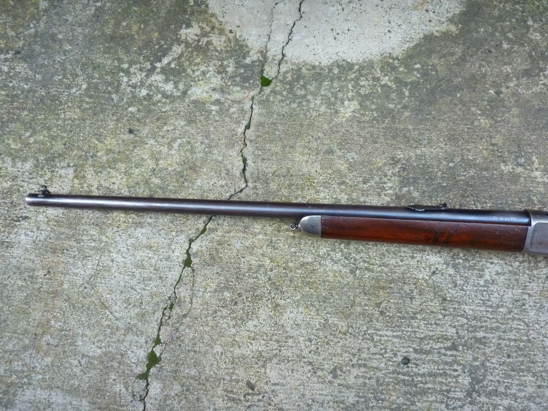

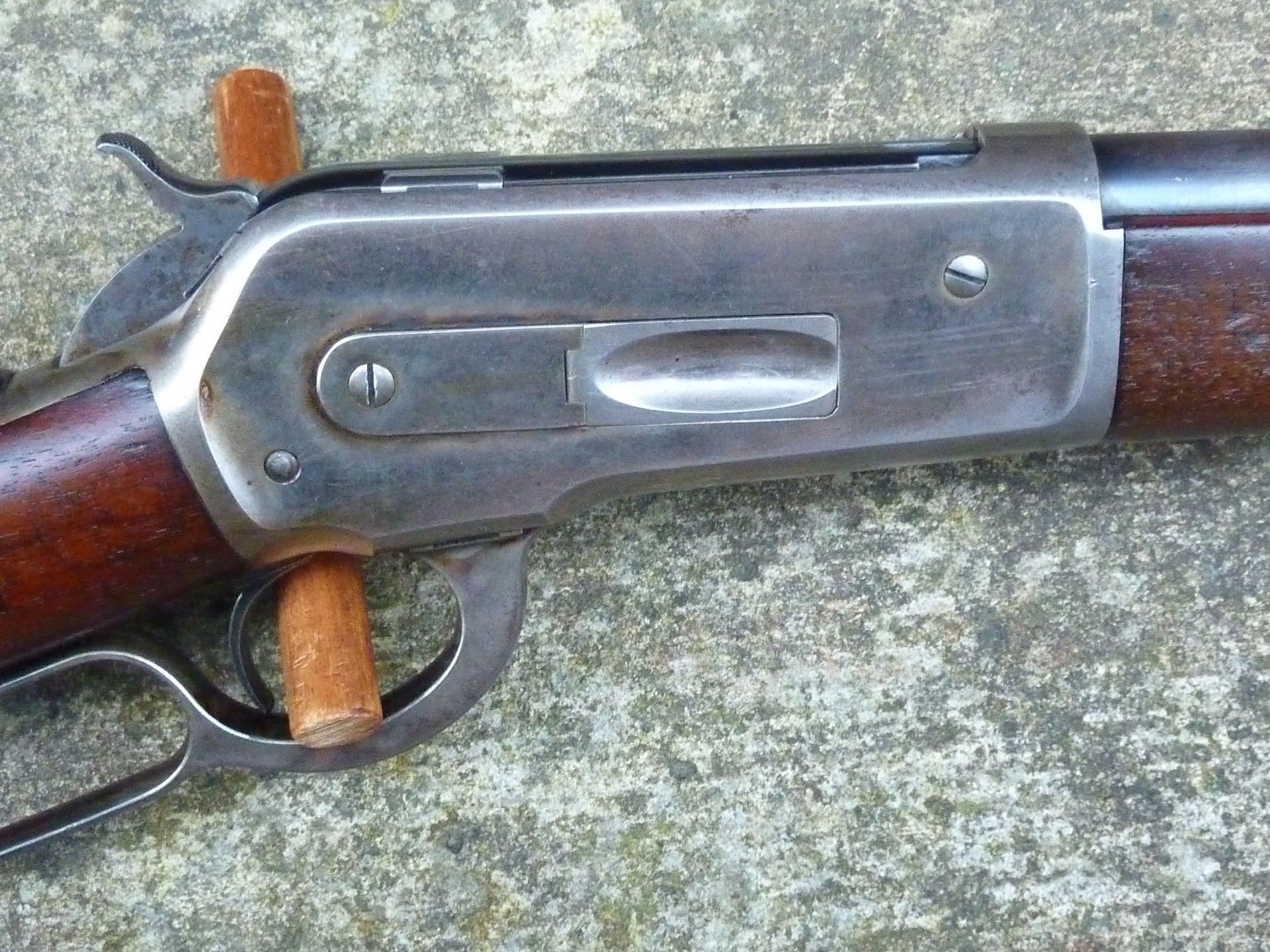

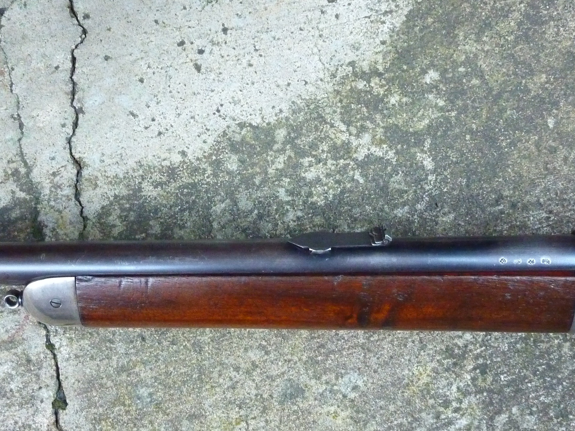

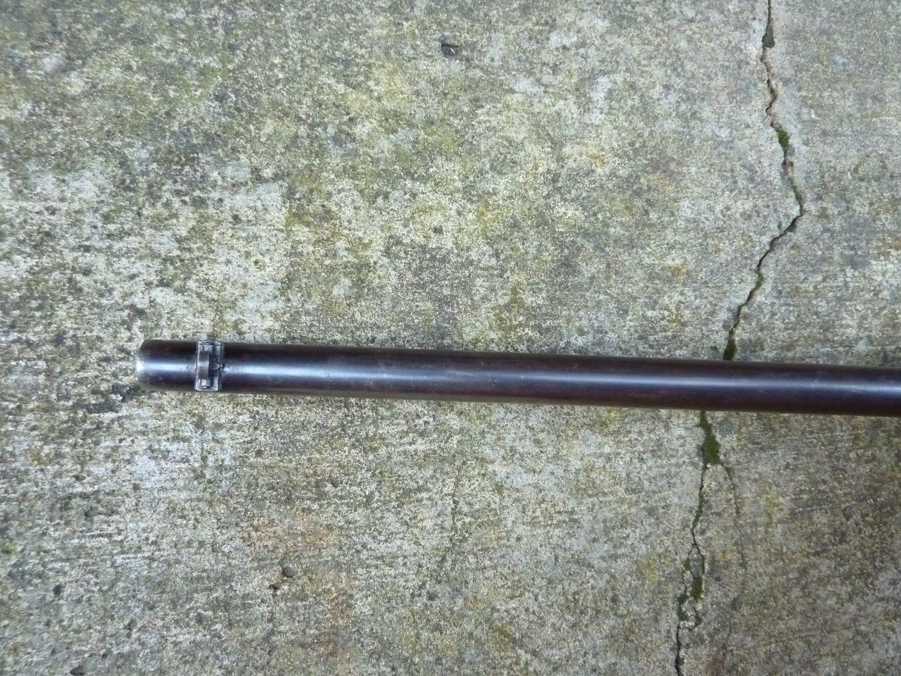

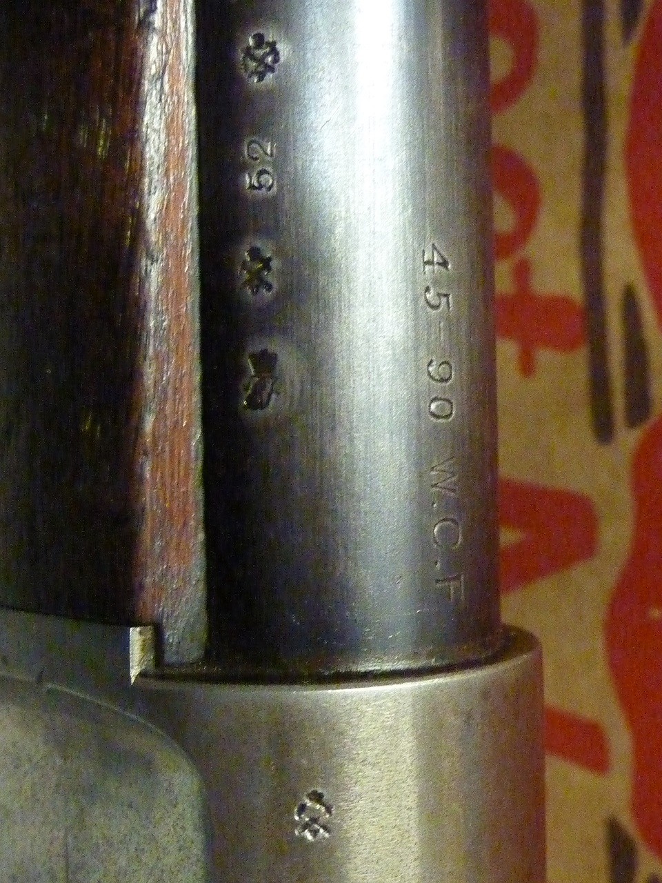

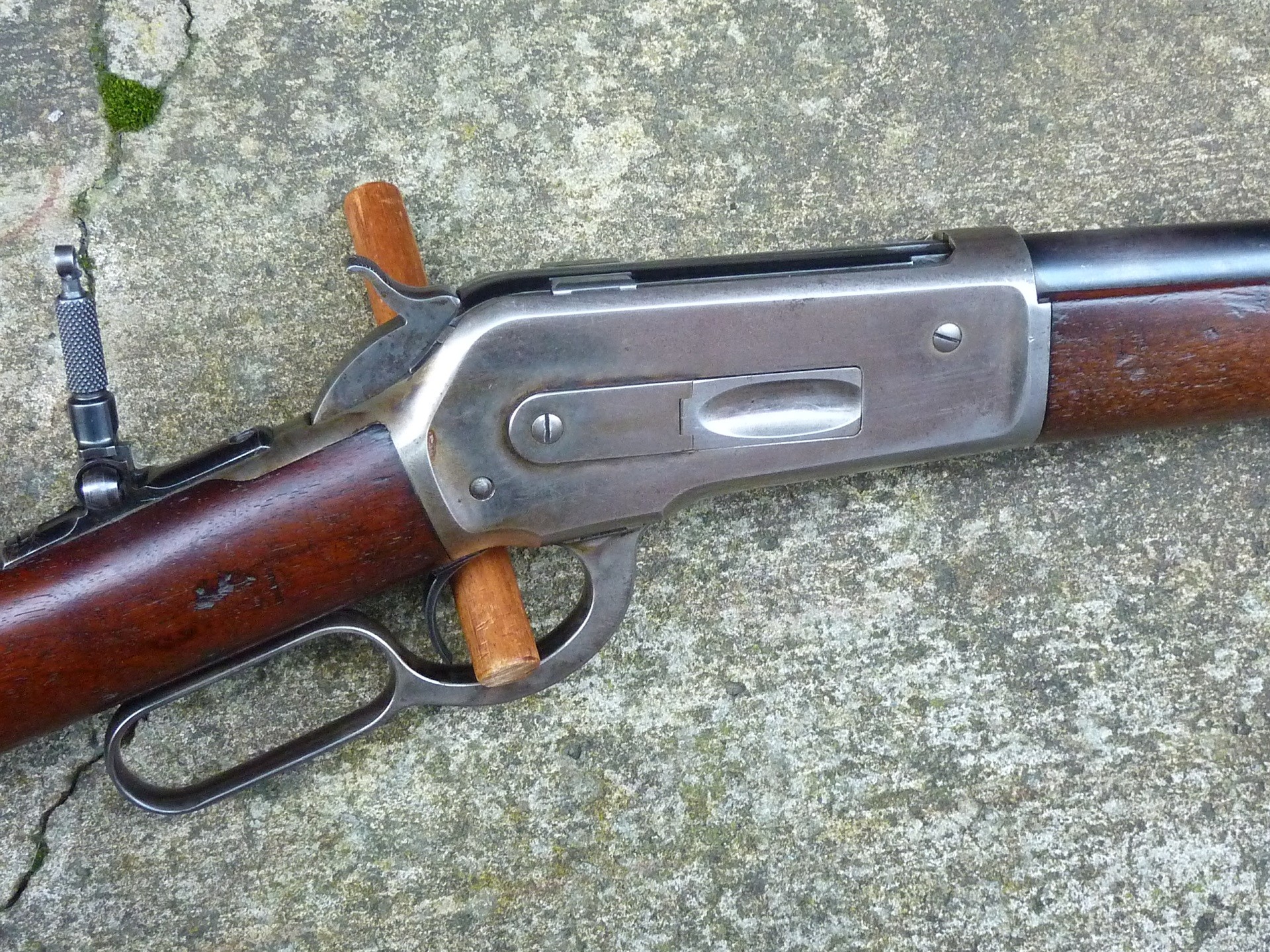

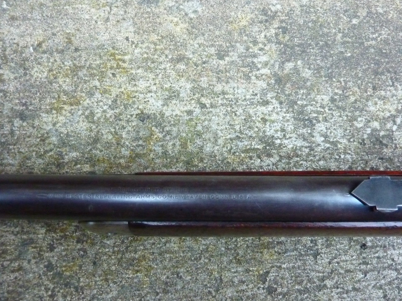

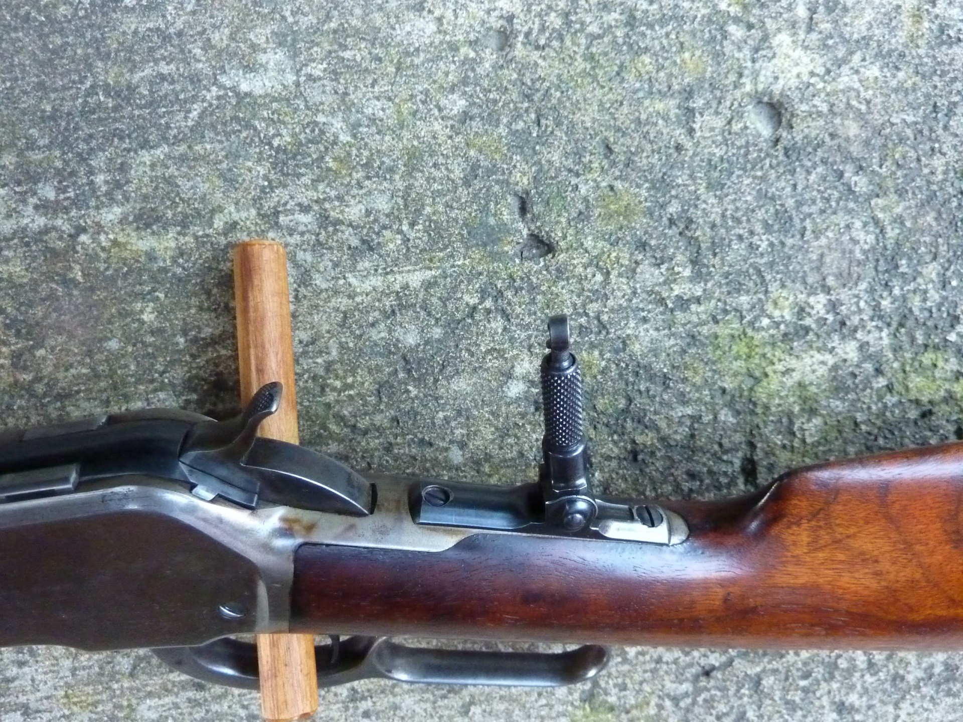

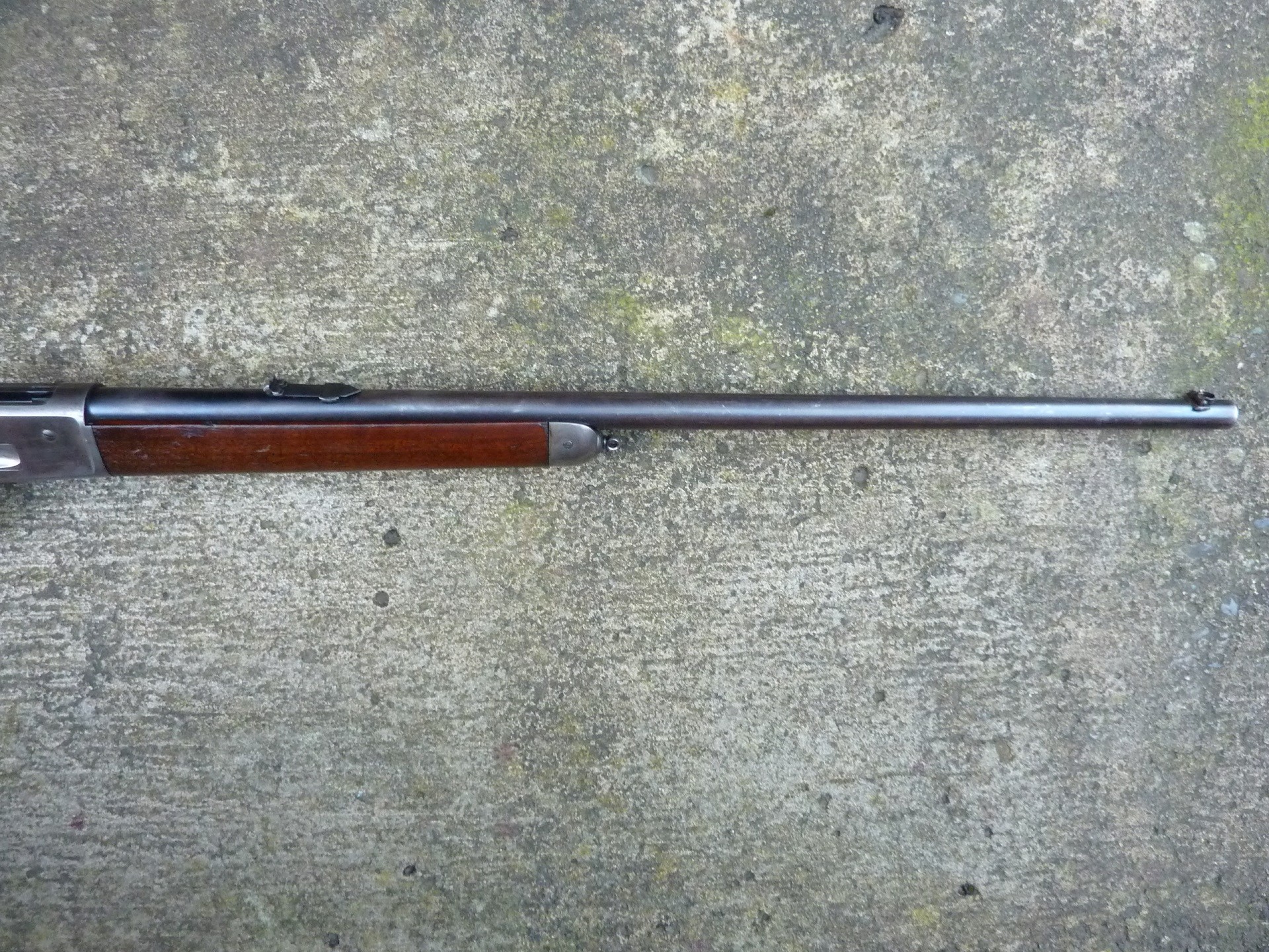

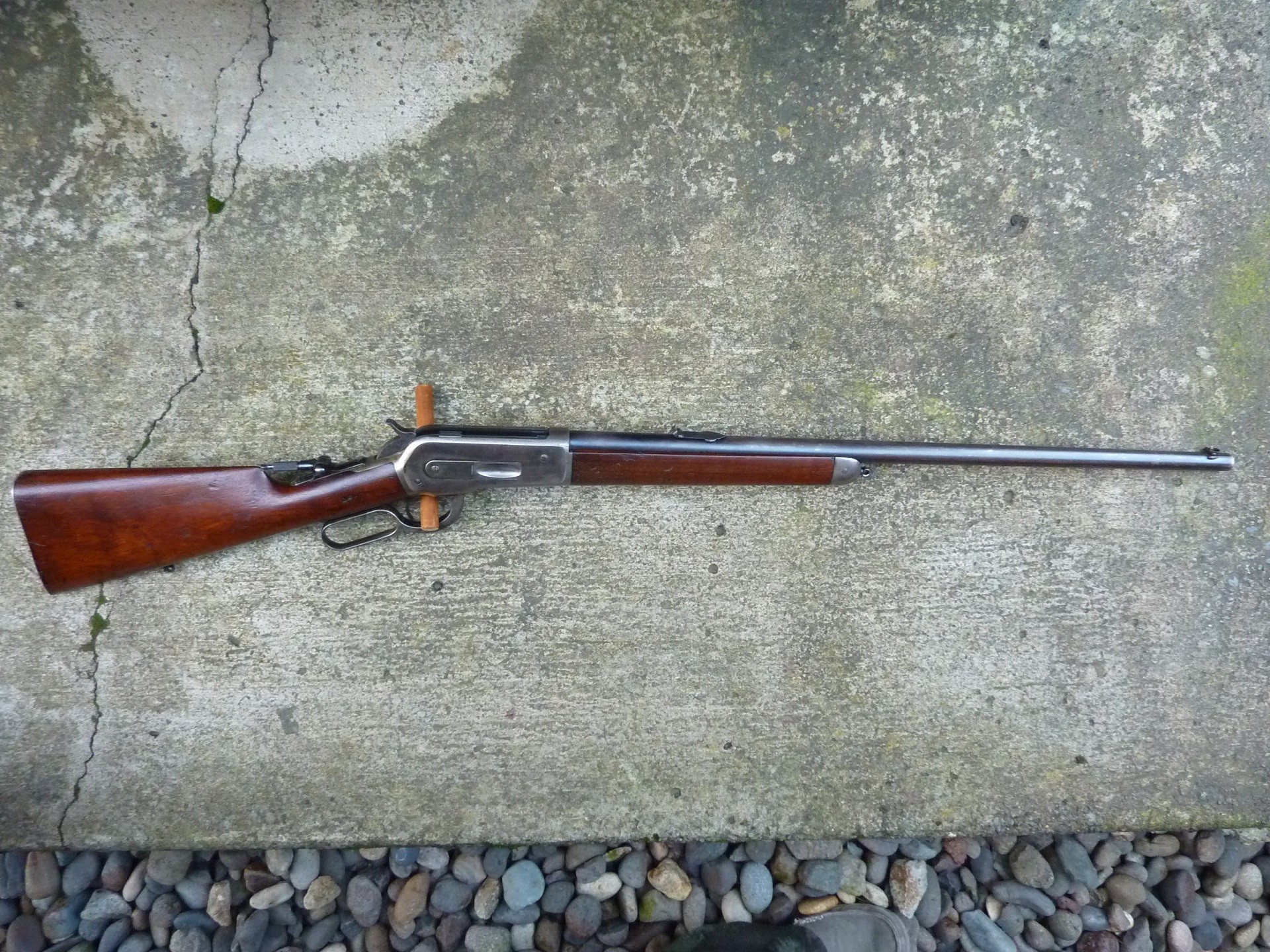

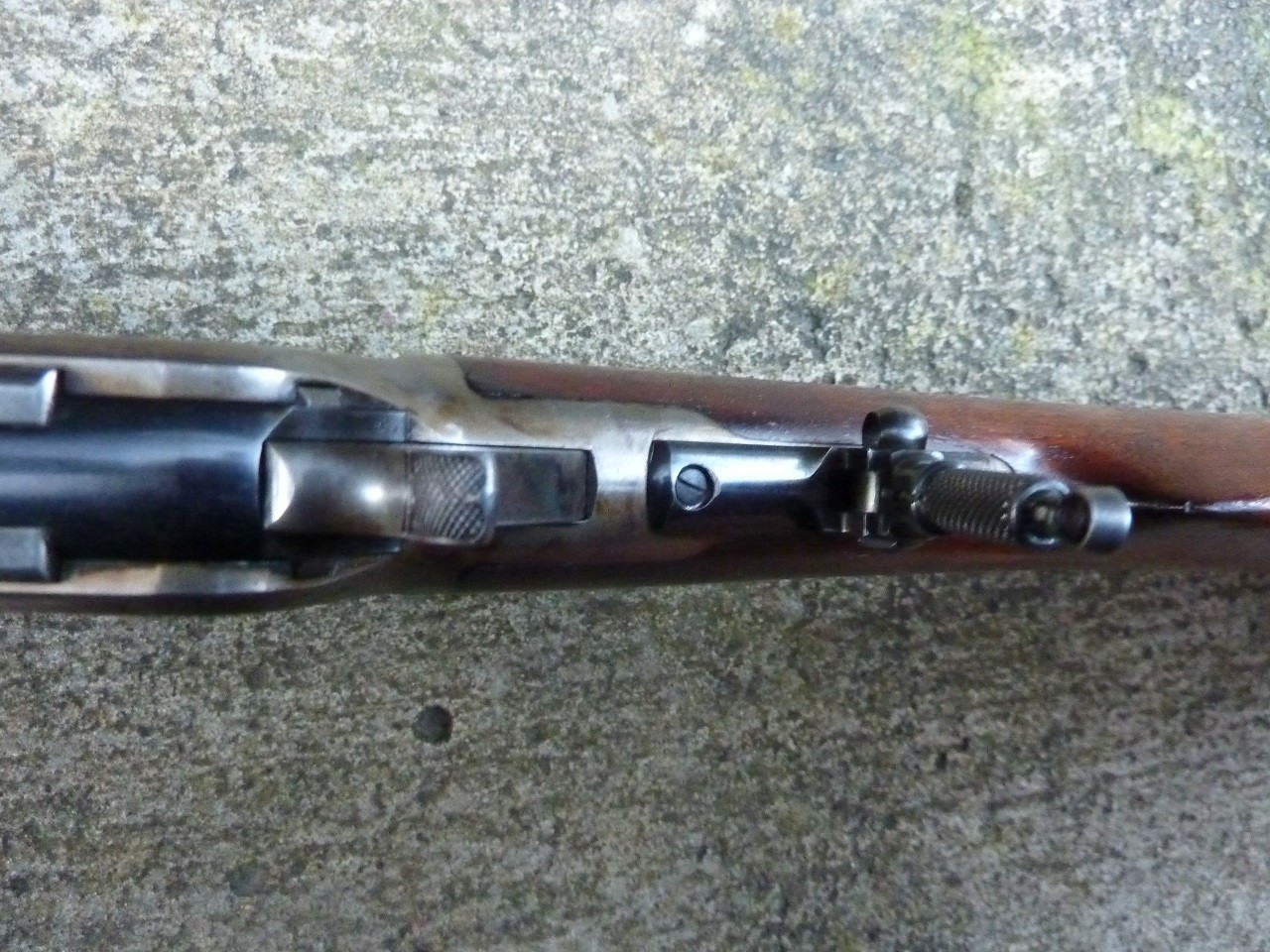

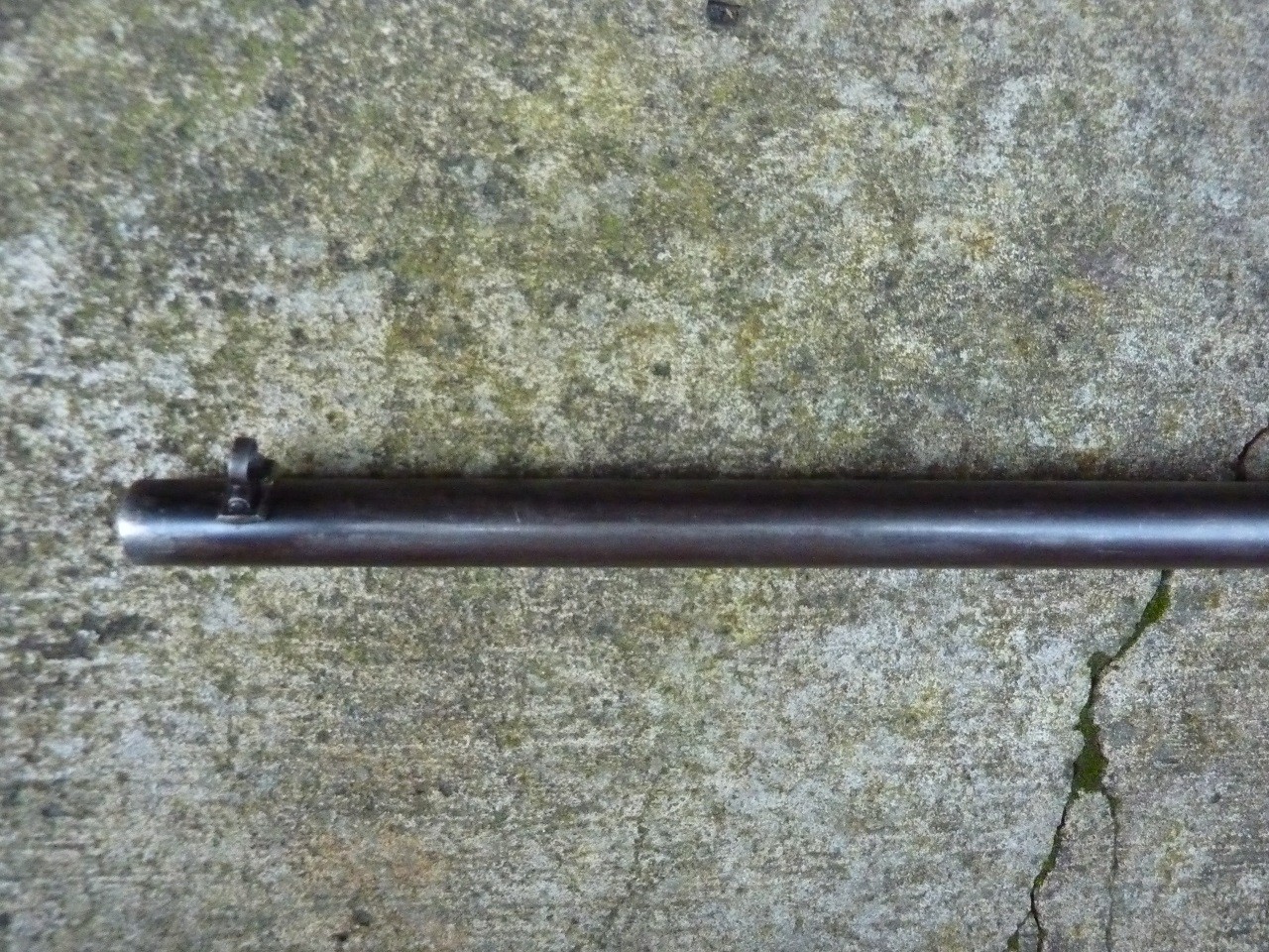

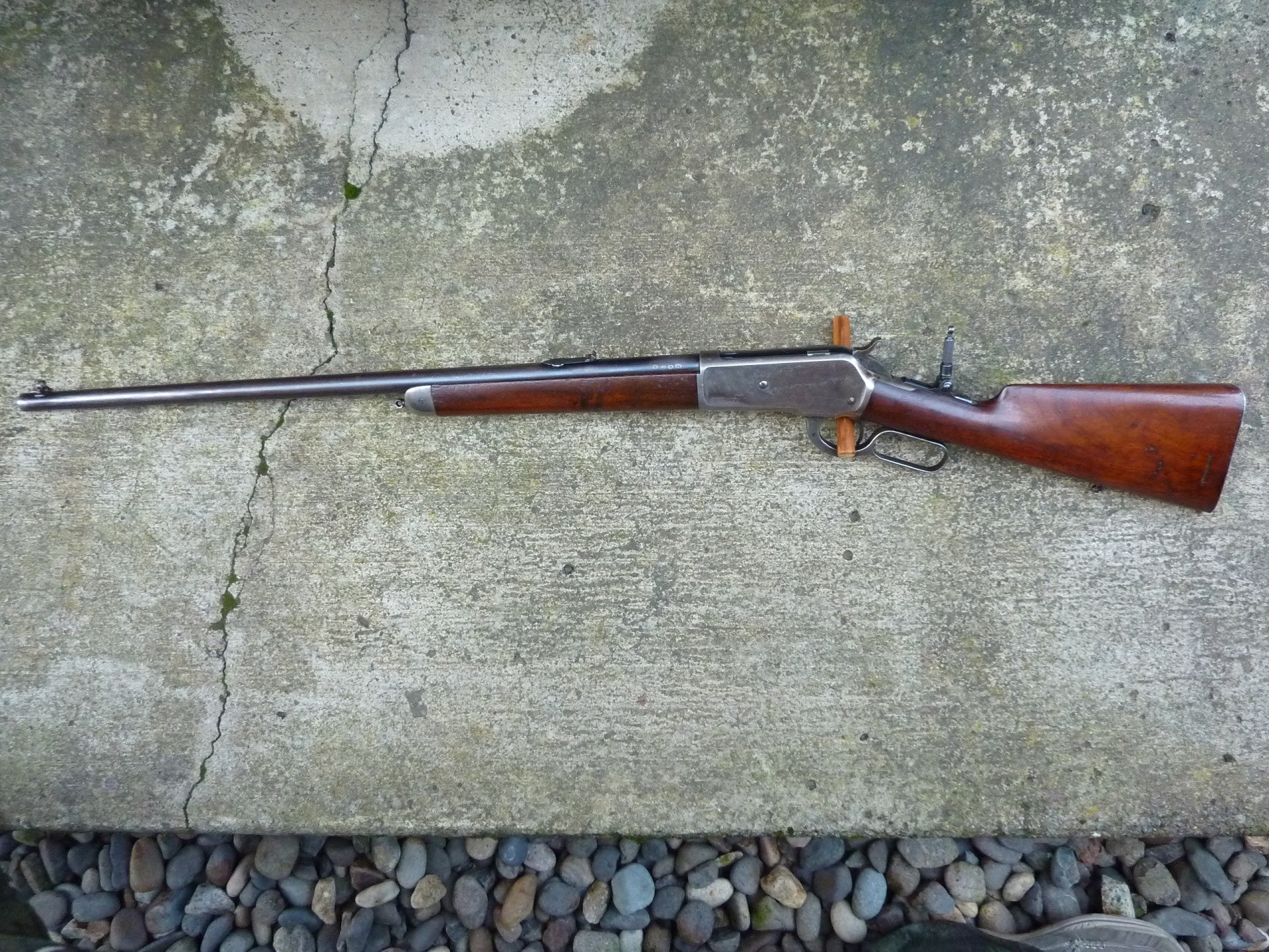

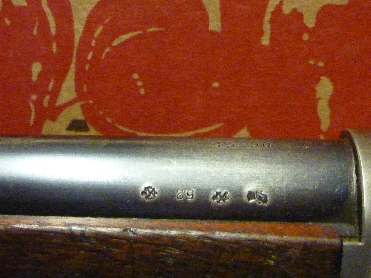

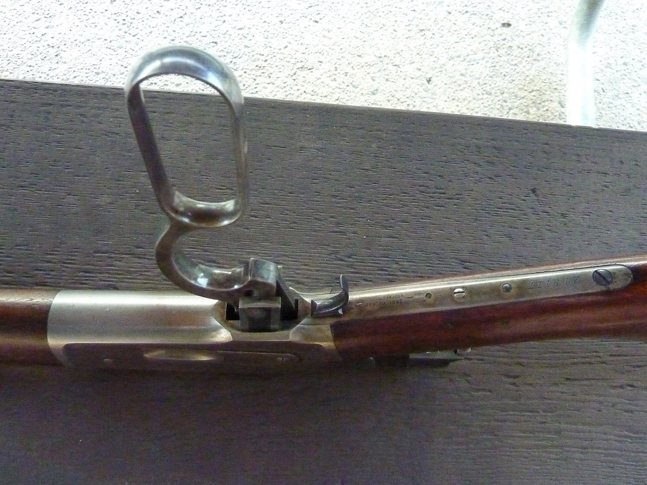

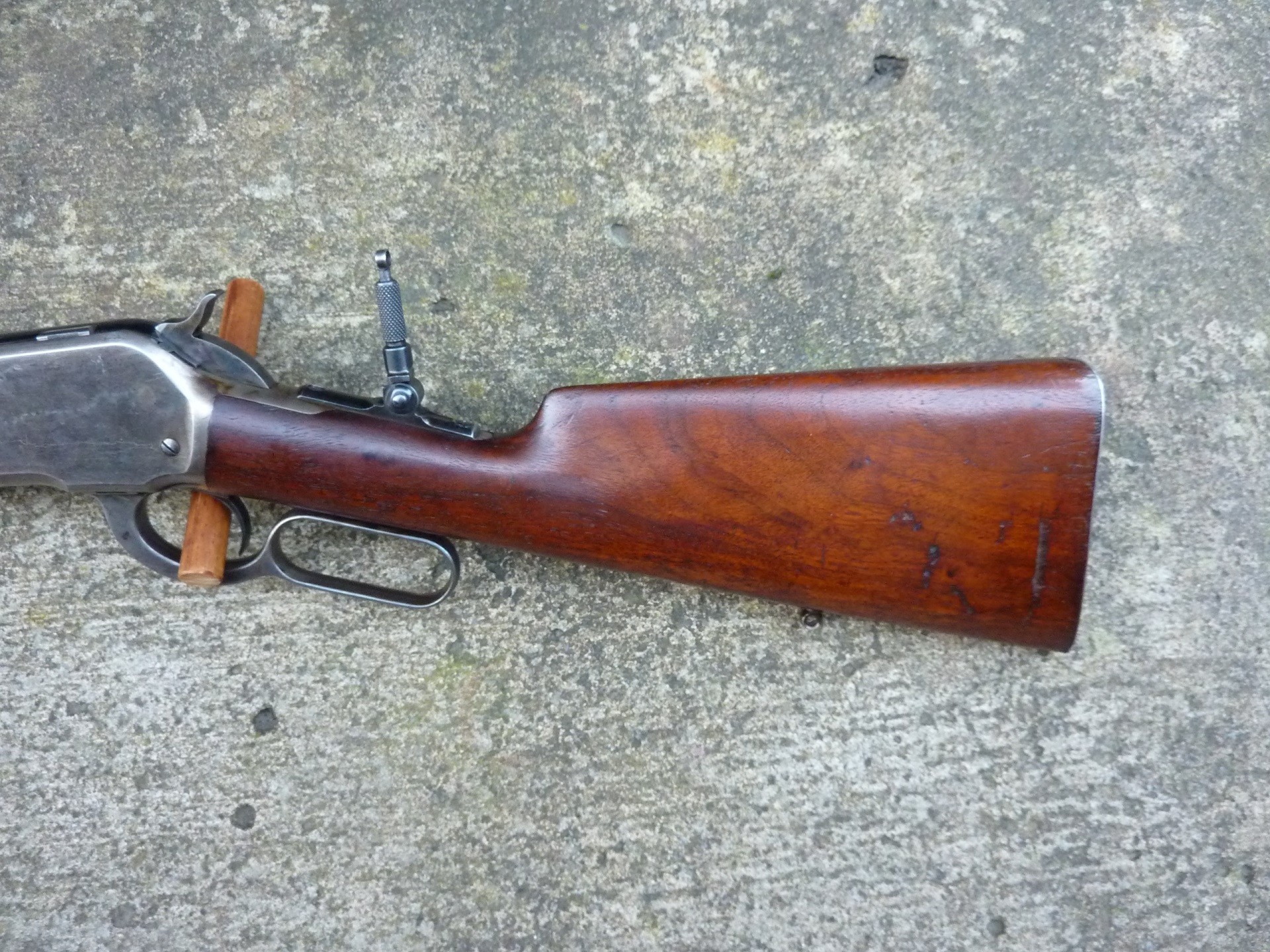

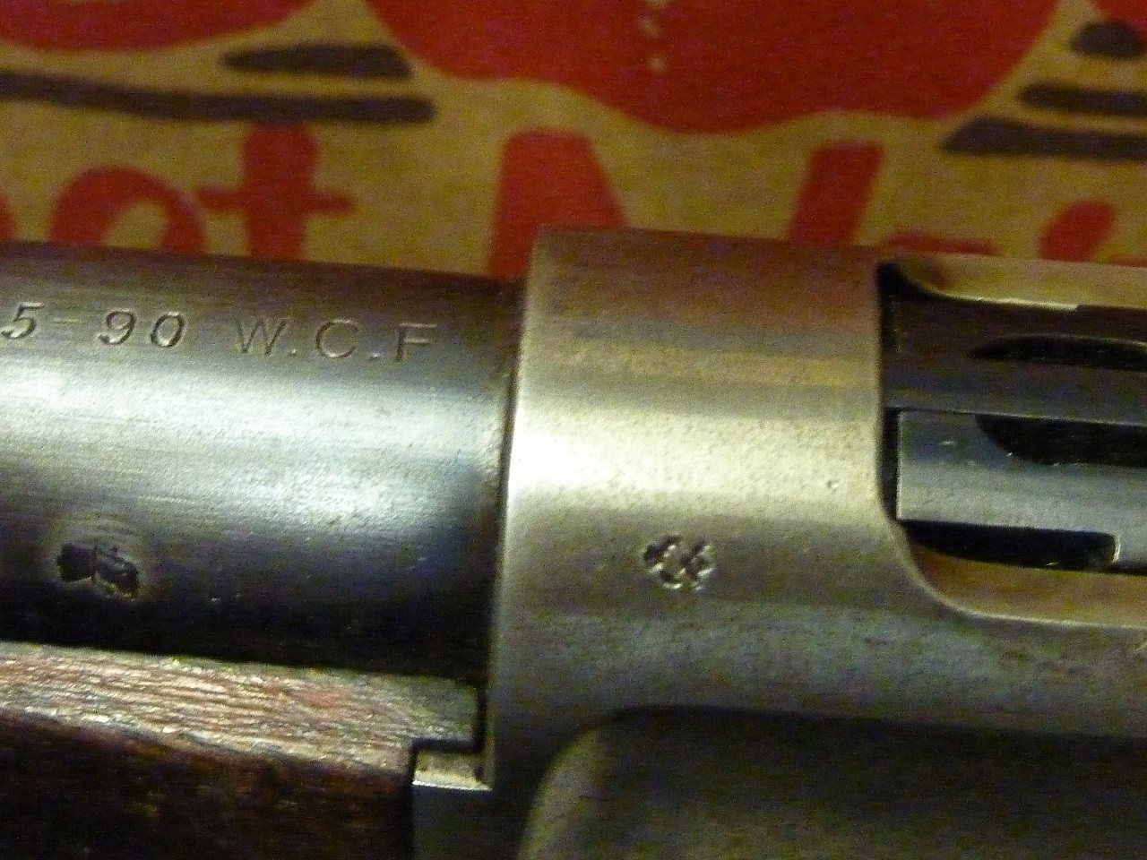

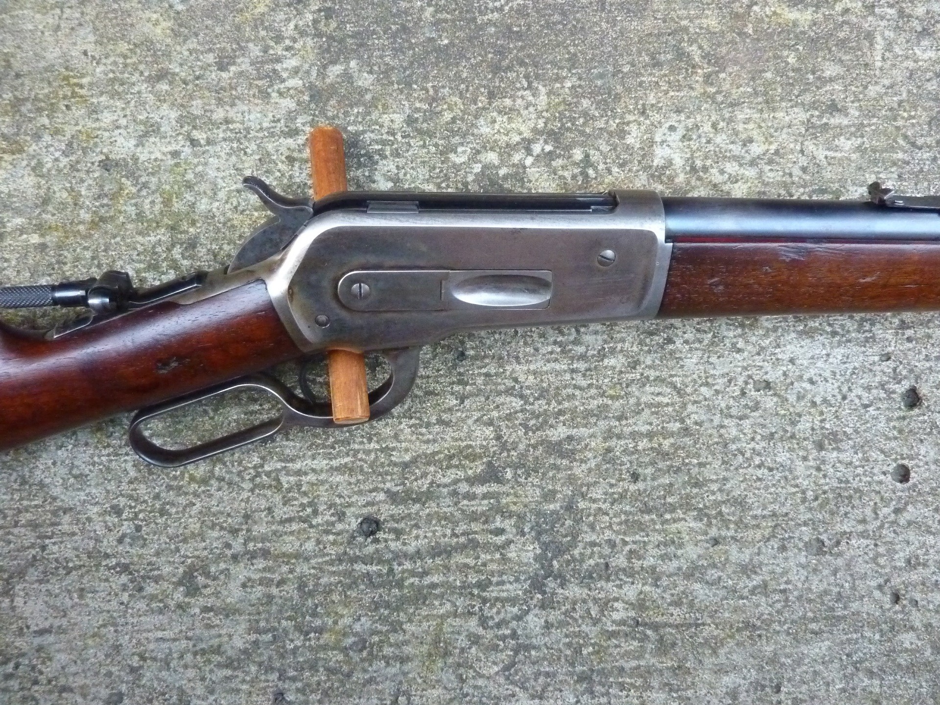

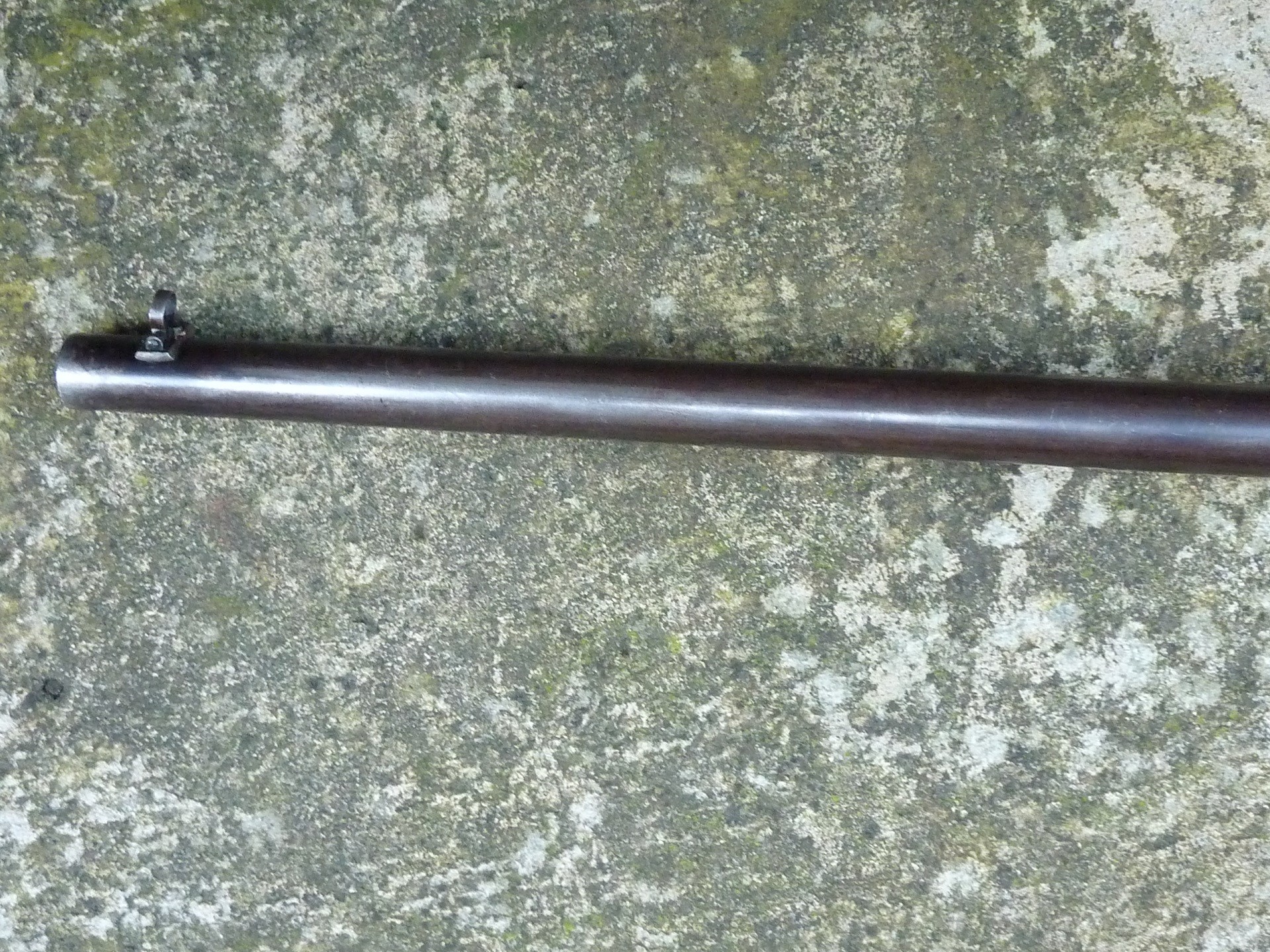

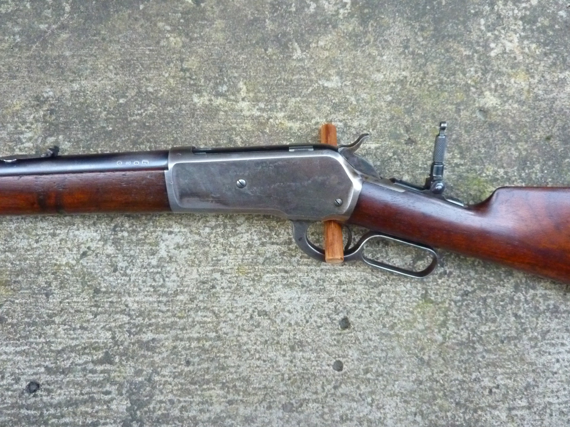

I believe they are London proofs on my rifle.  They are located on the barrel and the receiver.  Here are some additional photos.
P1090724.JPGP1090726.JPGP1090731.JPGP1090761-2.JPGP1090762-1.JPGP1090764-1.JPGP1090765-2.JPGP1090766.JPGP1090767.JPGP1090768-1.JPGP1090771-1.JPGP1090772-1.JPGP1090773-1.JPGP1090774-1.JPGP1090775-1.JPGP1090776-1.JPGP1090777-1.JPGP1090778-1.JPGP1090780-1.JPGP1090782-1.JPGP1090783-1.JPG

Highly likely that they are London/English proof marks.  Someone will have exact answer for each of them.  The front sight and the tang sight was added after it left the factory.  These are nice additions.  The front and rear sling eyes are not as manufactured.  I’ve not seen a front sling eye mounted on the front like that.  Any that I can remember were on the bottom.

I agree the front sight and tang sight were swapped/added after the rifle left the factory.  I too, have never seen another sling swivel attached to the end of magazine tube like this one.  It is very tastefully done and pretty unique, but definitely not done by Winchester. Thinking those may have been added by an English gunsmith back in the day??

Don, those look like Birmingham proof marks to me. Take that with a few large grains of salt however as I am by no means an expert. Regardless, very cool rifle.
