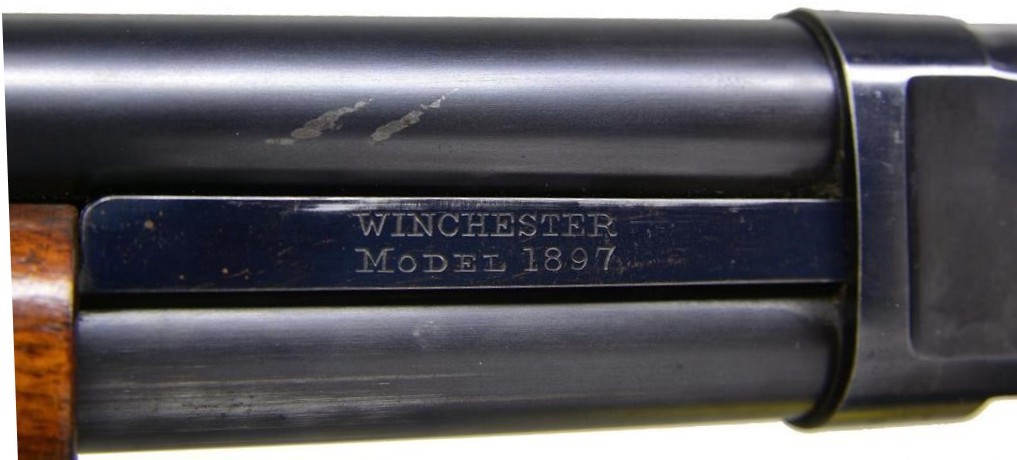

The barrel is evidently not original to the gun.  On the early production Model 1897 shotguns, the Model designation was marked on the slide bar only, and it should look like this;

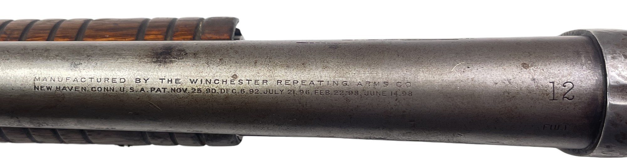

This is what the barrel marking should look like on s/n 67000;

I believe that Ithaca manufactured a line of shotguns with the “WESTERN” moniker marked on the barrels.
