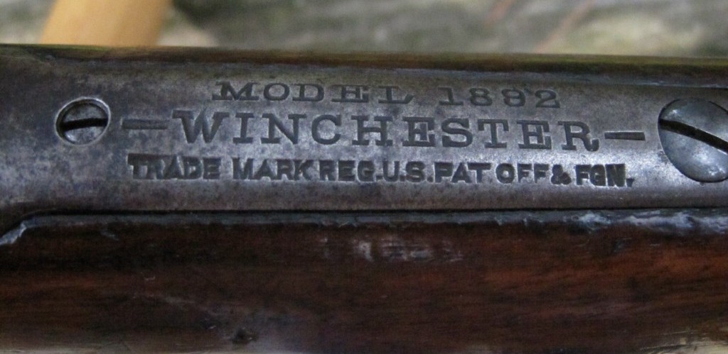

This is a rifle I am looking at that I think may be a parts gun. It is suppose to be a 1917 Model 1892 SRC but, looking at the magazine attachment sleeve and missing carbine barrel band, it looks like a sporting barrel was installed. Am I correct or could it have come this way? C

What you’re looking at is the standard configuration for a ’92 carbine in .25-20 and .32-20.

Hello Cliff,
The gun looks correct.  On the Model 1892 SRC’s all of the 25-20 and 32  WCF caliber examples have the under barrel magazine retaining band and never had the full barrel band like the 38 and 44 WCF rifles.  If it were truly a sporting rifle barrel the rear sight dovetail would be further from the receiver face.  Can I please get the SN of the gun for my survey?

The rifle is an early 1917 vintage gun.  When you get it I would be interested in a photo of the upper tang please.  The Type 4 style, with “&FGN” on the loser line, was just showing up in production at this time period.
Sure thing! What is FGN ?
Forum Posts: 2551
May 14, 2018 - 1:37 pm
FGN is an abbreviation for “Foreign”.
Winchester was trying to discourage all the foreign companies that were making imitation 1892’s so they added FGN to their trademark line to indicate that their patents also were valid in other countries.
But were they? I recall reading that Spain didn’t honor other country’s patents, in fact they had a law to that effect. There were a lot of Spanish copies and some were bad, some were very good. That’s the extent of my knowledge on the subject.     Nice gun by the way, and interesting caliber. Might have to expand my collection.
Actually, the FGN was to stop them from marking their copies “WINCHESTER”.  I guess they could make the copies, they just couldn’t stamp them with the Winchester brand.
