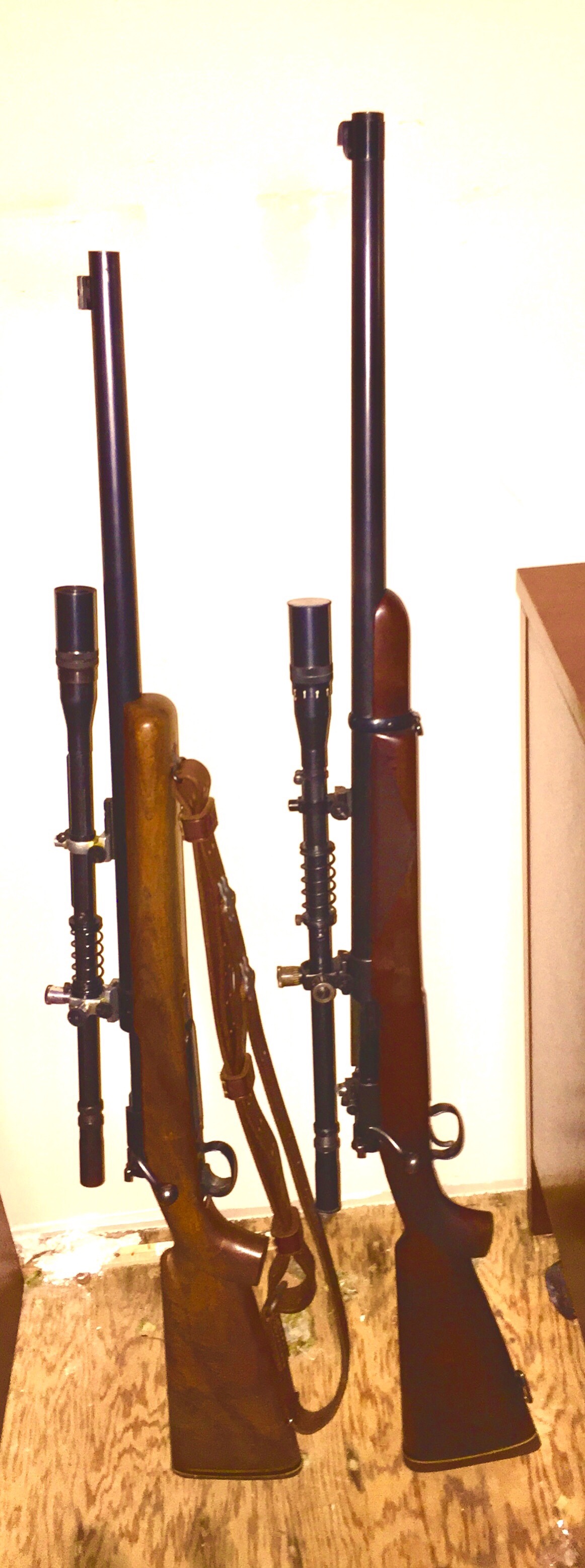

June 13, 2018 - 4:23 am
M54 Target & M54 Sniper Match w/era correct Unertls
 CF8EC7B0-3A0F-4CEE-8632-92404FBC3B56.jpeg M54 Sniper Match

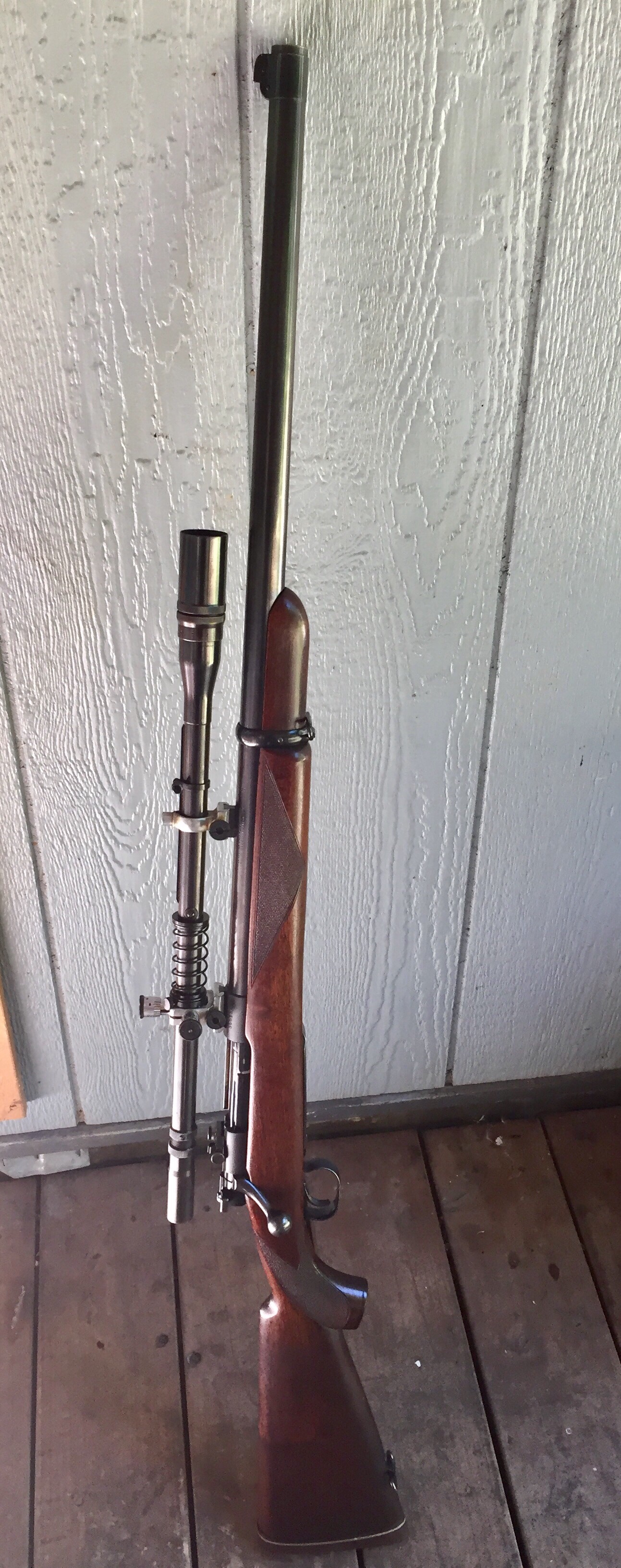

February 3, 2019 - 8:25 pm
Louis Luttrell said
Hi M54-
Not quite sure of your question.
The photo in my last post is a M54 first standard rifle.  The cross dovetail block in the barrel sight dovetail is a Lyman ‘BK’ and the one on the receiver ring is a ‘U’ block.  The scope is an early Unertl 6X small game/gallery scope.  Together the U and BK blocks place the scope tube high enough to clear the M54 bolt handle.  Same would be true using the factory-installed blocks on a M54 target rifle.
Of course with all the drop in that early M54 standard stock one should really add a lace-on cheek rest to raise the shooter’s line of sight a bit.
The M54 and M70 Target Rifles used the same medium heavy straight taper barrel contour, the only difference being that the M54 target barrels had an integral front sight ramp.  The M54 and M70 National Match rifles likewise used the same standard weight barrel contour.  The M54 Sniper’s Match rifle and M70 Bull Gun used the same extra heavy “bull” barrel contour, only difference being the M54 barrel was 26″ long and the M70 barrel was 28″.
Since the barrels differed in diameter, the height of the barrel mounted scope block differed:  0.417″ tall for M54/70 National Match; 0.360″ for M54/70 Target rifle; 0.262″ for Bull Gun.  All used the same 0.185″ tall receiver sight block.
Hope that helps,
