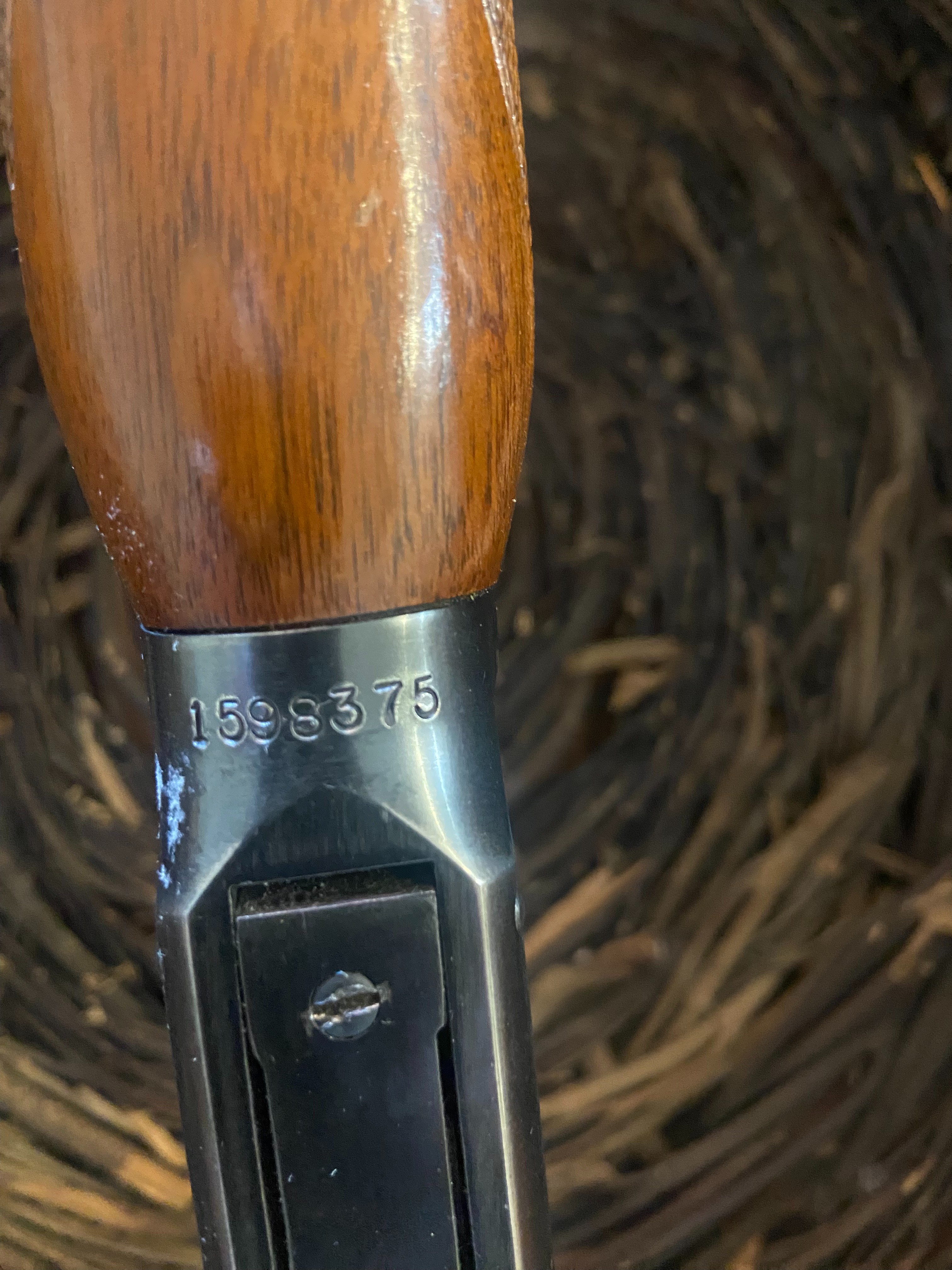

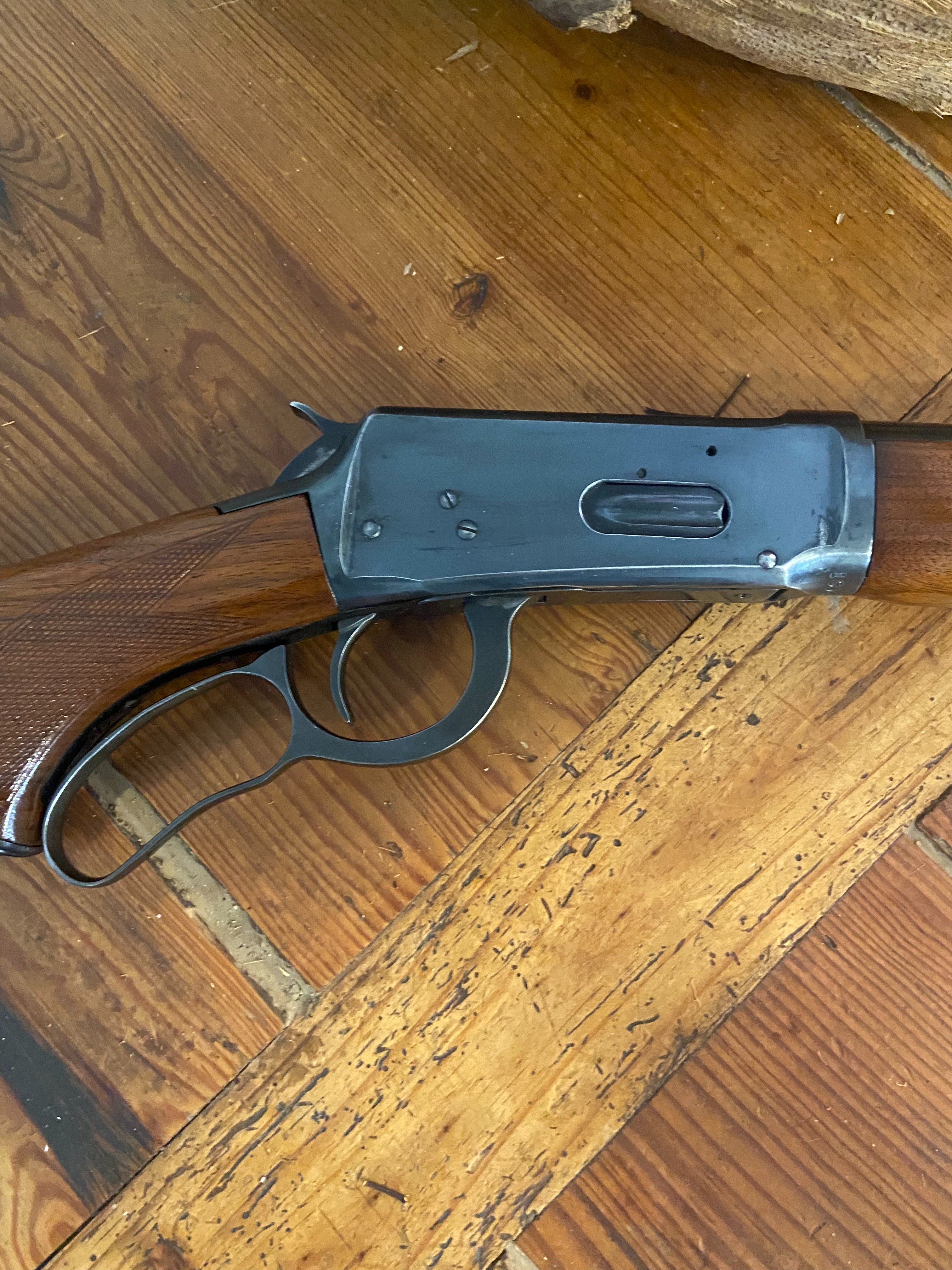

Found another in .32 W.S. > SN:1598375
Forum Posts: 14839
June 8, 2025 - 1:55 am
It appears to be a standard 24-inch Deer Rifle.

Deluxe checkered wood. You think original or added?
Forum Posts: 975
June 8, 2025 - 2:39 pm
The stocks and checkering on the Deer Rifle appear to be factory
Forum Posts: 14839
June 8, 2025 - 4:04 pm
Original, but refinished.  This is right in the middle of several other Model 64 Deer Rifles.

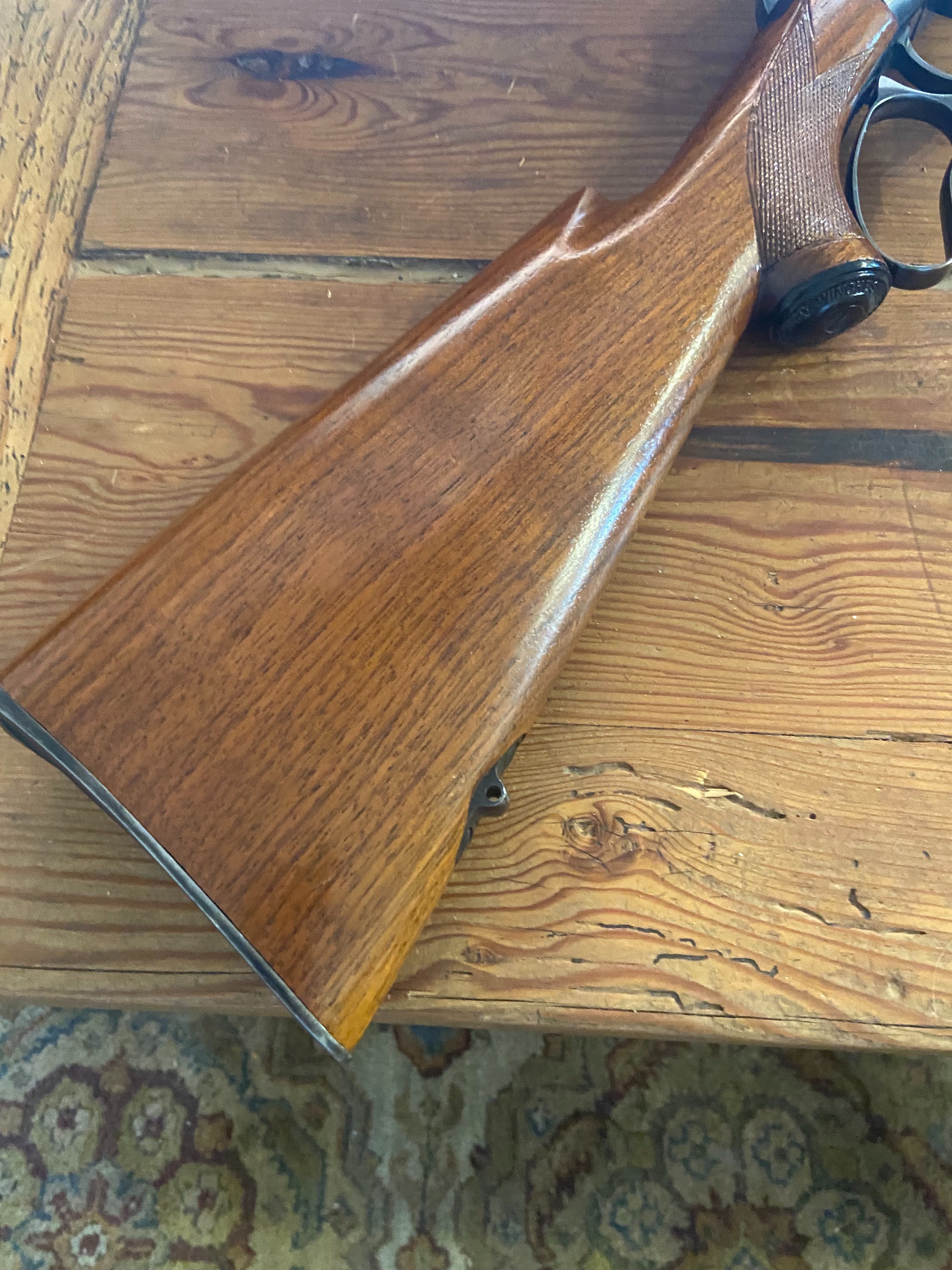

Bert,  With respect to this Deer Rifle, when you say “Original but refinished”, I assume you mean the wood has been refinished? To my less experienced eye, it looks like the buttstock’s underlying color is different, as if Winchester’s original reddish brown homogenizing stain had been removed in the process of removing the original lacquer. The topcoat is also brighter than satin.  It doesn’t appear the semi-beavertail forearm has been subjected (as completely, anyway) to the same treatment. although that may just be the effect of the lighting. What are the clues you see that indicate a refinishing?
We had discussed in the past the phenomenon of Winchester serials having been marked through the original blue on the Model 71, leaving a bright aura surrounding the digits. In looking at an enlargement of the serial on this Deer Rifle on the underside of its receiver,  the same thing looks to have occurred, indicating an original steel finish?

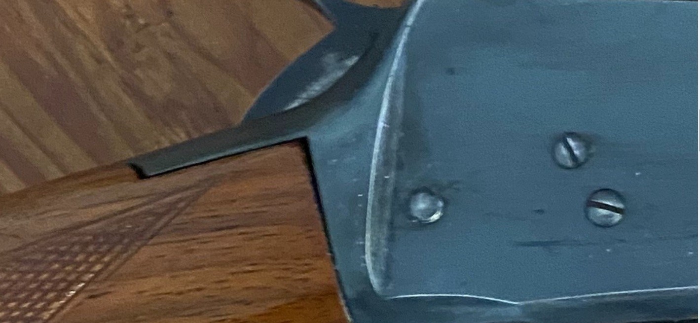

Forum Posts: 14839
June 8, 2025 - 7:05 pm
Bill,
This picture (blown-up to accentuate it) clearly shows that the butt stock has been refinished.  The fit is now atrociously poor.
Forum Posts: 2433
June 8, 2025 - 8:54 pm
Thanks, this is how I learn.  The refinisher distorted the tang and rear receiver inletting while removing the old finish and prepping for a new topcoat. Do you think the forearm was refinished?
Forum Posts: 14839
June 8, 2025 - 10:07 pm
Yes I do believe it has been refinished.  A close view of the fit at of the forend stock nosecap would help.

June 9, 2025 - 11:54 am
You can also see the butt plate to stock fit is off indicating the stock was sanded.
Forum Posts: 2433
June 9, 2025 - 2:16 pm
Hey, Steve.  Yes, I can see where the edge of the wood has been slightly rounded over in spots.
It strikes me that those flaws could be remediated by a skilled stockmaker.  With a rasp and some inletting black, buttplate junction could be corrected without too much effort, although it might mean re-blueing the buttplate.
Deepening the multiple surfaces of the wrist inletting would separate the journeyman from the masters and avoiding a receiver reblue might be tricky.
I know final.fitting of buttplates was done at the factory by attaching the buttplate and sanding the assembly but that’s a one-time job.
I’ve seen fixtures gunmakers employ to hold stocks at both ends and wonder if someone who anticipated refinishing stocks with complex inletting like those for the Model 94, wouldn’t have fabricated fixtures from abandoned parts to protect the inletting from over-sanding.
The wood on my old Model 92 25/20 rifle had been so abused by amateur refinishing that a well-regarded custom gunmaker charged with saving the gun could do nothing but scrap the wood.and order replacements.

Wood doesn’t match the metal; fit or condition. I’m wondering if that might be replacement wood, sure looks nicer than the rest of the rifle.
