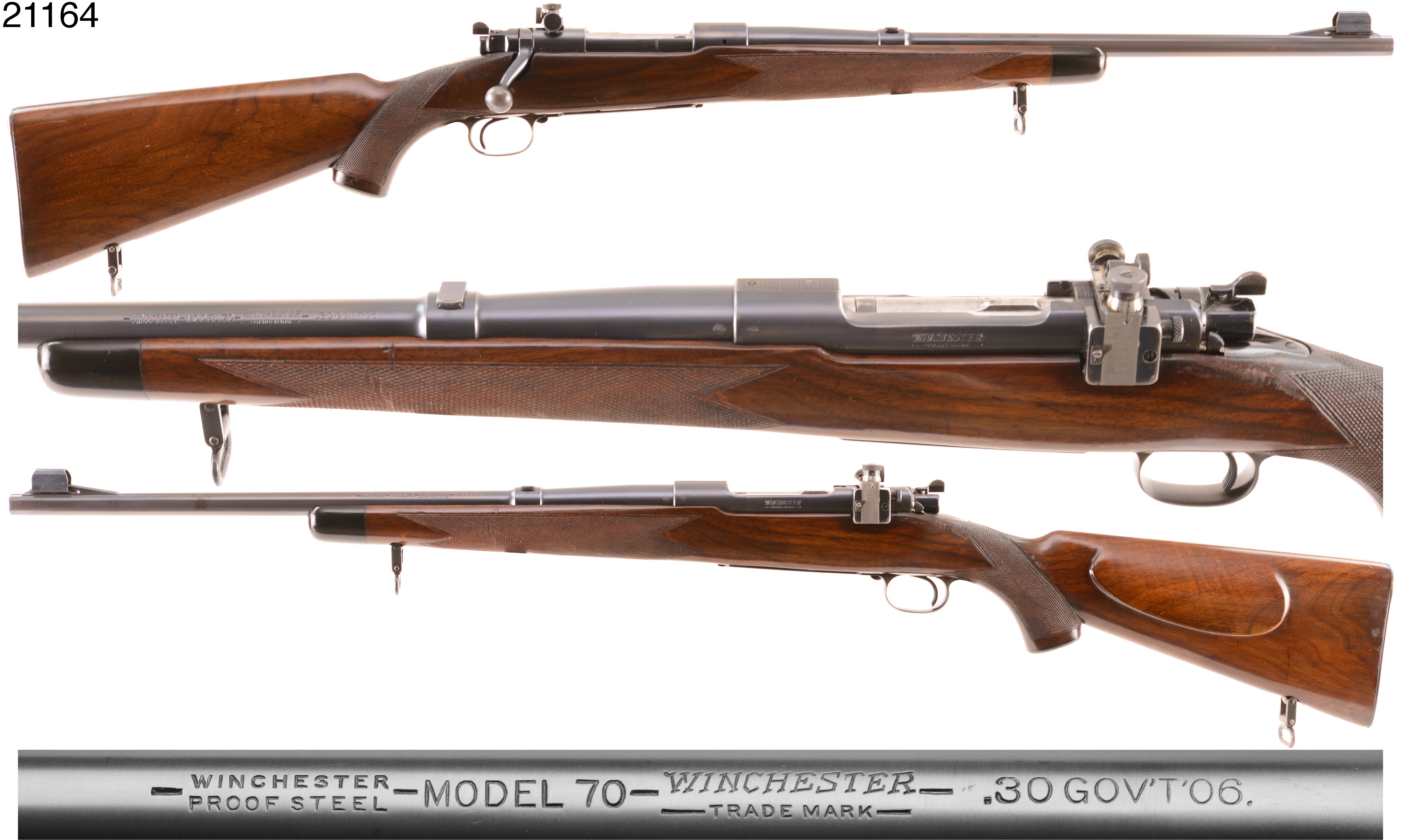

OfflineAt the risk of showing everyone that I am a total fool, I did buy this gun earlier this year. “Super Grade Carbine” 30 GOV’T’06 (s/n 21164). I am NOT saying that I believe ANY Super Grade Carbine to be genuine, but at least this one is made of all the right parts/finishes and has handling wear/marks consistent with the parts being together a long time. IMHO it’s what a 1938 Super Grade Carbine SHOULD look like if there ever were a “real” one…

I never said my SG Carbine is “real”, nor did I say I believe it to be “real”… Only that if it was “upgraded” outside the factory (likely) it was done with the right parts (unlike the GB listing).

OfflineLouis, Like many Model 70 Collectors when I see a Super Grade Carbine I automatically assume that it is a made up gun. If Winchester in fact made a Super Grade Carbine I would expect it to be in .30Gov’t06 chambering. Since we know that this is by far the most popular chambering you would think that you would see more Super Grade Carbines in that chambering. This is not the case. If Winchester made such a thing, I agree that it would be the gun that you posted.
Lou,
I like everything about you’re example. Bo brings up some good points also. You gents have made me aware enough to surly be careful out there, as my reckless nature can sometimes get me in trouble. LOL!
