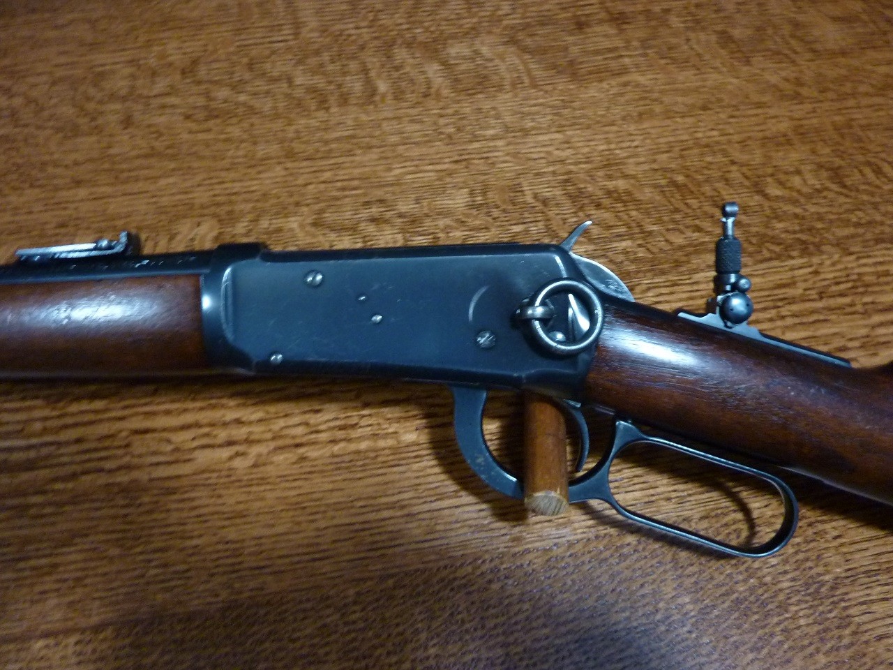

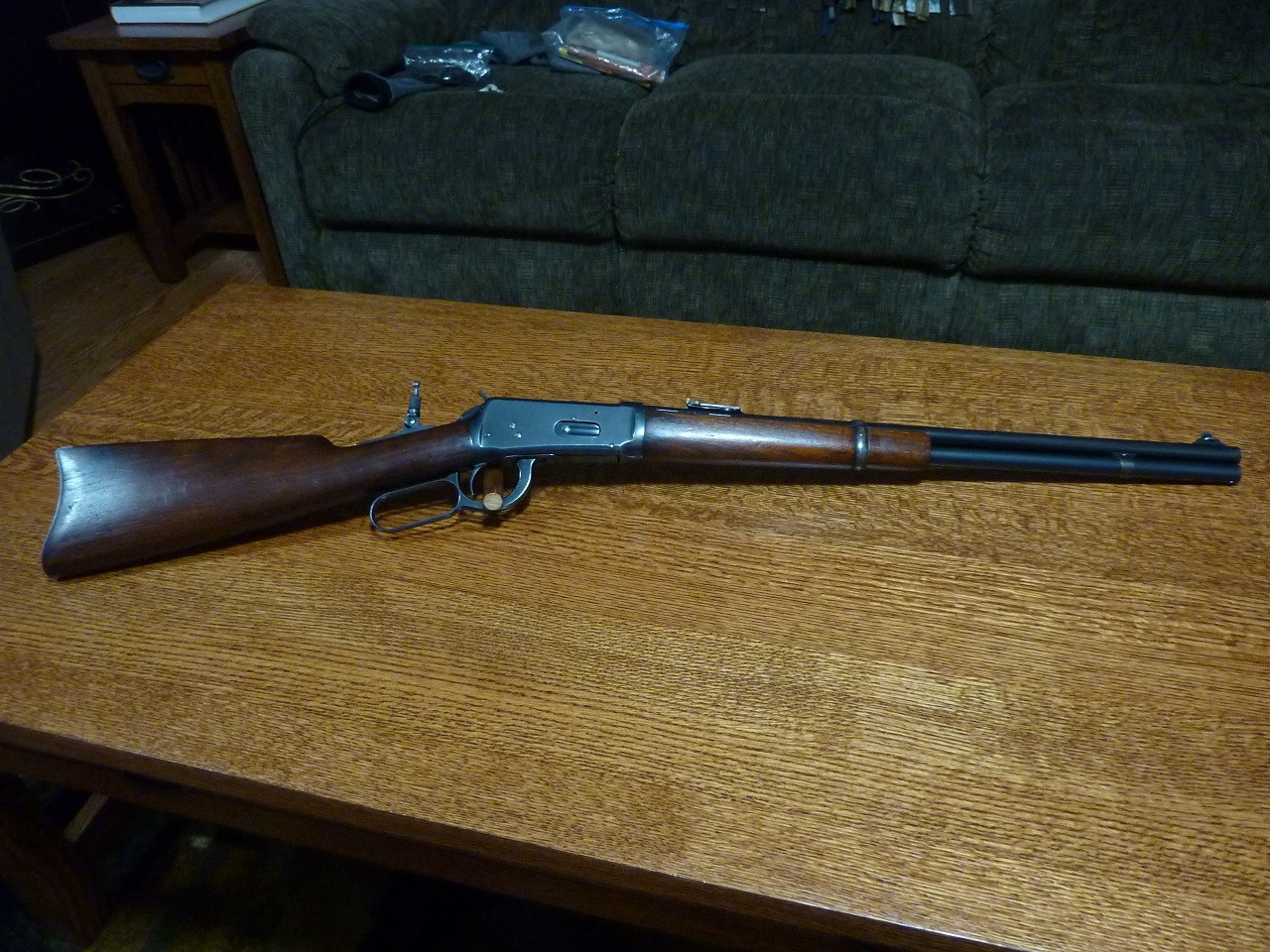

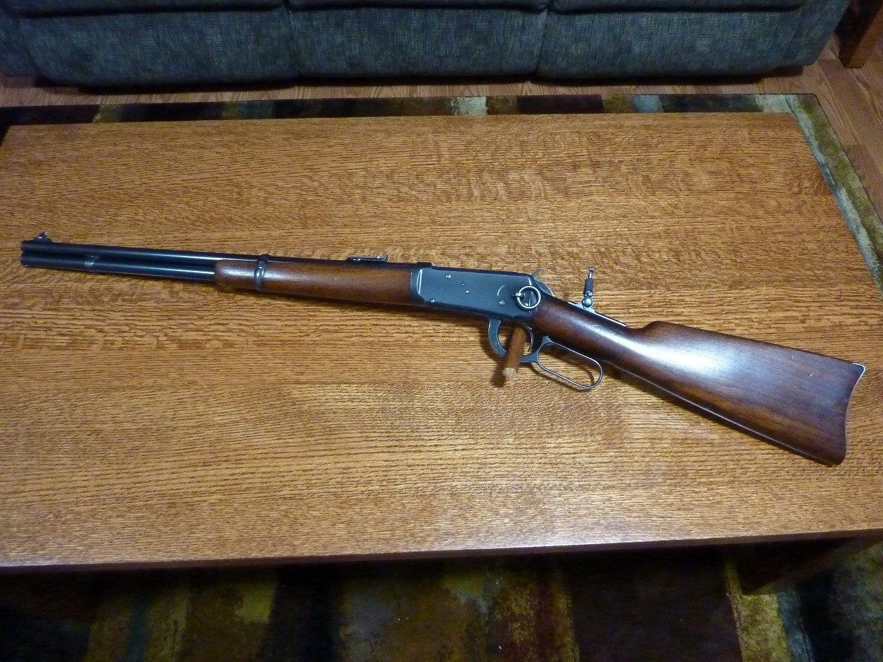

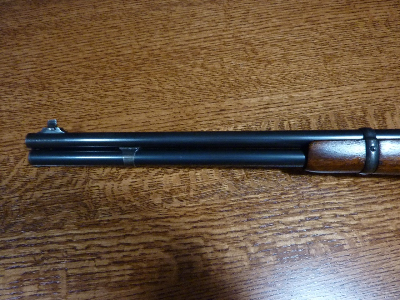

Bert, do you have Model 94 SRC, serial number 1040794 in your survey? Jessica says Feb. 5, 1929 for this one, clearly a standard carbine with saddle ring, carbine butt plate, nickel steel marked barrel, Marbles 94C stud type front sight, 95L folding rear sight, Lyman DA tang, 30 WCF. I bought this 30 years ago at the old Dry Creek Hardware in Fredericksburg, Texas.
Forum Posts: 14960
June 14, 2019 - 9:12 pm
No, I did not have it, but I do now.
