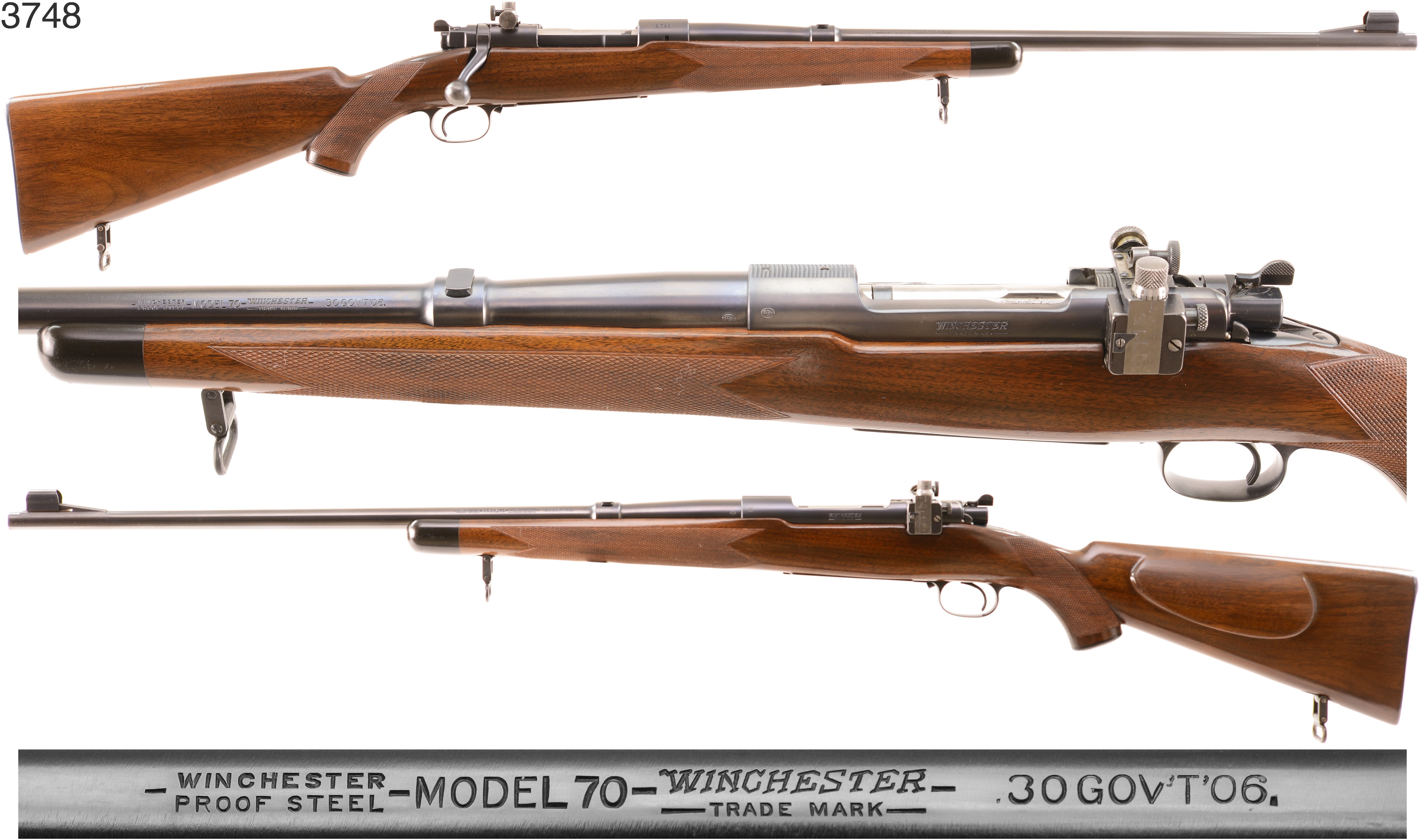

Anyway, assuming it’s the Super Grade, S/N 12723 was made in late 1937.  The condition of the rifle appears to be very good.  The rifle has the early front sling swivel placement, and I’m assuming that is a Redfield full gold front sight (photo is dark but it looks like one).  The sling looks to be the one Winchester would have provided with the rifle.  The wear to the floor plate is very common on the early guns where the bottom metal was charcoal blued.  The only major distraction is that the receiver was drilled on the bridge for the Redfield JR scope mount base.
So… As to value…  IMHO a completely unaltered (no added hole) 1937 vintage 30 GOV’T’06 Super Grade in excellent condition is about a $5,000 gun.  I’ll show a slightly earlier one (with factory Lyman 48WJ receiver sight) below.  How much the hole in the bridge hurts the value depends on the buyer, but I’d say knock off a third.  The Lyman scope (with good finish and clear glass) could itself bring $250 to $300.  So my guess at value would be around $3750 for rifle and scope.

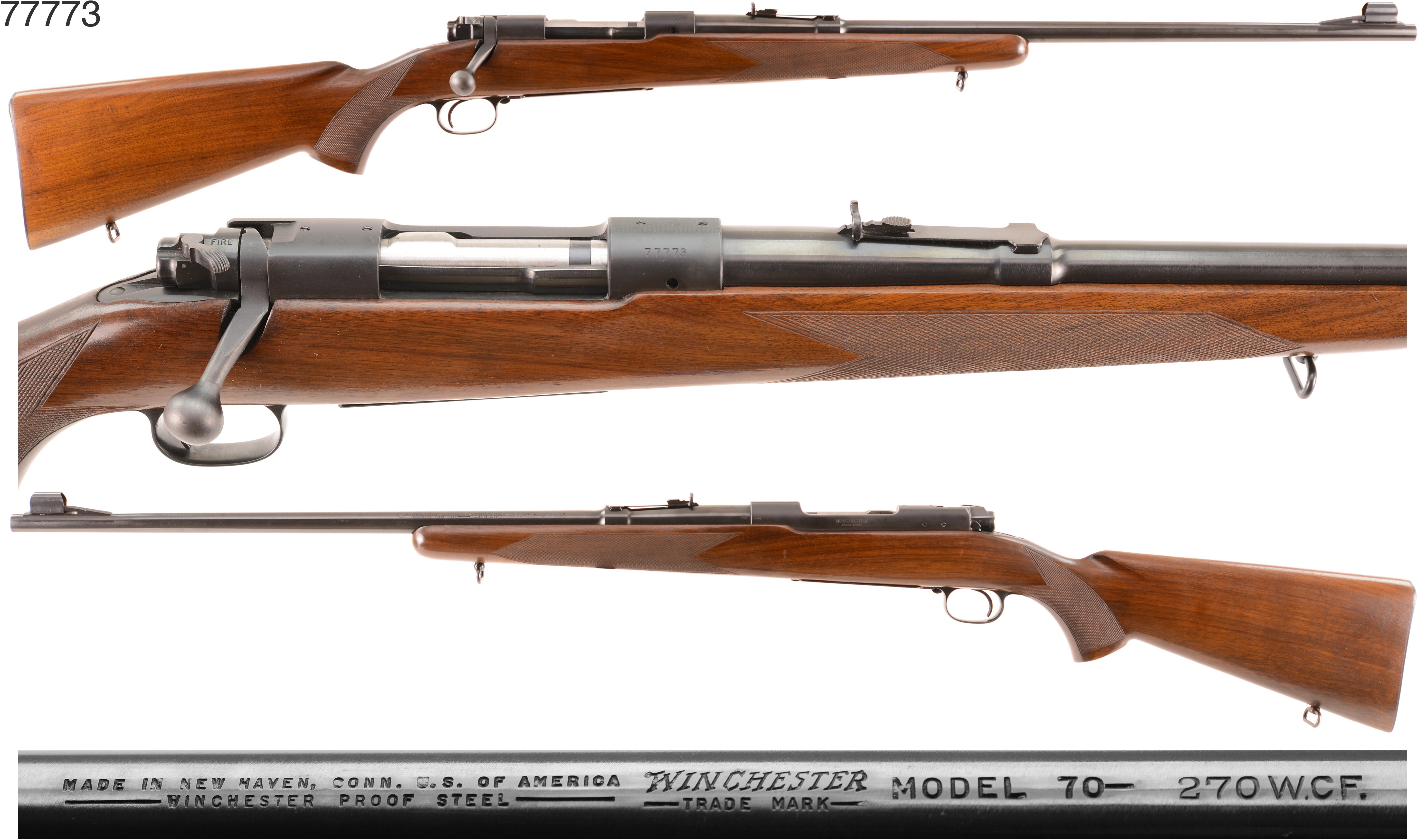

It’s hard to give a value on the second rifle without some pics to estimate graded condition.  Assuming the serial number is 61978, then it’s a “transition” era gun.  Good news is that those receivers had a bridge that was smooth on top with two factory drilled holes.  So the addition of a scope doesn’t hurt value.  Of course, Standard rifles bring less than Super Grades, transition rifles bring less than unaltered pre-war guns, and 30 GOV’T’06 was the most common caliber.  Still, assuming it’s in true excellent condition, I’d put it in the $2800 range (again plus the value of the scope).  The gun I’m picturing below is what it should look like, except mine is a 270 WCF.  Any detractions, like an added recoil pad, would cut that value in half IMHO.
