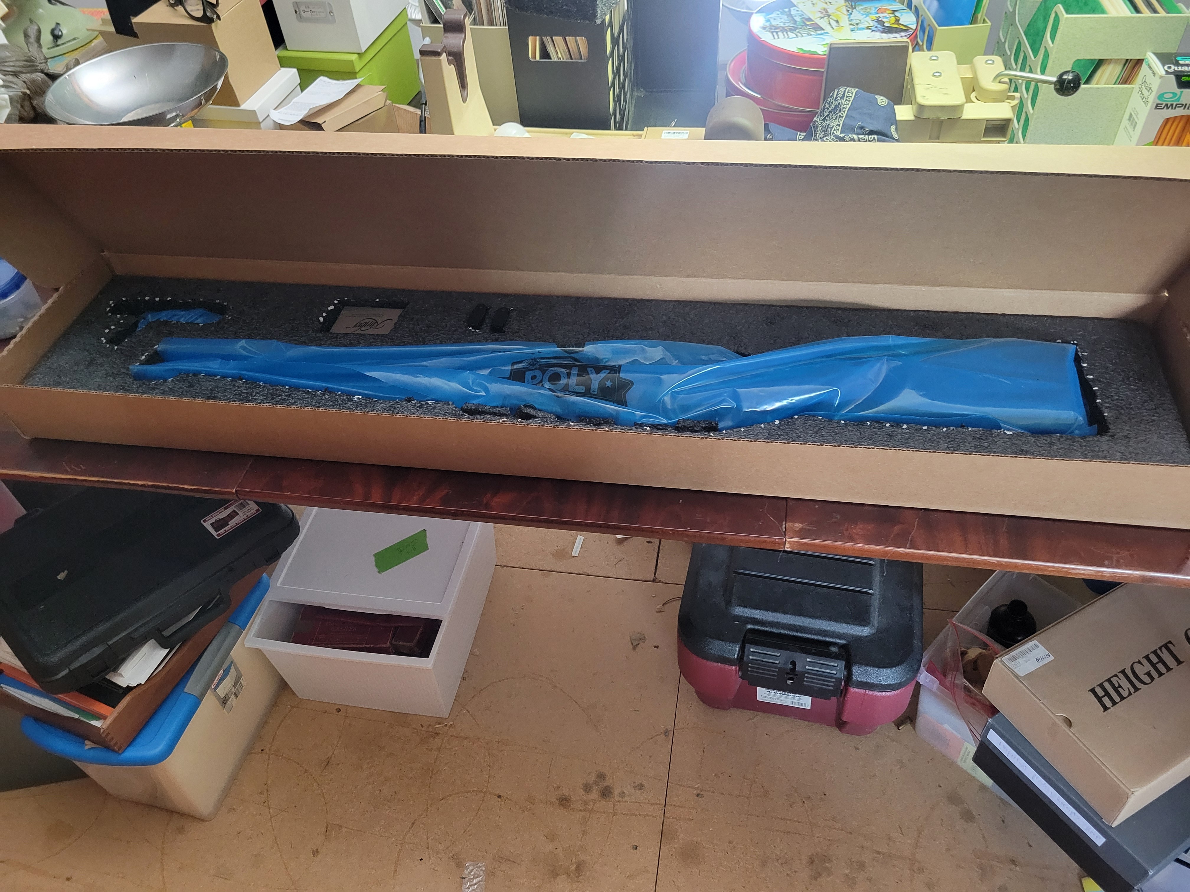

Before you buy anything, go look at what Cameron Packaging of Lima Ohio offers as its Custom Rifle Kit. It consists of a heavy cardboard outer box,  three layers of cross-linked foam inserts cut to fit tightly in the box. There is also a large swatch of anti-rust impregnated sheeting, in which the rifle is to be wrapped.
  1. The rifle is laid out on the middle layer of foam and its outline cut out with a razor knife or, more easily, with a hot knife. [Cross-linked foam is what marine docking fenders are made of.]
  2. The middle layer of foam is placed over the bottom layer.
  3. The rifle is wrapped in the anti-rust sheeting and placed into the outlined and cut cavity of the middle layer.
  4. The top layer is placed over the middle layer and the three-layer sandwich is fitted into the box, which is sealed – preferably with hot glue and shipping tape.
These kits are not cheaper than the plastic case you propose to use, but I’ve never had a firearm damaged in the twenty years I’ve used them. Even when the box itself was damaged.

What I have done over the years when returning an engraved rifle to a client is buy a inexpensive ,about $50$, hard case on Amazon. I get it postage free and it comes in a cardboard box that I use when shipping the gun to the client  Serves two purposes, cheap shipping container and it give the owner a hardcase to protect his investment.
Forum Posts: 2519
September 11, 2026 - 2:37 pm
Martin’s method is less expensive than Cameron’s – I have to order 4 or 6 at a time to spread the UPS Ground carriage fee from Ohio to Texas. The last order worked out to about $57 USD per kit. J
I’ve received the last couple of long guns I’ve bought, shipped in the manner Martin uses and they came safely to hand. I might throw in a couple packs of silica gel if I used that method, in case the box got shipped by mistake to Outer Slobovia.
