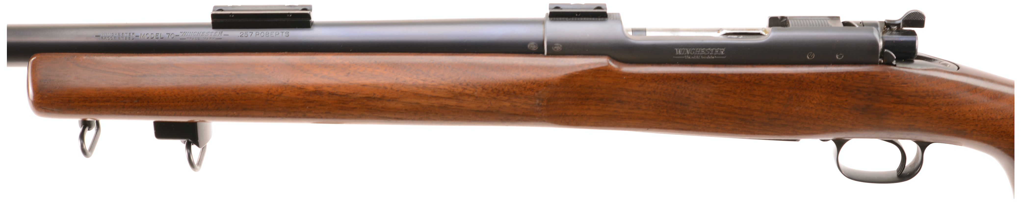

The factory scope blocks on a Model 70 Target rifle went on the front receiver ring and barrel. Like this:
The receiver block was 0.185″ high, equivalent to the Unertl or Lyman “U” code block.  The barrel hole spacing is 1.76″ according to the blueprints. The barrel block for the Target Model was 0.360″ tall (heights are measured as though the block was sitting on a flat surface, this is not the height of the top of the block above the top of a round barrel).  The National Match used a 0.470″ tall block and the Bull Gun (originally) used a 0.262″ tall block that was flat on top like a Unertl B-70.
As for style, the factory blocks were what I call “Lyman-type” and were coved on top to facilitate use of the metallic sights when the scope was removed.  The pre-war blocks (common until at least the mid-1950s) had both “Unertl crescents” on the right and “Winchester dimples” on the left side. The dimples may be visible in the photo above. They only matter if installing a Winchester A5 or Lyman 5A type scope that anchored to the block via “pins” on the left side.  For pretty much anything else you don’t need the dimples.
