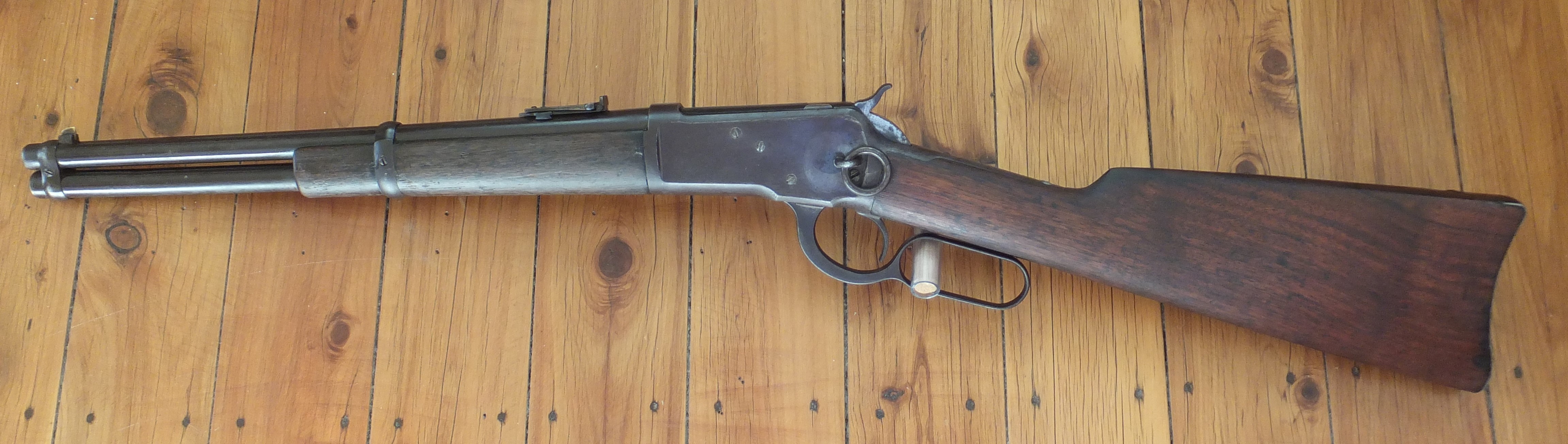

37
July 6, 2024 - 6:18 am
This carbine is about 90% deep brown, with a little of grey starting to show, being an early gun 1897, am I right it would have been rust blued, and the blue has now turned to brown ?
Forum Posts: 14841
38
July 6, 2024 - 6:23 am
Tony,
The barrel and magazine tube were rust blued.  The receiver frame was machine blued, and the hammer & lever were case color finished.  I can’t tell for sure, but it appears that your Model 1892 SRC was refinished albeit a long time ago.
