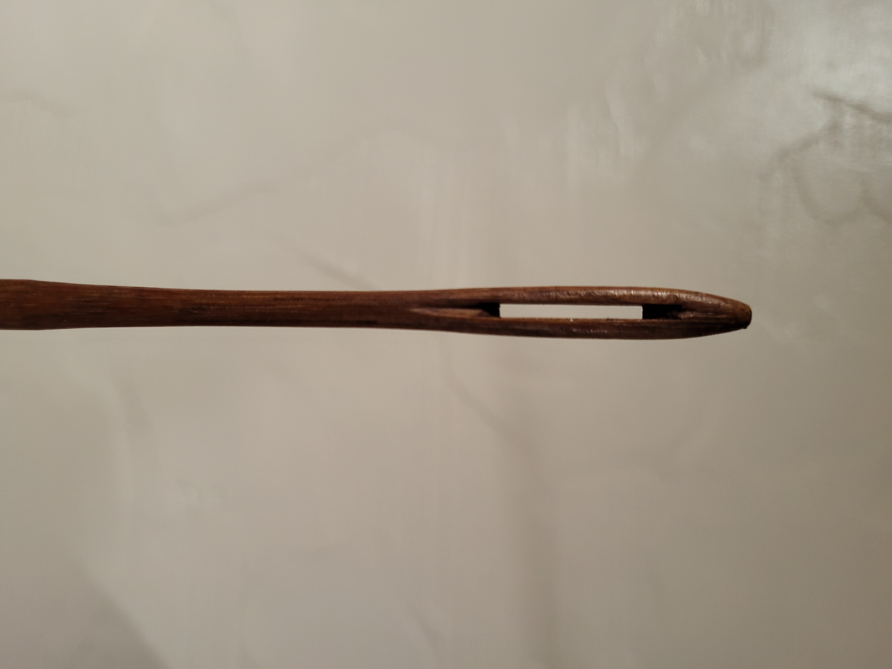

Forum Posts: 8
July 15, 2015
July 25, 2025 - 4:37 am
winchester nix said
Tim Tomlinson said that his son “has a model 1892 in .32 WCF that came with its original hickory wiping rod.  It is an unjointed, one piece rod”
I wonder if Tim could ask his son to measure the rod and compare the measurements to mine.
I really thank Maverick for producing the evidence that one piece hickory wiping rods were supplied with the Model 1892.
Oh boy am I late to this party.
The cleaning rod is exactly 30″ long, has a butt diameter of 0.274″ tapering consistently to 0.265″ at the 15″ mark and 0.260″ just ahead of the flat for the cleaning eye, 0.261″ at the widest spot of the eye, and has a noticeable bow in it likely from its prolonged storage in that PVC tube.  Given its age I’m unwilling to test its flexibility.  It is solid wood with no metal components, joints, or markings anywhere on it, and has an oil finish similar to period gunstocks and is a rich reddish-brown.
