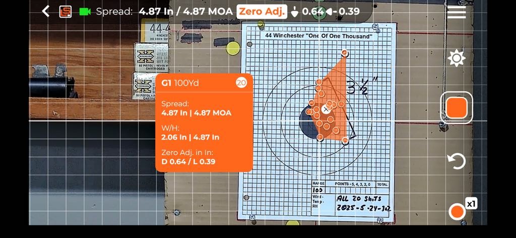

Absolutely, however…one thing to consider is that this is an example of the separation of a rifle cartridge from a pistol cartridge. That 44 Special is one accurate cartridge!!!
However, my experience is that I got a bit more velocity out of the 44-40 revolver load with 36gr of FFg BP. I thought, may have to check…was 950fps. Same as my Reloder 7 rifle loads at 300 yards impact velocity.

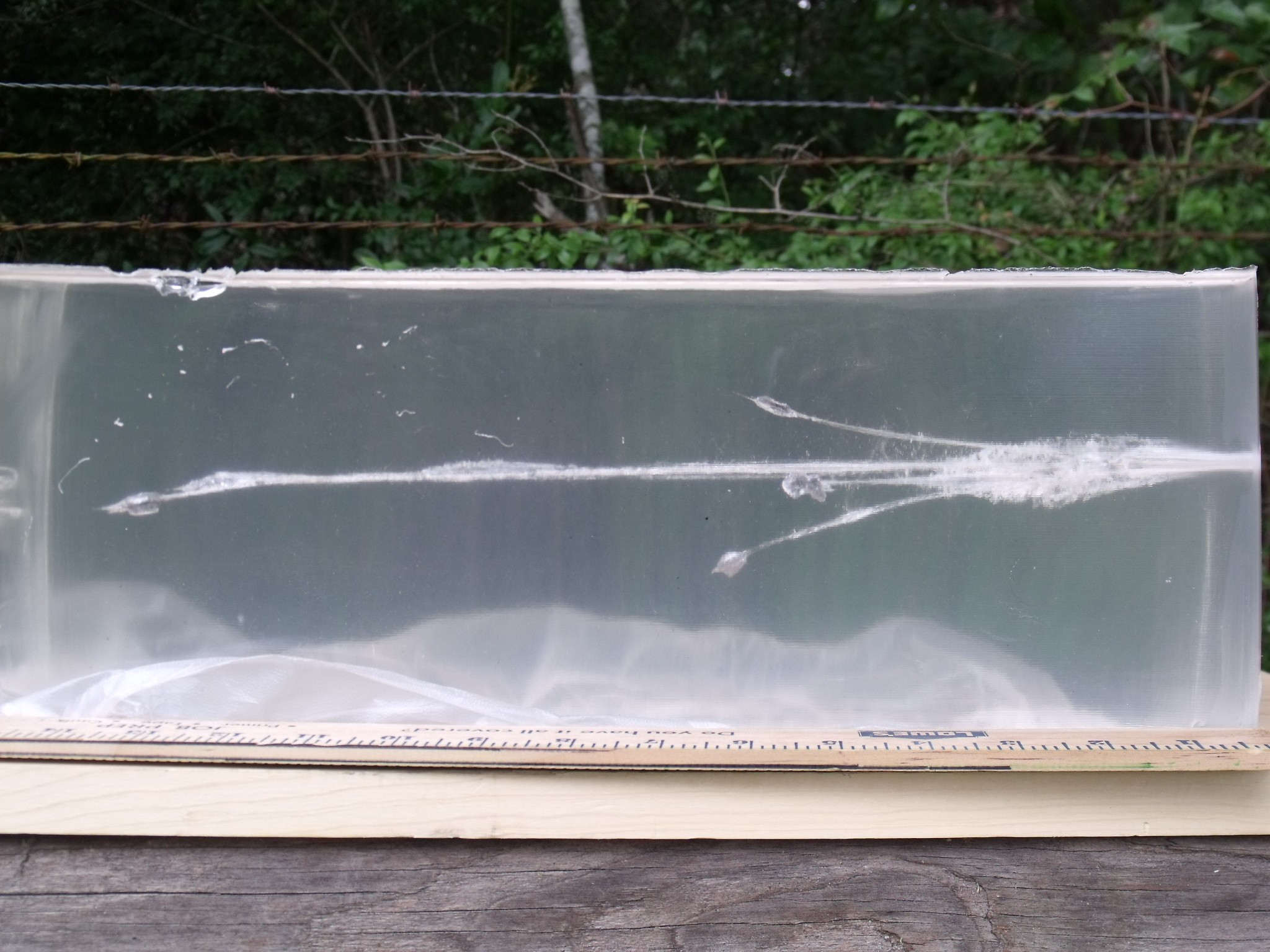

Ah yes, clear ballistics gel test with 7″ revolver
200gr Lyman 42499 50/1 mix, NASA lube (John Kort’s casts)
36gr Swiss FFg, 970fps and 17.5″ penetration
Rifle tests
To be clear, John Kort sent me these cast bullets and requested I test them for him with 36gr of Swiss FFg in both rifle and revolver.

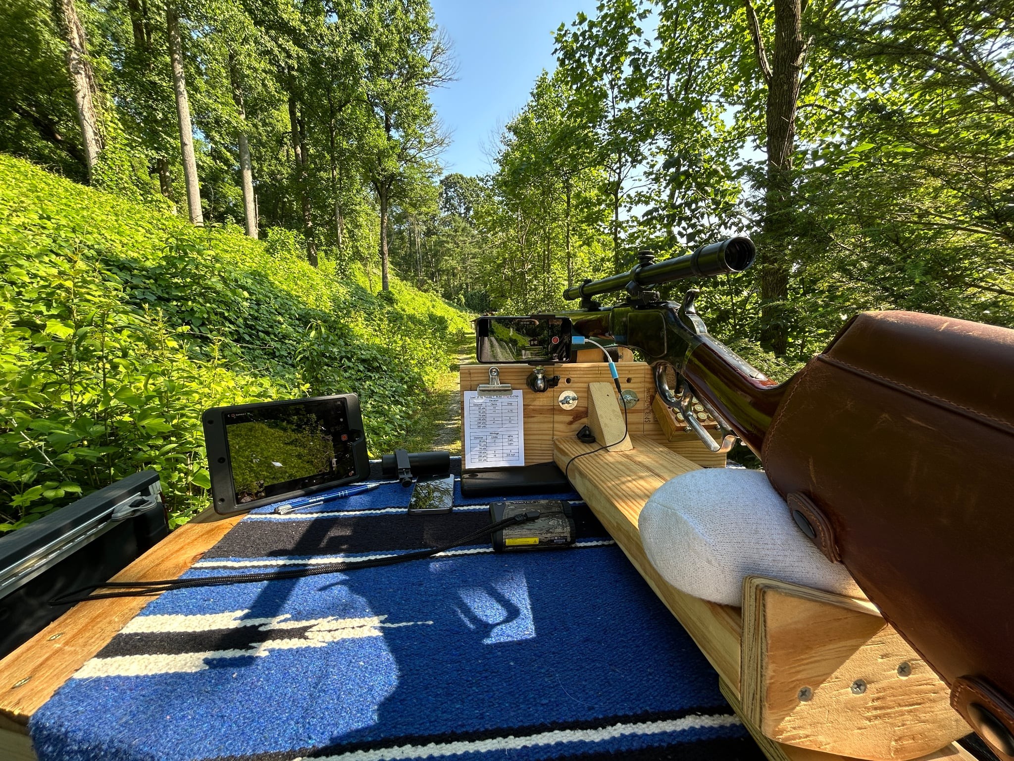

May try to get a target video finished in a week or so

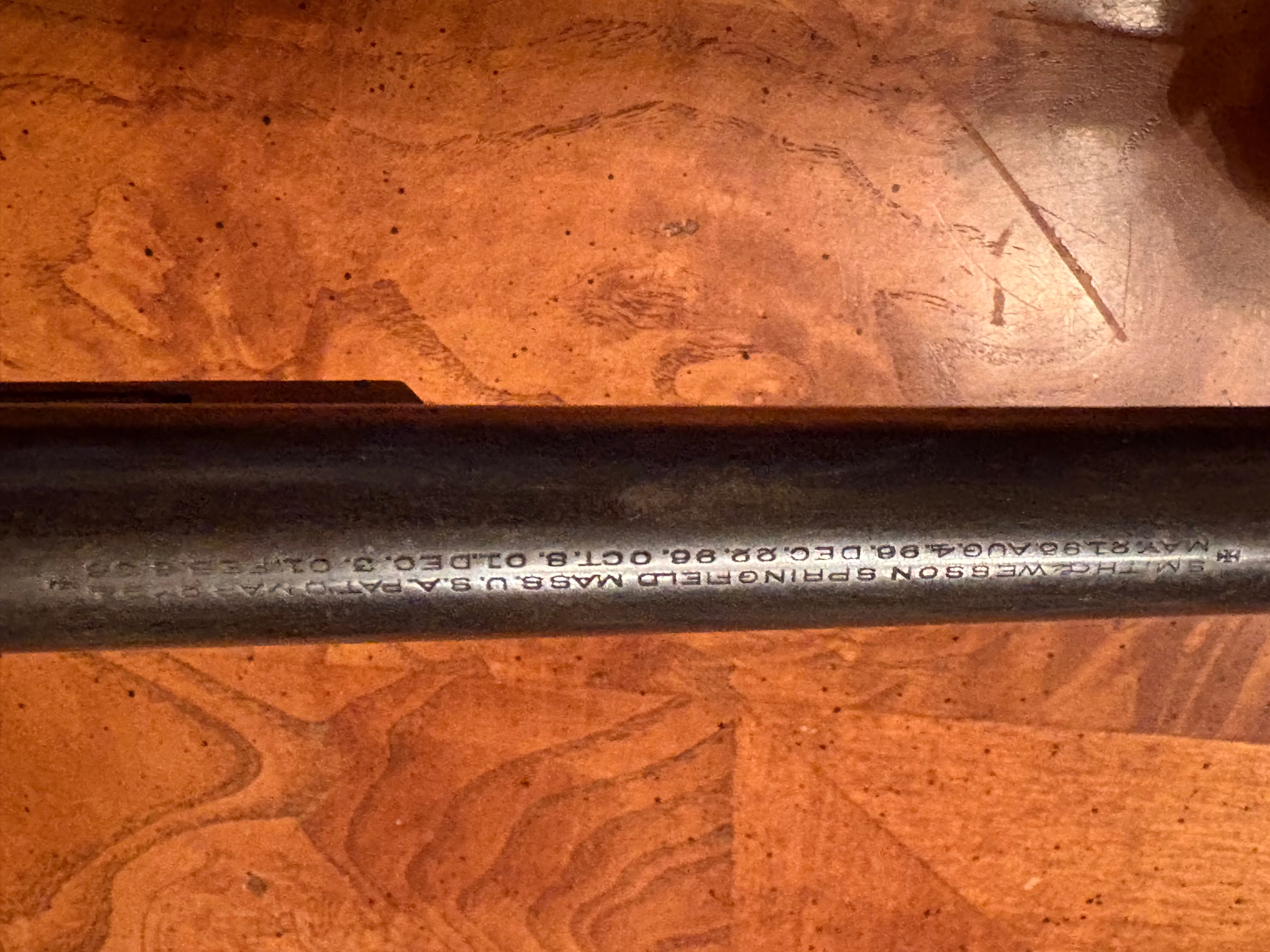

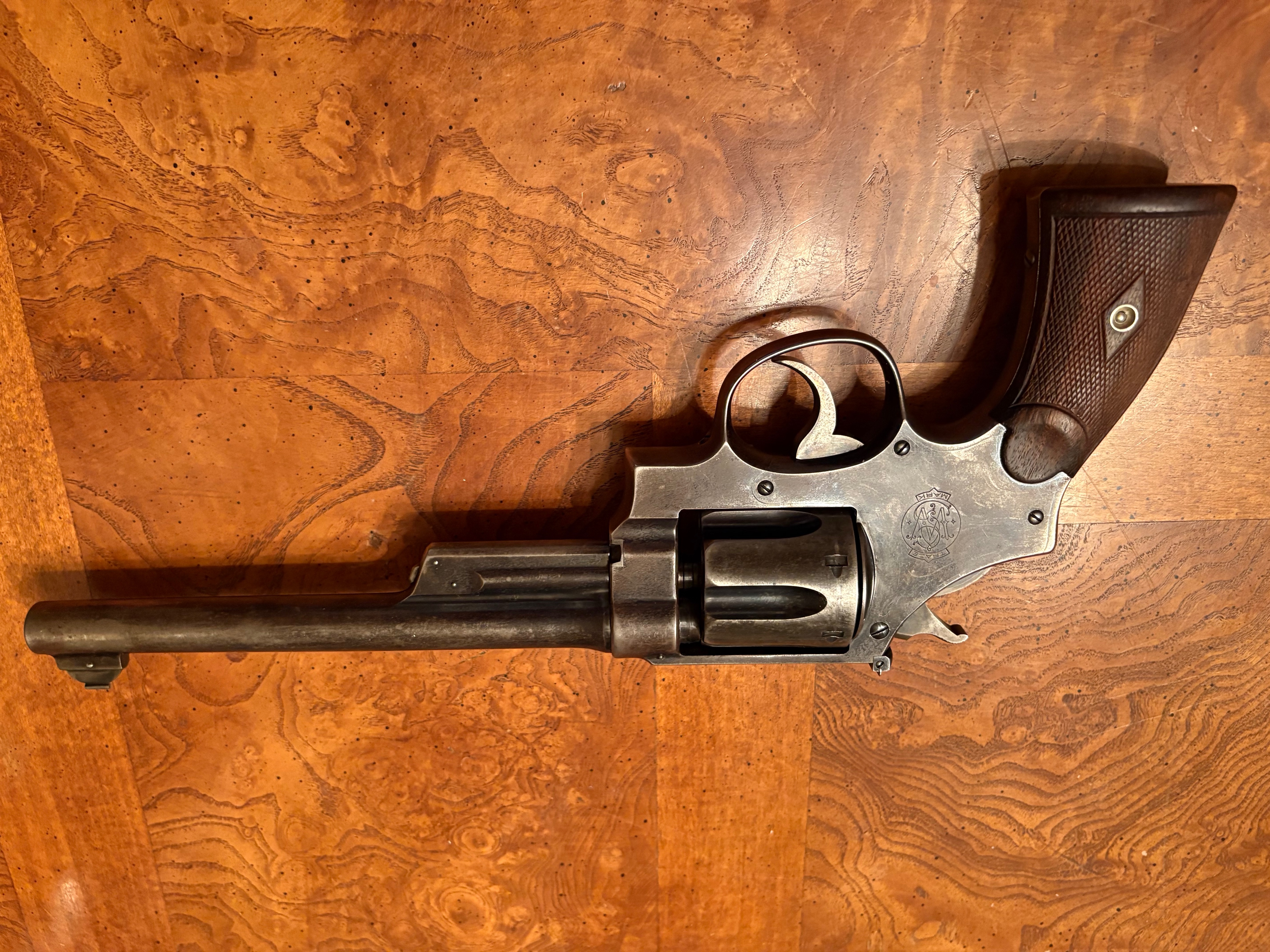

IMG_3685-1.jpegIMG_3686-1.jpegZebulon said
Doesn’t it seem strange that, considering the appearance of the 44 Winchester in 1873,  when Smith & Wesson lengthened the 44 Russian case to create the 44 Special for their 1908 New Century revolver,  they chose to only approximate the 44 Winchester, despite the substantially increased powder space created by the change to smokeless powder?
The principal officers at Smith & Wesson had not fallen off a farm wagon and were certainly competitive.  Was there a documented reason?
My guess would be they were not completely confident in the strength of their Triple Lock pistol with the metal chemistry science of the time. While that (lack of scientific knowledge) certainly didn’t stop Elmer Keith — he blew up revolvers to learn their limits,  he wasn’t running a company concerned about its reputation.  Colt’s would have paid big money for a photo of a triple Lock cylinder missing several sections of chamber wall and the top strap pointing to where they probably went.
Published specs in revolvers, 200 grain bullet:
44 winchester muzzle velocity 850 fps
44 Special muzzle velocity 870 fps,  muzzle energy 336 fp

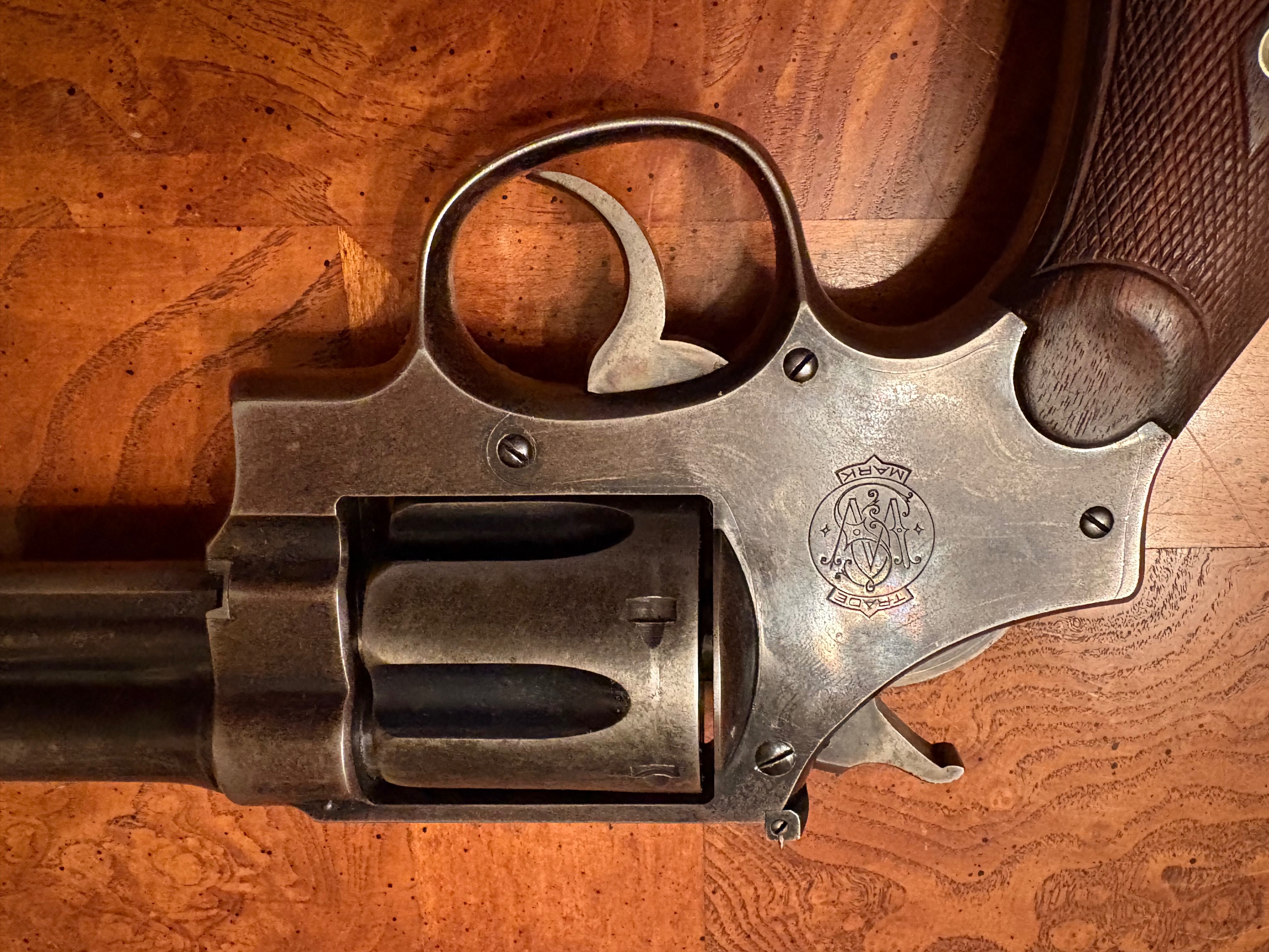

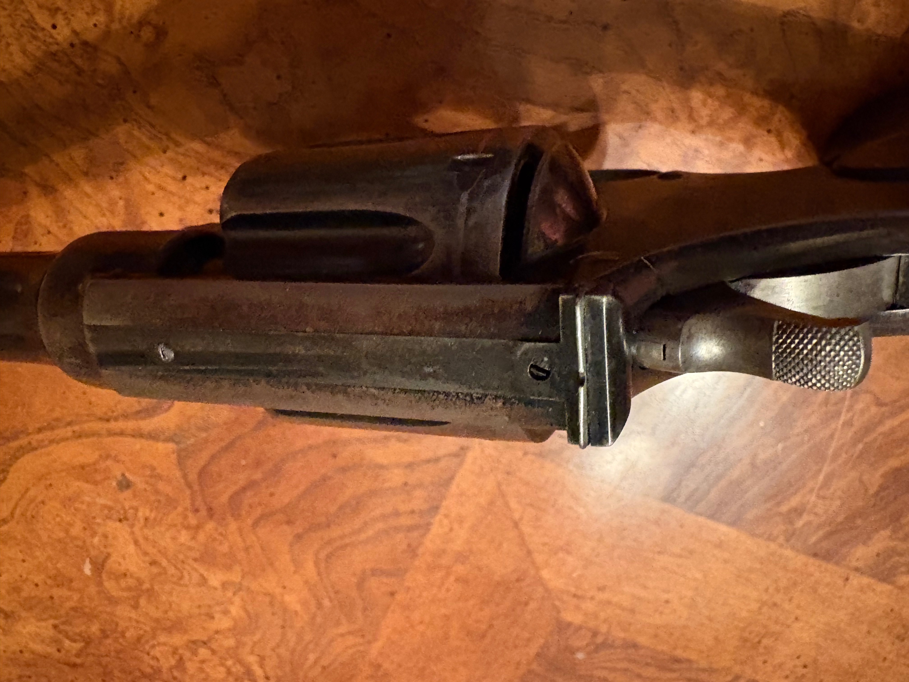

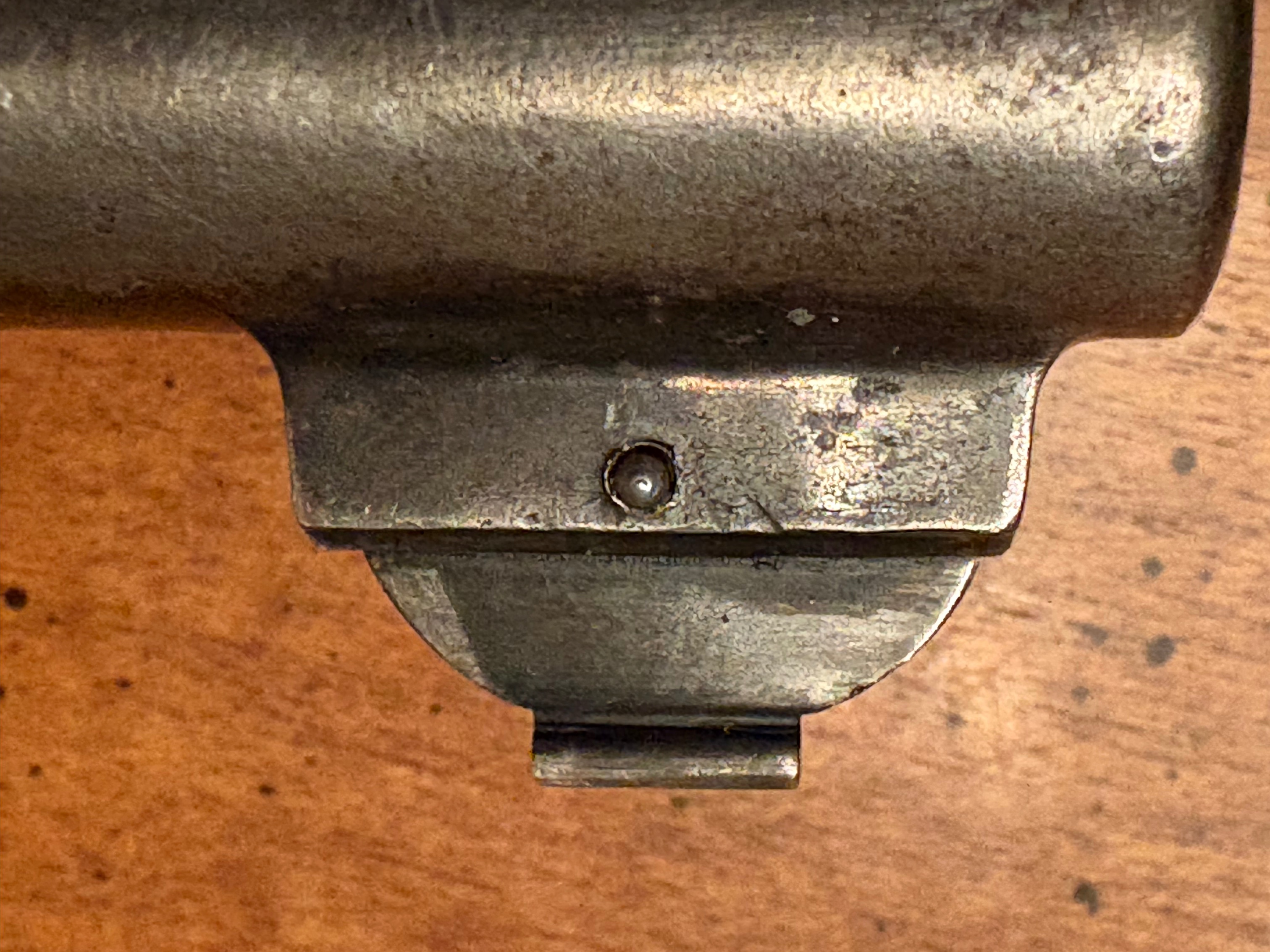

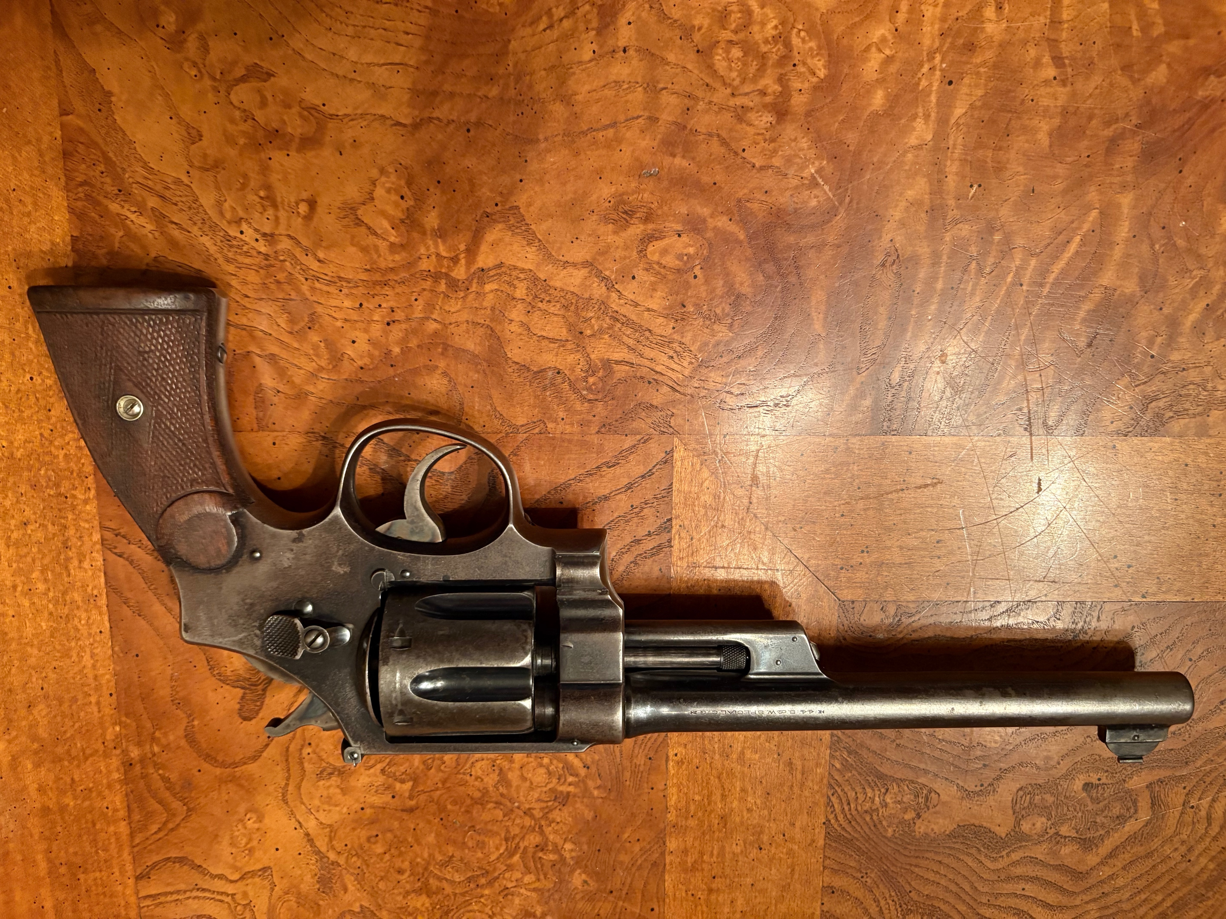

And here’s one for graphic purposes, .44 Smith & Wesson Special, Target Model, 7 1/2” barrel.

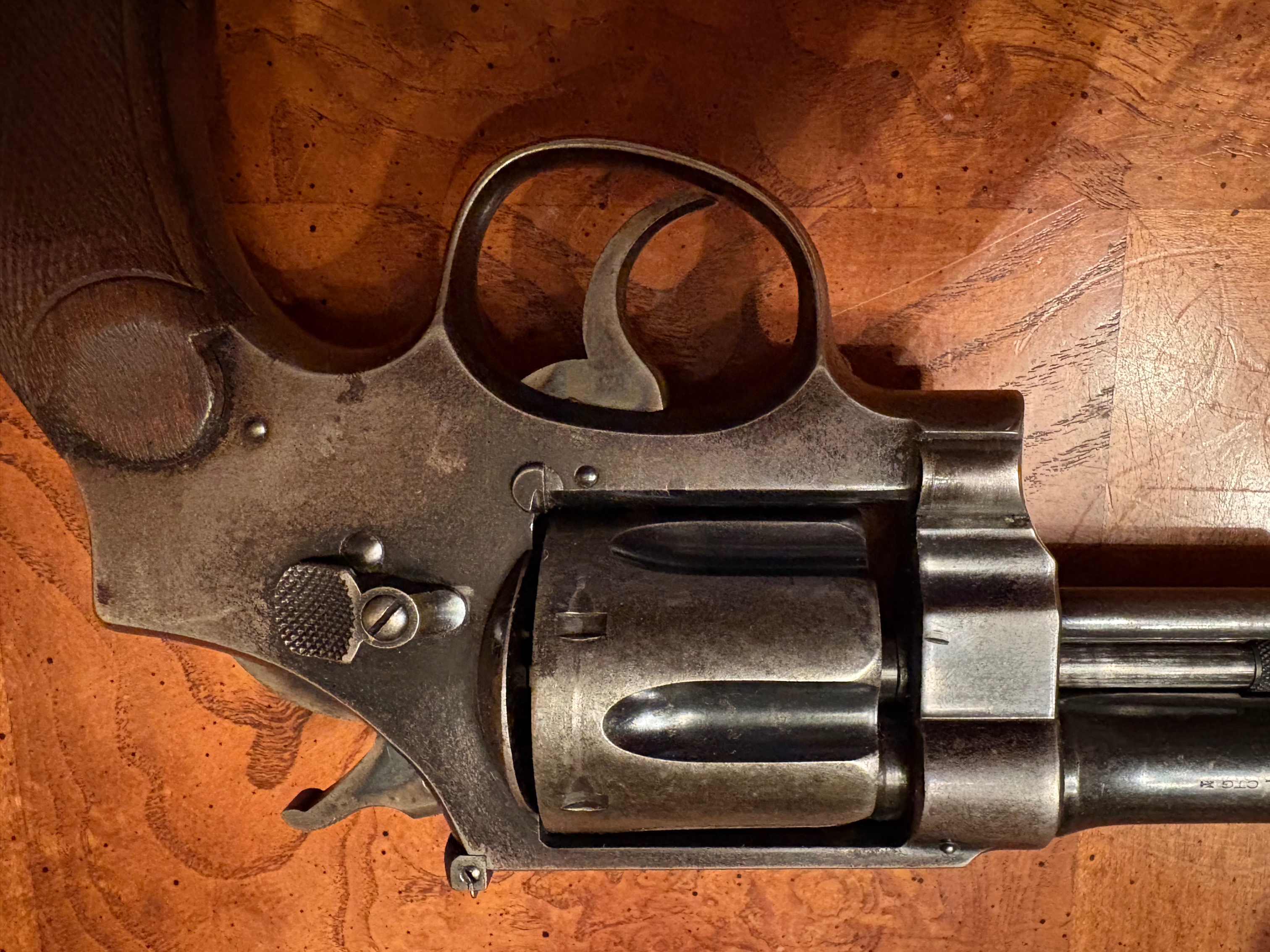

Forum Posts: 2528
June 12, 2025 - 1:13 am
And more photographs…

Also note the 7 1/2″ groups at 200 yards using #4 American Powder
