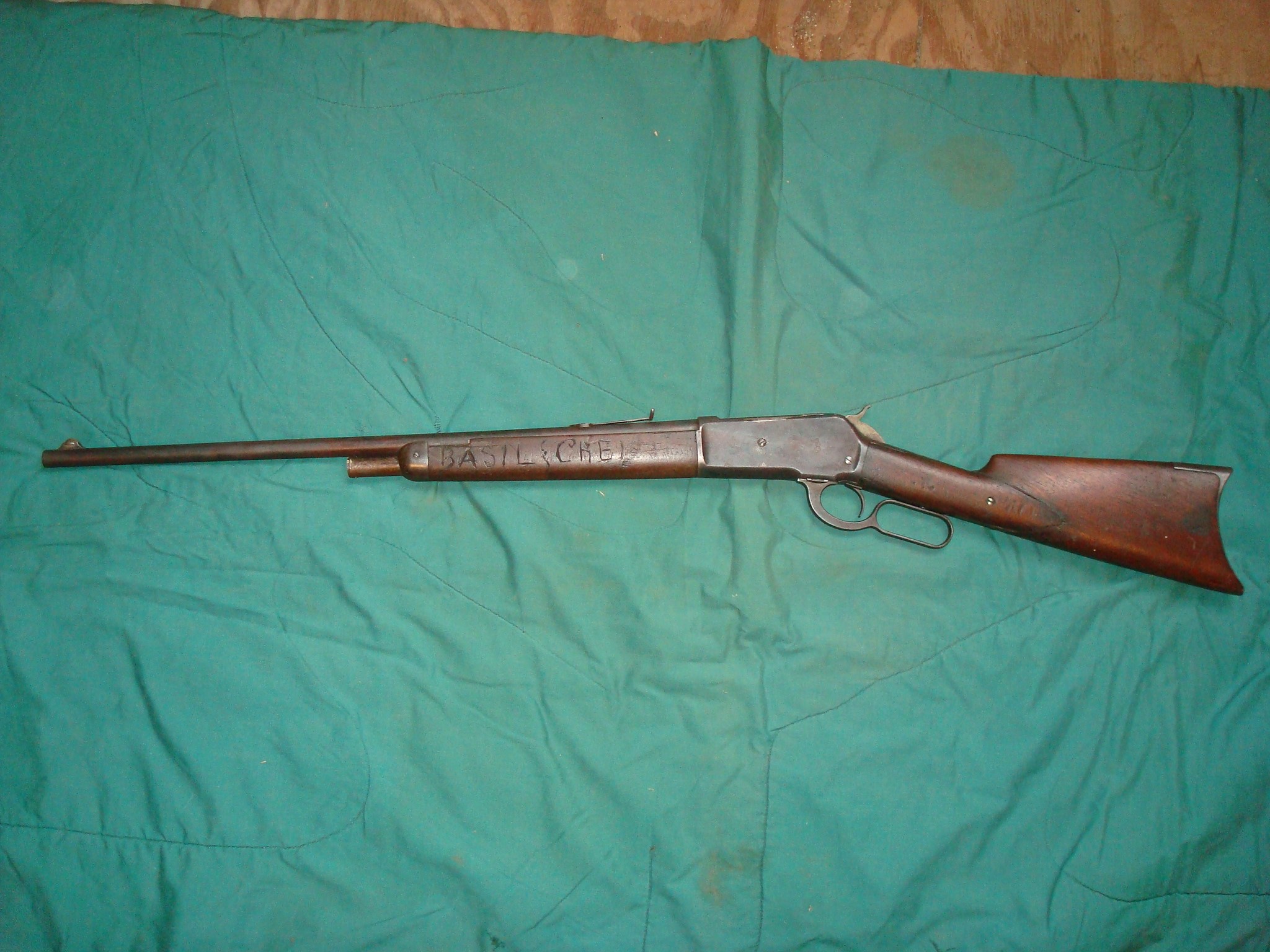

Thank you for the comments.  It is a long story but I have been trying to track down my uncle’s rifle for over 30 years and I finally found it and purchased it last week.  He passed away while I was in the service and my dad didn’t know where the rifle went.  My dad and all his siblings have long passed.  While I was discussing the rifle a neighbor gave me this photo of my grandfather with a rifle that I believe is the same rifle.  This picture was taken in the 1920’s.  I expect deer hunting. The rifle pictured below has been rebarreled (currently 33WCF) as it has a 25K serial number.  I suspect that for some reason the original barrel/magazine was damaged, a fall, etc. and needed to be replaced.  I remember my dad talking about a 38-56 and I wonder if that is the rifle pictured with my grandfather. The 38-56 and 33 WCF are not much different and may have been an easy conversion.  My uncle suffered terribly, mentally and physically, from his WWII war wounds.  He did not have much and survived on his pension, hence the condition of the rifle with his name carved on it.  Thank you for the information.  I’m just starting my research so thanks to all for the assistance and comments.  Even if it is not the same rifle, I’m excited to have the old work horse back in the family, warts and all.

The magazine tube on the Model 1886 shown in the second picture, looks to be cut down from a full length tube.
The end cap on the magazine tube is the flat type,
Not the rounded type cap, used on a shorter length magazine tube.
Ya might want to pull the forend wood and mag tube off and check the barrel date, if there is one.

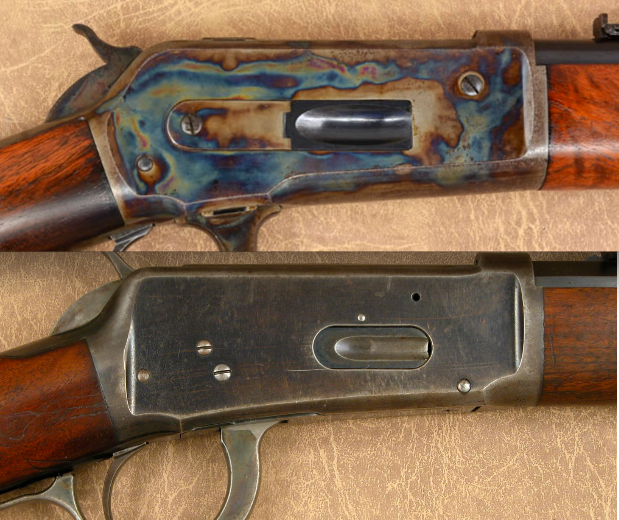

This might help us out a bit.  A side by side comparison of the 1886 and 1894 receivers.  I change my vote to it’s an 1886 TD.
