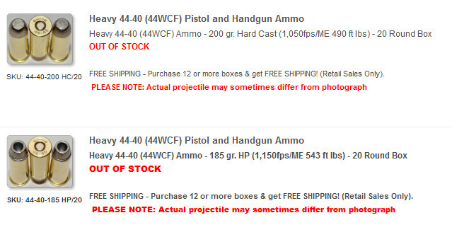

Doesn’t sound like this ammo is out on the ragged edge as I recall some of their offerings.
https://www.buffalobore.com/index.php?l=product_detail&p=514
Forum Posts: 5006
September 30, 2021 - 1:24 am
It looks like this stuff is lower power than factory.

They are jacketed 44-40
Forum Posts: 14960
September 30, 2021 - 8:48 pm
Tim,
At the listed velocity shown in post #6, jacketed bullets are not going to hurt anything.

I have a Model 1892 lever manufactured in 1900. Octigan barrel. Am I able to Shoot 185g heavy 44-40 from Buffalo Bore out of Idaho? These are the hallow point cartridges. Would really like to hunt deer this year.
Buffalo Bore explains of such use, the information is there. Go re-read ALL of their information.
185gr Hammer
➤ 1,430 fps — Winchester Model 1892, 20-inch barrel, circa 1916
➤ 1,438 fps — Uberti Model 1873, 19-inch barrel, circa 1997
➤ 1,140 fps — Ruger Vaquero (large frame), 7.5-inch barrel, circa 2003
➤ 1,150 fps — Colt New Service, 7.5-inch barrel, circa 1905
➤ 1,042 fps — S&W Model 544, 5.5-inch barrel, circa 1980’s
➤ 1,137 fps — Custom (Brian Pearce made) SAA replica, 5.5-inch barrel, circa 2017
➤ 1,065 fps — Ruger converted 357 Mag. flat top, (by Jack Huntington) 4.75-inch barrel, circa 1959
ALSO…. Item # 44-40-185 Hammer is utilizing a soft copper alloy Hammer Bullet. The alloy used in this bullet is as soft as a copper alloy can get. Still, it’s doubtful that at a 1,300-fps impact on muscle it will mushroom much, if at all. If it hits bone at that velocity, it’ll likely mushroom depending on the size of the bone.
There is nothing “Heavy” about Buffalo Bore’s 44-40 cartridge loads. There can be certain concerns BUT BB claims their 44-40 loads are within SAAMI specs. If that is true, their loads should be at or below 11,000psi. Personally I think they are right at the limit for SAAMI specs.
I used BB’s 44-40 loads as a “control” when I performed 83 documented pressure tests on many different 44-40 handloads @ 10 shots each test. I then compared their loads with factory loads, factory cowboy loads, high pressure handloads and handloading manual loads as well as black powder loads in modern and vintage brass. All of my results are consistent and in line with each other with pressure information.
Can the Buffalo Bore loads be used in an original and replica Winchester 1892’s?
YES….can they be used in your 92′, that is a decision only the owner can make. Laugh
My Buffalo Bore Test Results https://sites.google.com/view/44winchester/chasing-the-44-40/factory-loads/buffalo-bore-target-181?authuser=0
