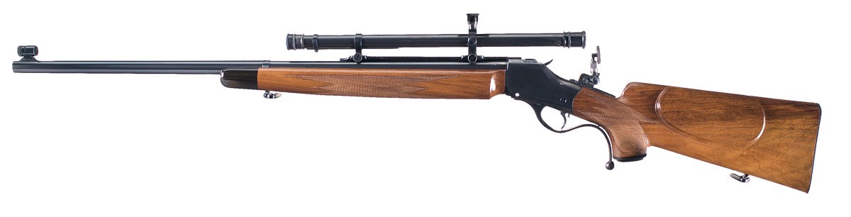

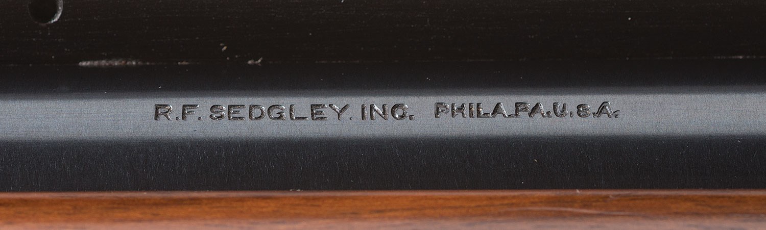

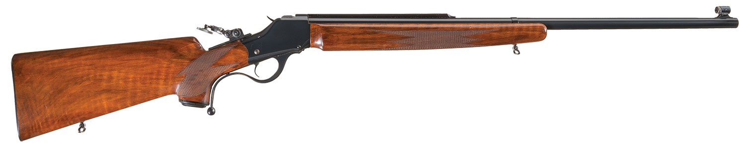

I am very familiar with Sedgley’s connection to Winchester.  Winchester sold most of their remaining Model 1885 parts (receivers and barrels) to R.F. Sedgley in 1923.  I have encountered at least a few dozen high-wall Sedgley built rifles over the years. See the attached pictures below.
