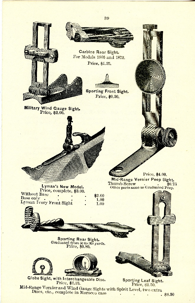

I looked at the some catalogs and its possible that the Globe could be the Globe with interchangeable inserts like this.
http://hastingsantiqueguns.com/files/products/387/img8166.jpg-1-1024.jpg

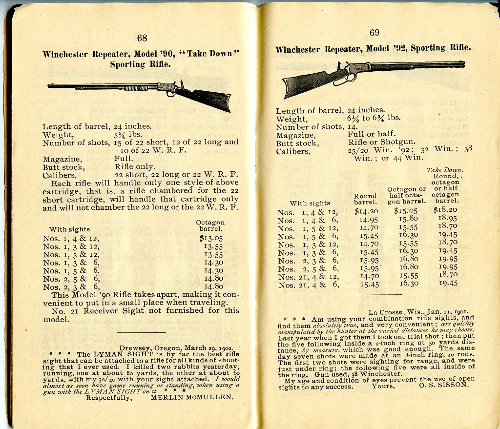

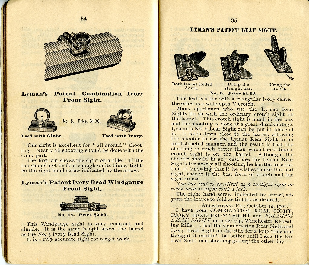

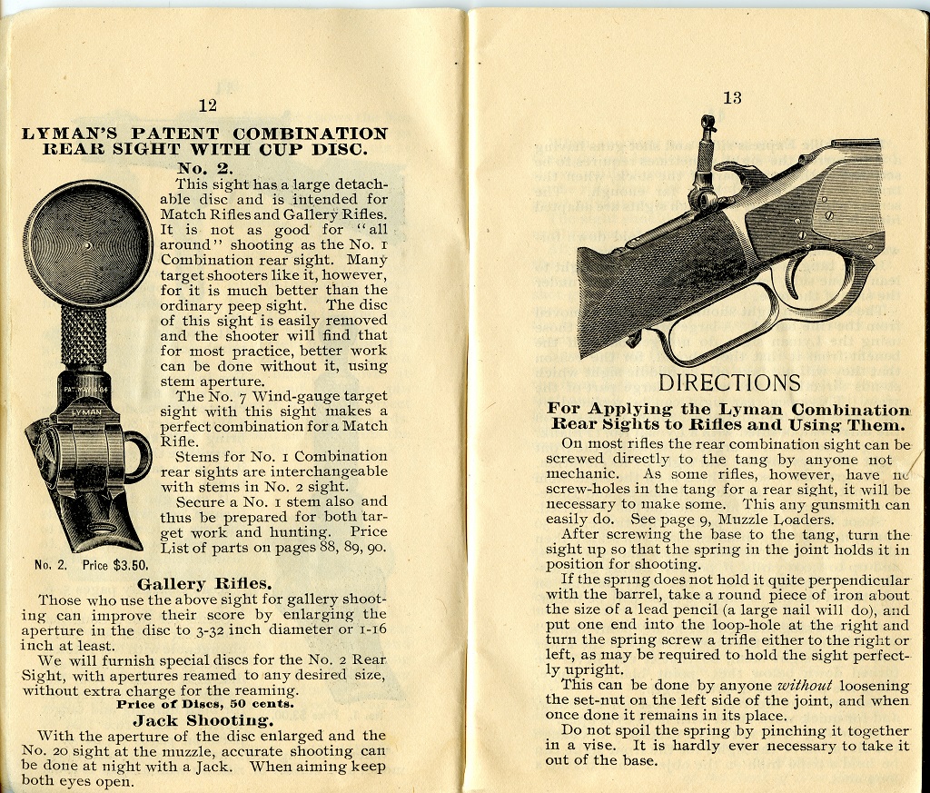

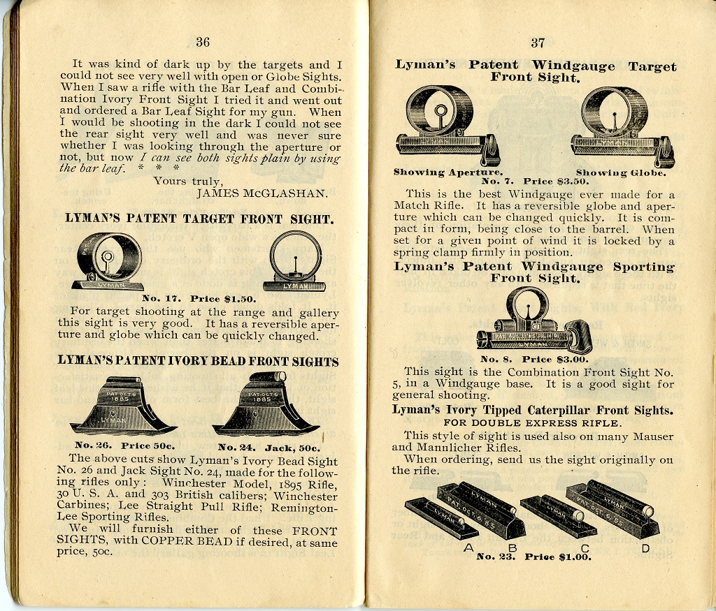

I scanned some catalog pages of these sights for you also.
The Lyman catalog is from 1902.  The next catalog I have is from 1906, the items are basically the same but the quality of the catalog for scanning purposes is not.  In 1902 they offered a few more sight configurations in their list, but still had the 2,5,6 configuration for sale for the 1890 in 1906.  I imagine Lyman or Winchester put whatever you wanted on the gun up to a point if you asked nice enough.  I included the Lyman pages in case the ledger entry leads you to believe they were all Lyman sights, and for everyone’s reference.

Forum Posts: 2869
August 1, 2015 - 2:37 pm
Brad,
Thank you very much! Your scans were very helpful and I appreciate you taking the time to post them.  The front sight on the rifle is a Lyman #5 Patent Combination Ivory Front Sight (with folding globe) which I mistakenly thought was a Beach sight.  So, instead of being replaced I suspect that is what the ledger is refering to as a “globe sight” since it is one of the combos with the #2 Lyman rear tang sight.  So, the rifle probably has the original sights which makes me very happy.
