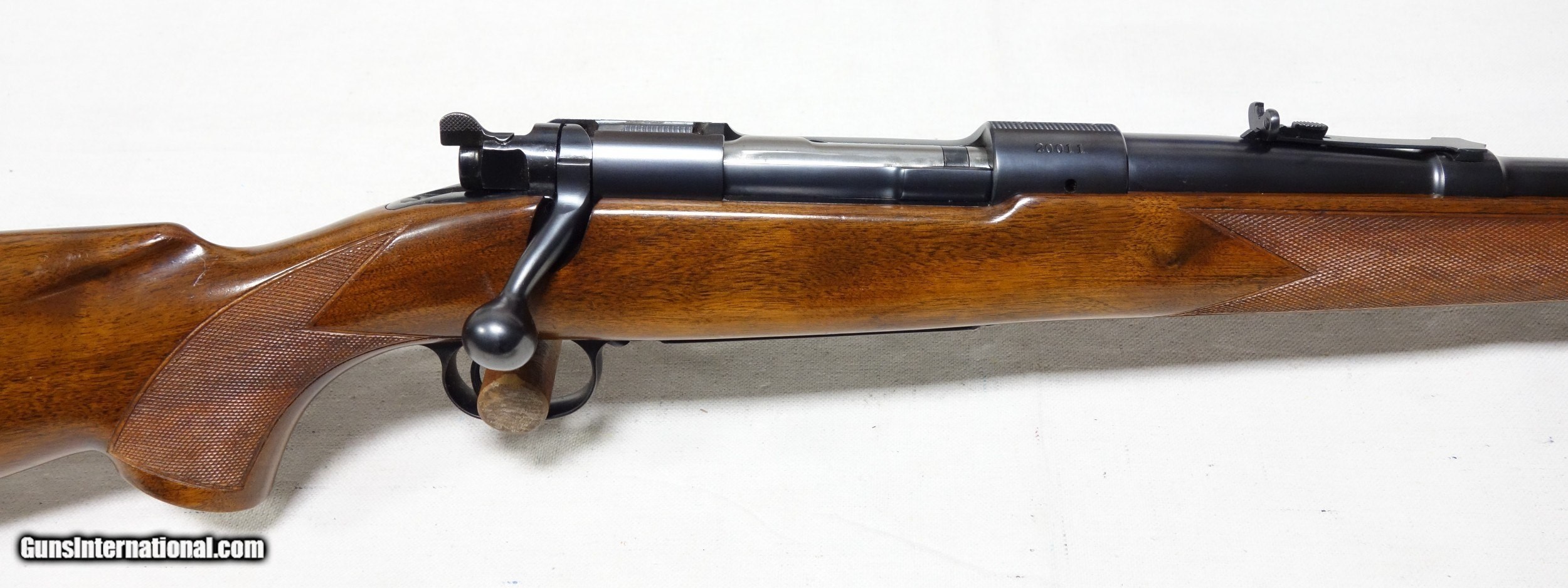

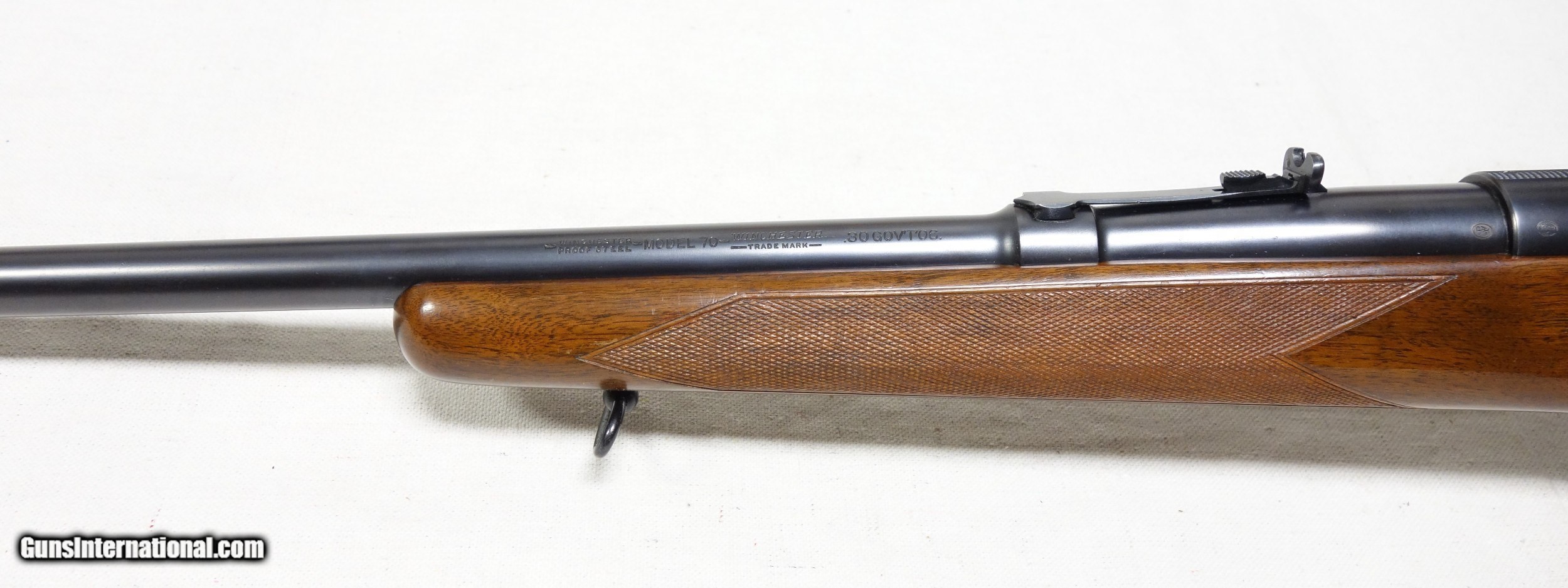

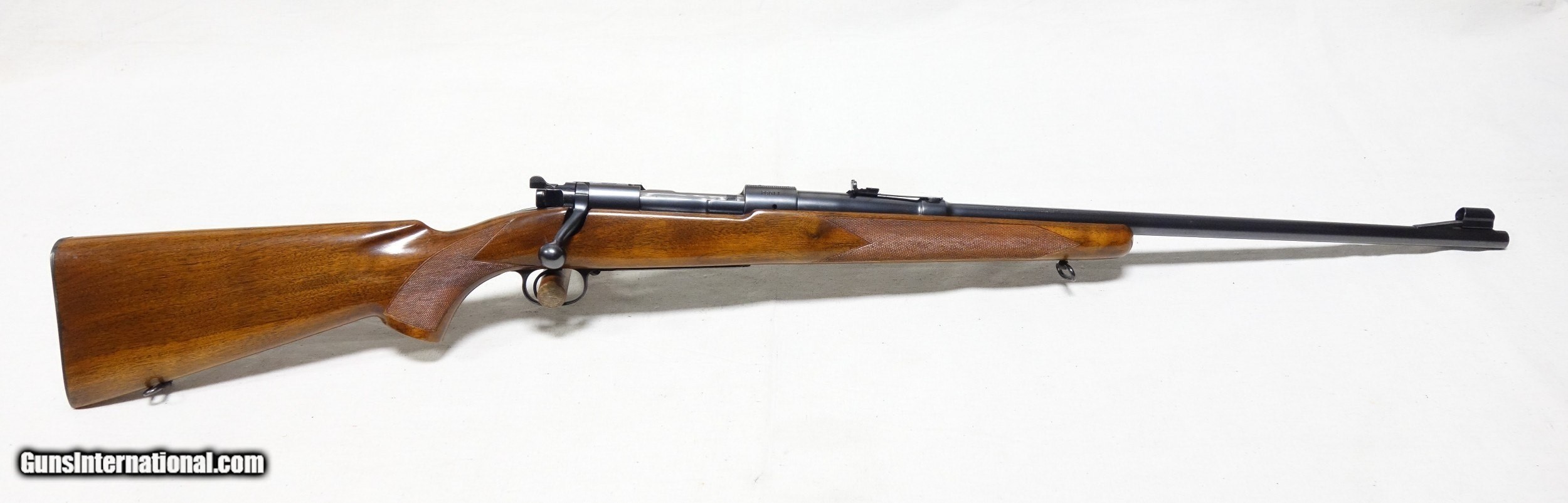

IMHO that one is not right.  Proofs don’t match, barrel roll markings (left/right) were not made with Winchester dies, caliber stamp is wrong, and I don’t think the ramp stippling is correct either.  I’d bet the under barrel caliber stamp is wrong too… Add to all that, according to my records S/N 20011 was a 30 GOV’T’06 Standard Rifle when Dave Morris (Frontier Guns) sold it via Guns International in 2021… Wink
Here are some pics of S/N 20011 as a 30 GOV’T’06.  You’ll note that it was a type I-2 (no pin in the bolt sleeve) back then too:

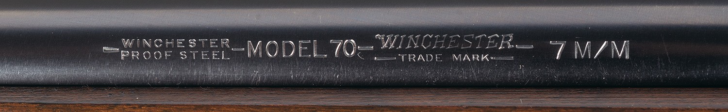

Winchester apparently didn’t adhere to the “MM” abbreviation for M70 caliber stamps, for whatever reason.  I know all 9 M/M and 7.65 M/M barrels are suspect, but the marking used for the somewhat more common 7×57 Mauser chambering was 7 M/M.  This one, Carbine S/N 66220, pictured in Whitaker’s book is probably correct:

I have no idea why Winchester used the slash mark. I do know that the mark Winchester used was longer and the 9 was a slightly different font, at least based on the Rule pictures, and that is assuming they are original. They used the same slash on the 7mm and 7.65mm.
