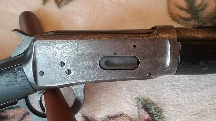

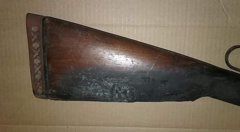

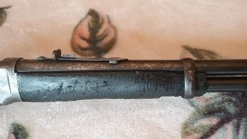

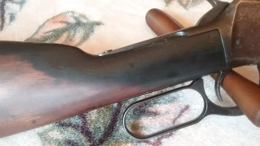

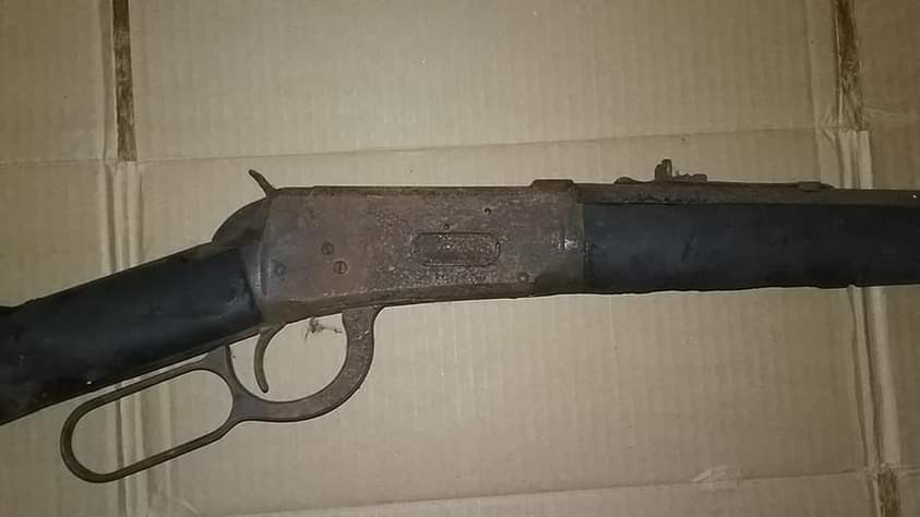

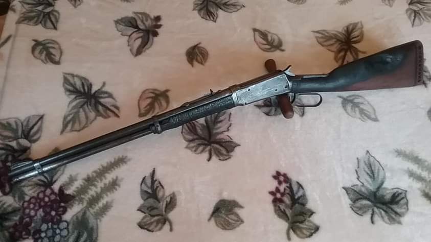

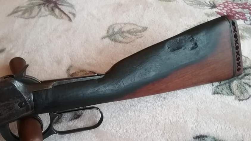

This Model 94 Flatband in 32WS had been in a fire and left for dead. I had to see if it was salvageable.

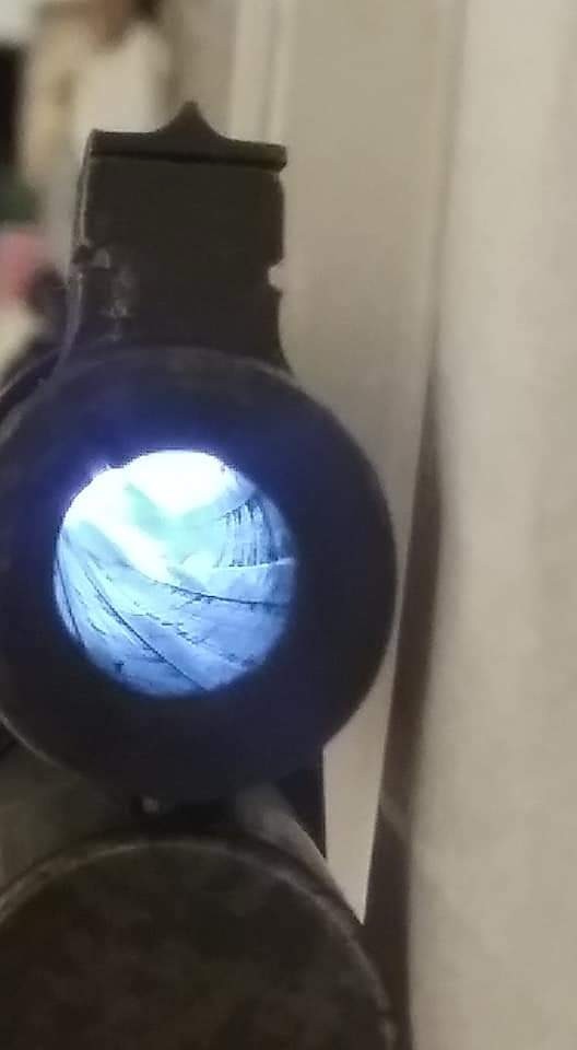

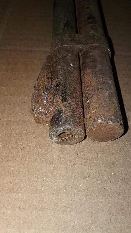

Although the wood was charred, it remained largely intact, and damage to the metal was only cosmetic. The wood was cleaned up, the charred areas treated with a hardener, and the rest refinished. The gun was disassembled.and thoroughly cleaned. Internally, the receiver was fine, like any other 70 year old gun. The bore appears shootable and is brighter than the picture shows. Only the magazine spring needed to be replaced, largely due to rust.
It may not be pretty, but this old carbine will live to shoot another day, scars and all. Another minute, and the outcome would have been different.

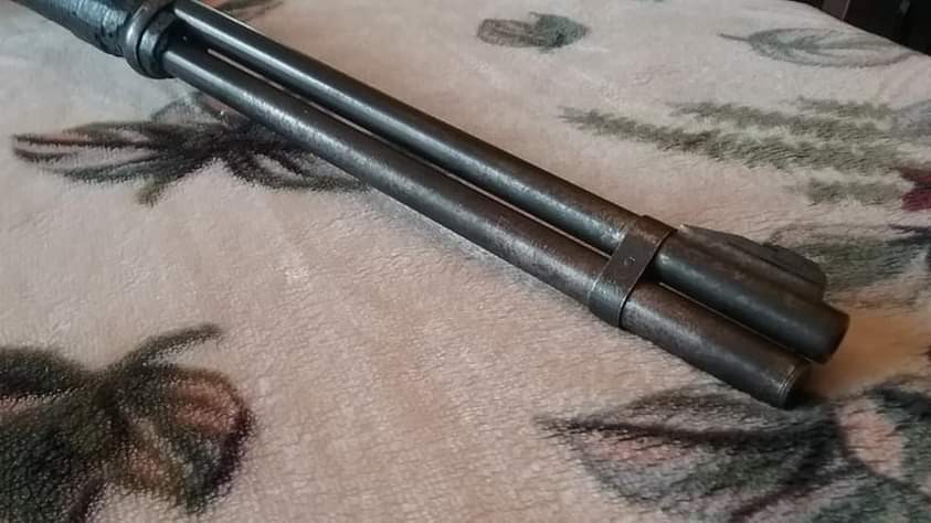

It’s the one I mentioned recently in the 1894 Survey thread, #1521865. I have since found the barrel is stamped 48.
One thing I find odd is the front sight. Is this a commercially made sight, or did someone do a real good job removing the bead?

It is definitely not the original factory sight.  Beyond that, it is nearly impossible to determine if it is a commercial or altered sight.
