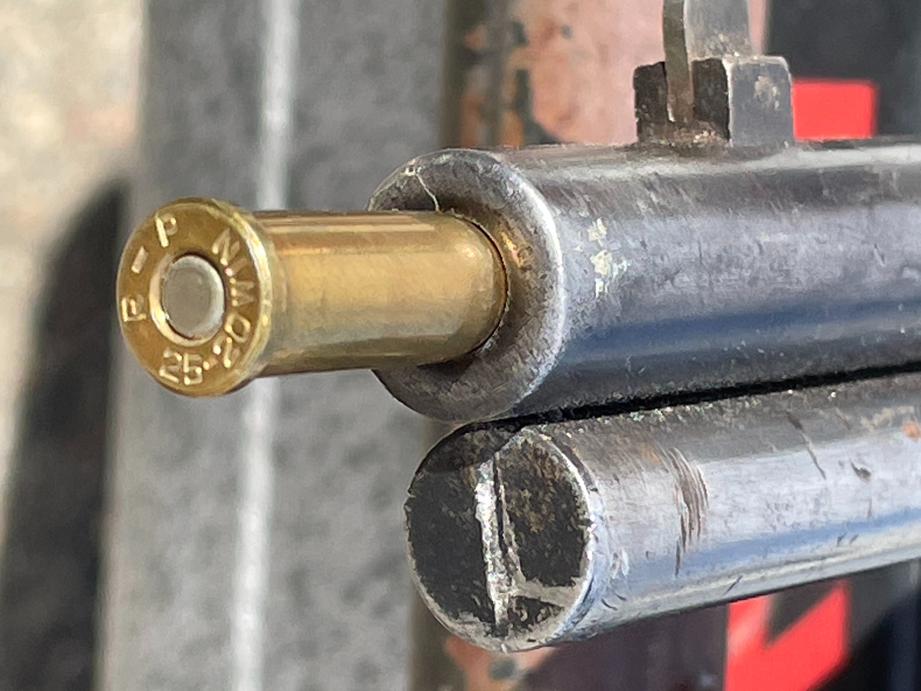

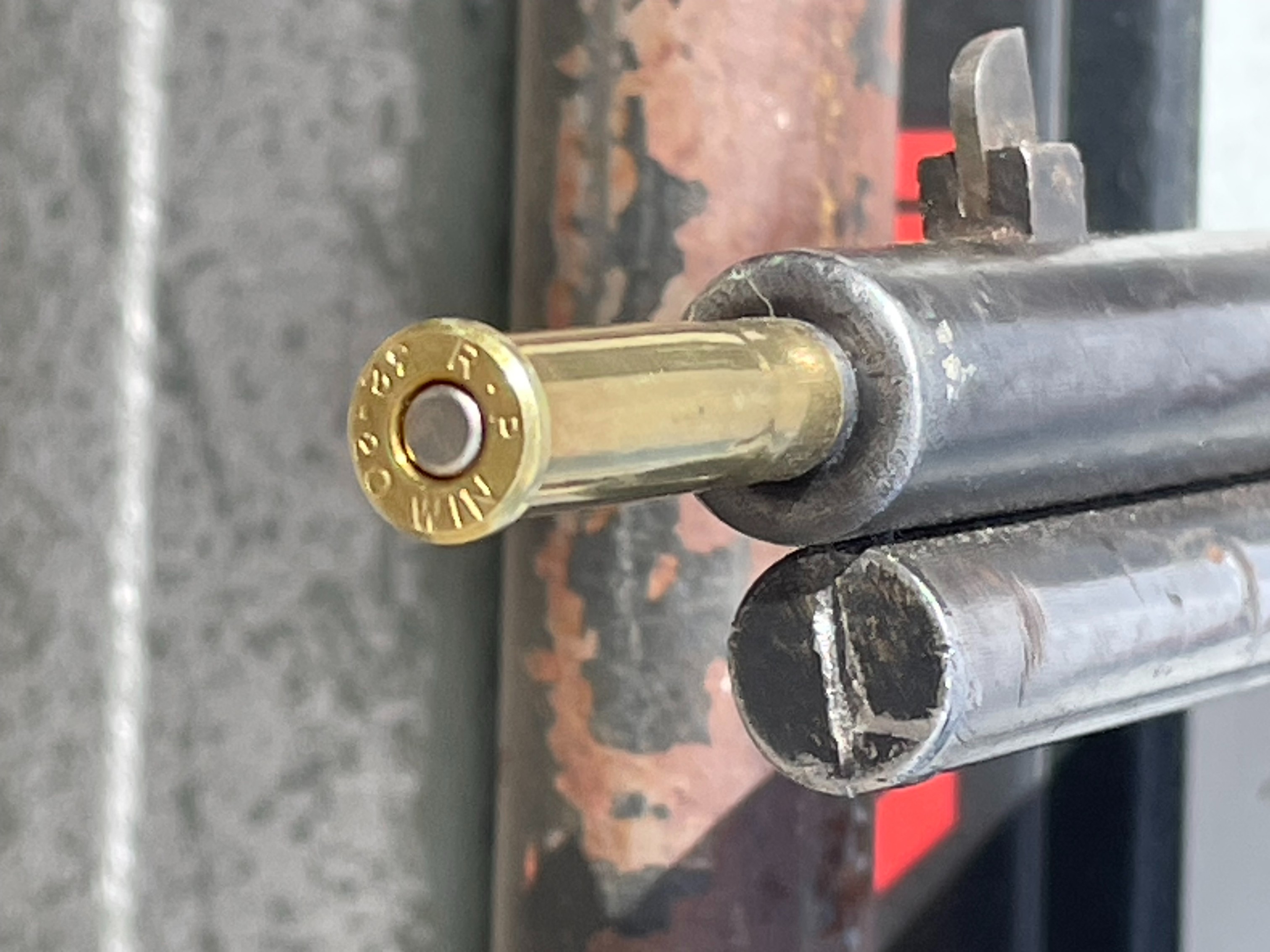

I have been approached by a collector who has a 25-20 marked Model 1892 that clearly is chambered for 32 WCF.  I am no gunsmith by any measure so let me ask.  Ca a 25-20 bore be increased to 32 WCF caliber with being relined?
Forum Posts: 14758
March 30, 2026 - 4:40 pm
Yes it can.  A simple rebore, rifle, and rechamber.  Going the opposite direction (from 32 WCF to 25-20 WCF) would require a liner.

Unusual that somebody would do that level of gunsmithing and not remark the barrel. It would be prudent to make a chamber cast and check the rifling.
