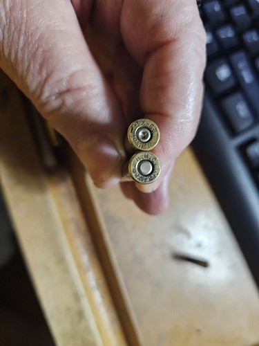

Springer2
Forum Posts: 4
September 14, 2026
September 15, 2026 - 10:06 pm
I shot these pretty quick so not the best photos. They would not come up in preview but maybe I did something wrong.
https://live.staticflickr.com/65535/55529796527_f27d780a51_z.jpg
https://live.staticflickr.com/65535/55530969839_749291a5f4_c.jpg
https://live.staticflickr.com/65535/55529796522_e98679b1bc.jpg

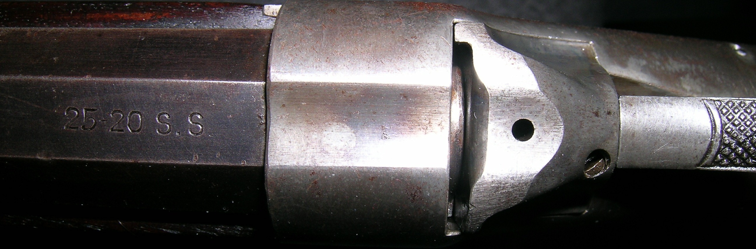

Forum Posts: 15022
September 15, 2026 - 10:59 pm
Per the original factory records, your low-wall S.S. was originally a 25 Stevens rim fire.  I can see in the pictures that you posted that it still has the original rim fire breech block versus a center fire block.  That leads me to question if will actually fire correctly.  Do you know if it has been test fired with a 25-21 Stevens center fire cartridge?
To covert from a rim fire cartridge to a center fire requires changing (or altering) the breech block and the firing pin, and changing the extractor.
Springer2
Forum Posts: 4
September 14, 2026
September 15, 2026 - 11:46 pm
Thank you so much for the information, Bert. That explains a lot. The breach of the barrel looks like new and just machined, not something done over 100 years ago. Also it locks up very tight but smooth–not like an old rifle. After I read your reply, I took a case I just primed and it fired fine and the primer was hit on center. Looks like whoever did the work knew what they were doing.

Forum Posts: 15022
September 16, 2026 - 12:32 am
That is good news on the mostly correct conversion.  My guess is that the original breech block was altered/modified for the center fire pin.  Winchester drilled a vertical gas vent hole in the top of the center fire breech blocks (not present on your rifle’s breech block).
