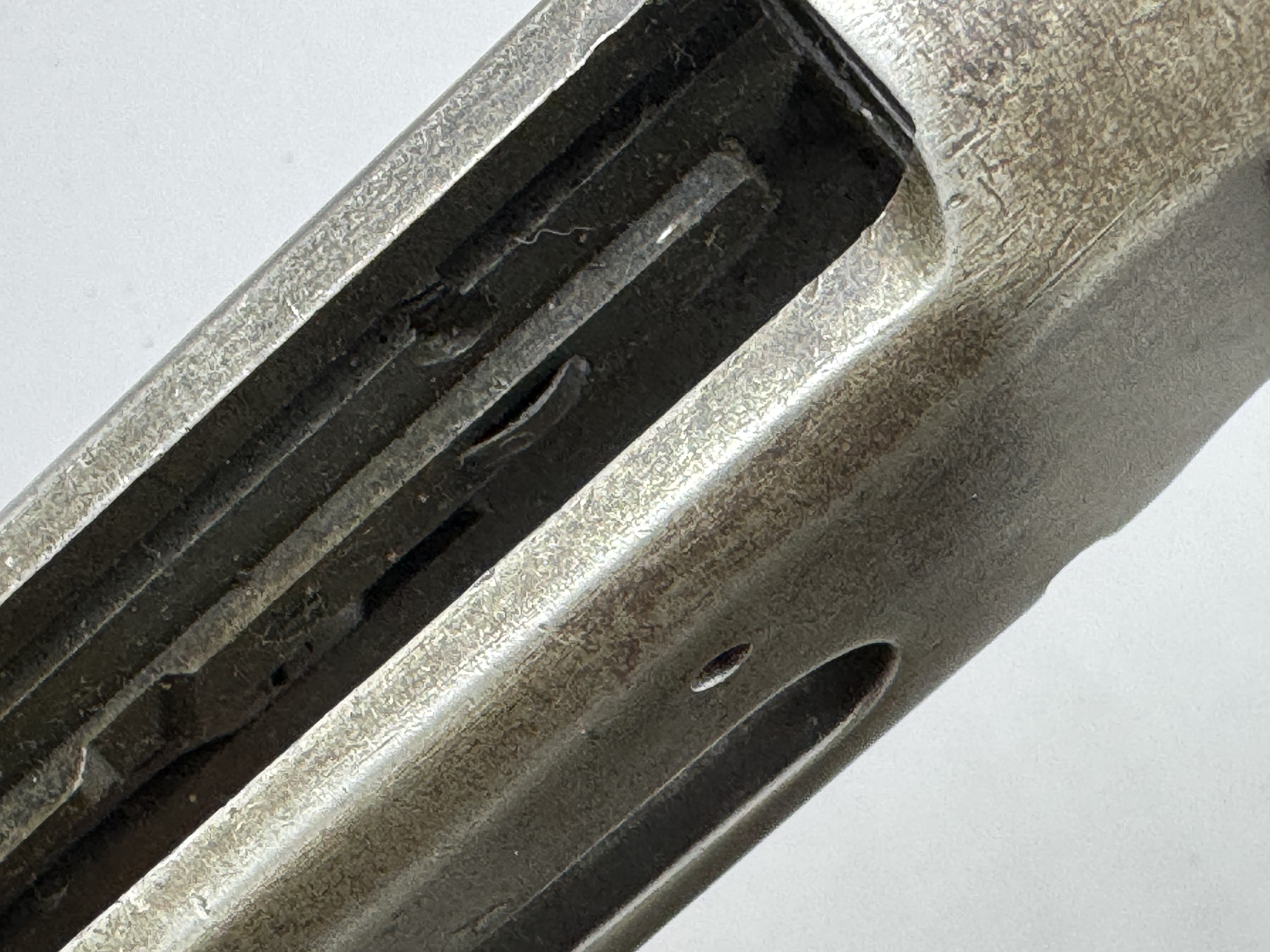

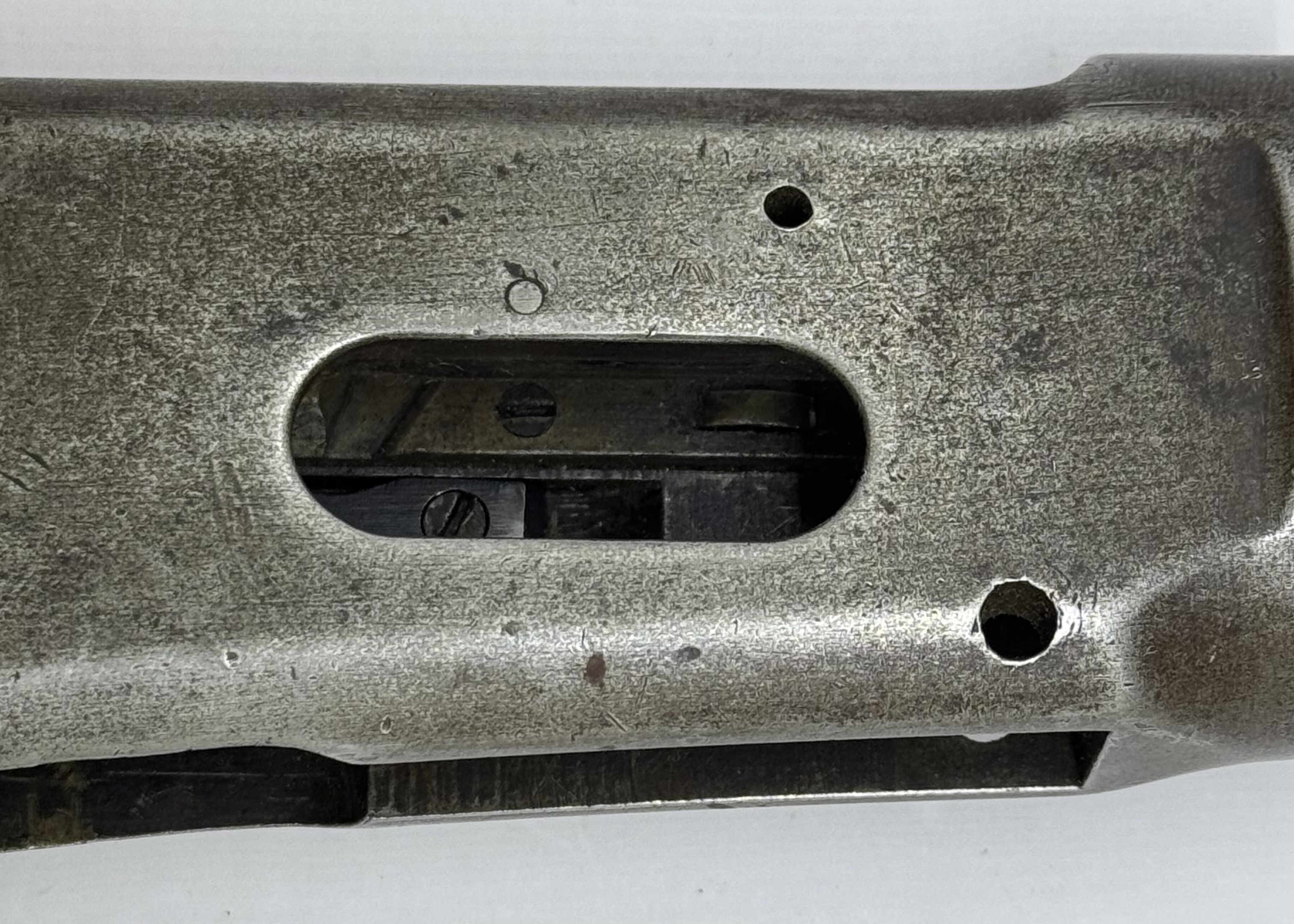

Here are a couple of pictures of my other 94 in .38-55. You can see the spring pretty clearly.
The carrier’s on these are also slightly different in that they have a cutout or “detent” on the left side to clear this spring.

Just to clarify and be absolutely sure, you’re talking about this little guy right here?:

That’s the guy. There’s one for sale on eBay bundled with the cartridge guide. I don’t need the guide and can’t bring myself to spend $75 for both just to get the spring.

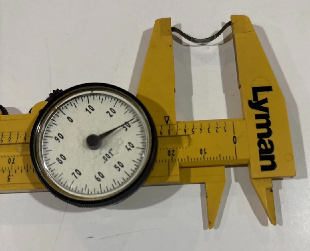

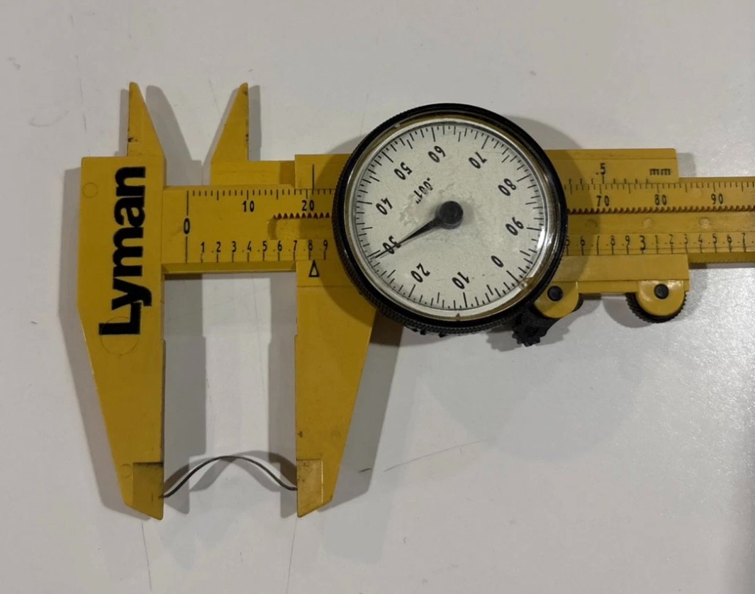

I have tried Homestead, but by email only. I’ll call and hopefully I’ll get lucky. I think the larger problem is that it’s not listed or shown as a separate part and most folks don’t know what it is. I asked the eBay seller if he would send me some measurements so I could try to have one made. Here’s what he sent me..

If anyone can recommend someone who could make me a couple of these, I would appreciate it. It literally looks like just a metal strip.

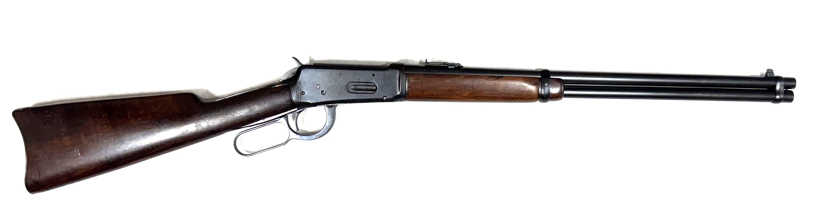

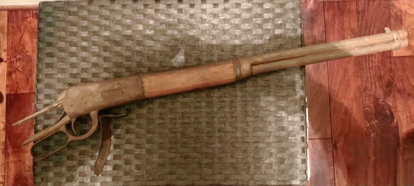

I’m actually in the coldest part called Virginia :). My first Winchester was given to my dad by a family friend who had a hunting cabin in Alaska. It’s a carbine from 1927image00.jpgIMG_9131.jpg that was in really bad shape. The story goes that it was either won during a weekly poker game or found in the dirt at this cabin. Unfortunately, both gentlemen have passed so the truth shall remain a mystery.
Still figuring out how to post images, so forgive the odd placement of the before and after shots.
