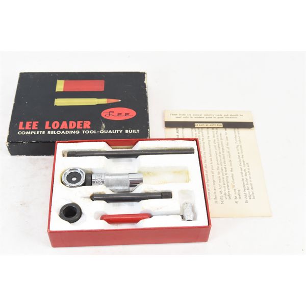

TXGunNut said Every reloader started out with a basic setup and today it makes a lot more sense than when I started over forty years ago.
I started with one of these while in HS, for a .38 Spl revolver my father gave me.  Not exactly designed for “high production,” but, as I knew no one to show me the ropes, anything more complicated would have been too intimidating for me to even get started.  Now I wonder what happened to my set, as I never throw anything away; it just “disappeared” after two doz relocations over several diff states.
