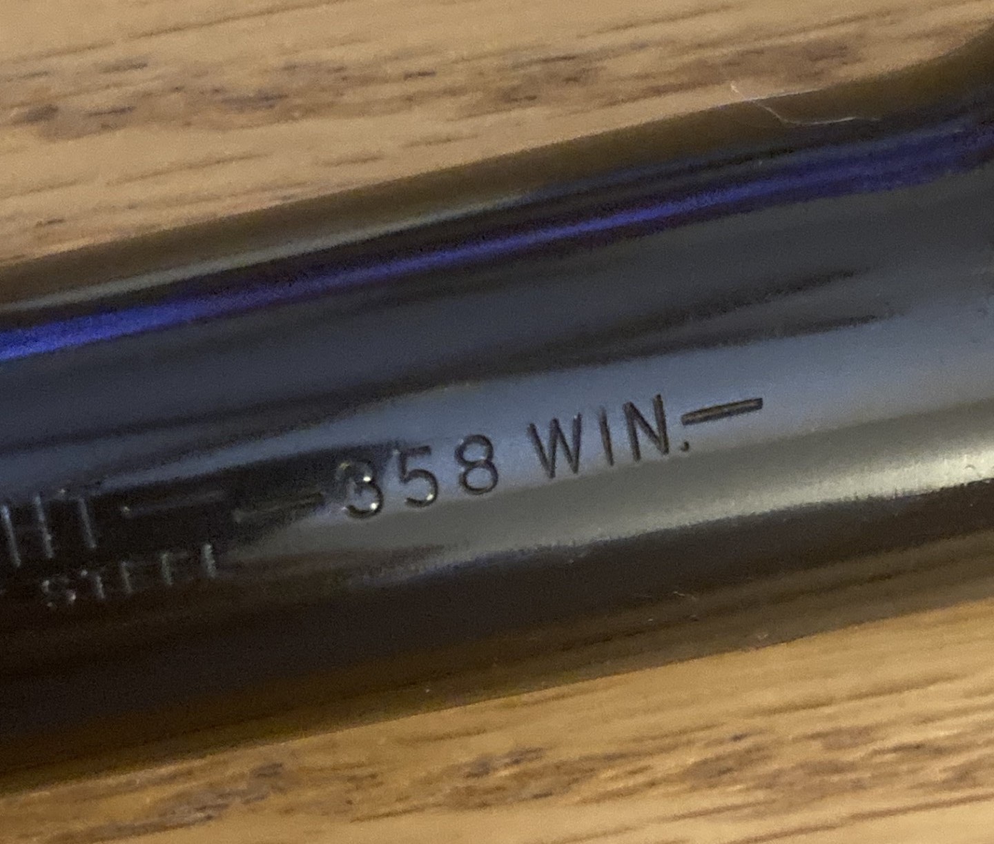

Pics and thoughts

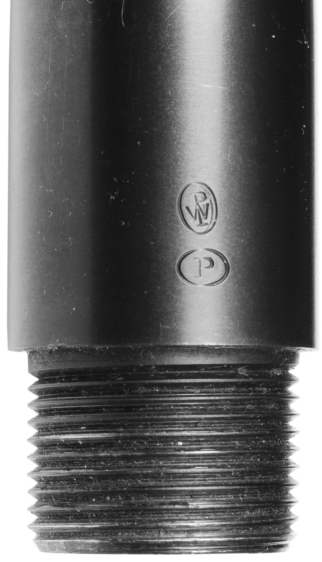

My understanding is that the “WP” definitive proofs were not stamped until after the fully finished and assembled rifle was proof tested.  Ditto application of the electropenciled bolt serial number.  That’s why those two markings are the only ones on a M70 that should be “rough”, i.e. never polished over.

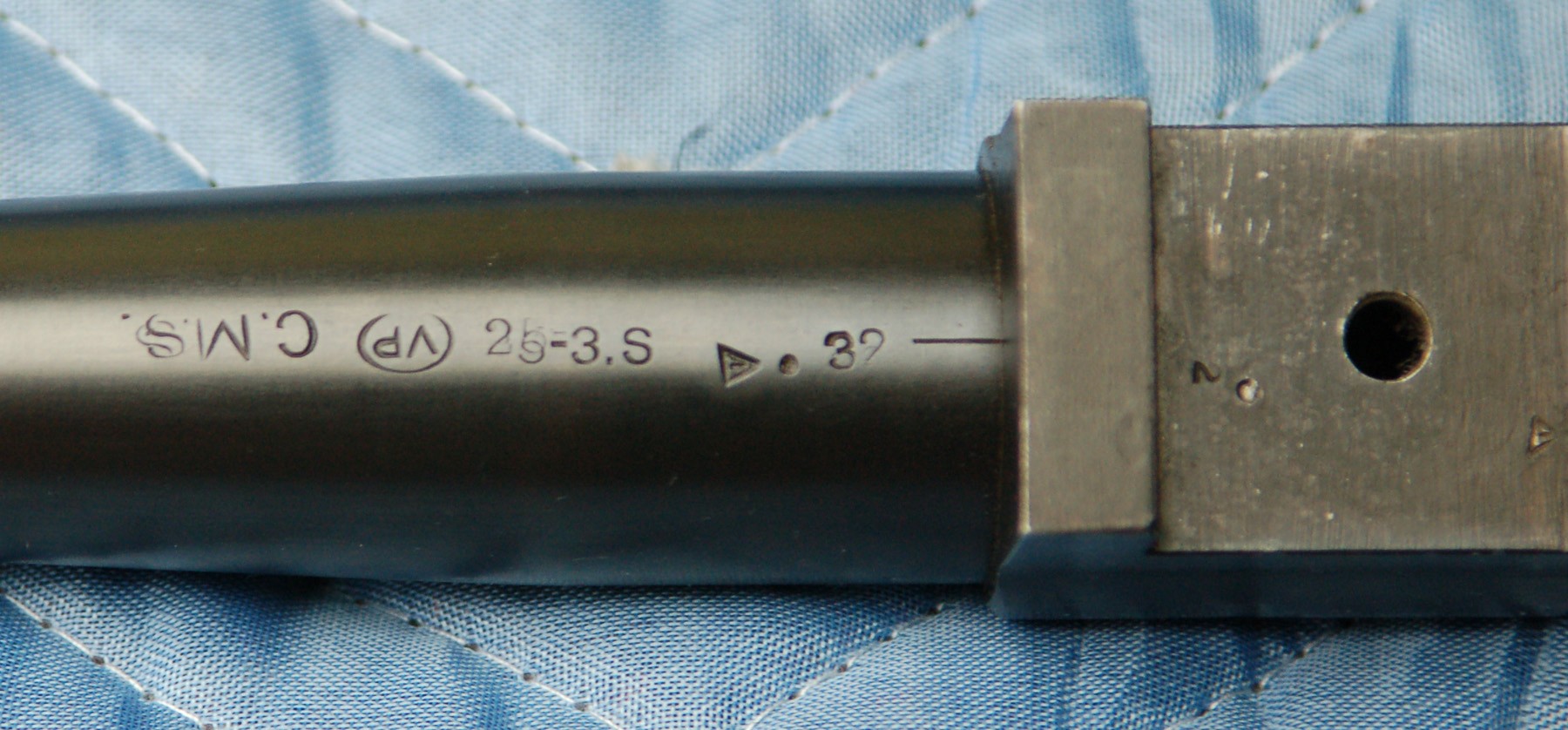

The interesting thing (to me) is that the M70 barrels I’ve seen bearing the “circle P” mail order proof ALSO have the definitive “WP” proof.  One gets the idea that those barrels were proof tested and given the mail order proof simply to denote that the factory did not fit it to whatever action it might now be attached to (no guarantee of correct headspace)…
This picture is typical IMHO… Another barrel of Ted’s that’s currently at my house for photos.  This one’s a real oddity, in that it’s a ’39 date M70 barrel that in addition to the mail order proof is hand stamped “54” (for Model 54) in the exposed roll marking.  Apparently someone ordered a replacement barrel for their M54 in 1939 and Winchester didn’t have one handy, so they took a current production M70 barrel (lacking “70” stamp) and stamped it “54”…

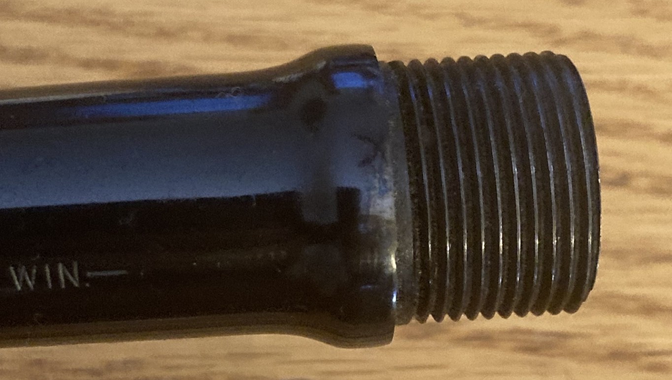

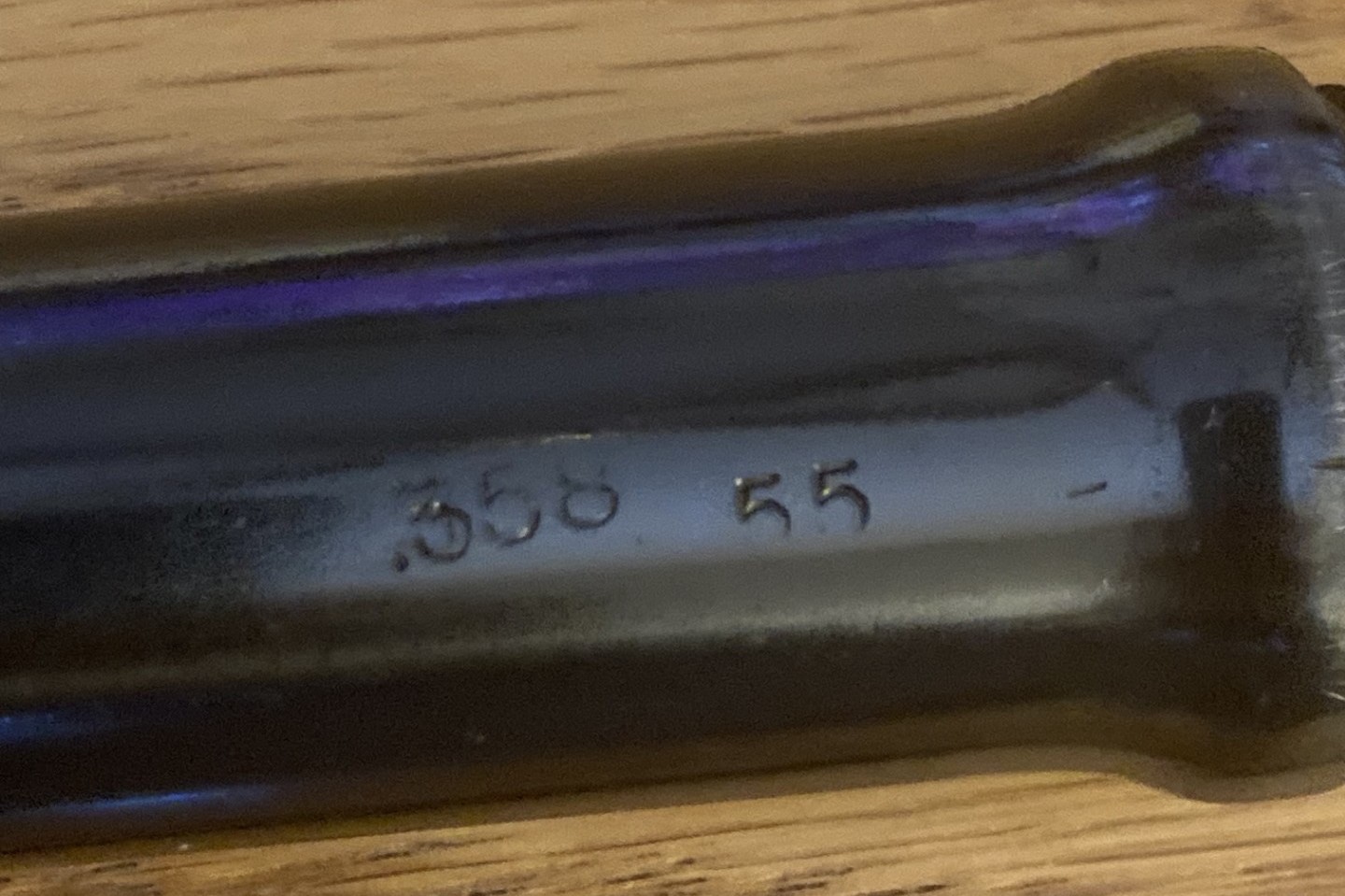

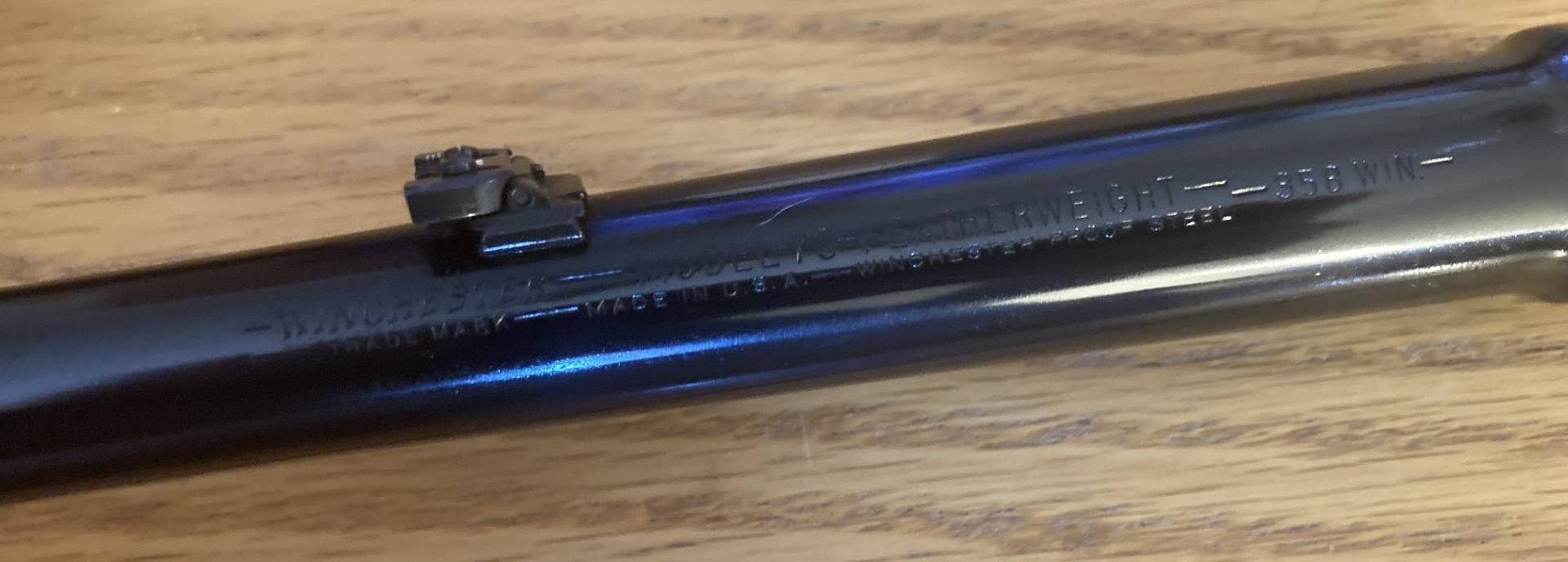

As far as Ted’s 358 WIN barrel, it looks like a genuine 358 WIN barrel to me (as opposed to a rebored/remarked 308 WIN barrel).  Winchester stopped providing mail order barrels well before they developed the 358 WIN, so it’s not surprising (to me) that there’s no mail order proof stamp.  I do not like to comment on the blue finish (original or reblued) from photos.  This one has undisturbed blue on the barrel threads and muzzle crown (probably the rifling as well), suggesting it hasn’t been on a gun/fired since it was blued.  That (along with the absence of a definitive proof) would argue against it being a “take off” barrel.  So IMHO it’s either an original “NOS” barrel or one that’s had the proof polished off…

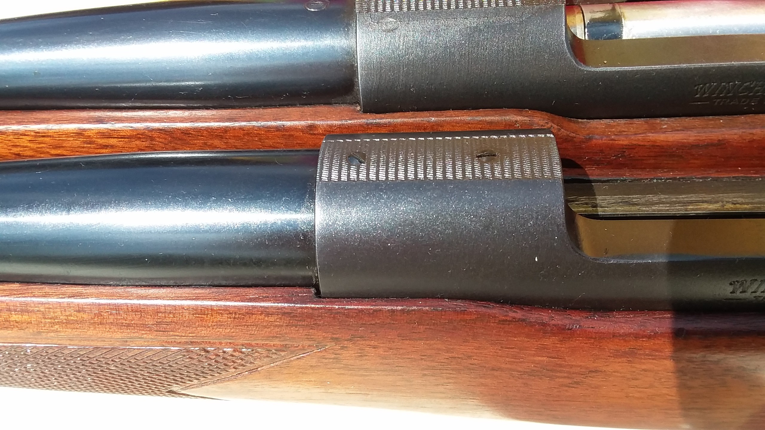

While trying to make sense of inspection stamps (tedious exercise) I just ran across this picture I’d saved …  Two M70 300 WIN MAGNUM Westerner-Alaskans, one completely lacking proof marks (s/n 553887).  Otherwise it’s a normal looking gun, not refinished.  The other one is a late 1963 rifle, s/n 578??? (I don’t have the full s/n recorded).  It has the sloppy misaligned proofs typical of 1963.  But the first one isn’t marked at all…  I have several views of both sides/top of the receiver, just showing one…
I guess sometimes “stuff” (excrement) happens… Laugh
