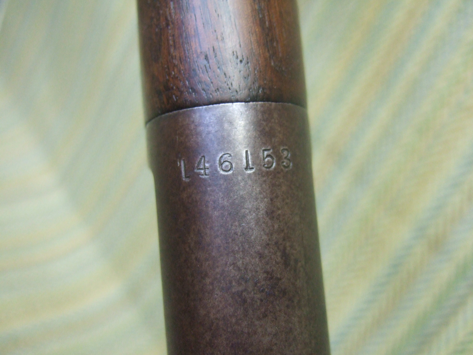

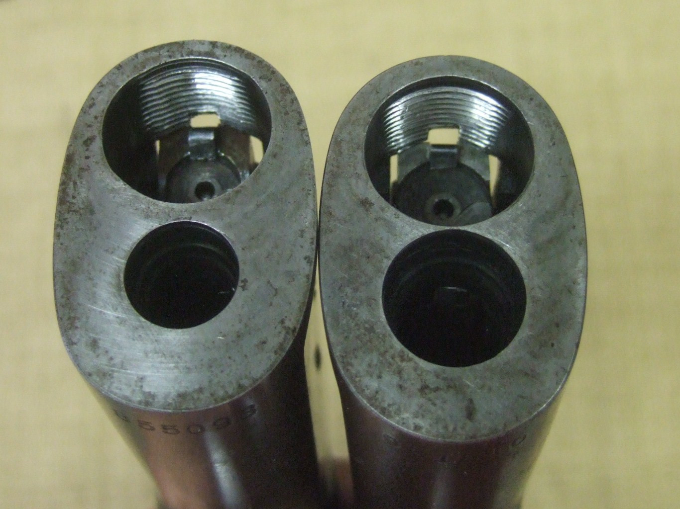

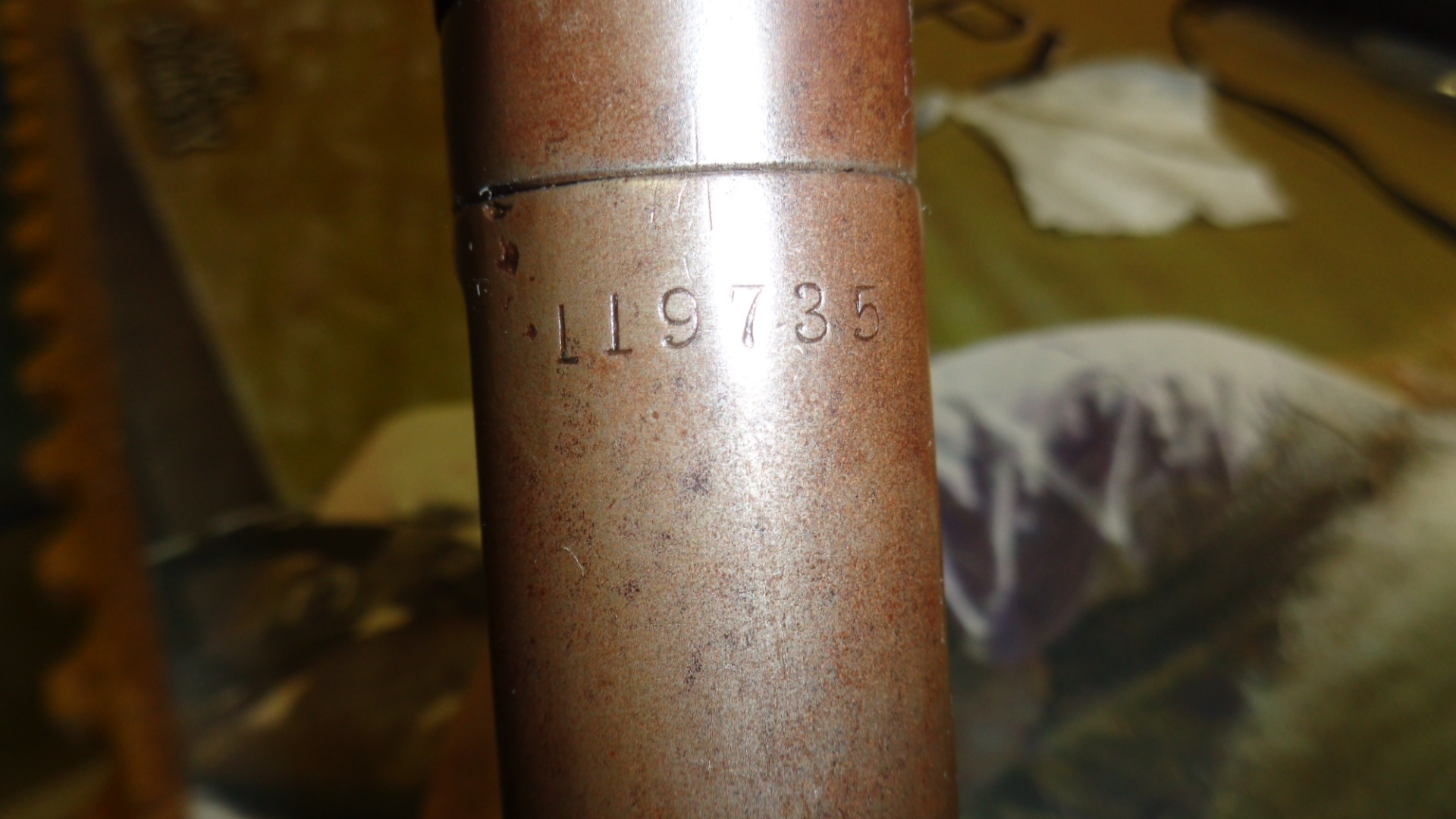

Something is definitely odd about the rifle. The SN looks centered to me (Pic 45 and the script on the SN digits appears right for the SN range (although looking a little worn-below are a few SN digit pics to compare).  However, if it letters as a 44 cal carbine, the fact that it has a small caliber recess in the receiver for the magazine tube tells us its definitely not a 44 cal receiver (compared below).  I have come across carbines that have been converted at the factory (letter as such) to a TD rifle, but this isnt one of them.  If the script style of the SN checks out either someone has a set of the old dies and either removed the SN or took advantage of the original being worn down (absent).  The current SN looks worn and as if its been there for a considerable amount of time.  Definitely doesnt look recently restamped.  The first small caliber TD rifles I see are in the 20,500 SN range.  Have seen several really early but they werent original.
