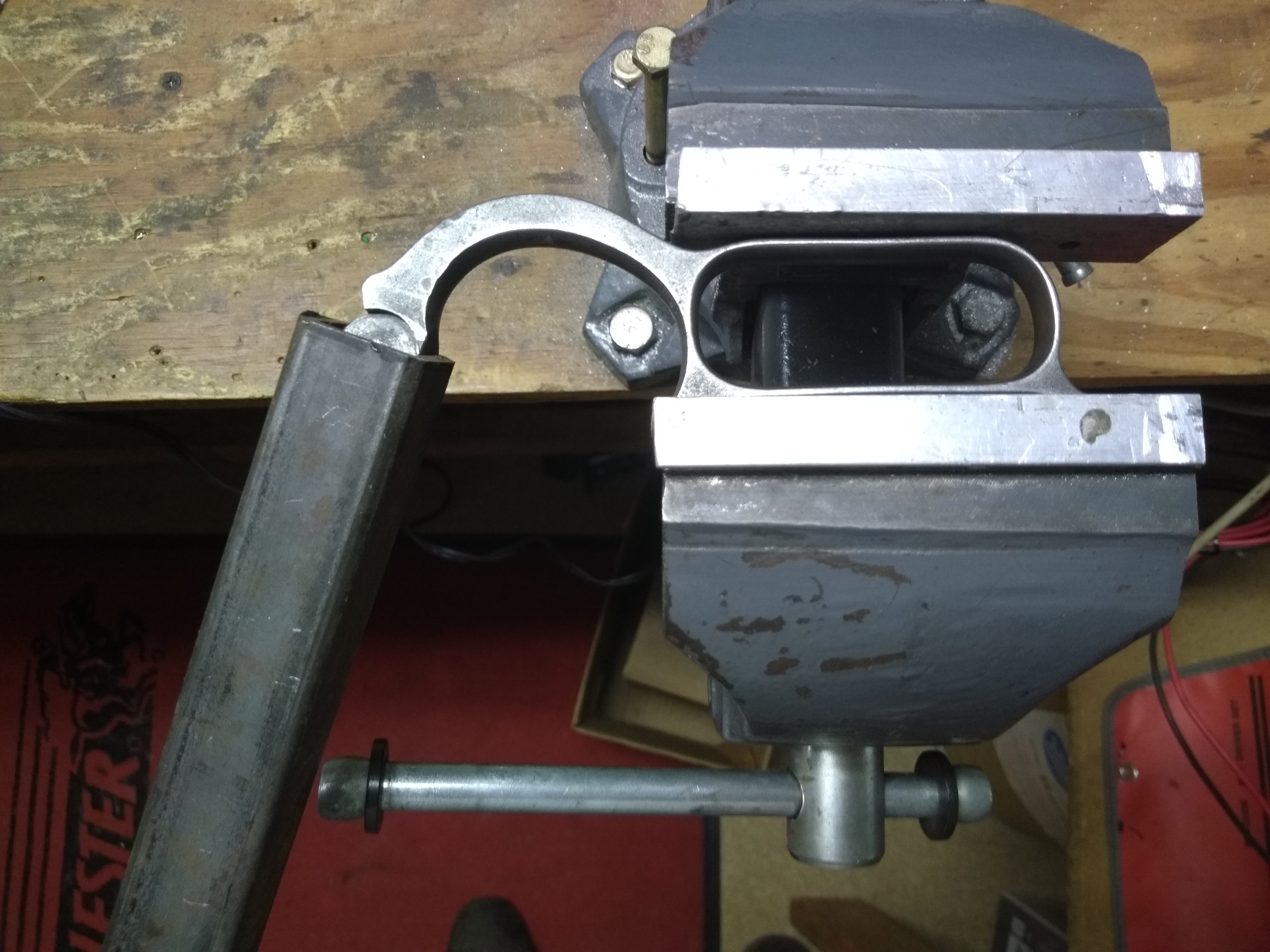

Take the lever and put it into a padded vise like the picture below and then bend on the front of the lever with a small pipe or crescent wrench a little at a time and keep trying the lever in the receiver until it works. It will yield in the finger loop area since its the thinnest. Best case is it works and worst case is you buy another lever. If you want to replace it I would go on Ebay and get a original lever.

Thanks I will give it a try.

Like I said, You have nothing to lose trying to bend it back. The only issue with buying one is if it fits up right or the cam is worn down and your lever sages.
