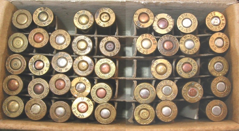

He is asking $2 per piece… a bit on the high side, especially considering it is mixed.  One thing to look out for on used 25-20 brass is whether or not it is black powder brass or smokeless powder brass, as they take different sized primers.  If you look closely at the picture I have attached, the leftmost row of cartridges are black powder (larger diameter primer), while the row immediately to the right of it are smokeless powder (smaller diameter primers).

I knew it was scarce brass to locate and nothing more.
Does the smokeless version uses small rifle primers?  Were the black powder version a special size or would a large pistol work?
Erin
Forum Posts: 15042
December 21, 2020 - 7:51 pm
Erin
The smokeless case do use small rifle primers.  I do not know what the black powder cases use, as I have avoided using them.
